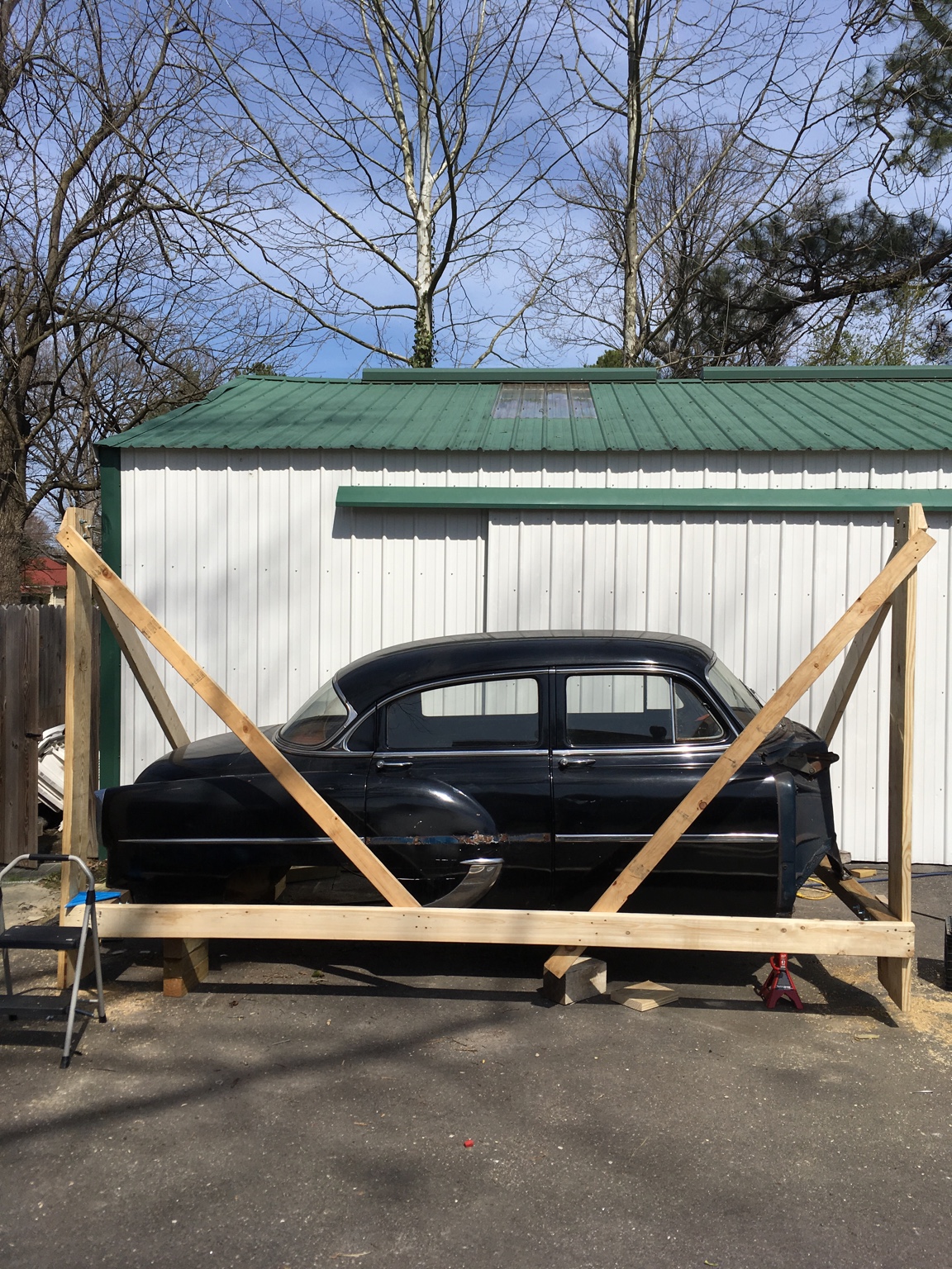

  8. buzzbrother
    Joined: Jun 2, 2009
    Posts: 76
    buzzbrother
    Not hard. Mine has been sitting on a jig in my driveway for 6 months. you have engine and trans still in?
    Regardless
    Few beers, few buddies, few hours. Pedals, steering column, throttle cable, Drop the fuel tank, rear shocks, e brake, battery and cables any connections, think there is 8-10 mount bolts. I used cribbing some jacks and an engine lift, put it on rollers, built rotisserie jig around it...all in a weekend.
    [​IMG][​IMG][​IMG]
    The37Kid likes this.
