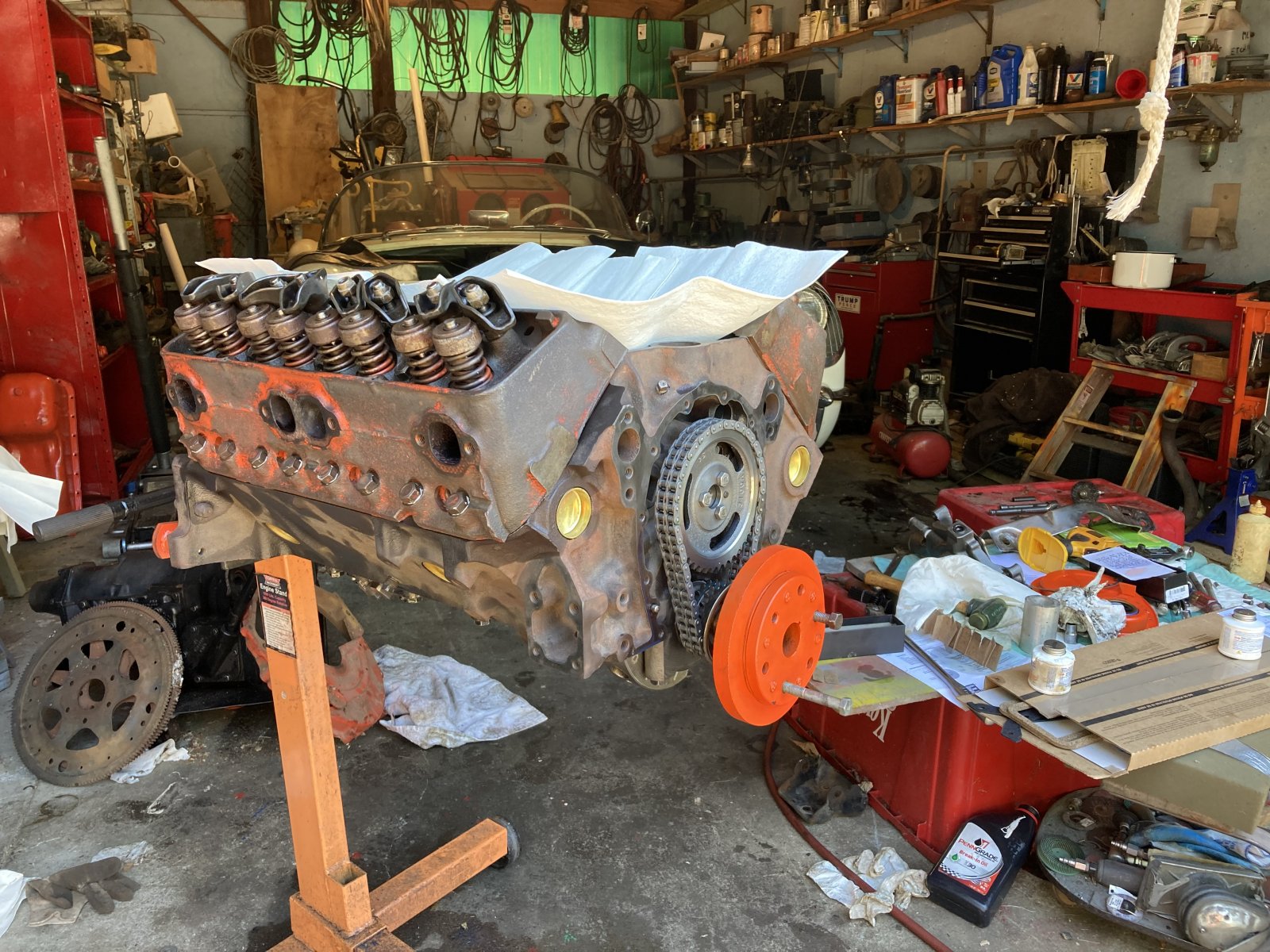

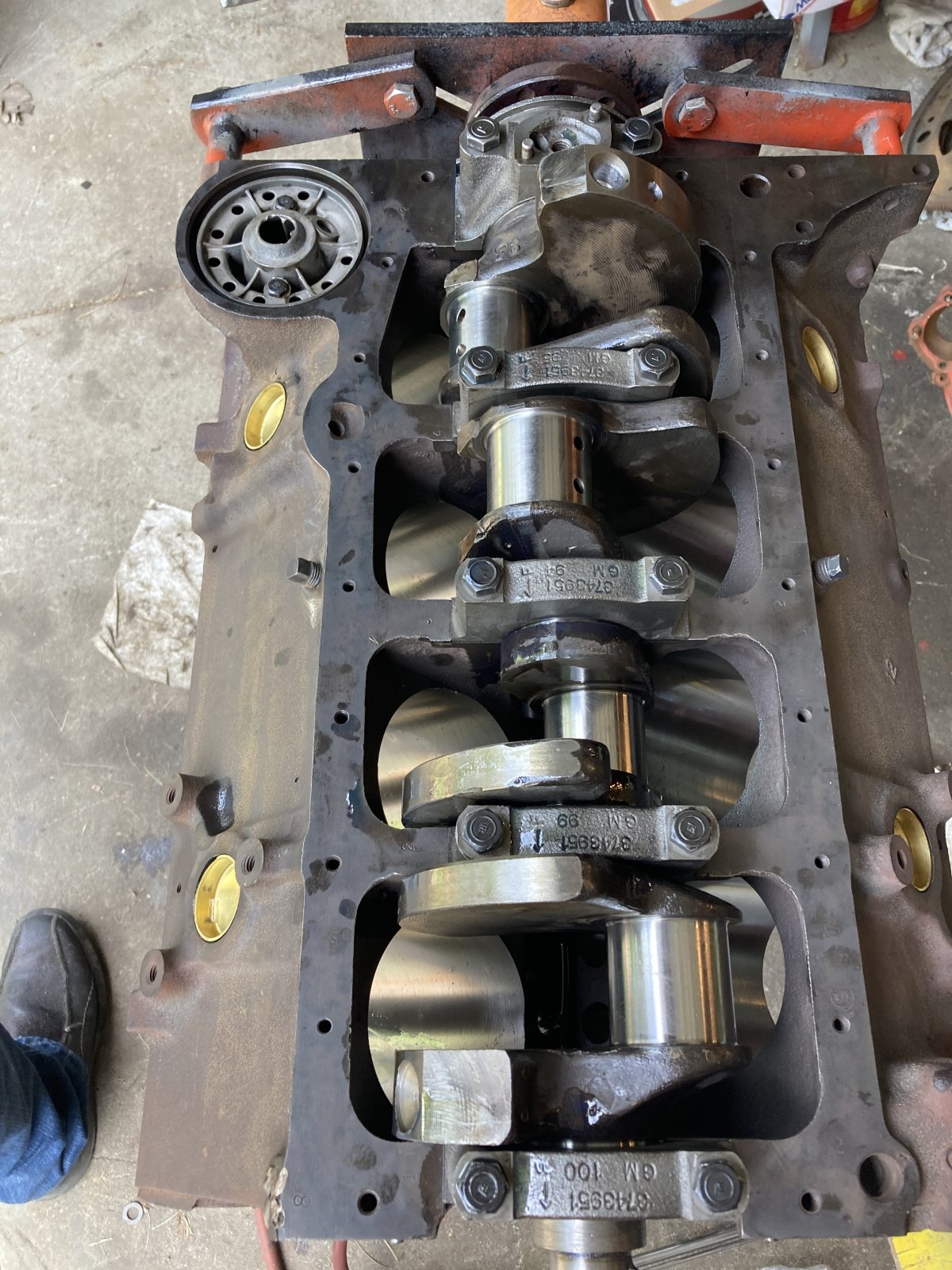

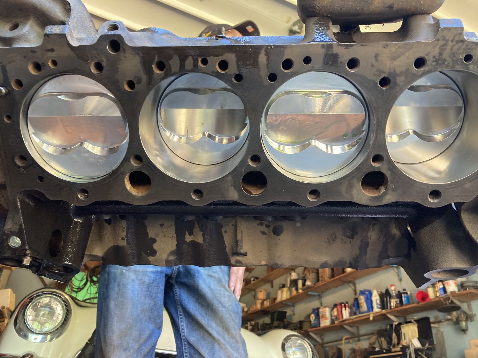

    We received the engine from the shop and now have the crank and high compression pistons installed. The cam has also been installed. More progress and updates to come.

    Just a word of caution, before you get it painted all pretty, prime the oil system real good to make sure the new plug in the deck surface on the odd cylinder bank doesn't leak. I've had headache's with them leaking after the factory plug was replaced. Lookin' good Though!!! :cool::D

    Now is a good time to make sure those pipe plugs on each side of the pan rail can come out easy for coolant drainage.

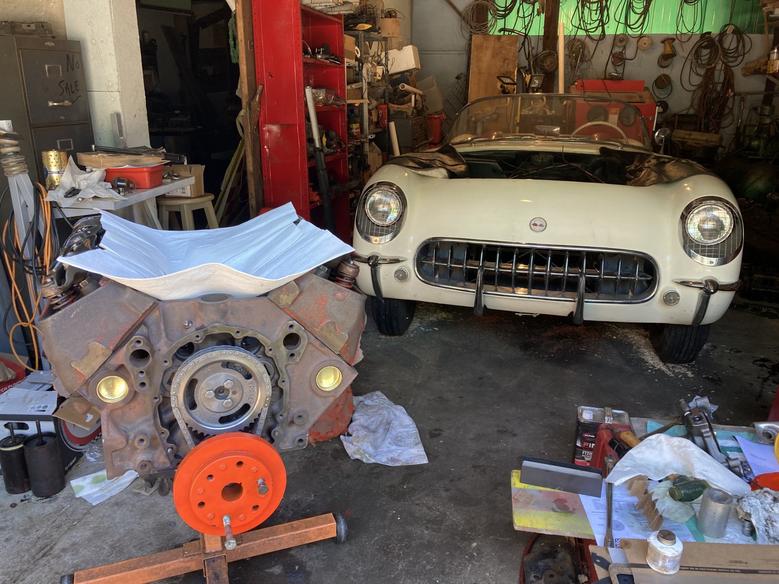

    Got the double hump 202 heads on today. Slowly getting towards the finish line. Anyone know if the pushrod length is different between the originals on this engine for power pak heads and the double hump heads? Will the originals work ok in this application?

    a small block pushrod is a small block pushrod, they are all the same length

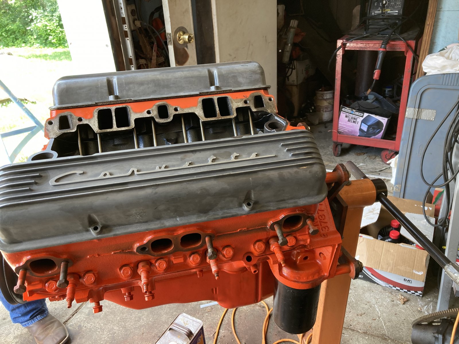

    Engine ***embly is now mostly complete and it is now finally painted. Valve covers are just sitting on the heads for the pictures. Have also decided to ditch the power glide for a turbo 350 transmission. We did know that the powerglides were v8 and 6 cylinder specific. Not to mention having one more gear will help the drive ability considerably. Does anyone know if the adapters to mount a turbo 350 to a 283 work well? More updates to come.

    A turbo 350 will bolt right up to a 283 without an adapter. You do need to make sure the block is drilled and tapped for a block mounted starter as some 283’s had starters that bolted to the bell housing

    Weren't all 283's drilled and tapped for starter's for Turboglide applications?

    I think you may be right.....

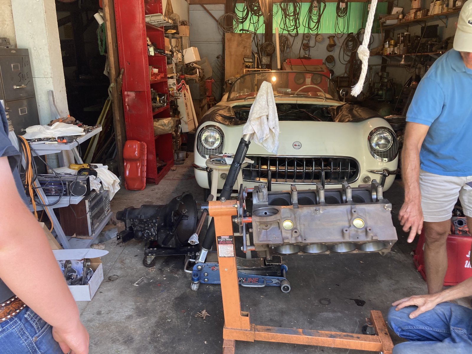

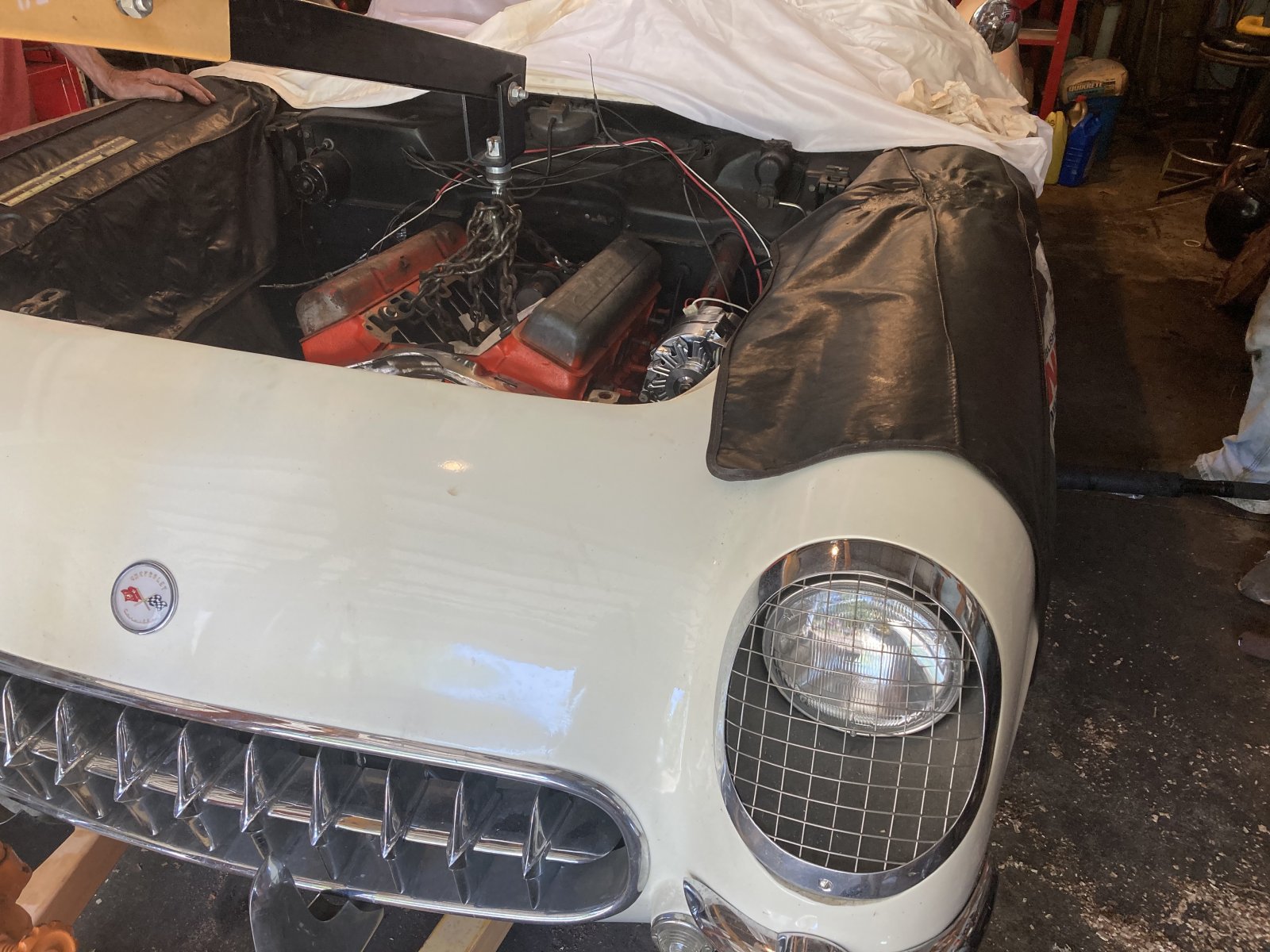

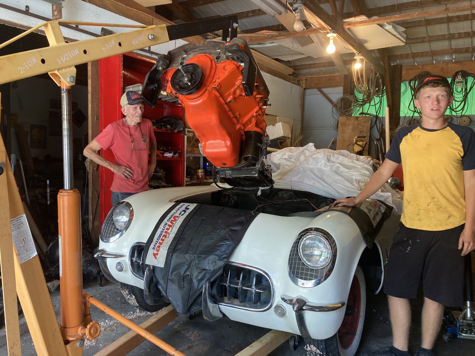

    Lots of progress, after a couple tries the transmission is installed. We may have allegedly bought the transmission in a back alley, so everybody cross your fingers that it works. We also positioned the engine in the car and are starting to make new mounts for it. Now it finally looks like a 55.

    Looks right at home in there! I´m sure gramps is gonna have fun with this little 301 powered vette!

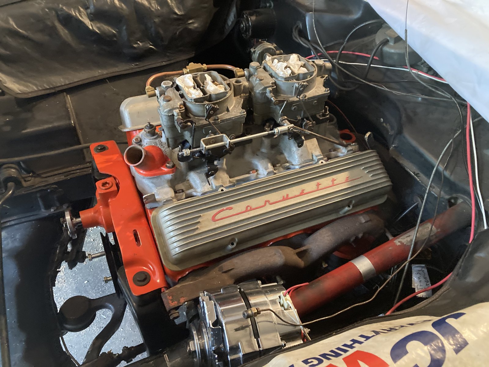

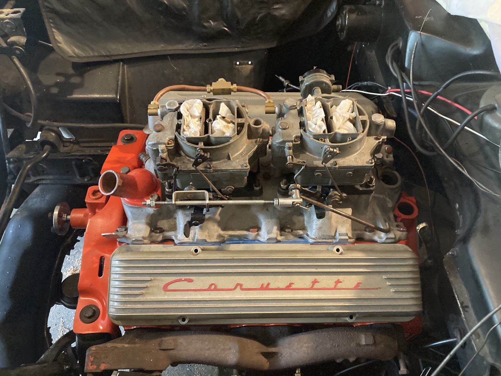

    There’s a point in every build where you know you’ve done the right thing and made the correct choice. One of these moments wears when we got the intake, carbs, and set the valve covers on it. The next big moment will be fire up and driving…hopefully. I also have no clue what the compression ratio will be but I know it’ll run on pump gas. Meanwhile we’ve got to get this thing done, summer’s almost over and the homecoming parade waits for no corvette:
