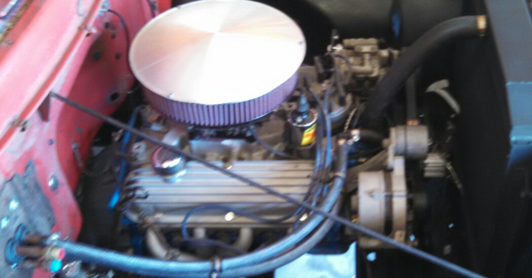

    lined up CHRR.jpg Mine doesn't look a whole lot better than yours, but it has been my daily for 15 years.
