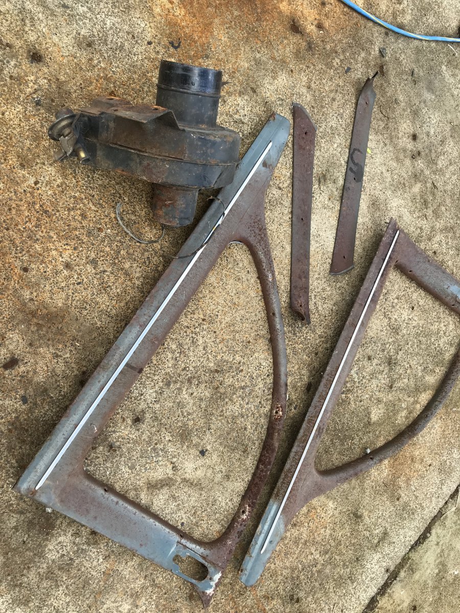

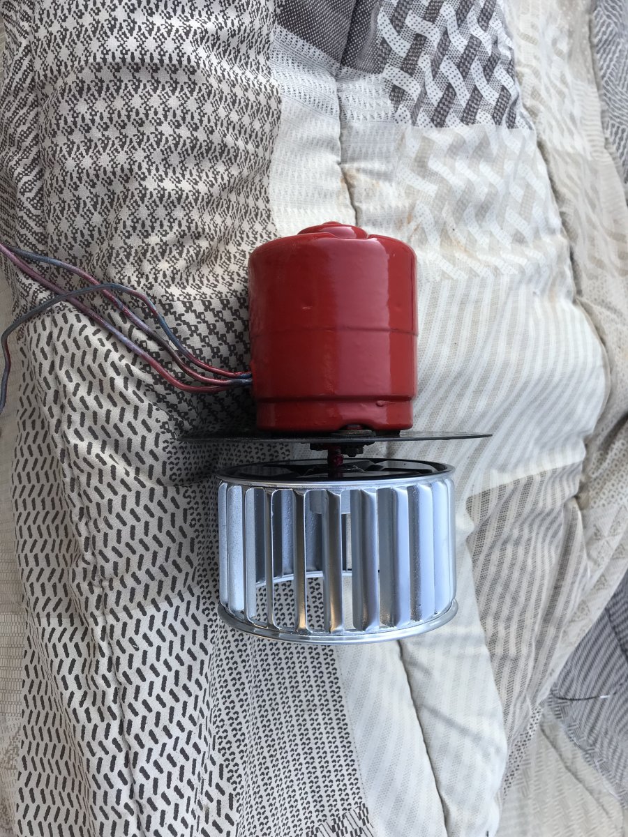

    Good looking car. Have fun. I have a few parts that may fit your car. I have the heater blower motor and housing. I see you are missing the motor on yours.

    Does that go where the large round hole is in the vent ducts?

    23B1130C-FE1F-43AC-BF36-90146626F4DD.jpeg 55C320B0-1A1D-47B0-8014-1FCDEAAF3F5D.jpeg B56830F3-7166-4328-ADAB-E5C772B9D81B.jpeg 0ECEBC20-22DB-4C8C-A9A8-8D157386C83F.jpeg D942AAB7-280F-429C-BF60-ACD1EE8EAEF7.jpeg 23B1130C-FE1F-43AC-BF36-90146626F4DD.jpeg
    Yes it looks like this.^^^ plus the small pile of parts I have.

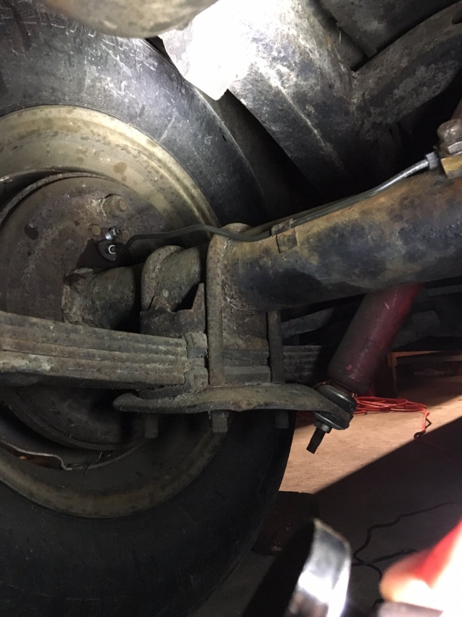

    It is a junction block where the soft brake line splits to the two wheel cylinder hard lines. Nothing inside it, just a fitting. It is attached to the differential housing with the differential vent (oily thing).

    I have front brakes, but no rear, I suspect the lines are bad

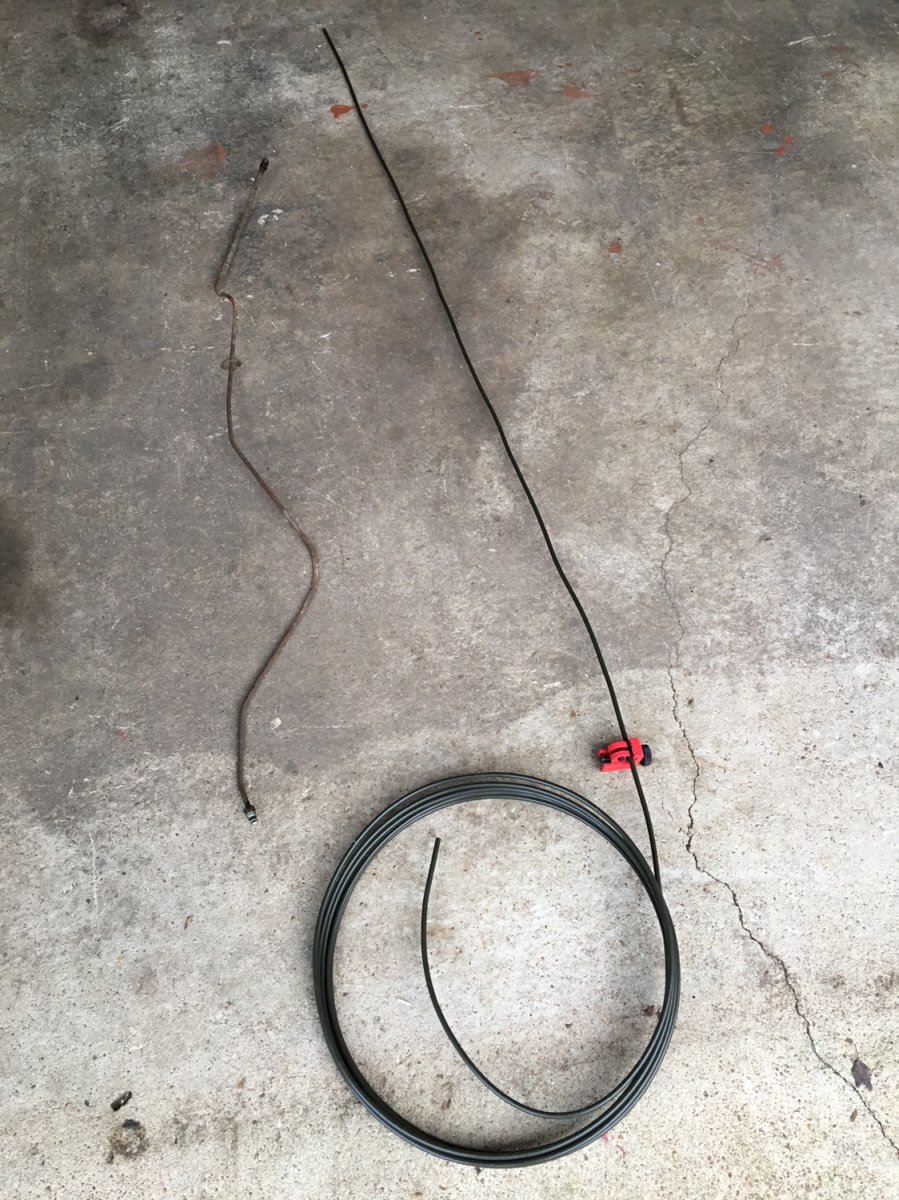

    Tried my hand at making some brake lines today as opposed to ordering pre bent lines and waiting a few long days for shipping..
    Didn't turn out as good as I had hoped but not bad for a first time i think.
    IMG_2057.JPG IMG_2058.JPG IMG_2059.JPG IMG_2060.JPG IMG_2061.JPG IMG_2062.JPG IMG_2063.JPG
  22. My only question is, did you double flare the new brake lines? Just doing a single flare on those lines will often cause cracks in the flare.
    I like the car. I like the older Y blocks, but for practicality, I think I would look for a 390 FE engine. Parts are not difficult to find, and you will have good, reliable, performance at a reasonable price.
    Bob

    To double flare there are inserts that you insert into the end of the tube and create a kind of reverse flare then you flare as usual. If you did not perform the first step the flare will leak and eventually fail due to cracking as stated previously.
  25. I am sending this link showing the technique for doing a double flare, because the technique is difficult to explain. It is critically important that the brake lines get a double flare, so I am p***ing this youtube link along so you can double check that you did it right.

    Thanks, missed the last step, guess I'll be climbing back under..

    Double-down on the double flare thing. I tend to buy straight sticks of brake line since it can cut my flaring in 1/2 on shorter lengths. I can get it in 60" pieces and unions work pretty well for me. I did the front of my '59 Ford that way.

    When you cut the brake line use a fine hacksaw because a tubing cutter will work harden the line makeing it harder to bouble flair. After cutting file the end smooth and de blurred then follow the directions on j-jock video.
