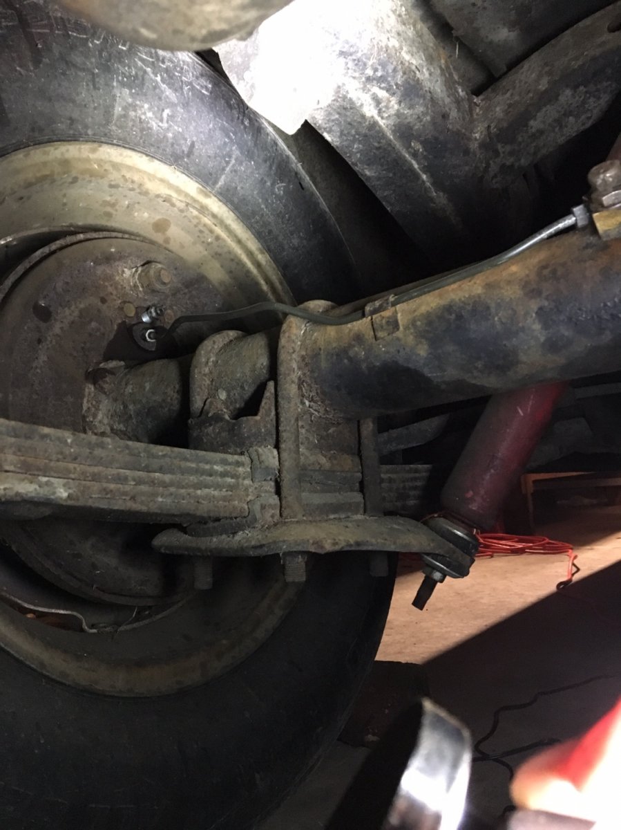

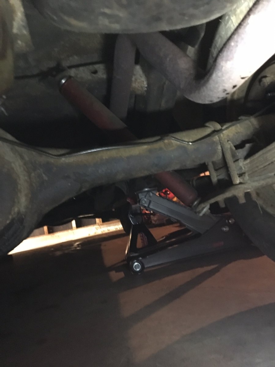

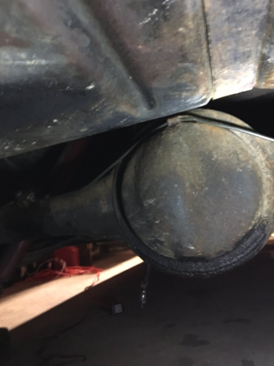

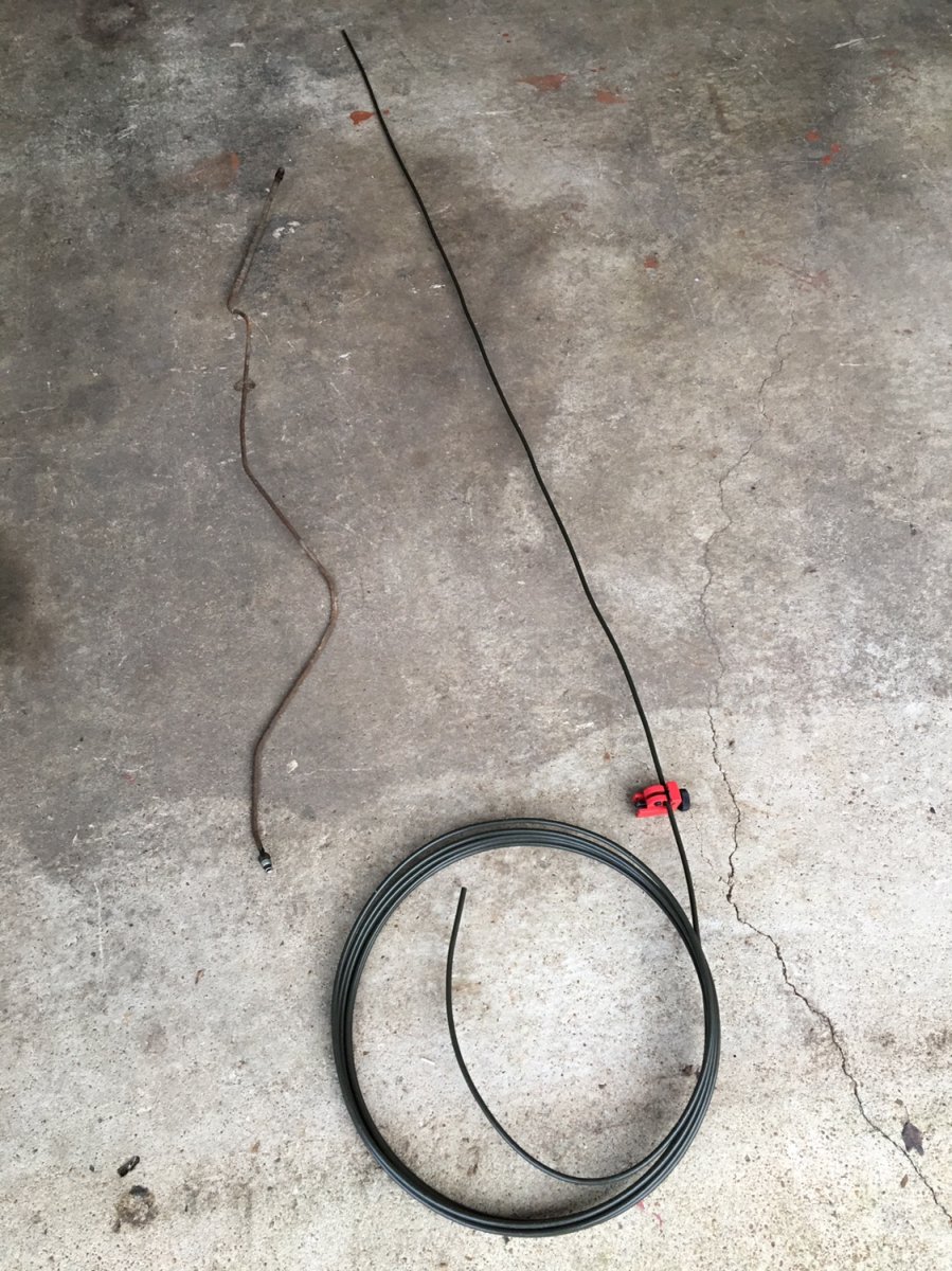

    hey just a heads up, the reason the line that runs over youre u bolts has that coil over it is to prevent vibrations wearing a hole in your line where it makes contact. not a crisis but you can always slio a small diameter rubber hose over that section as a safety measure

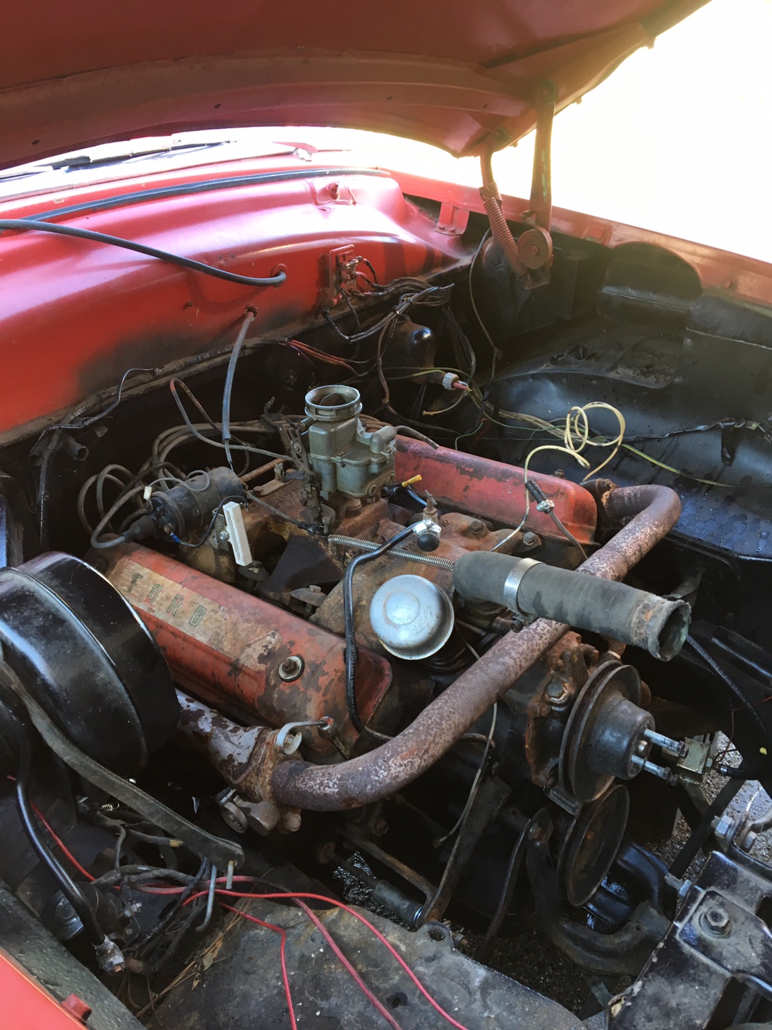

    An alternator should change between 13.8 and 14.1 volts. Over that and it drinks the battery water and could be harmful to the battery or worse. Looking at the wiring pictures, a re-wire might be a good idea.

    I actually had to rewire since that photo to get it to charge to the aforementioned 16v while running. The wire which I currently have running to the coil is connecting to the coil after the circuit runs through the ballast resistor, which I think may cause the alternator to read lower voltage, causing it to put out more voltage than necessary. I am going to try running the wire to the "in" terminal of the ballast resistor to see if that helps bring the voltage down to normal levels.

    Small update, i still cannot get my hand into the seemingly 0 cubic inch space that I need to to get the rear brake lines connected back to the adapter/splitter (whatever it's called) on the frame near the steering box to get the brakes up and going again. I put this task on the back burner after the below occurred.

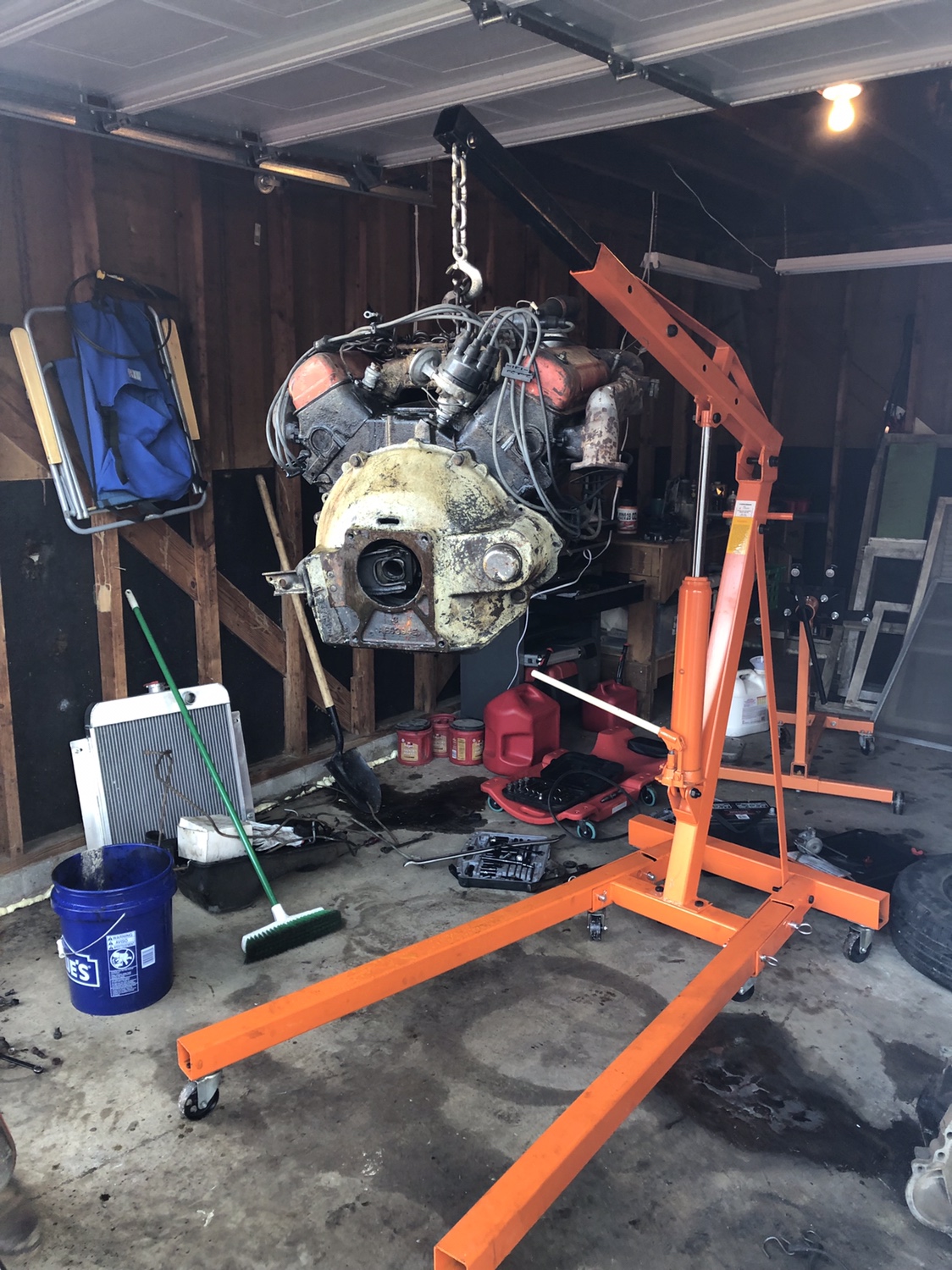

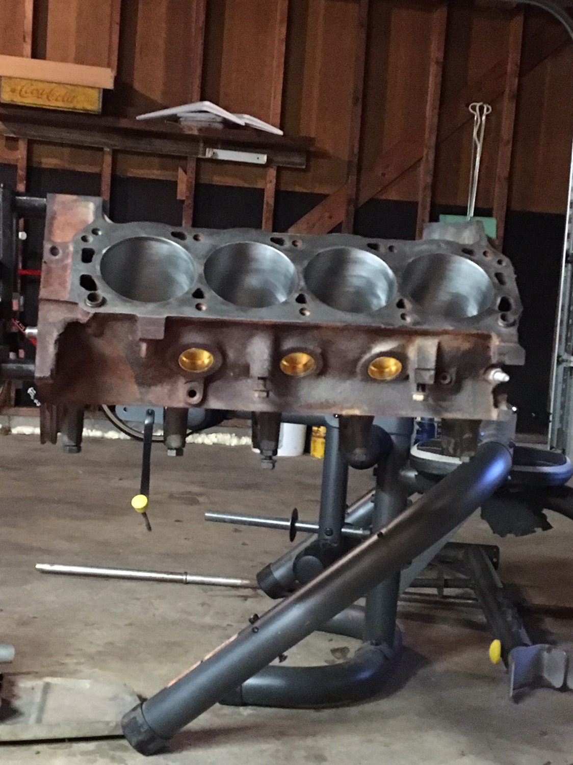

    Still plugging away slowly on the ford.. over the last few weeks, I pulled the engine out, got my 302 block freshened up, and pulled out the ratty wiring. Yesterday I got the transmission and drive shaft out.

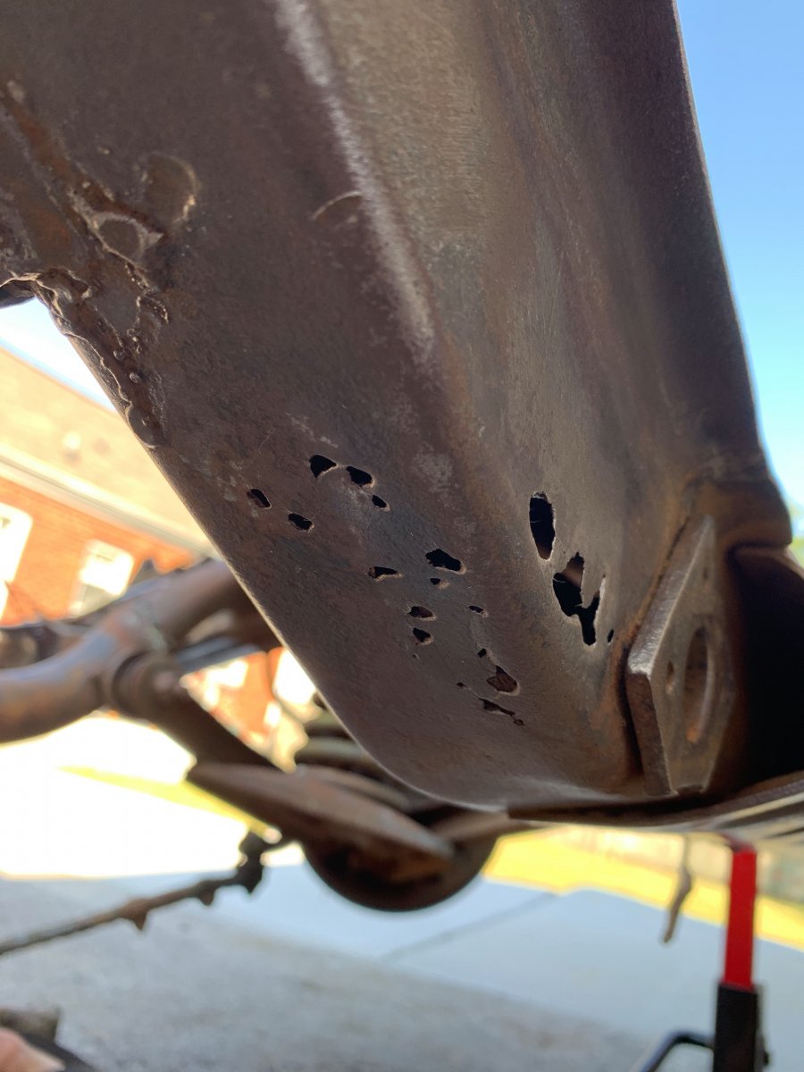

    Last week I also took the front bumper and splash pan off to prep for getting the crossmember repaired. I'm open to suggestions.. the only frame repair shop that gave me a quote quoted $1,800 to fabricate a new crossmember and weld it in, which I thought was way out of line. What do y'all think?
    I keep pulling parts out, can't wait to start putting them back in...

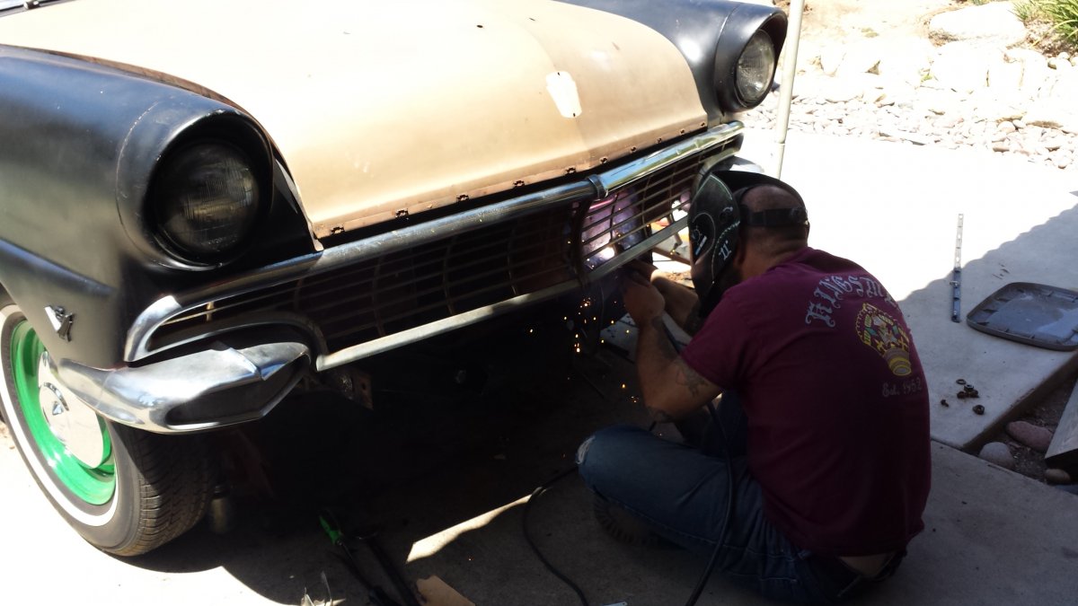

    from SoCal
    I found a new fabbed 56 front crossmember on ebay for 300 bucks. I replaced it myself with all my suspension in.
    Use allthread to lock the springs, then pop out the A arm bolt.
    Bang the new member between the rails, bolt up and check the front end alignment. Then weld er up.
    It was easy

    My buddy put his fluxcore 110v in his trunk and brought it over.

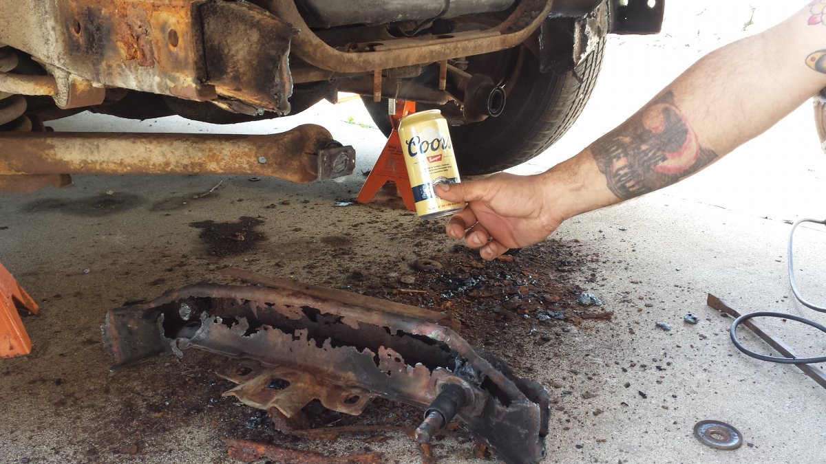

    Jakes38
    Excellent day! Never underestimate a flux core welder in capable hands. 20150412_121707.jpg

    I'm not 100% sure that "capable" is how I describe my hands, but I'll take the compliment, brother.

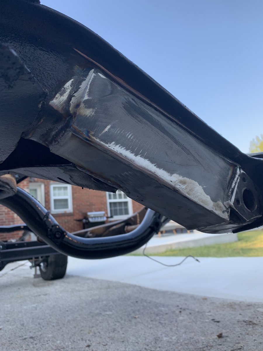

    Well, lots has happened since I last posted.

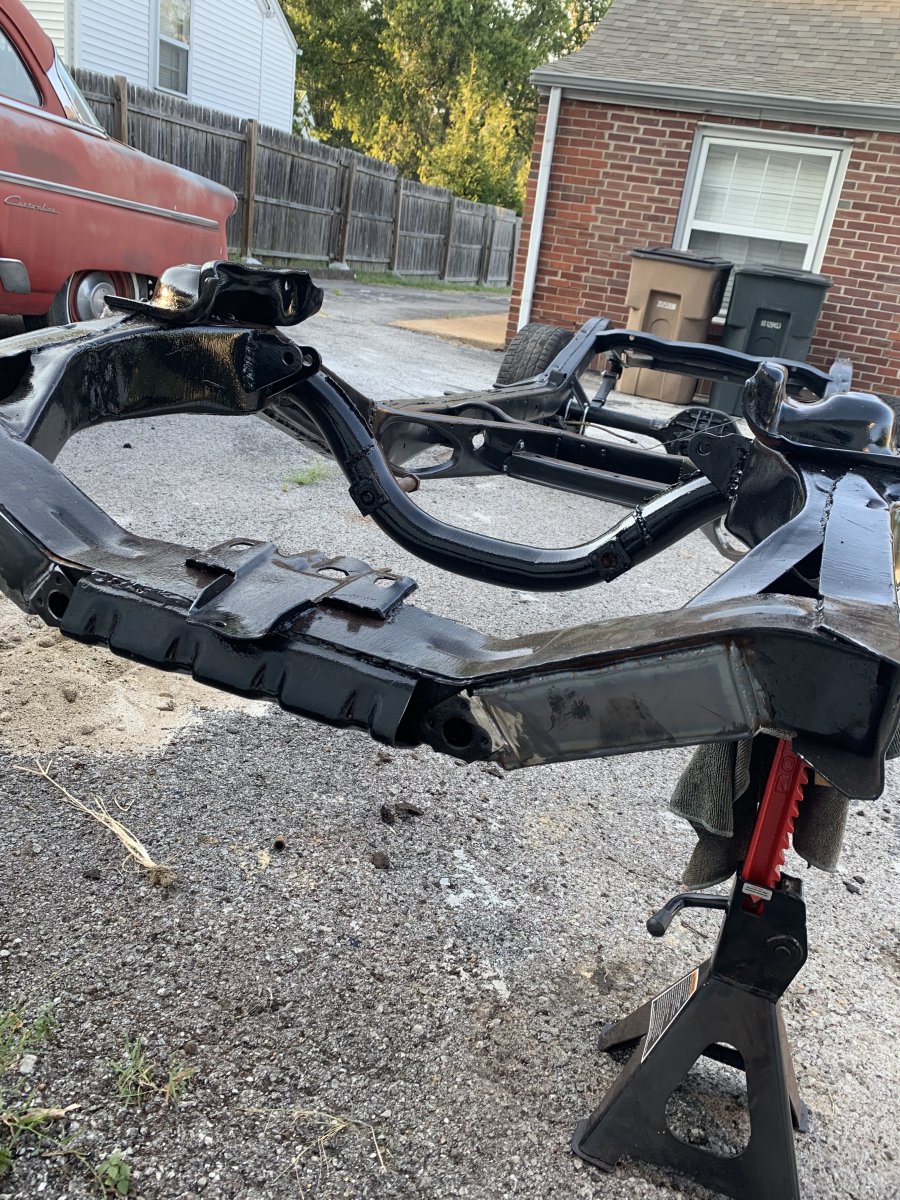

    I’ve been slowly ac***ulating 302 parts, and ended up buying a donor car on the cheap to swap the frame out (and got lots of parts to sell to more than make up for the cost).
    I’ve been stripping and painting the “new” frame, and thought the front crossmember was fine until I got around to hammering out the bolts that hold the lower A-arm on and the rust fell out and revealed Swiss cheese.
    I was pretty devastated but found a mobile welder to come by and he did a great job patching it up. It wasn’t nearly as bad as the original frame.
    Now if only I could figure out how to post pics from my phone...
    Next step is finish rebuilding the front end, lift the car body and start stripping and painting the underside of that.
