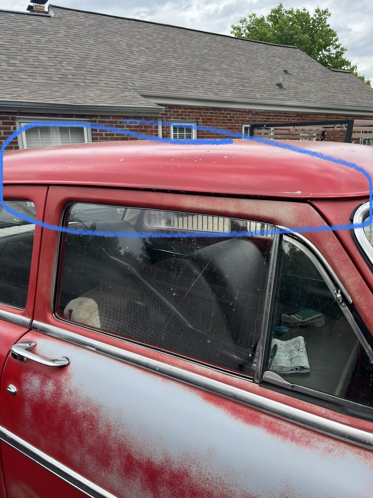

    Man, I am having some trouble lining up my door gaps.
    On the p***enger side door, the gap between the roof and the top of the door, in front by the A pillar, is really wide. The same gap in back by the B pillar, is super tight.
    For the life of me, I cannot figure out how to make this adjustment as the hinges only seem to move the door toward or away from the body, and not up and down.
    tips?

  4. 6sally6
    Joined: Feb 16, 2014
    Posts: 2,920
    6sally6
    Wonder if............you could put a thick washer/shim in the hinge to move it up some.?
    Surprised there is no up & down adjustment in the hinge ***embly!

  5. Dos Cincos
    Joined: May 13, 2011
    Posts: 935
    Dos Cincos
    Are you adjusting the hinges on the door side or on the pillar side? Door side is up/down - Pillar is in/out
  6. tylerbrasher
    Joined: Dec 22, 2010
    Posts: 148
    tylerbrasher
    Ah, I will give that a try
    I didnt see any room for adjustment at the door side on a pair of old hinges I have, but I figured there had to be a way.

  7. AldeanFan
    Joined: Dec 12, 2014
    Posts: 1,170
    AldeanFan
    The door gaps on my ‘54 wagon are not very good, but someone has elongated most of the holes in the hinges to get more adjustment and the face of the tailgate hinge has been milled to get the tailgate to open without hitting the body. You may need to do something like this to get it perfect.
    On other cars I’ve had to add flat bar to door edges to make the shape and size of the door fit the opening perfectly.
    I think that these cars didn’t have great gaps from the factory and 60 years on the road and several restorations and repairs haven’t helped.

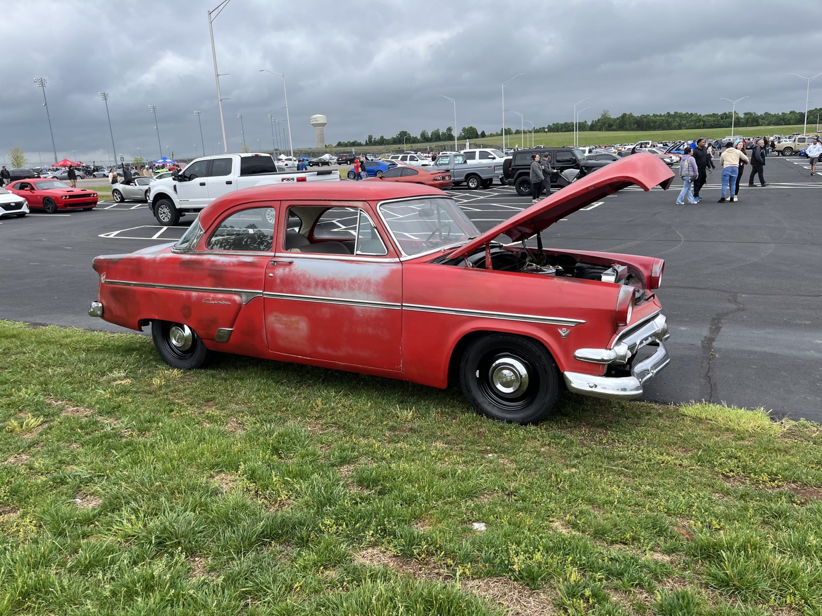

  8. tylerbrasher
    Posts: 148
    tylerbrasher
    Wanted to show off at the local cars and coffee 3690E509-8465-463A-9BC2-1EF4BA0AE945.jpeg 724C57E8-4318-4343-842B-CCC5E3B08447.jpeg

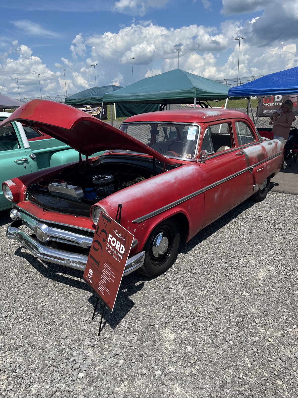

  12. tylerbrasher
    Posts: 148
    tylerbrasher
    My wife is a graphic designer and whipped up a nice car show placard BC0D6958-5255-4C35-9FC5-888B2A6839F5.jpeg

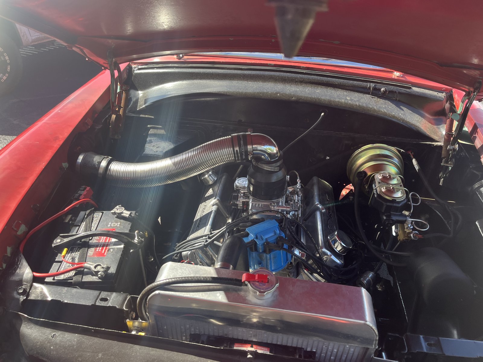

    Alright I’m experimenting now with turning the factory fresh air heater ducts into “ram air”
    seems to work ok and sounds KILLER after I put this together.
    At high speed and high rpm I seem to get some sputters and loss of power. My initial thought is that it’s forcing too much air down the carb and leaning out, but it could be starving for air too if my plan has backfired. Any thoughts on rejetting?

  20. tylerbrasher
    Posts: 148
    tylerbrasher
    no help. high rpm and high speed i can hear the air whipping through as i left off the gas after the stumble. so is my 3" set up not giving enough air or cramming too much in the engine at high speed? It doesnt seem to mind as much at high speed in overdrive with lower rpm

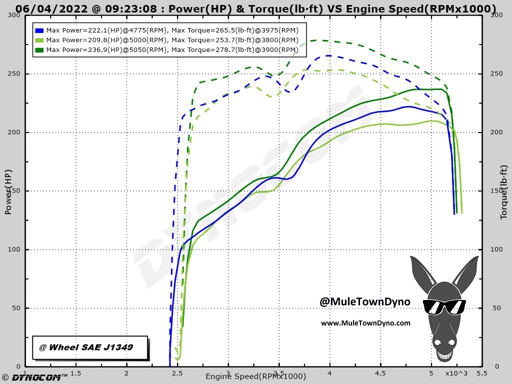

    Eh, i took the “CAI” setup off until I can figure out how to make it work. Needs more fuel I think. Maybe a cheap AFR gauge will help diagnose the issue.
    separately, I took the 54 down to the Nashville cars and coffee and hit the mobile dyno up, 237 hp at the wheels and something like 278lb ft of torque. Not bad I think. I’m estimating 237/80% = 290 something HP at the crank

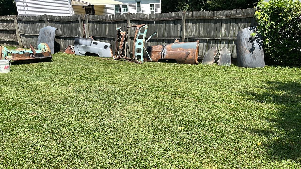

    Have some misc. 54 body panels for sale too. Pm me for details. I will make a great deal for you. C401194A-68E4-423E-A43B-E5165B0C9677.jpeg 8EA120B9-986E-41E1-AADD-5713043FCD37.jpeg

  25. AldeanFan
    Posts: 1,170
    AldeanFan
    For your cold air intake, I don’t think there is much to be gained from this and you run the risk of creating a vacuum in the wheel well and pulling air out of the carburetor.
    your carburetor probably needs more airflow than the one pipe can supply, lots of cars with your amount of cubes and HP had factory dual snorkel air cleaners and factory stuff like this is usually barely adequate.

    Hmm not sure what the reason is for the drop at 3500 rpm’s. Maybe vacuum advance dripping out?
    vacuum secondaries dropping out?
    this was WITHOUT the CAI experiment….

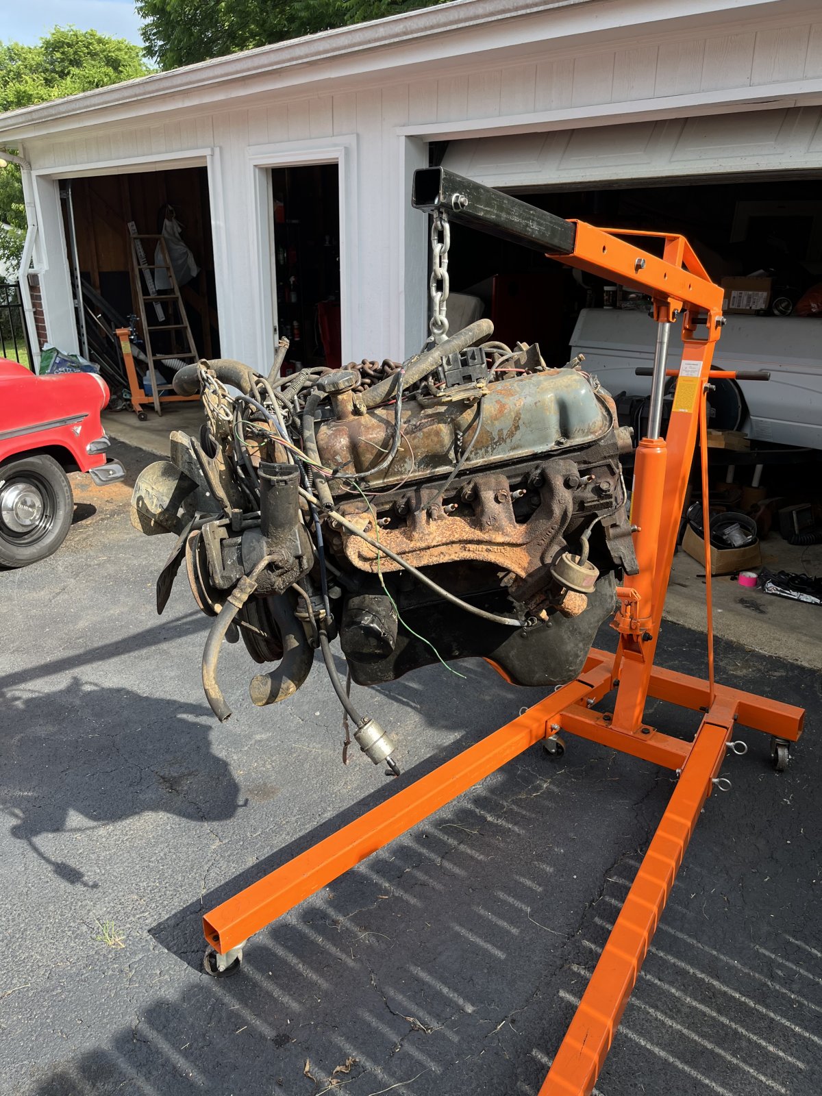

  27. tylerbrasher
    Posts: 148
    tylerbrasher

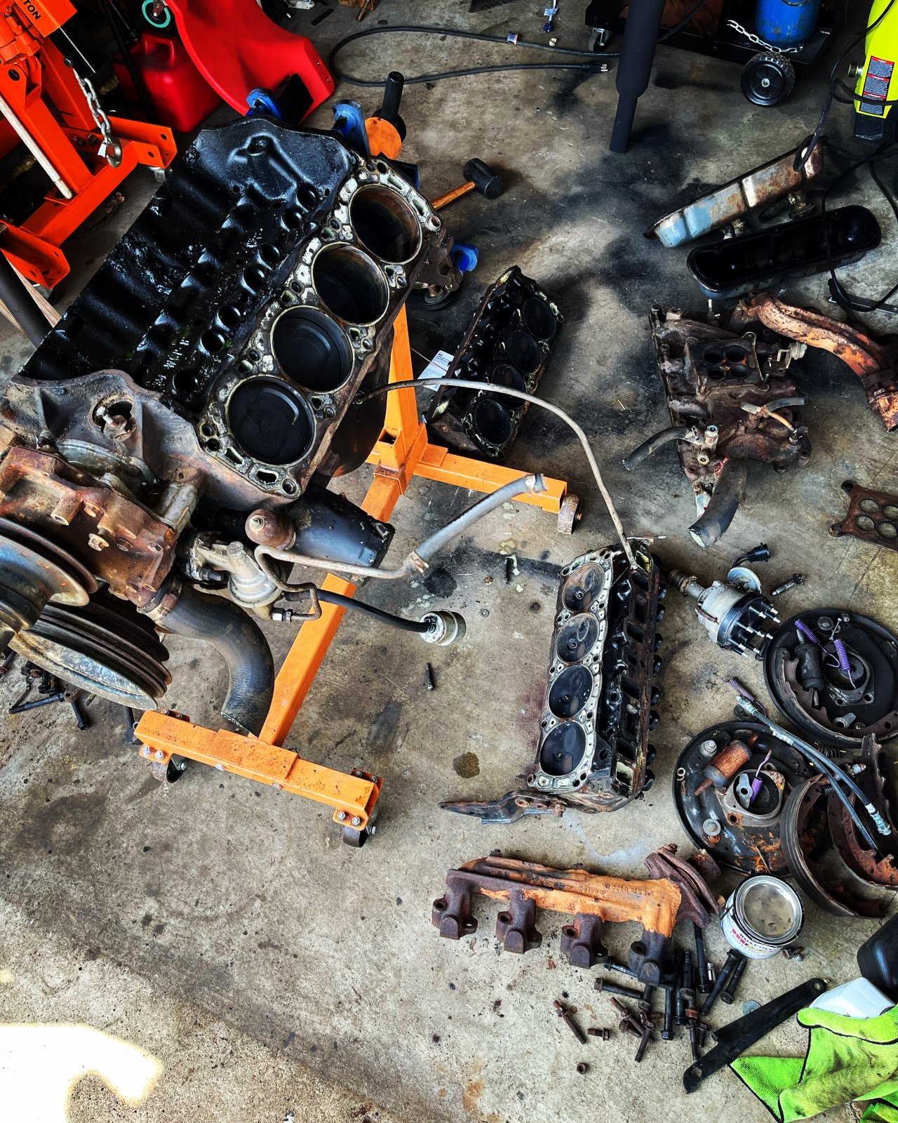

    Well well look what the cat dragged in
    351w
    Maybe getting stroked to 408 or 427
    maybe the rings get gapped for a future turbo
    bobss396 and RustyDogg like this.
