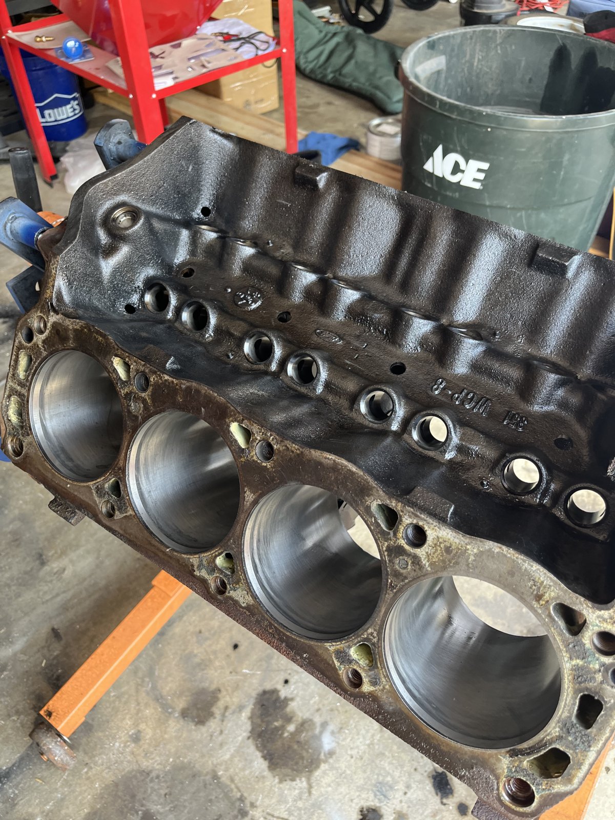

    BFA8B89B-0288-47FD-A040-01F53A1D0628.jpeg Bottom end on this old 351w was perfect. Looks like E5 heads (not as good as the later E7s as I understand it), and set up for flat tappet cam.
    pretty sizable ring ridge means I will be boring it out.
    Is there any reason not to bore it out straight to 4.050 or 4.060, as opposed to just 4.030? I guess you kind of limit the ability to rebuild it if it develops a new ring ridge later in its new 4.060 life?
    I see that most people go 4.030 with a 4” stroke to get a 408, but I’m thinking 4.060 for 414 sounds better

    Prolly a good thing you sold it.......pretty healthy for street use (Make that extremely healthy!)
    106* LSA = really snotty idle! 661-646 VERY hard on springs.(prolly got the numbers transposed too)
    108* LSA should be "max" for a street engine and ONLY with a manual ******.(or loose convertor.)
    60 over will INCREASE your chances of developing over heating problems. 30 over is good
    (40 over if cylinder taper is bad)
    IMHO
