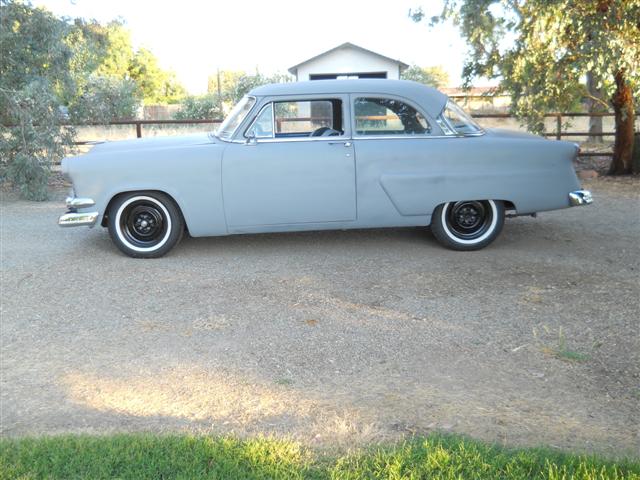

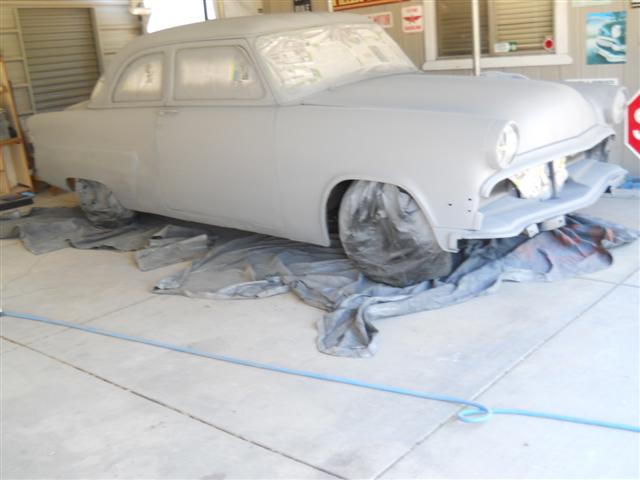

    Recently purchased Sedan project. turns out that it is not a coupe like I thought. Pics of what it did look like, with mix'n'match paint job. Also, pics of now in gray primer. Had to get it together enough for pics required by my insurance company. still need body work, real paint, upholstery, side gl***, etc. on low budget, even used plastic $10 chrome outside rearview mirrors from summit racing for now. I know this will upset some but, it does have a small block Chevy with turbo 350 and Camaro posi rearend. plan to do mild custom/hot rod driver. have to find plenty of parts, like side trim. also, need to figure out what year engine and rearend are.

    I ain't upset, its runnin', ain't it? Further along than any of my heaps. Enjoy it!

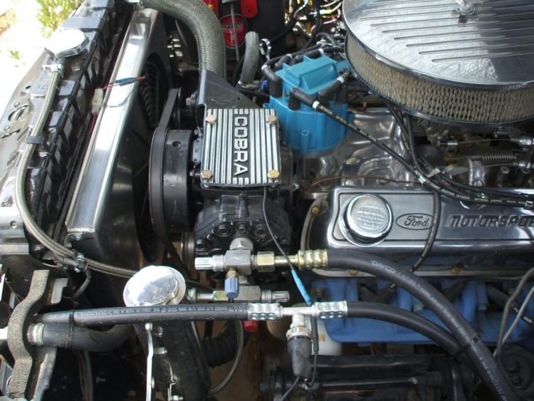

    I can live with a SBC in a 52-54 but for the life of me why use a electric fan?,,there is ample room for a mechanical fan and I personally think it would look better.
    BTW,you need a new fuel filter,,that one is pretty bad. HRP

    yep, does run strong. I have not had time to go through lots of details, like fuel filter. filter is not as clogged as looks in pic. came with elec fan, not as much room for regular fan as it looks in pic. but, have not given up on regular fan.

    There is more than enough room for a 6 blade fan. HRP

    Neat car...I like it !
    Can't see if the taillights have been reworked by the pix, but a cool "old school" trick at that time on the '53-'54 Fords was to straight-cut off the center "cone" on that taillight (leaving it open so the bulb shows through) and screw in a '53-'56 Olds '88 lense to the body of the original. Inexpensive, cool, easy, looks almost stock.
    All the best to you with this...it'll be a GREAT driver !

    Horse Power draw 15-20 HP unless a clutch is added,electric fan zero HP draw ;) Love my electric in Phoenix.

    Jeff,,I'm not to worried about the HP loss but after I melted a electric fan to the radiator in Columbus,Ohio some 560 miles from home in 1988 I have a strong distaste for them.
    Plus if you forget to turn it off it will kill your battery if it is wire to run with the ignition switch turned of,,,ask Merlin.:D HRP

    I've got a '54 Ford Coupe. (short top & quarter windows)
    Your chrome and stainless sure is nice...
    That Chevy looks like it grew there, nice install.

    Yep, that one is a 2 door sedan (just like mine) and not a coupe. Looks nice though, looking forward to updates.

    learn something new every day - have not done any research on different '54 body styles. just went by ***le info, and who knows if that was ever right. Thanks. for those concerned about not having a mechanical fan looks like only room for a 14" - 15". not many out there but, will keep looking. of course, a fan shroud will also have to be figured in too.
