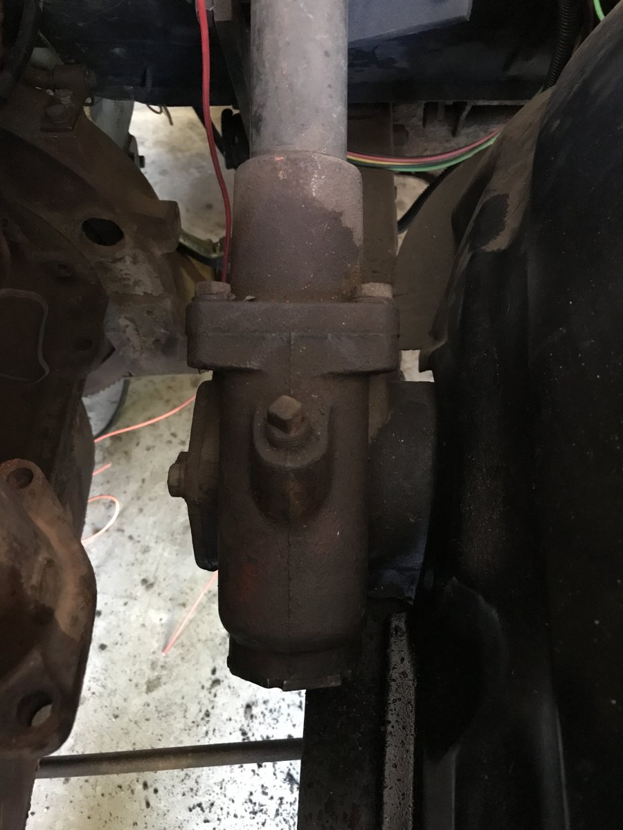

    After spending the majority of yesterday looking for a new and/or a rebuild kit all over the innerweb, I'm asking for help. The steering box on the 1954 GMC Pickup my son and I are working on is shot. The steering wheel has to be rotated at least 360+ before the front wheels start to turn. Does anyone have a line on a good used box, or where to have a GMC box rebuilt, or a good rebuild kit? Do any other boxes fit in the '54? Thanks for any help and information.

  6. squirrel
    Joined: Sep 23, 2004
    Posts: 60,394
    squirrel
    have someone else move the steering wheel back and forth, while you watch the steering linkage....see what's moving, and what isn't

    54 uses the "modern" recirculating ball steering gear. It's hard to get that much slop in the gear itself. But it can be done, I suppose.

    All good suggestions above - but unless I missed it, the most obvious and easiest check is the steering gear adjustment. My old '53 box had a lot of play, until I adjusted it as per the shop manual. It involves using a fish scale to check the drag on the ball/worm gear (pitman arm disconnected as I recall). I believe you can find an online shop manual on the stovebolt page.

    So... turning the steering wheel doesn’t do anything to the linkage until you start to ‘feel’ resistance on the steering wheel, and then the you can start to see some movement. I’ll try to adjust it and hopefully that’ll work. I do have the manuals and will follow what it says. Thanks for everyone’s input/advice. I’ll get back to you with an update. Adjustments.JPG

    I doubt it's an adjustment problem...the screw on the pitman shaft adjustment is in all the way, and the bearing cup on the worm adjustment looks like it's still where it belongs.

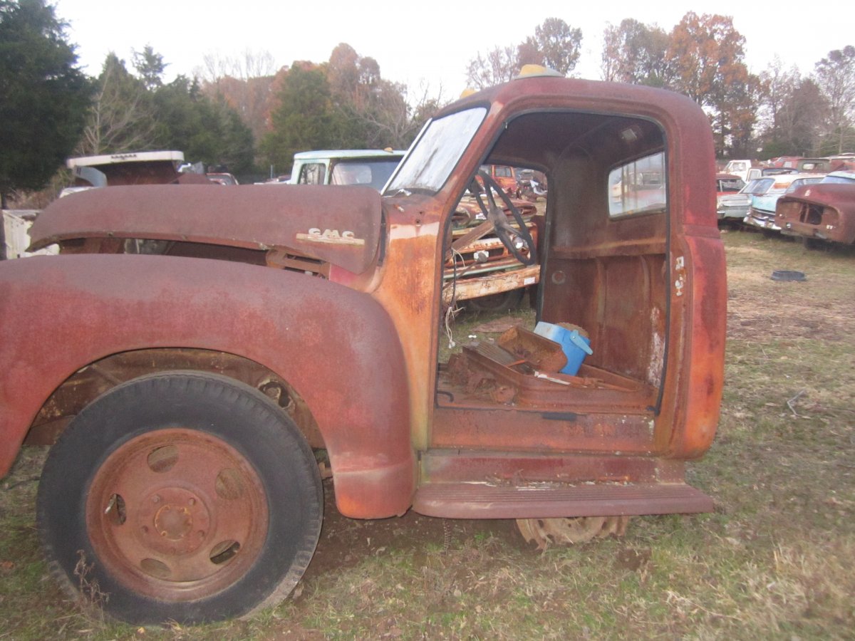

  15. quite often those steering sectors the worm gear and pinion get worn right in the middle and the outer ends are not worn. If you adjust to remove GMC cab 004.JPG the slack its too tight at each end where the wear is not as great. That makes them bind. the best source to find a good used sector is from old grain trucks. nobody cranked on the wheel when it was setting still and they never ran as many miles. I have one in my hoard the steering has zero slack.

    this is a recirculating ball steering gear....it has ball bearings at the ends of the worm, and balls between the worm and worm nut, and there are bushings that support the pitman shaft/sector gear. The bearings and bushings wear, you can replaced the balls, and the bushings, but the races might or might not be replaceable. The gear teeth on the worm nut and the pitman shaft, when worn out, are not repairable. If they are worn, you want to find another steering box to start with.

    Well... I promised an update and here it is. Got it out and after taking it apart discovered the bearings were destroyed. Threw the new bearings in, and seems to be good as new. Now to install it back in the truck and put it to the real test.
