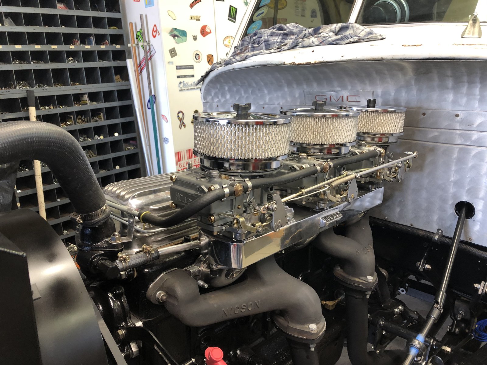

    Cool… they look the best but actually flow the worst. You can tell by the exhaust needing to exit at 90*. They however miss every aftermarket intake. Under no way will my son take his off. IMG_2893.jpeg

    @jimmy six is that a trio of tri BBL carbs???
    it was more of hearing he had 7 sets left a few weeks ago and the big swap meet is next weekend figured id swing by and see if he still had any and he had 2 sets left. His originals he wont sell and one set left of the repops. So $500 poorer i left his humble little shop. Lol.
    They cant however flow any worse than the Clifford ones that came with the 6=8 intake. Lol toothpick tubes. Lol

    The Holleys are 1960 Mercury 280 cfm on Offenhauser adapters to the early 3 bolt base which came with every Howard 5-2 manifold I’ve ever seen. These are set as progressive but they were originally on a Clifford tubing intake as straight linkage.

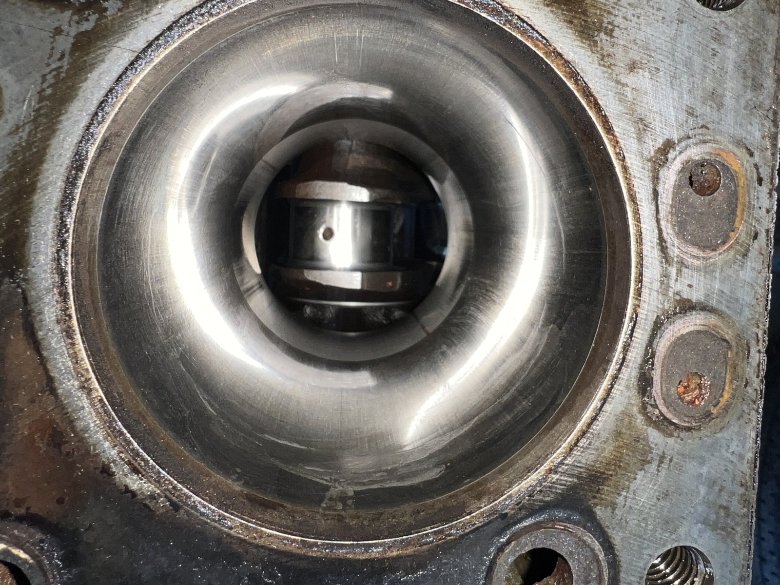

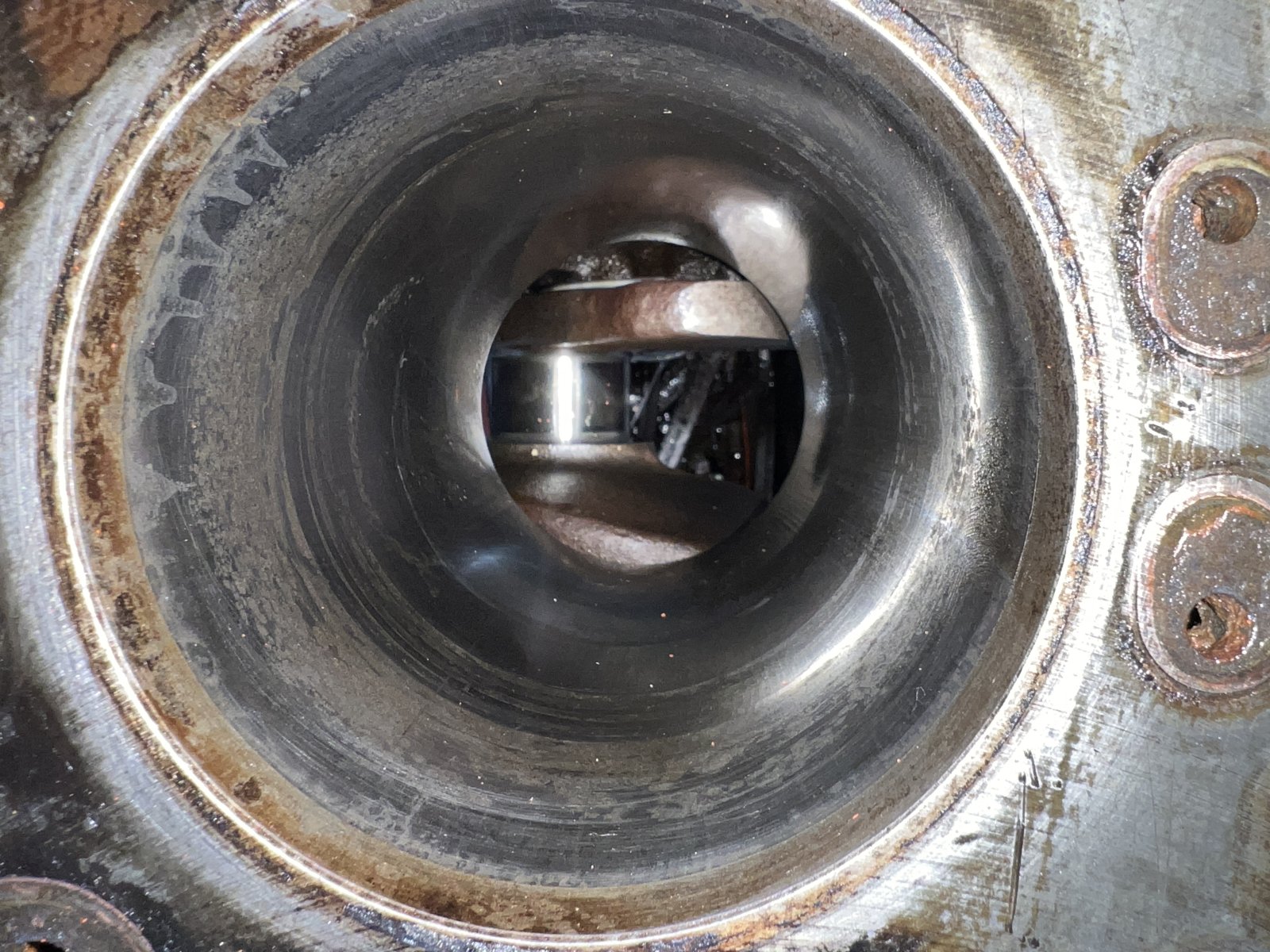

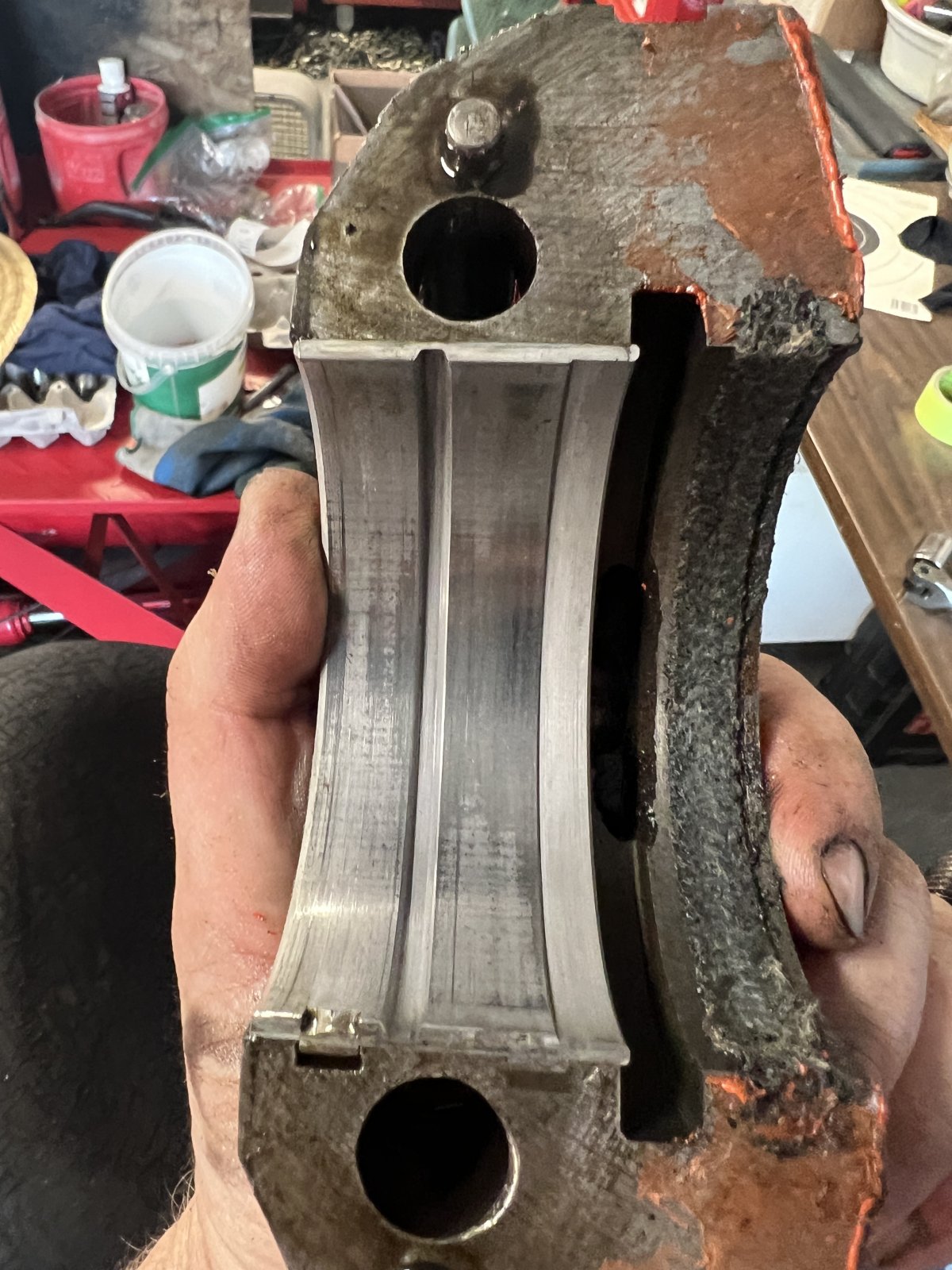

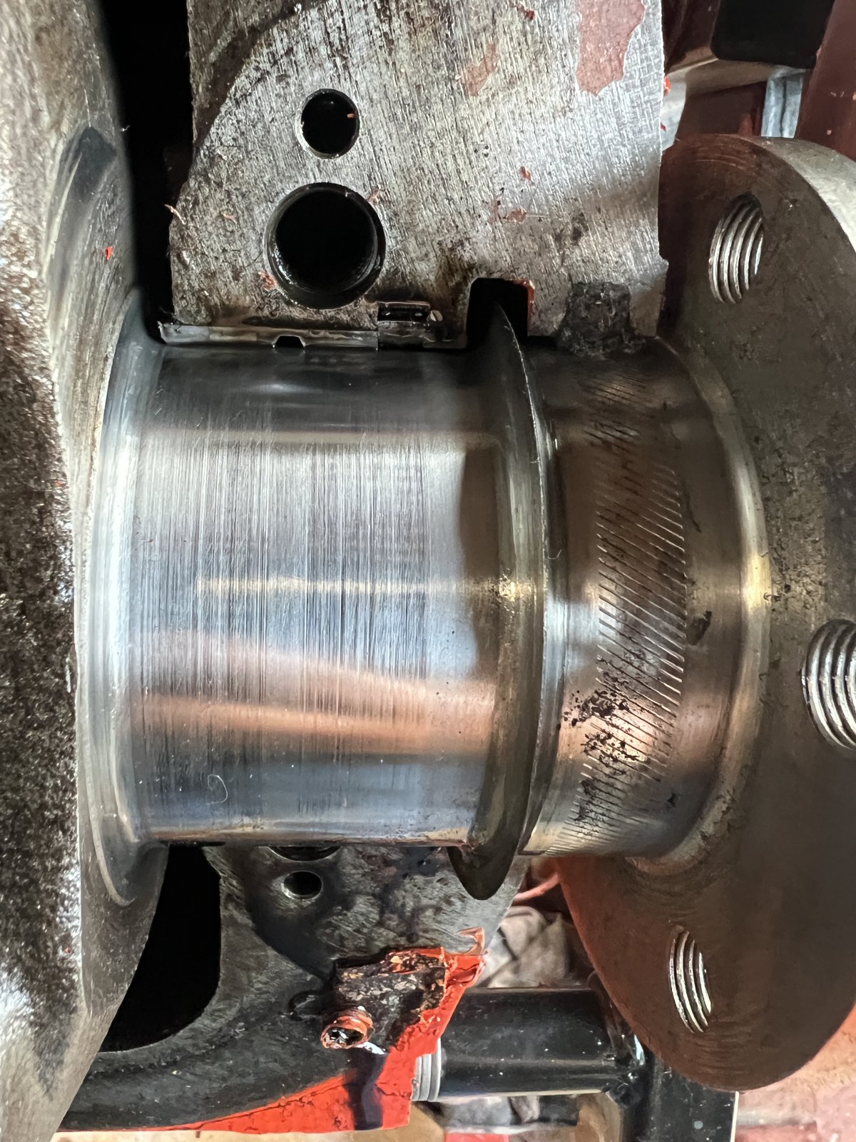

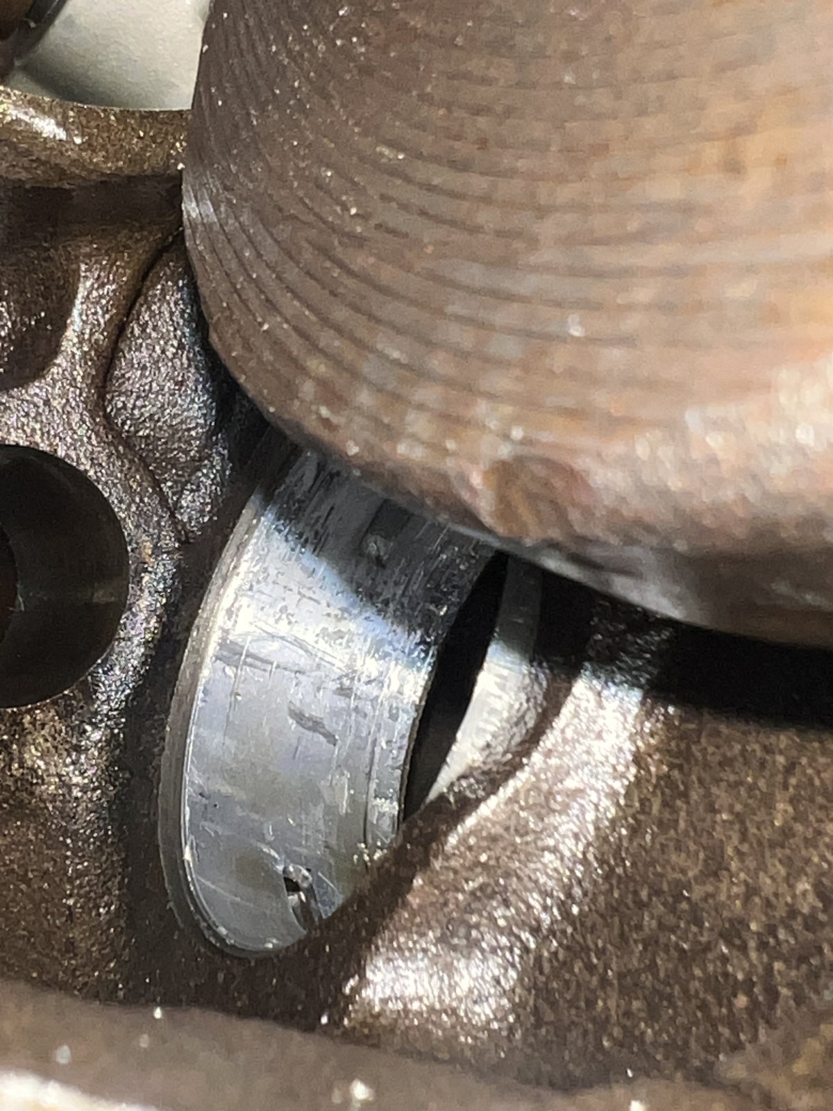

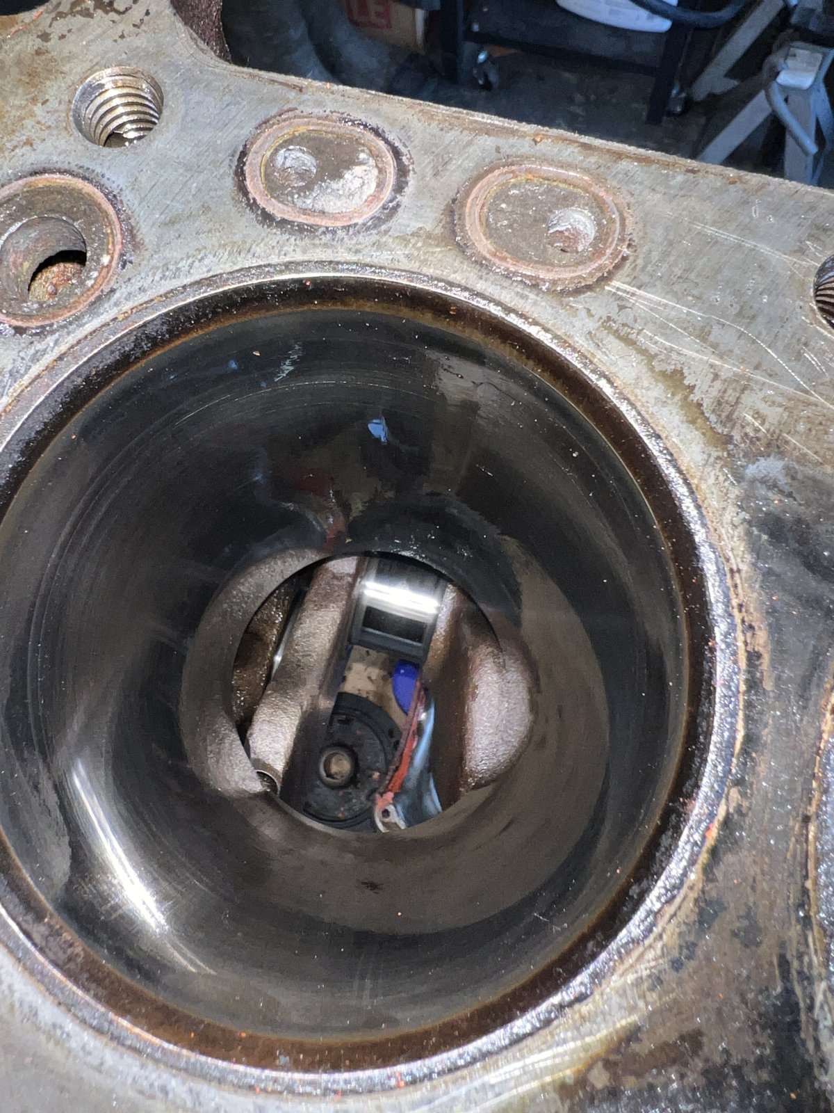

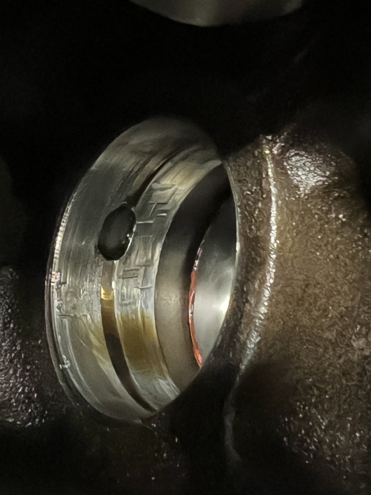

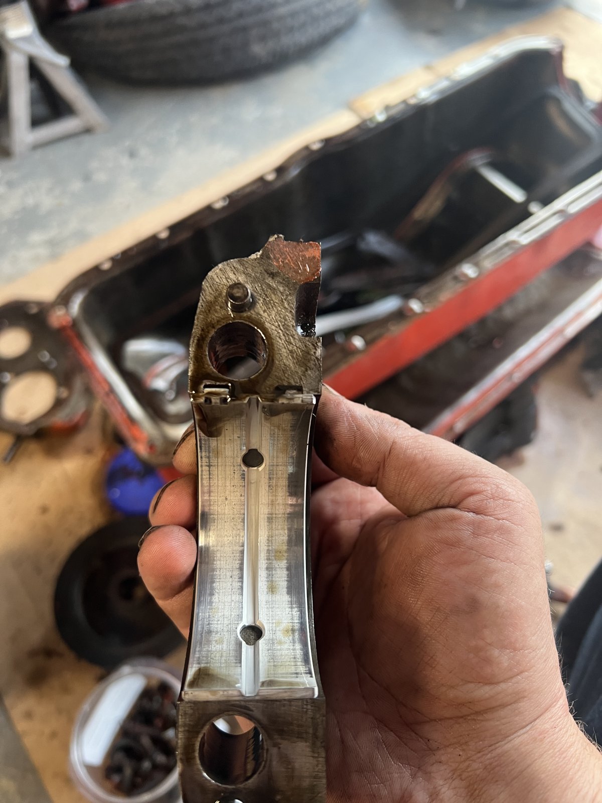

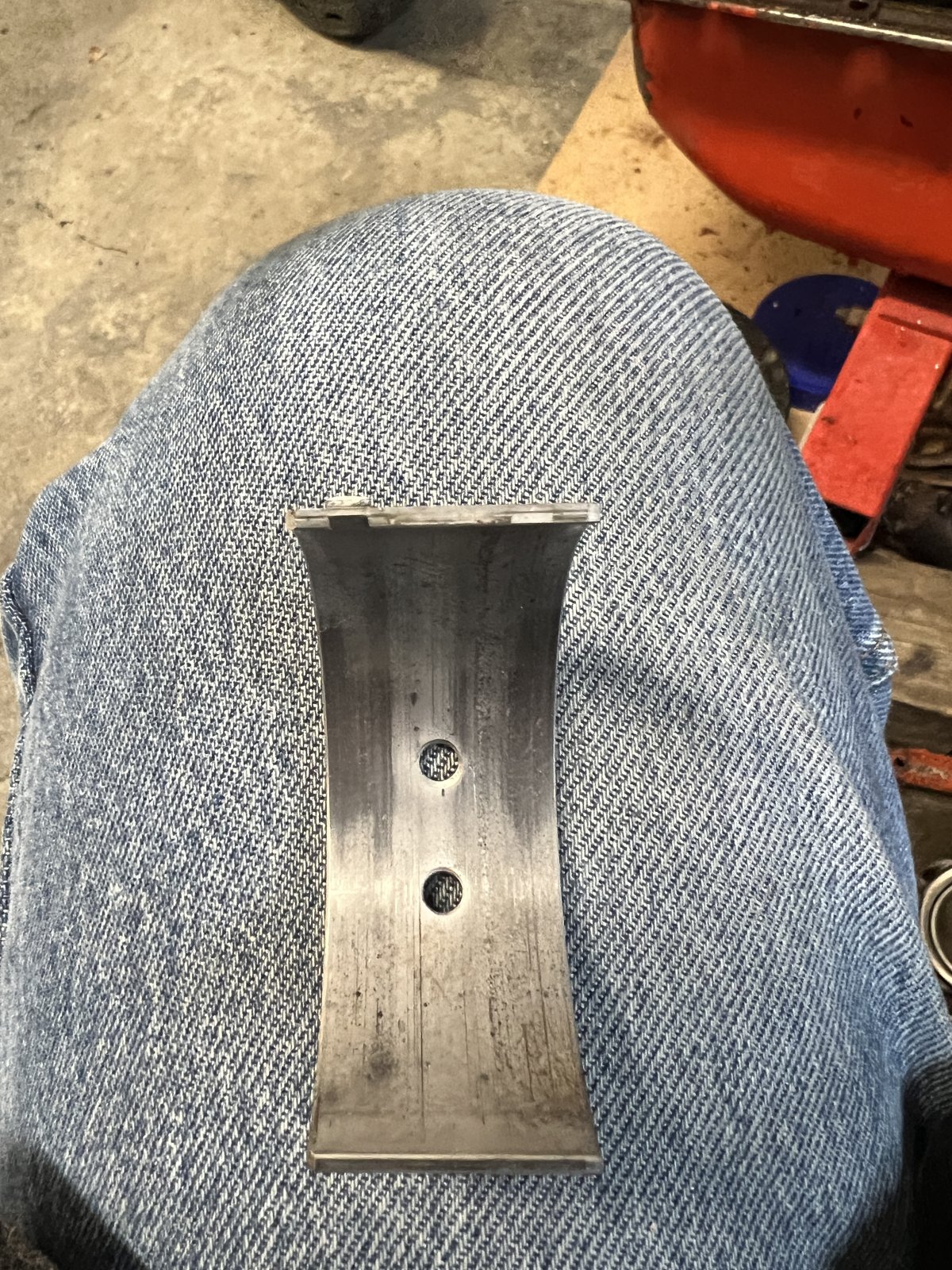

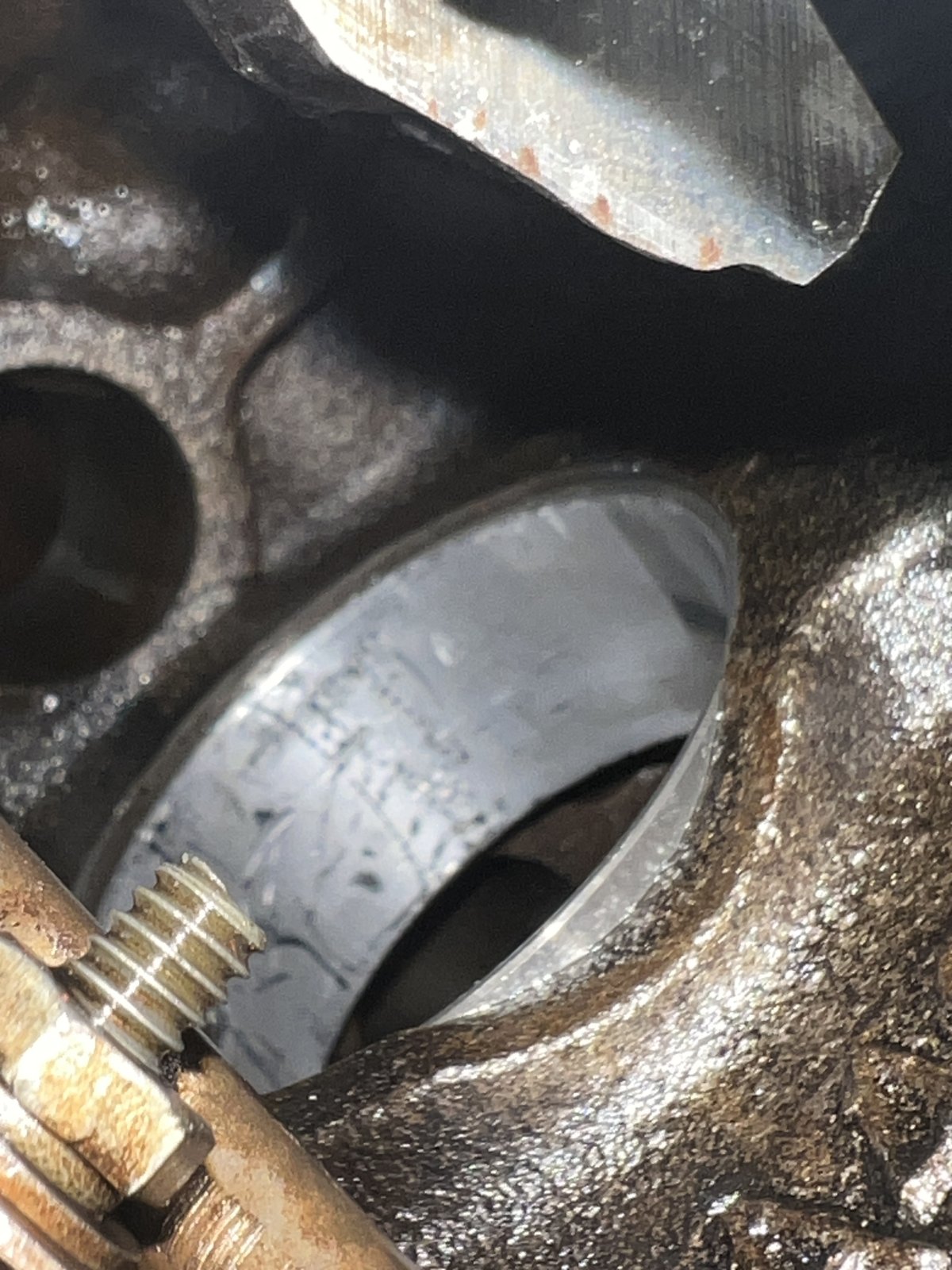

    Well a bit of a disheartening turn tonight. I got my Best Gasket kit in the mail, so I figured id finish getting the block ready. Needed to pull the cam so i could replace the gasket behind the timing plate. Started off finding no gasket behind the retainer and thats when things went south. After carefully removing the cam i noted some unusual wear on the rear most bearing surface on the cam. Fingernail test failed. Looked at the bearing and it looks like someone beat it with a screwdriver. Went up the line to the front and yep all pretty effed up. My gut tuned over. Grabbed the ratchet and popped a rod cap. Crud. Block is a D Block so it has standard mains and rod bearings and it has 10 under bearings and my guess was the crank wasnt turned. Im borrowing a micrometer tomorrow to verify. Put that back on and pulled a main even worse. 10 under bearings as well and scored badly. So off with the head. And by now I wanted to cry. Recessed valves to start, had a decent gasket on it though copper rings around every water and oil passage. But the one cylinder i saw in the borescope is really bad and very etched. Someone added their own oddball stampings to the piston and block on the deck as well.
    At this point i have zero idea what i am going to do. Have to motors that meed rebuilt and seems like Egge is about the only company with parts and no oversized pistons.
    Enjoy the carnage photos.
    :(:mad::(:mad:
    #2 bottom end rod bearing
    Rear most Cam Bearing
    Second to last cam bearing
    Second Front Bearing
    Front Bearing
    Rear Cam Bearing Surface

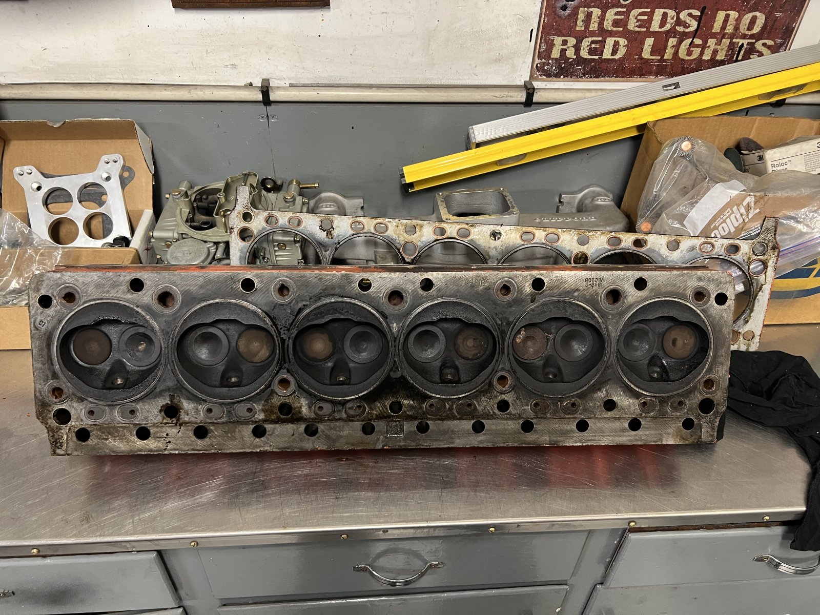

    Head with questionable valves

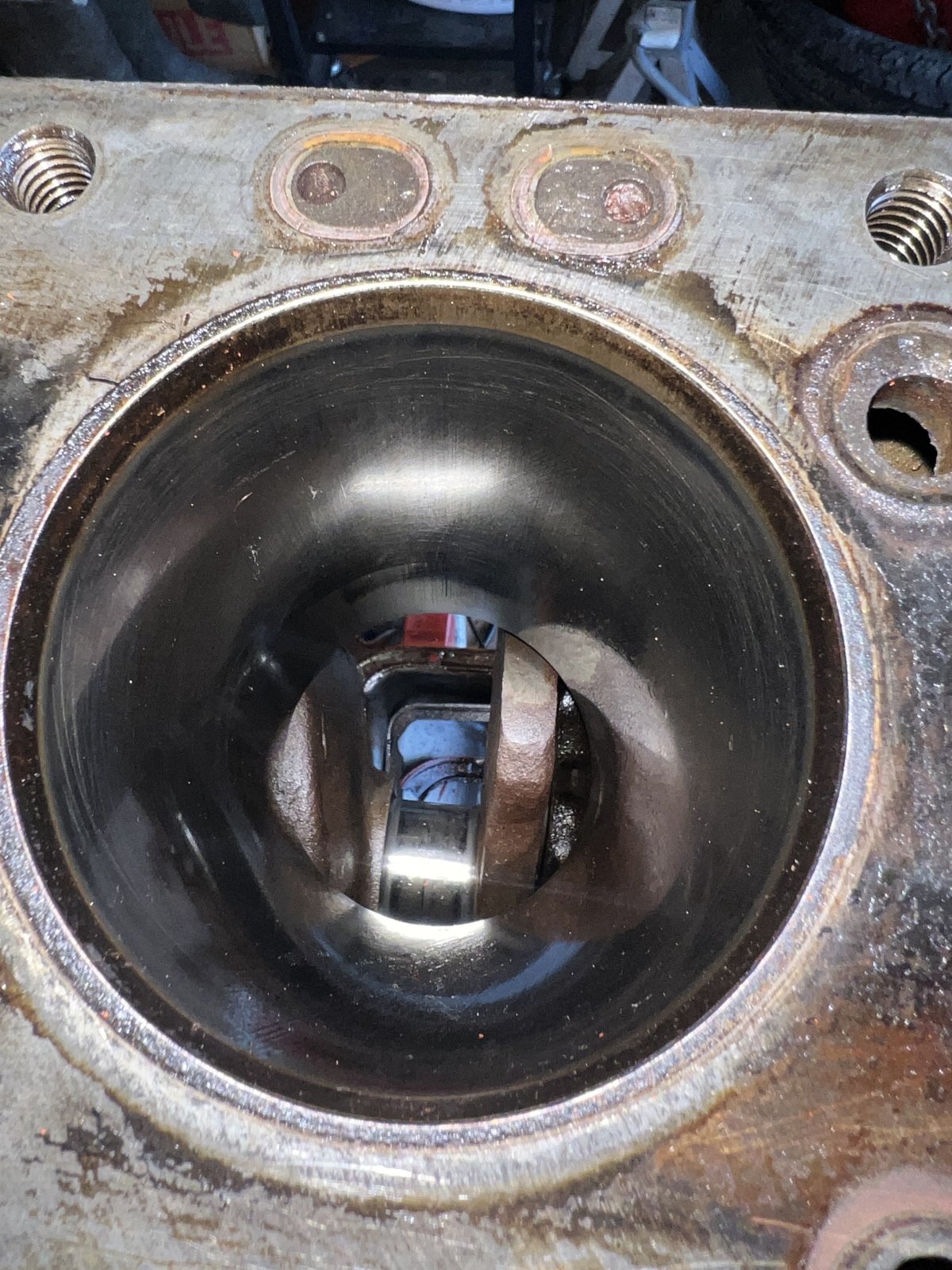

    #5 hole with deep etching
    Block
    #2 main cap bearing and crank
    specs
    sigh, some nights you win and some nights you crash and burn. Should of checked this motor more before spending $2500 on everything I’ve accumulated including the transmission.
  6. I'd assemble it and run it while looking for a replacement. You said you drove the wrecker it came out of and it seemed fine.... Let it fly.

    I might have to do that. At a minimum new cam bearings. Just sad as this one was suppose to be a low mile rebuilt motor. Now im glad we pulled it from the truck i got it from as it would not of lasted long at all in a 2 ton truck. Now i have 2 motors on the floor in pieces. Lol. Odds of finding another 270 or 302 in good shape is slim to none. May find a 250 from a Nova but then none of my parts fit.
    No clue where im heading with it now. All the money ive invested so far.

    Dawned on me looking at the pics on my big screen. They drove the cam bearings in with a screwdriver. Rolled edges, sideways strikes. So all that trash went thru the motor and wiped it out. Ill have to cut open the oil filter.

    The plan now is to finish tearing it down, hot tank the block, inspect it, and at a minimum get all new bearings. Polish the crank and hope it stays in spec as i seem to only find 10 under bearings nothing more. But i have the complete 248 and another small chamber head and another cam and crank outside of thr 270 and 248 blocks. Hopefully make one complete good motor out of all the parts. Still gonna sting. This was supposed to be a low mile motor. The previous owner drove it back from Oregon this way or it happened along the way. Hard to see in pics but the oil filter is very sparkly. :(

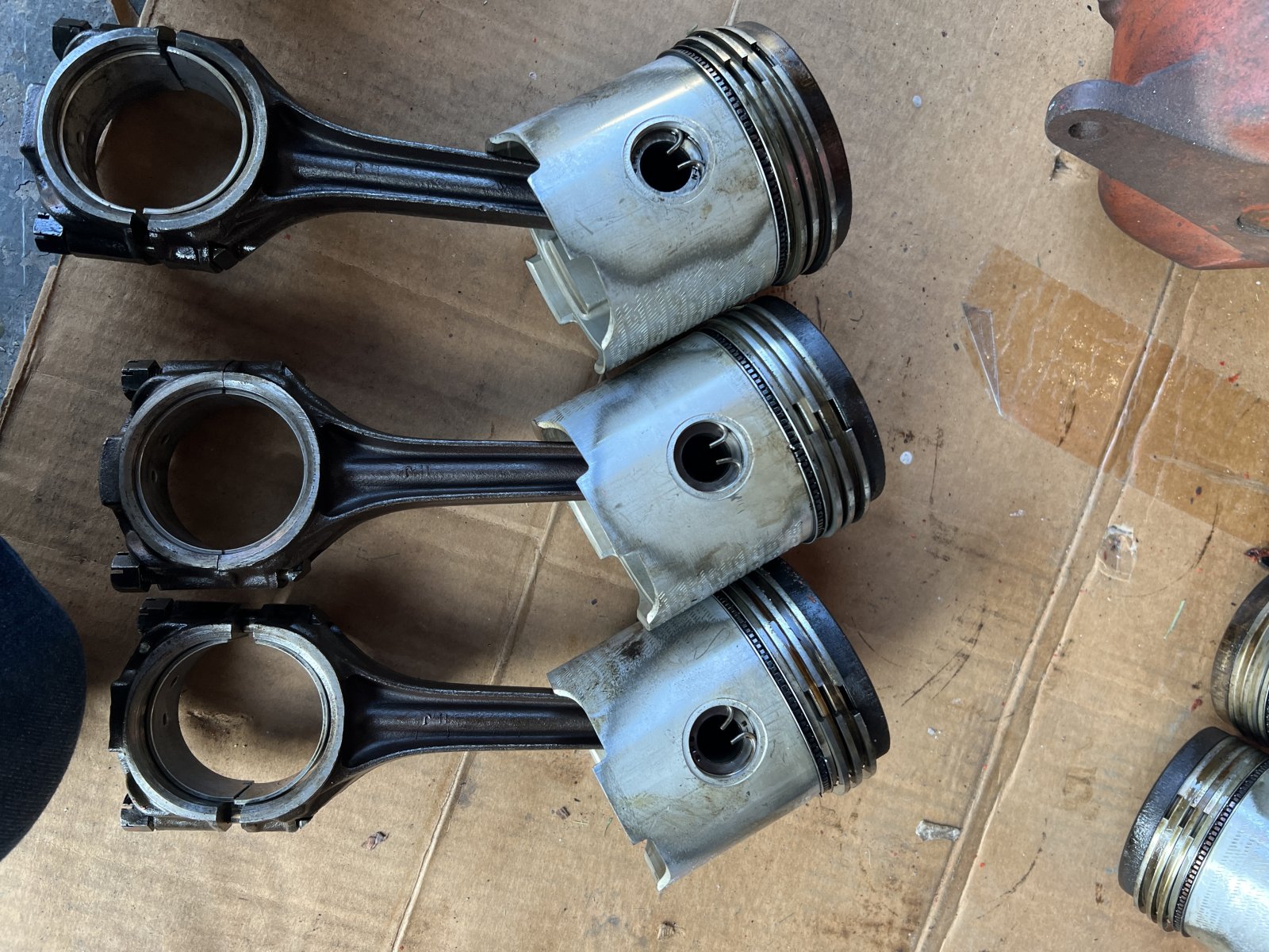

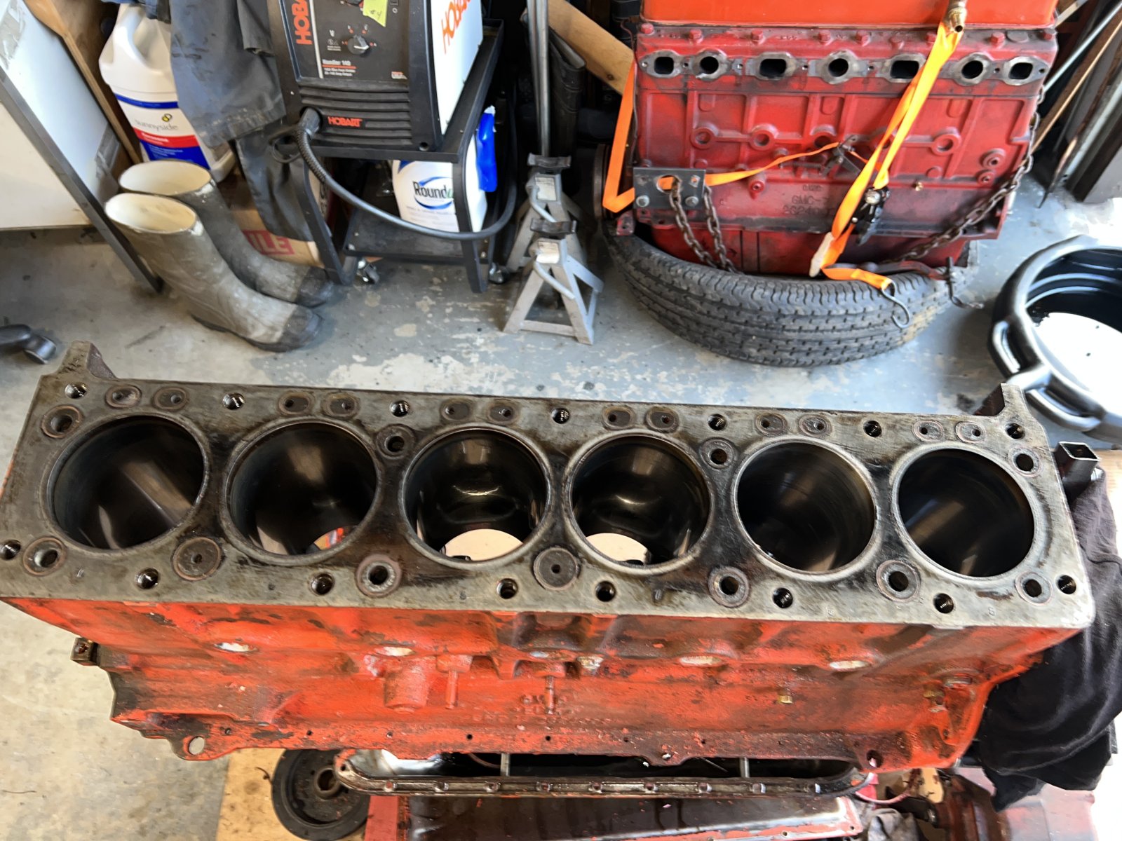

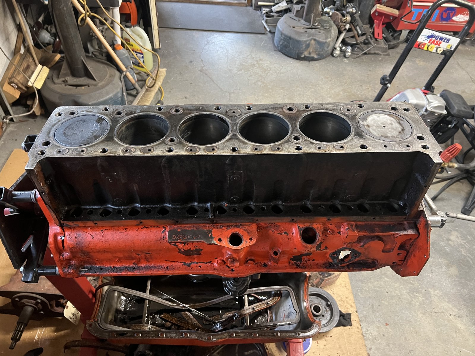

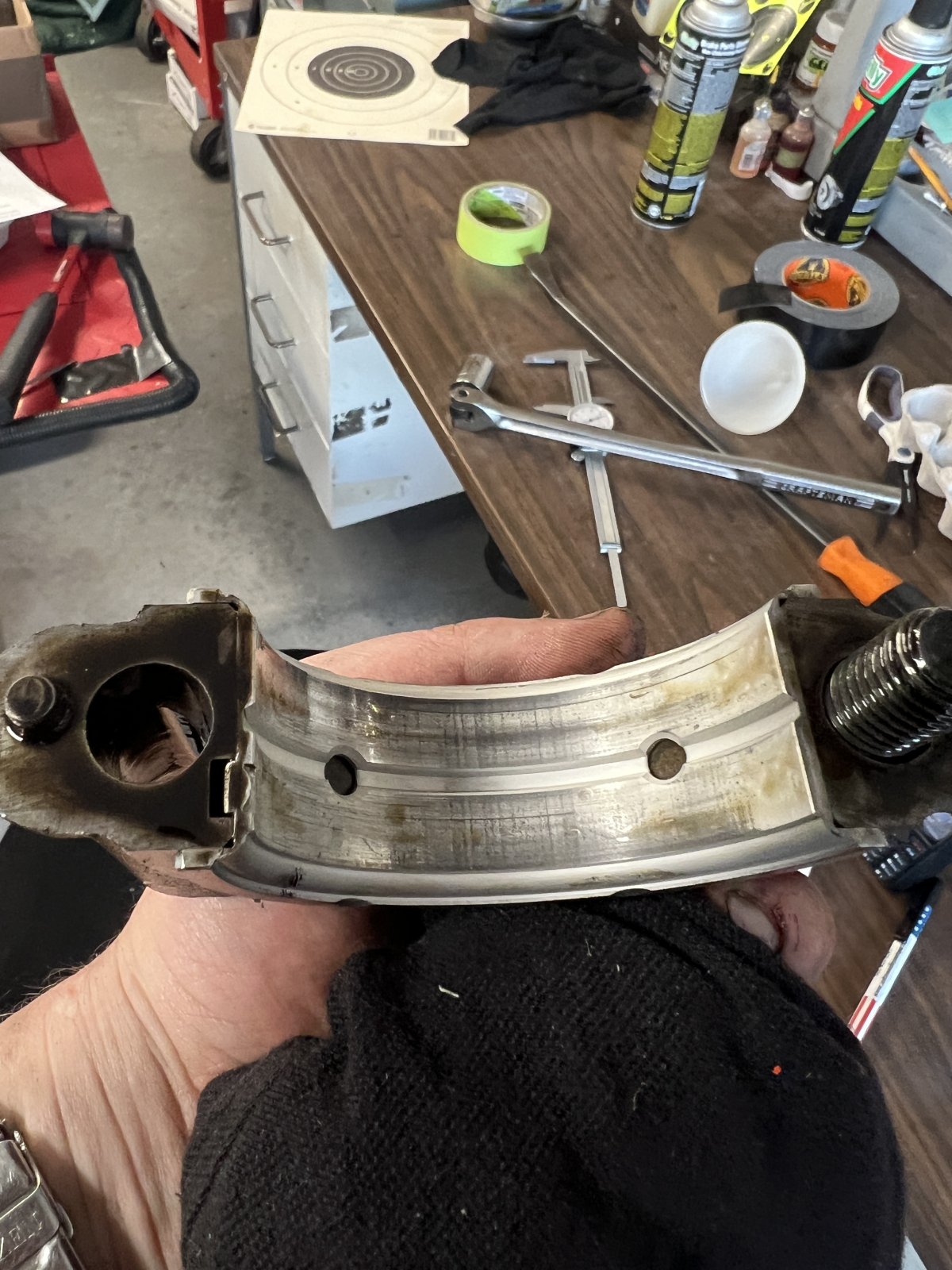

    Tonights carnage. #5 hole is definitely the worst. Tried some grey scotch brite pad and oil and didnt touch it. Red pad didnt touch it either.
    All the rod journals are .006-.010 out of round measuring right at 2.300”+/- .005.
    Mains i haven't measured yet because i cant see how to remove the oil pump from the block with the funky bolts holding it in.
    But all 6 piston compression rings were all lined up teo had the oil scraper rings also in line with the gaps of the compression rings.
    so enjoy the show! Lol time for a shot of Scotch for me.

    I've seen worse! Does look like new bearings, probably not a "clean" rebuild. Get the block honed and cleaned, new cam bearings, and put some cast rings in it. They'll straighten those bores up. Does northern auto parts not have a rering kit for it?

    I havent checked Northern Auto. My machinist wants to clean an inspect the block first. Has a fairly good ridge at the tops of the bores as well. If i can find them I wouldn’t mind punching it out a bit.
    Further inspection i doubt the head was touched when it was rebuilt. So thats on the list as well.

    Pistons are not normally Knurled from the factory right?
  19. Budget36
    Joined: Nov 29, 2014
    Posts: 15,037
    Budget36
    No.
    And also rings will move from where they started at, to where they end up at over time.

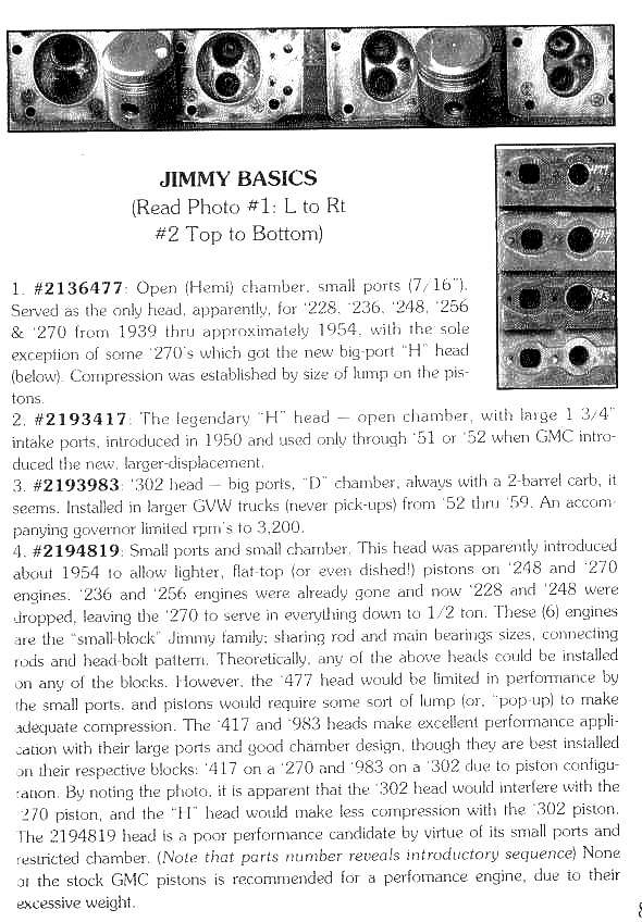

    Found a good casting number chart and gathered this info
    Using the ID chart i found an few issues?
    Block is a 2434003 55-63 270 with side motor mounts
    Head is 2194819 55 270
    Cam is 2193486 which i had to look elsewhere and is for a 228???
    Crank is 2342204 which is a 52-54 302?
    Rods are 2341204 late 302
    Pistons are 2341506 cant find info
    Spare crank 2194570-248
    Spare cam- 2193486- early 228
    So im guessing my supposedly low mile rebuild is a find anything and make it run rebuild.
    Gofannon likes this.
  27. Gofannon
    Joined: Feb 8, 2007
    Posts: 984
    Gofannon
    Cams should be iron? Easier to regrind. I just had a steel one done. Grind, nitride, straighten and polish. Head is the small chamber one.
