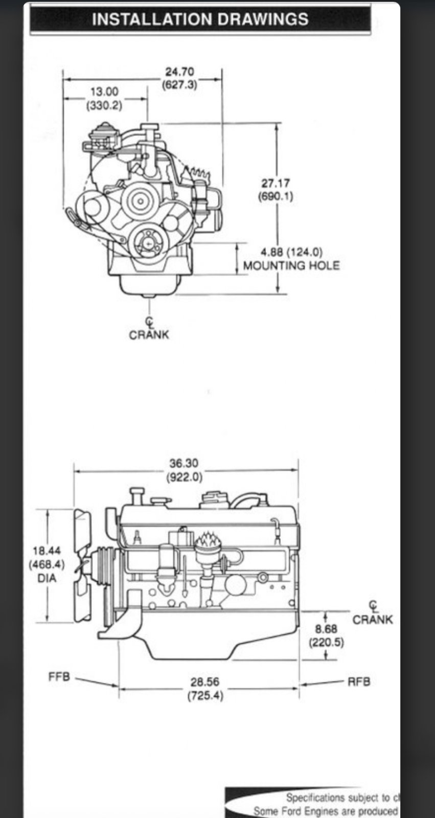

  10. The 300 Ford is the greatest light duty gasoline truck engine ever built. Period. Hands Down. I wouldn’t think twice about putting a 300 into anything.
  11. Littledeucecoupe
    Joined: Jan 30, 2011
    Posts: 158
    Littledeucecoupe
    I wonder if the T5 would take the torque from the 300. But talk about a way to really tee off a GMC Purist. Got my gears turning. Need to find measurements, figure motor mounts etc. lol
    Six Ball and anthony myrick like this.
  12. Look for an M5OD. They were used from 1987 to 1996 in millions of F-150’s.
    Littledeucecoupe likes this.
  13. Small block ford bell housing bolt pattern on the 300s
    Lots of transmission options

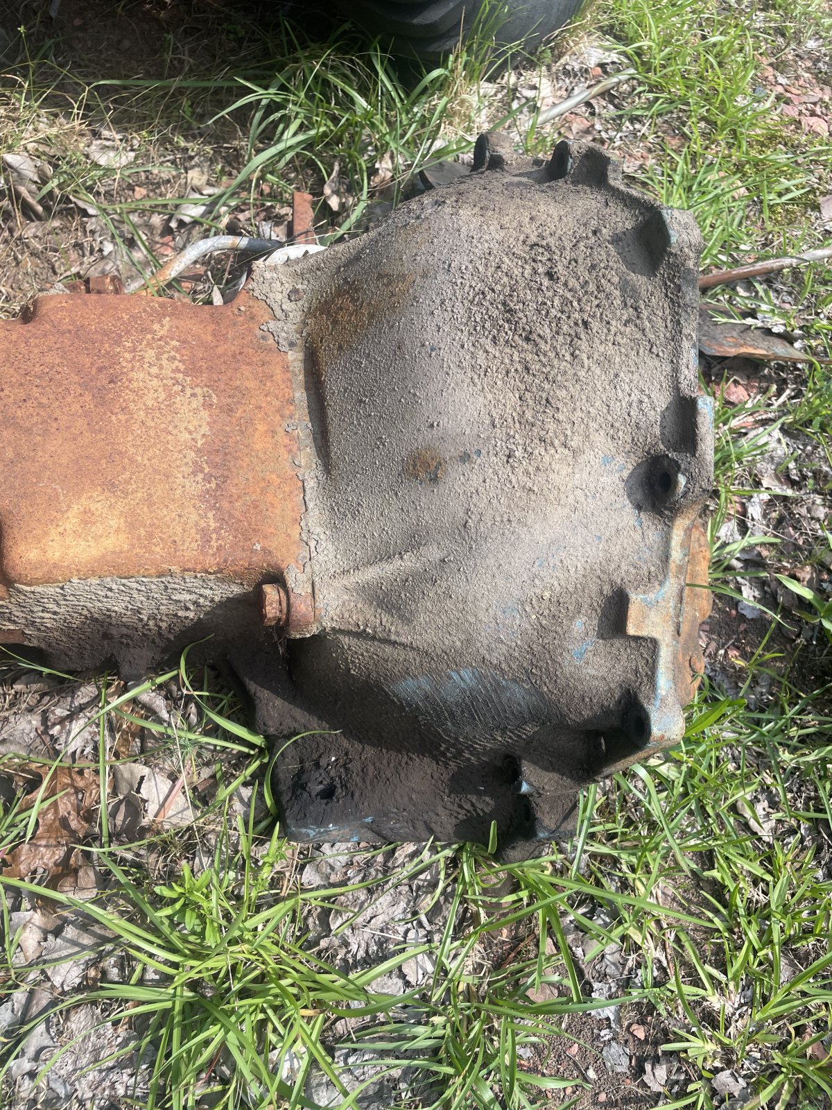

  20. If ya did decide to look at a 230-292 Chevy 6 you can use a 72 down truck bell
    Should bolt up in place of the original gmc
  21. jimmy six
    Joined: Mar 21, 2006
    Posts: 18,034
    jimmy six
    I didn’t know the trucks had the side mounts on the bellhousings to sit on the crossmember.
    this one came from a 64 c10 with a 230/250.
    I think this style made it to the early 70s
  23. That is the same bellhousing I have for our 230/SM326 swap into our 1950 3100. Are the GMC bellhousing crossmembers and Chevy bellhousing crossmembers similar?
  24. I think so. Both the frames I have are GMC
    My 1949 gmc had a 59 235 and 64 ish Saginaw 3 speed
  25. That is great news, thank you Anthony!!
