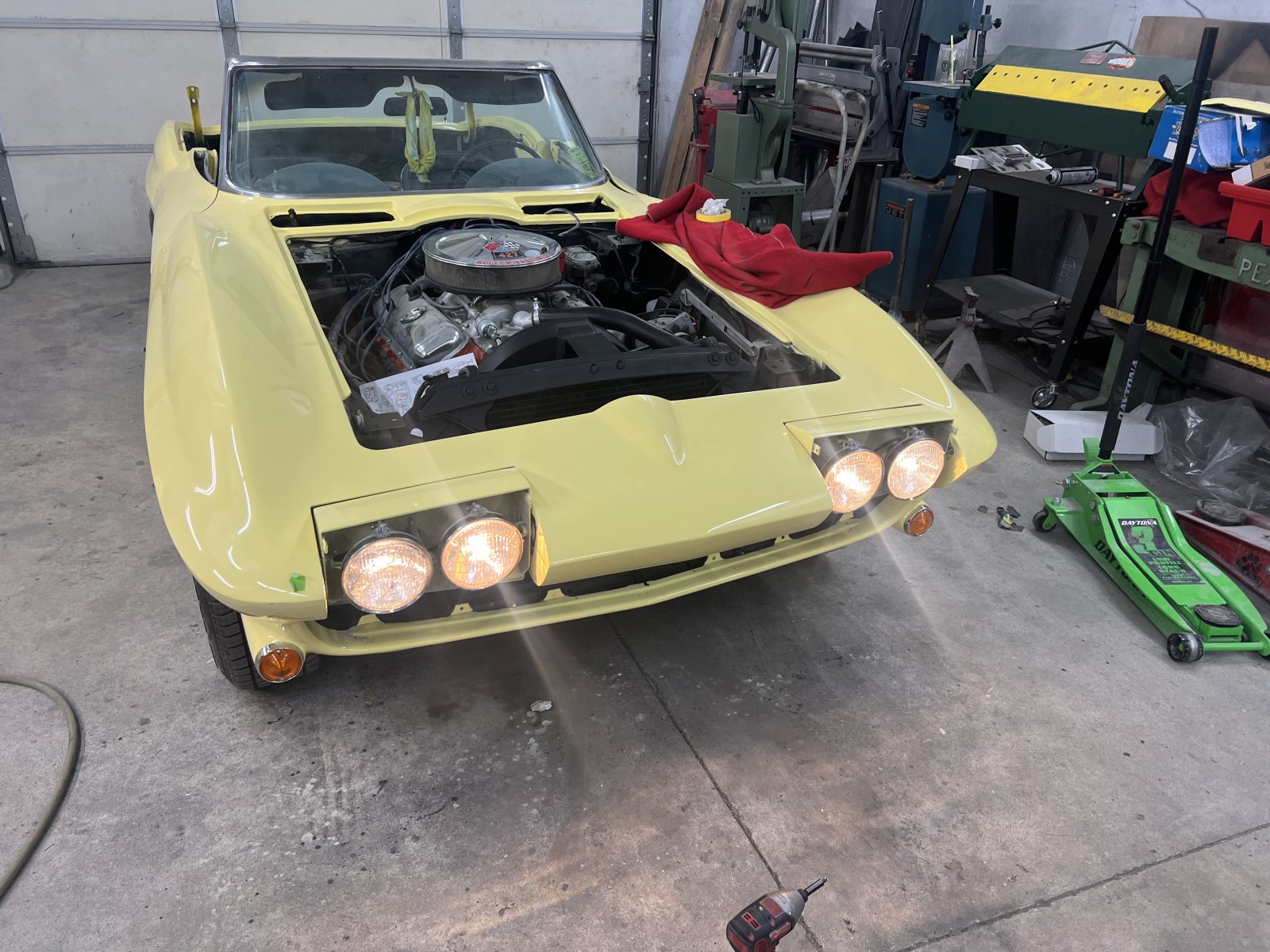

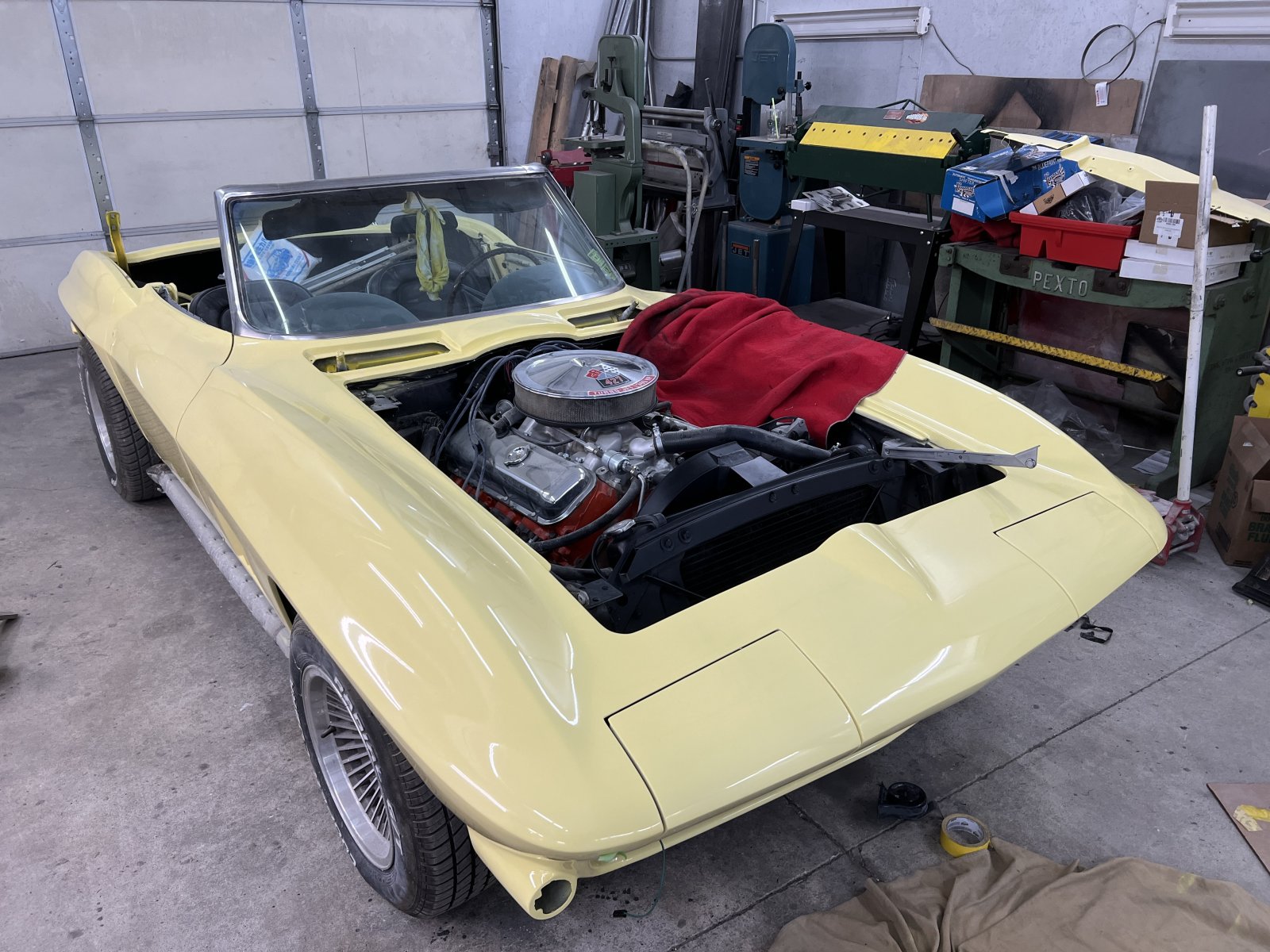

    Put a new wiring harness in this beauty and blew the ballast resistor, voltage regulator and probably smoked the alternator. And it was a GM Certified harness. Back tonight when i can have peace and quiet. Lo

    Got the Vette sorted. Voltage regulator contacts were welded. Dug and found another in the parts horde. Tested with it all issues solved.
