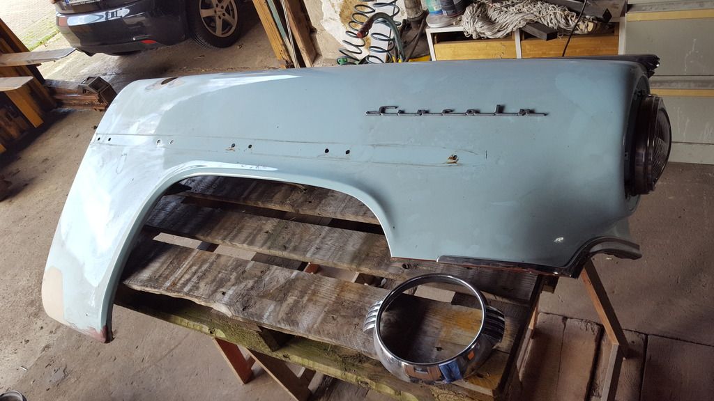

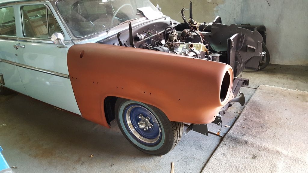

  2. derthor
    Joined: Oct 17, 2010
    Posts: 74
    derthor
    from Germany
    color stripped the fenders and closed the holes
    Ranchero59 likes this.

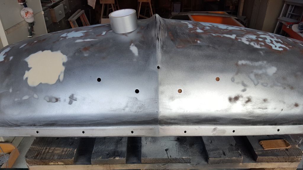

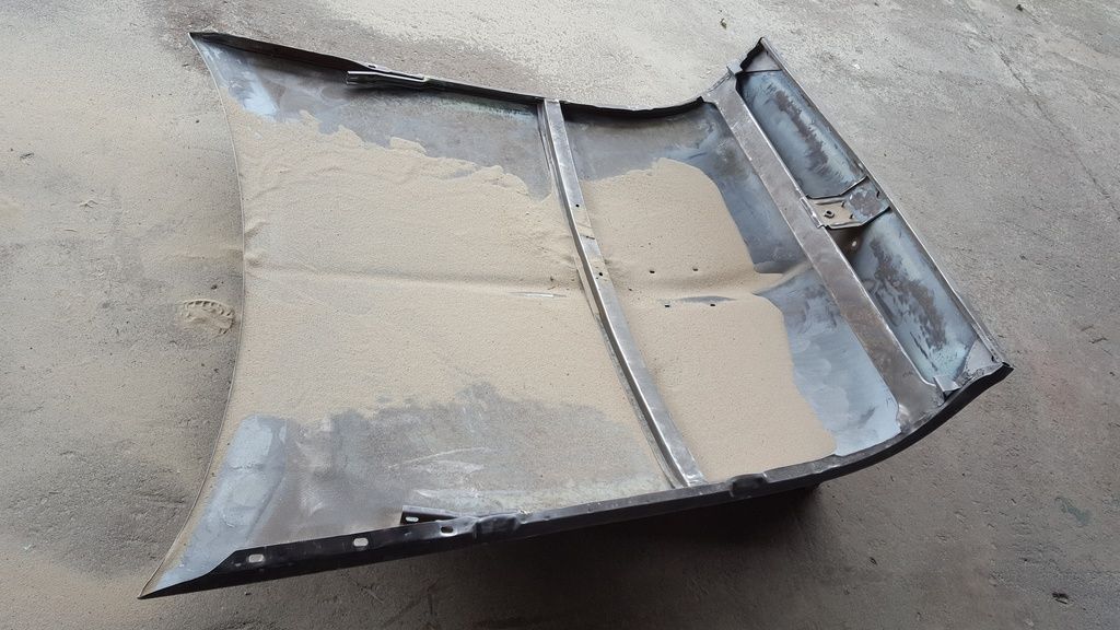

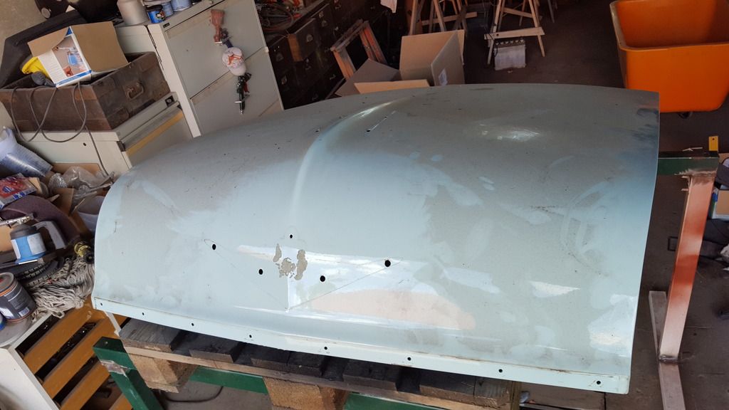

  3. derthor
    Posts: 74
    derthor
    from Germany
    same job for the hood, but there was a little bit to much paint .....7or8 layers of paint
    sandblasted and painted the inside
    Ranchero59 and chryslerfan55 like this.

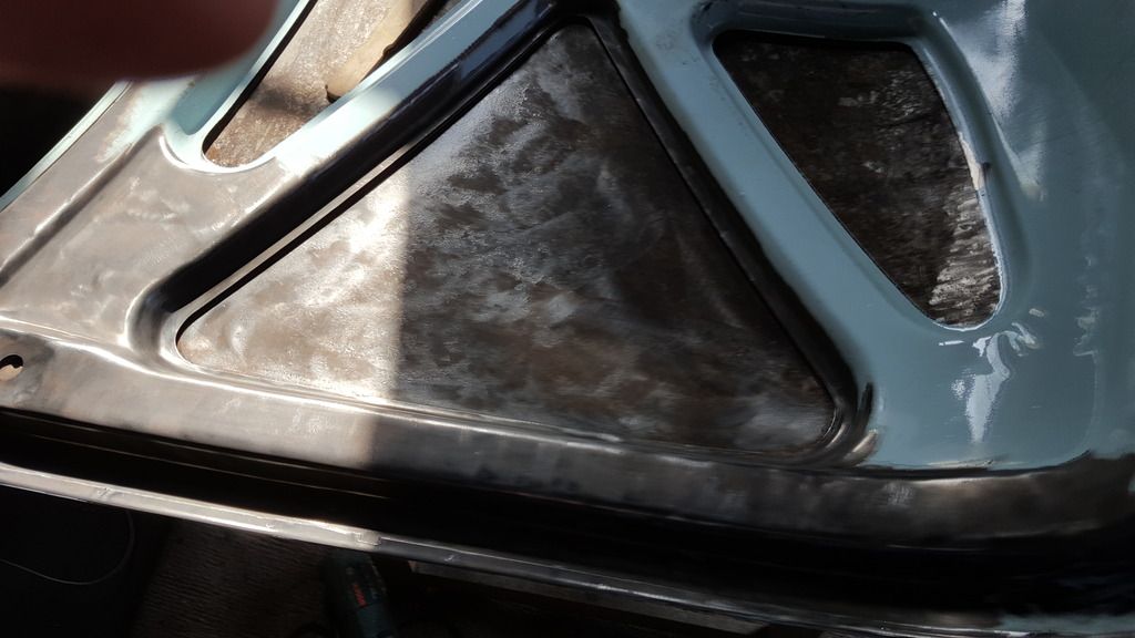

  4. derthor
    Posts: 74
    derthor
    from Germany

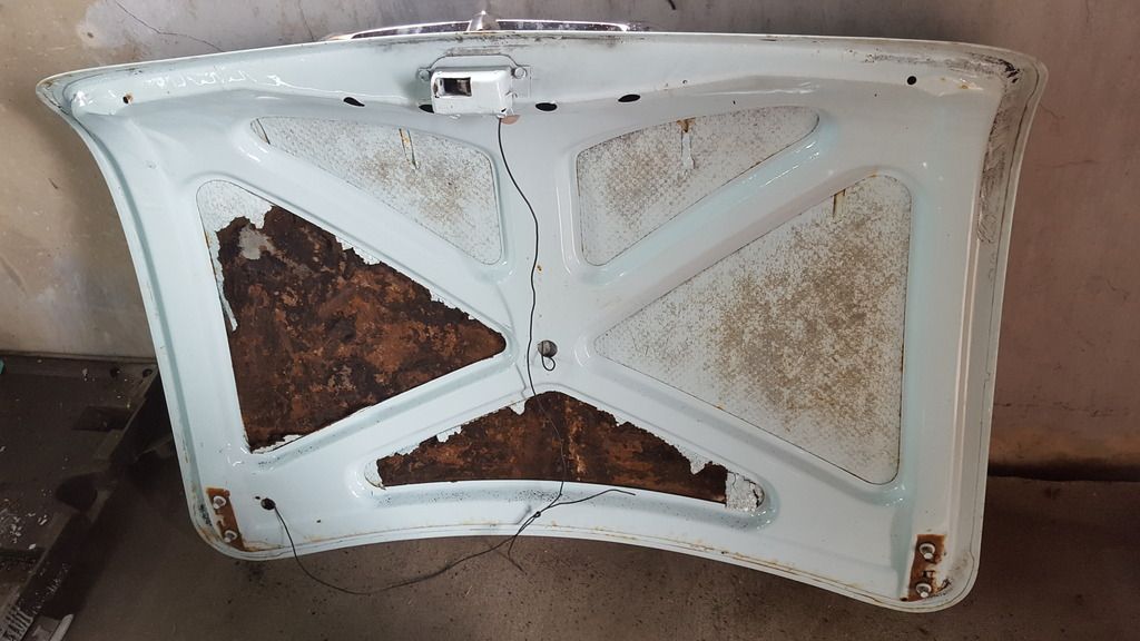

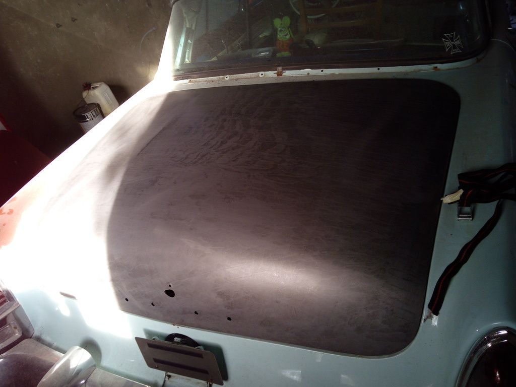

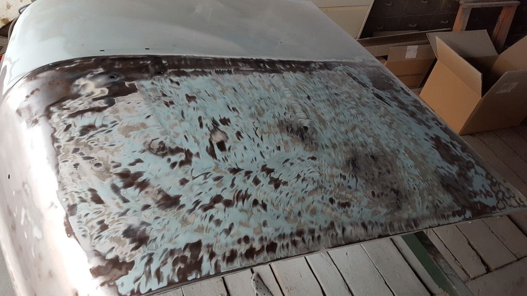

  10. derthor
    Posts: 74
    derthor
    from Germany
    next step paint stripping the trunk hood, but the first view looked very bad. After putting away the anti drumming parts I saw a lot of rust. I started paintstripping by myself with the angle grinder and a wire brush, but than I decided to put a little bit money in the hands an give the trunk hood to a company for chemical paint stripping.
    after the hood was rust free and bare metal it has been ktl coated
    brEad, Ranchero59 and kidcampbell71 like this.

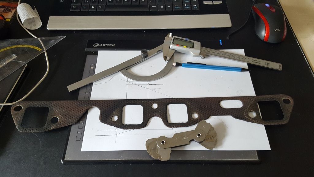

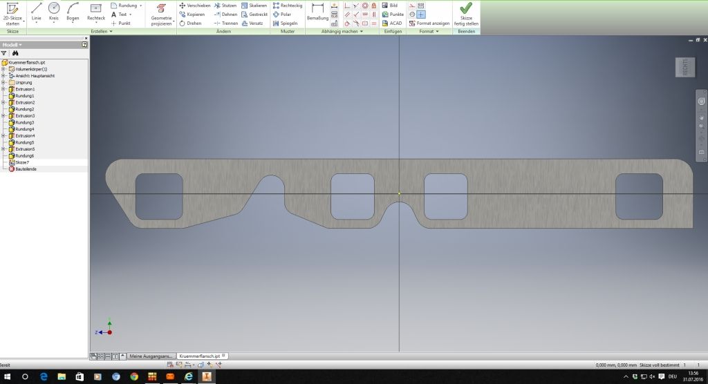

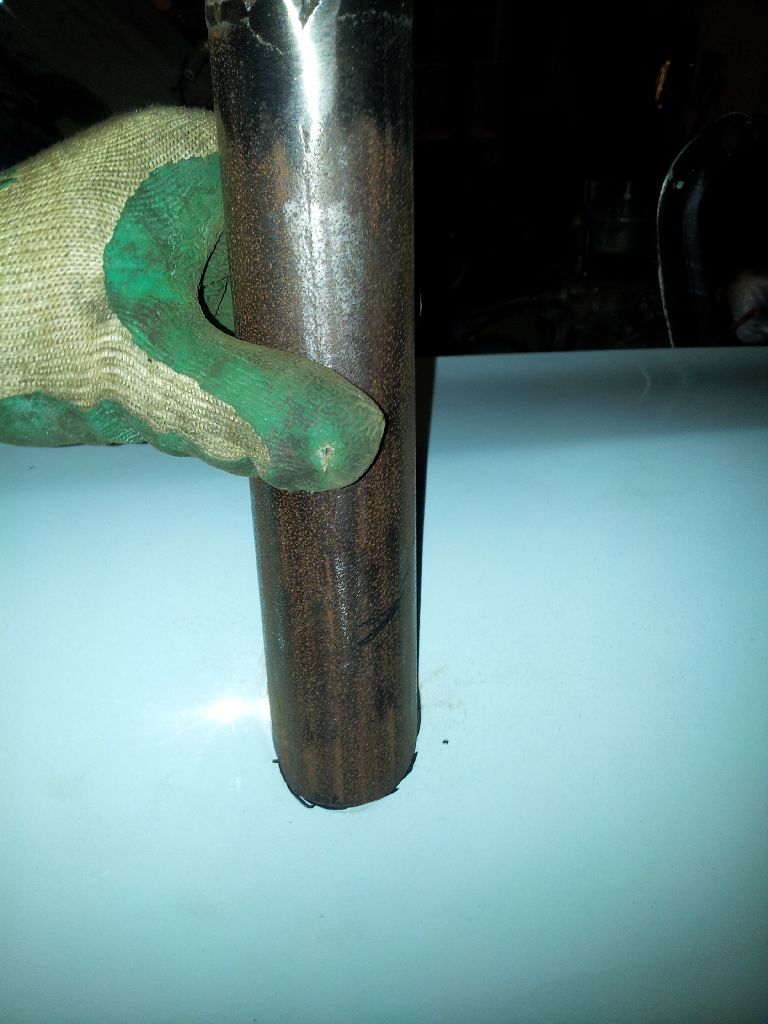

  11. derthor
    Posts: 74
    derthor
    from Germany
    two steps forward and one step back.......the exhaust system is not the best issue and so I decided to go an other way. Inspired by the thread about the 54 Ford Crazy legs https://www.jalopyjournal.com/forum/threads/crazy-legs-my-54-ford-build-thread-old-custom.709542/ I got the idea to a new steering system for the old lady. That will give me the chance to build a 2 way exhaust system. Let´s take a look if the little voices in my head are wright :D
    first step to build a new exhaust system...remove the old one and for measuring and draw new flanges in 3D
    and the new steering rack arrived....Chevrolet Beretta. I hope it will work and fit
