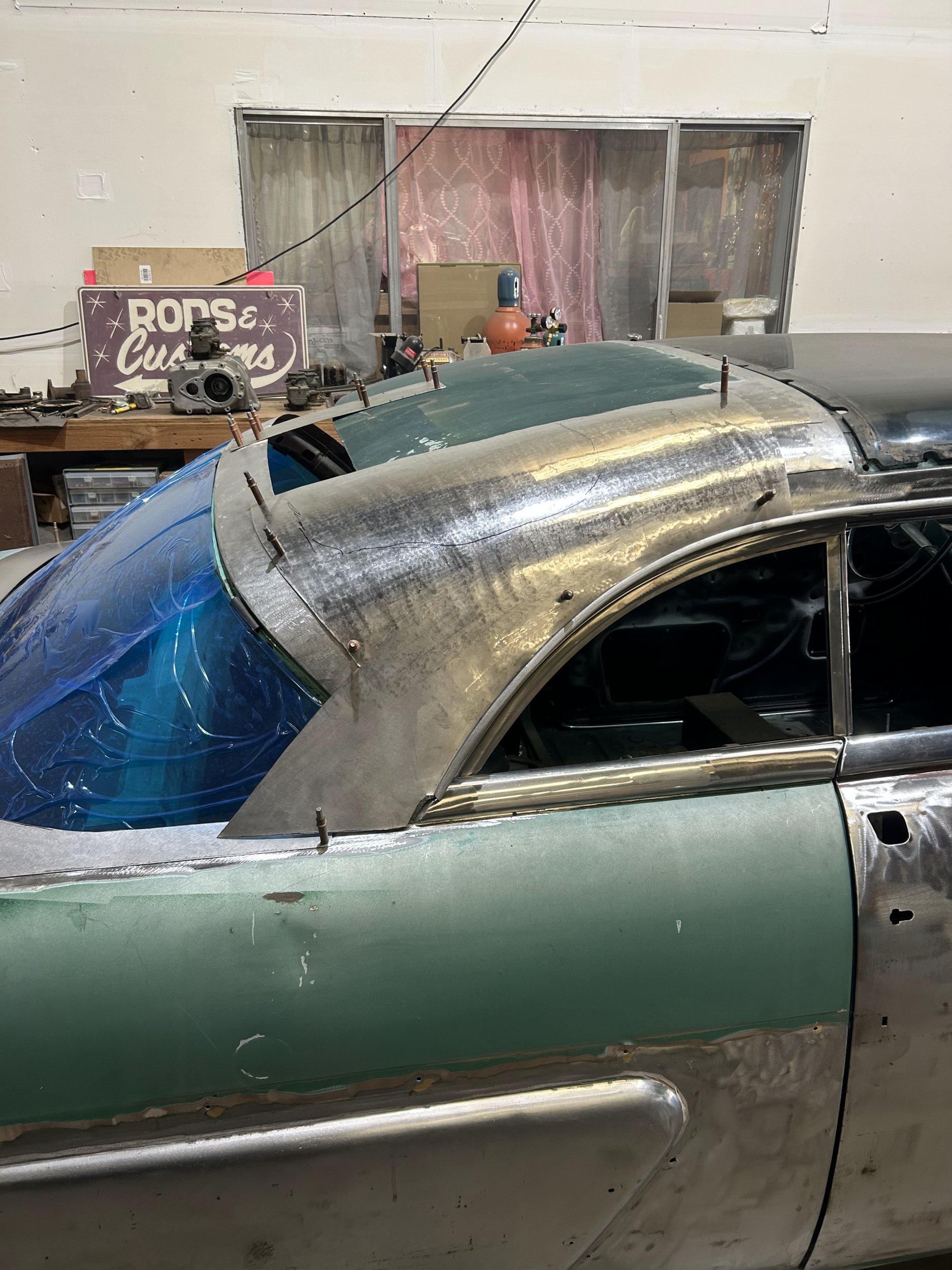

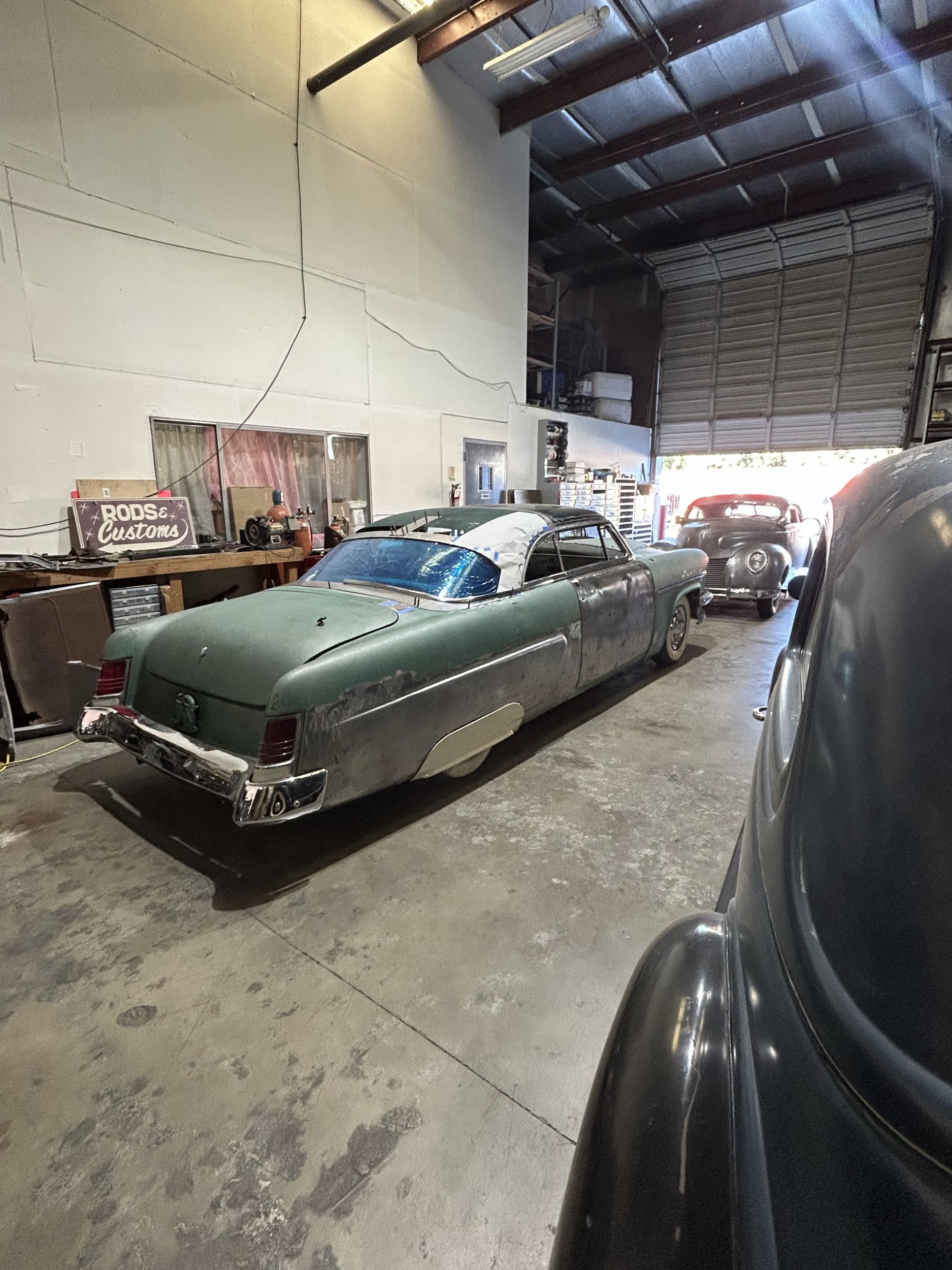

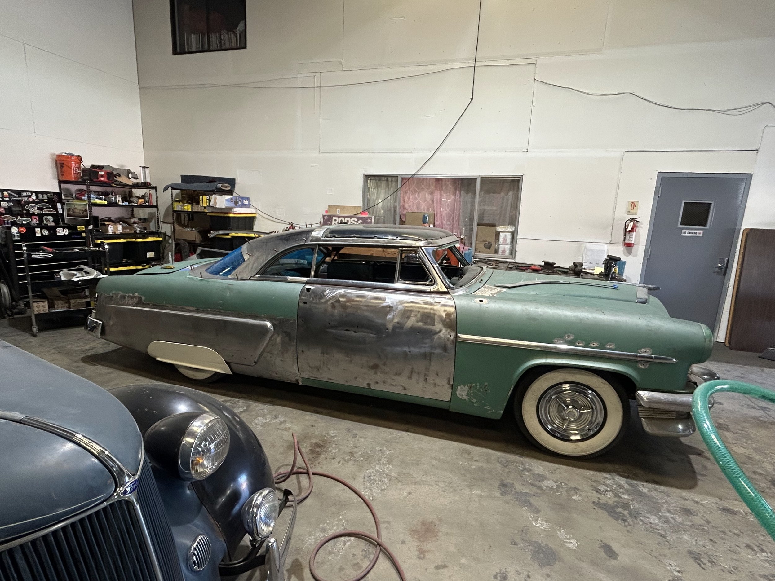

    IMG_20251021_134657(1).jpg IMG_20251021_134657 (1)(1).jpg IMG_20251020_164423(1).jpg
    he started on the sail panels yesterday. I think it is turning out better then I could have hoped.
