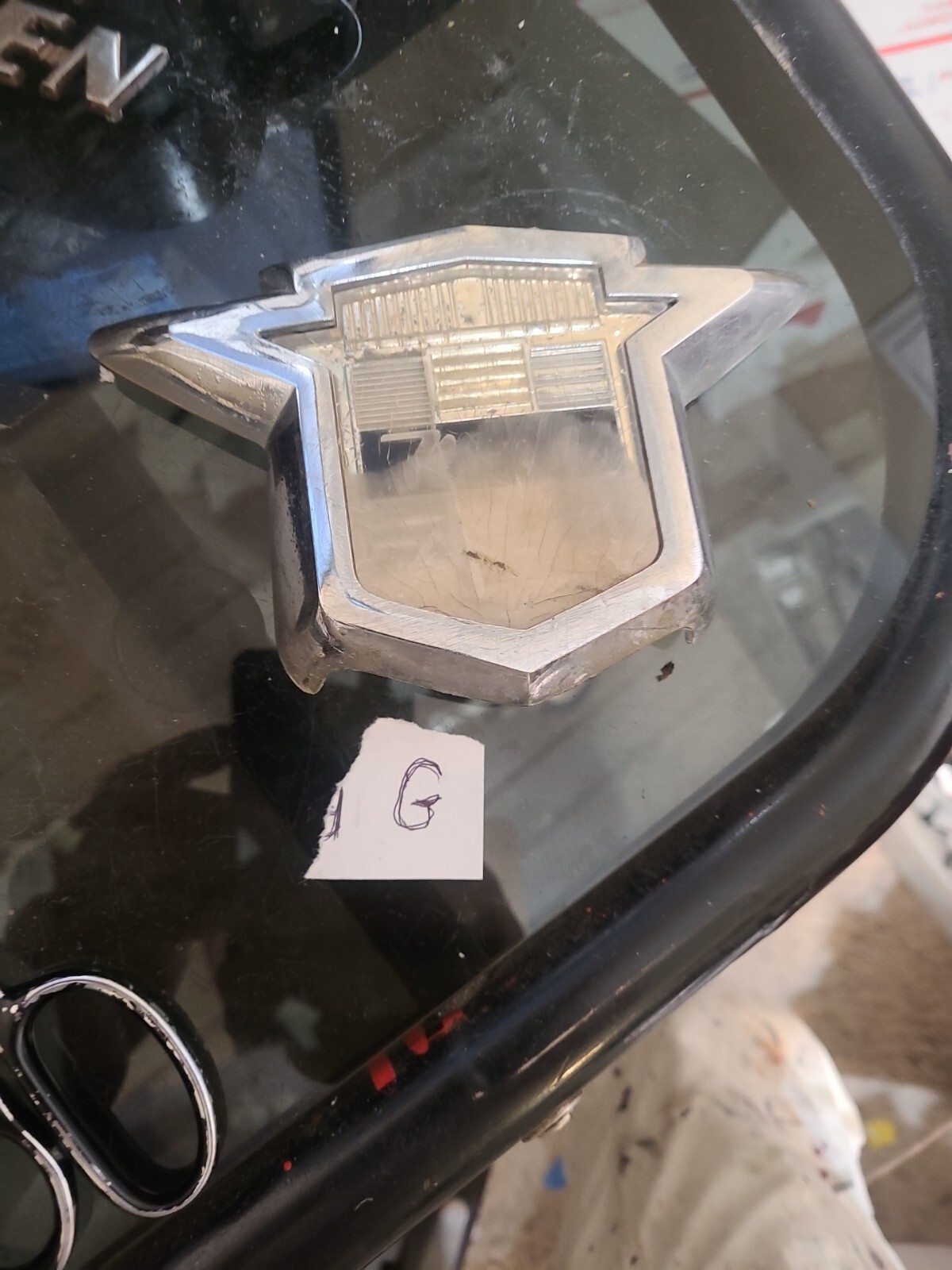

    I also bought this kinda rough emblem to use on the grille. It was very foggy on the bottom and had a bunch of crazing on it, I wetsanded the plastic face to get the fog off and polished it, then covered it in Vaseline for a couple weeks. The Vaseline soaks into the crazing and fills them in, works really well. It came out great, but I mocked it up on the car and I like it better without. So not going to use it, but figured I'd show the before and after anyway.

    That emblem cleaned up amazingly well!

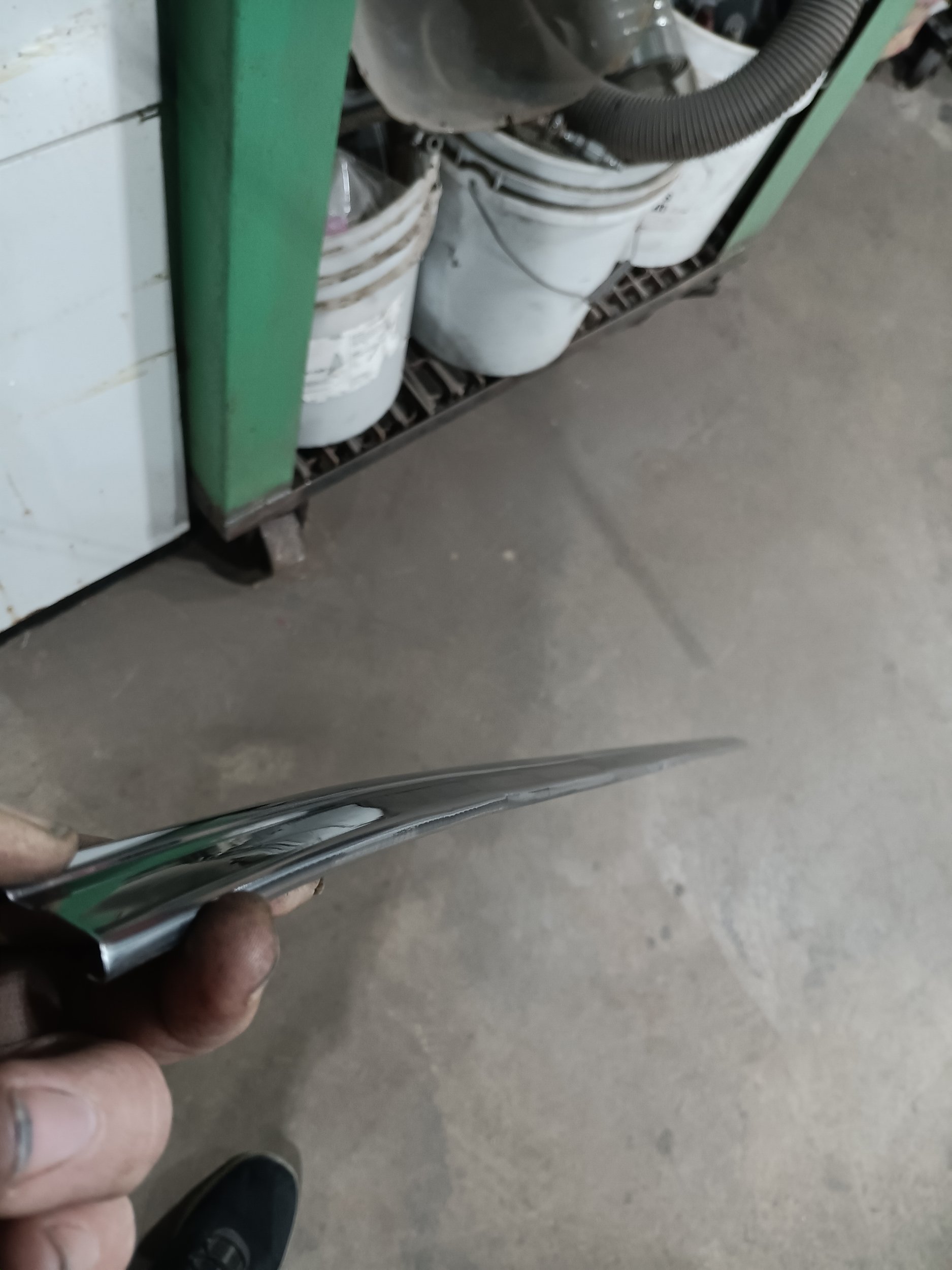

    I used .030 stainless MIG wire with regular 75/25 Argon/CO2 mix to weld up the holes, using a br*** backer bar on the front to try to limit how much weld I had to grind down on the face. It worked OK, although the Rambler moldings are paper thin. The screw hole welded up nice but the rivet hole took several tacks and got a little ugly. Then I ground them flush, did my best to sand them flat (it's hard to do inside that little groove) and then pounded on them with the buffing wheel.
    I also did my best to straighten out the bent/flattened part. I like to use one of those plastic shims that come in auto lock-out kits, it's nice for beating on stainless because it doesn't mar up the back side like metal tools can.
    It's still visible at certain angles but for this car, and a molding that's down low on the body, I'm really happy with it. With a bit more practice I think I could do even better, very pleased for a first attempt though.

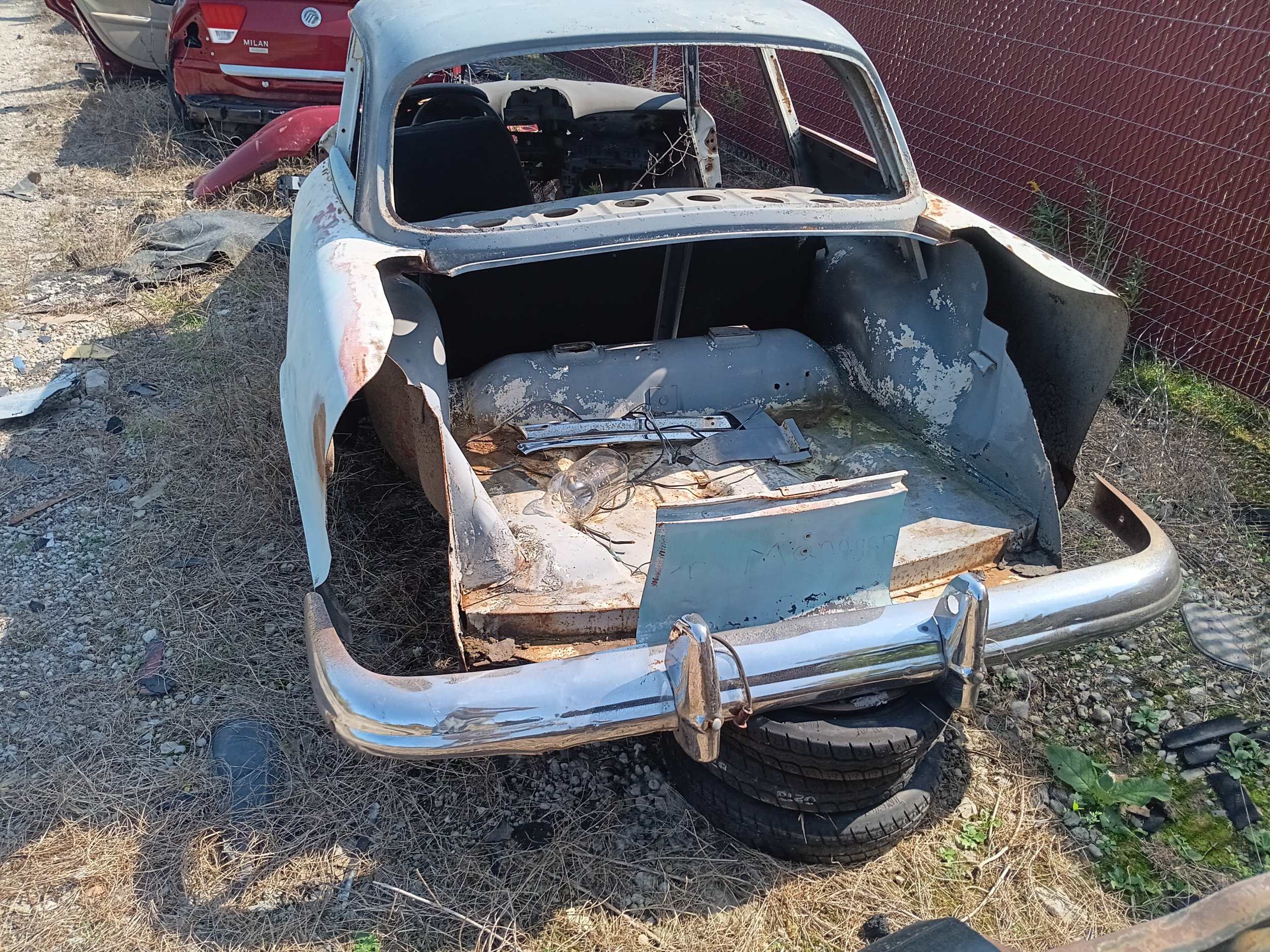

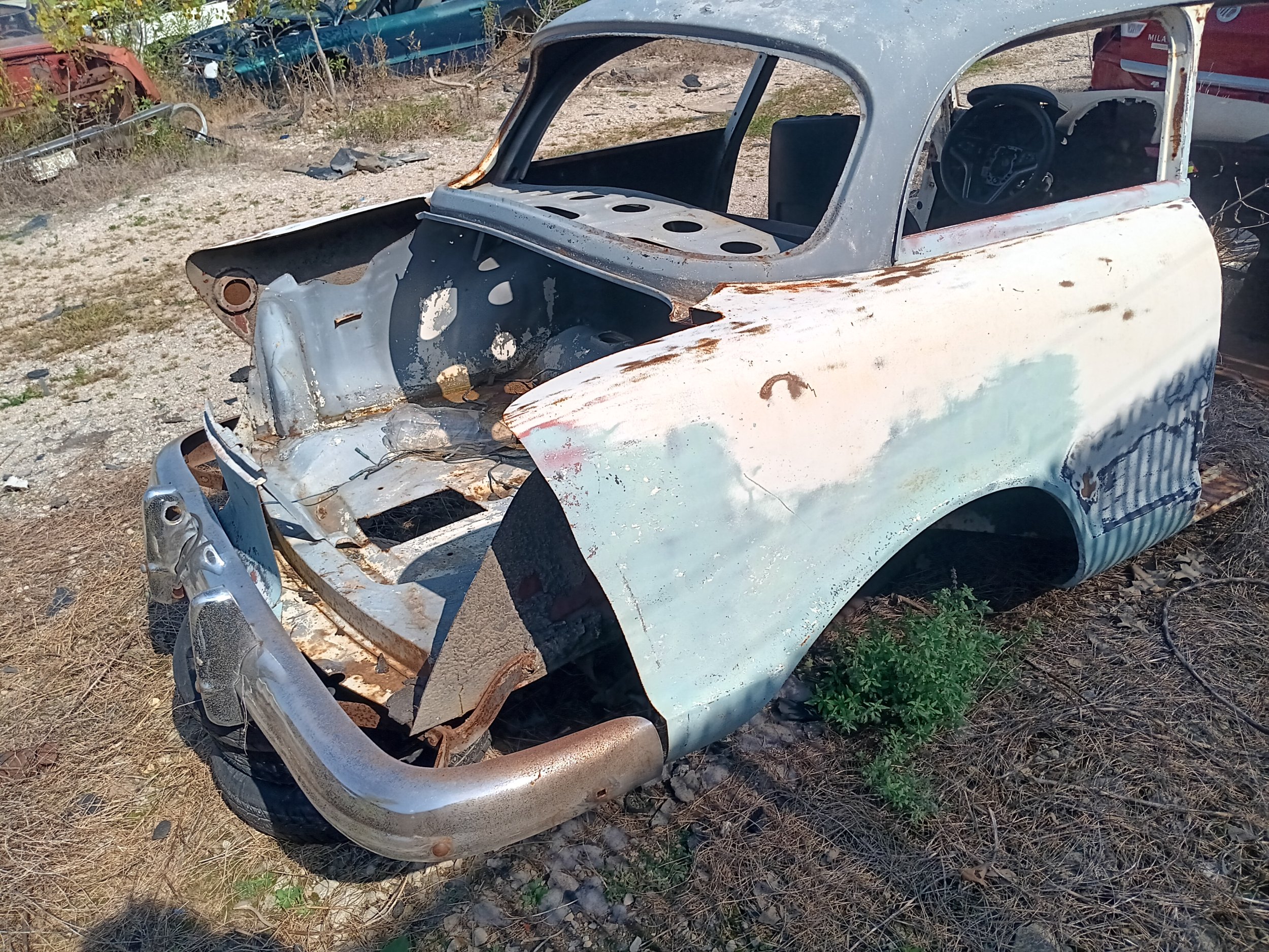

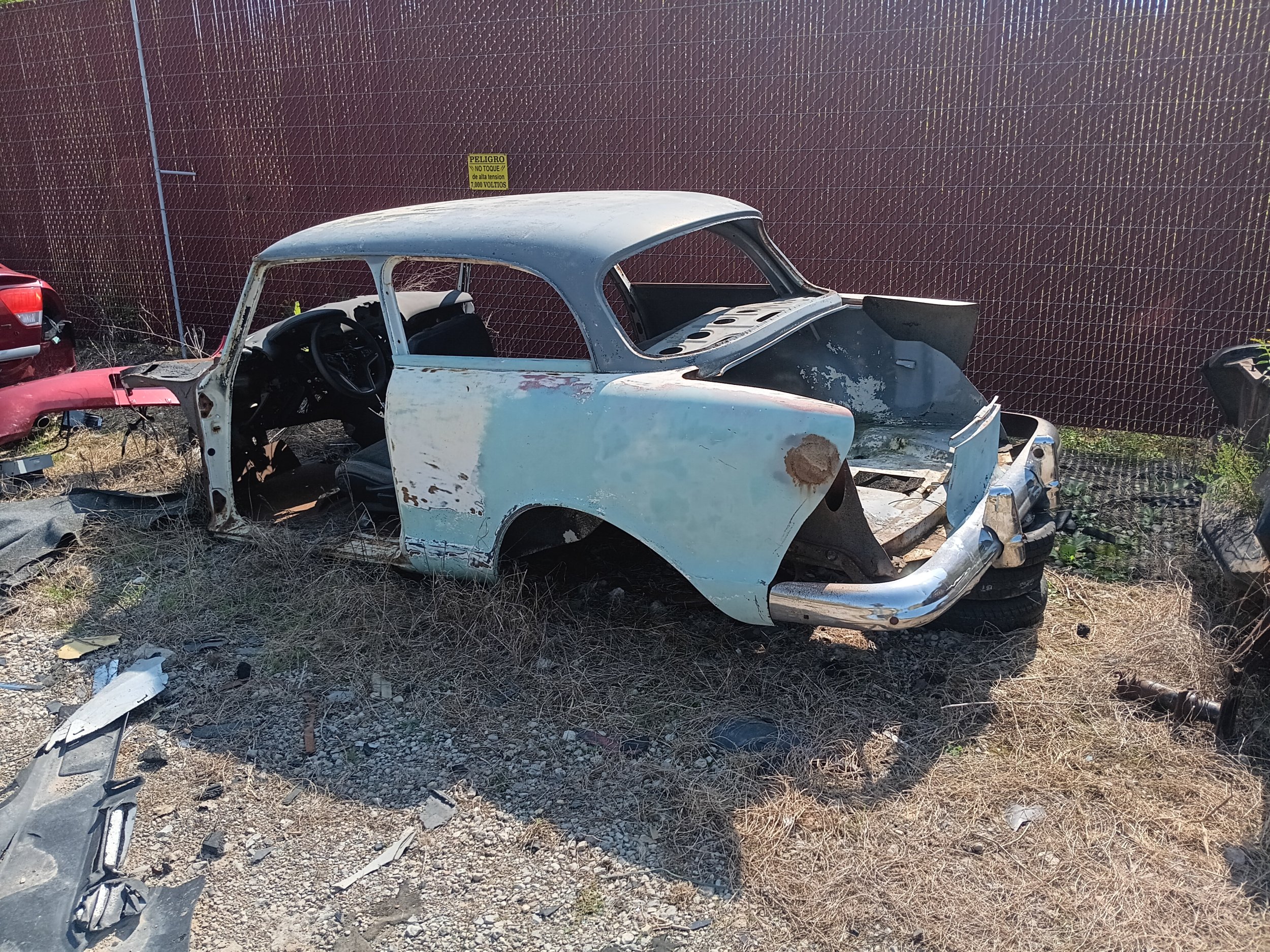

    No real update on the car but I was at the junkyard where my donor car was and I took some pics of what's left. When I cut the tail light pieces out I was careful not to ruin the wheel arches since those are still good and I can't use them, in case someone wants to fix a 58-60 American with rusty wheel arches, they're still intact. That and a rear bumper is about all that's left.
    Whenever I pull stuff at a junkyard, I try not to wreck anything else in the process. I wish everyone took that at***ude.
