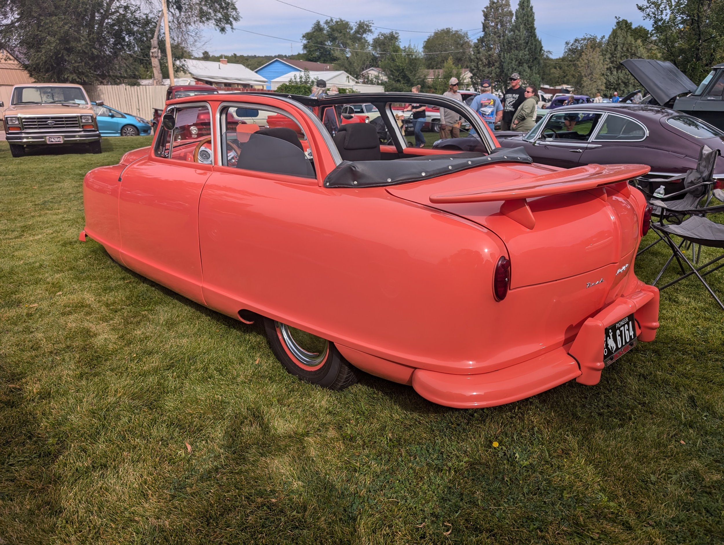

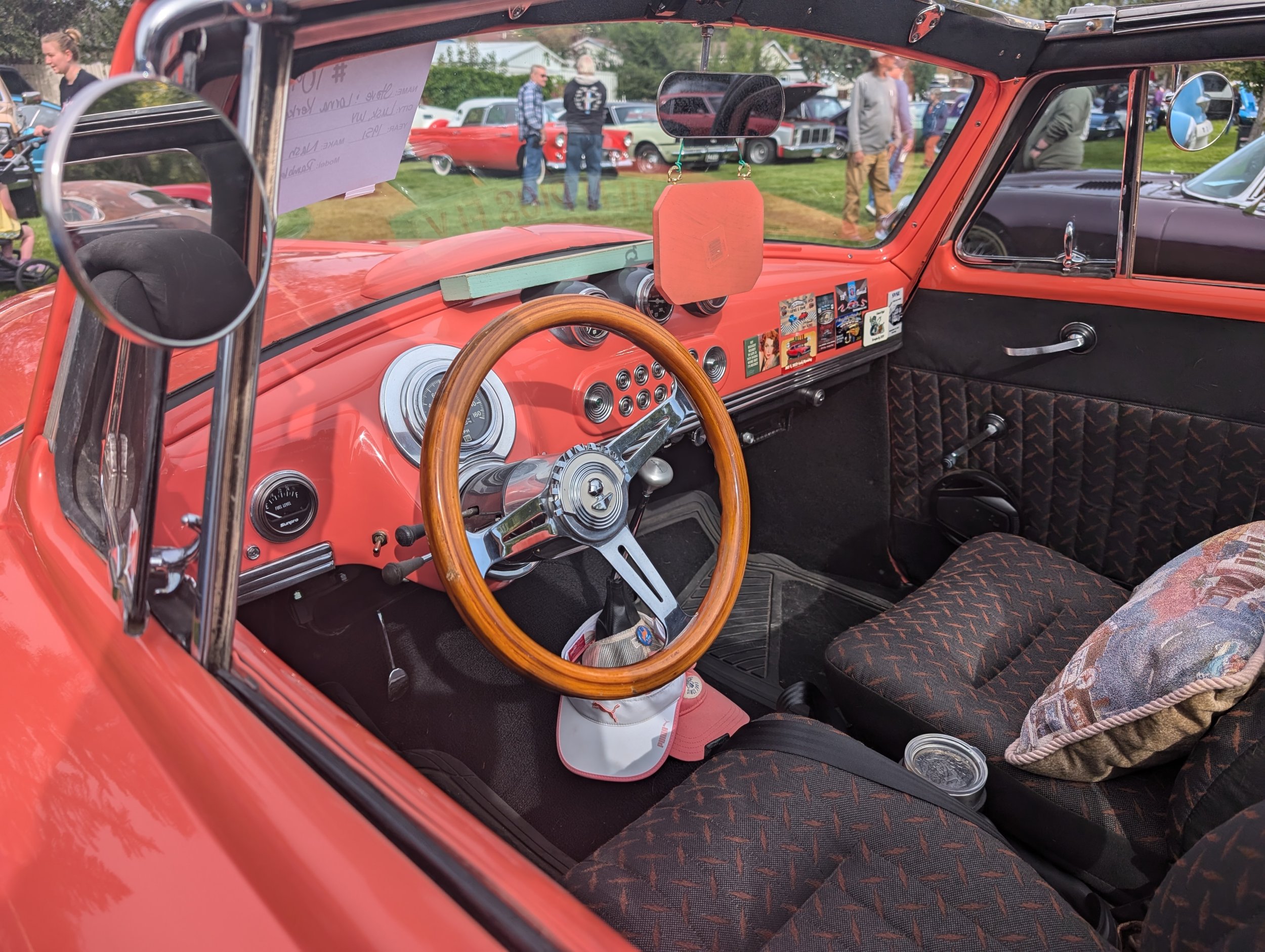

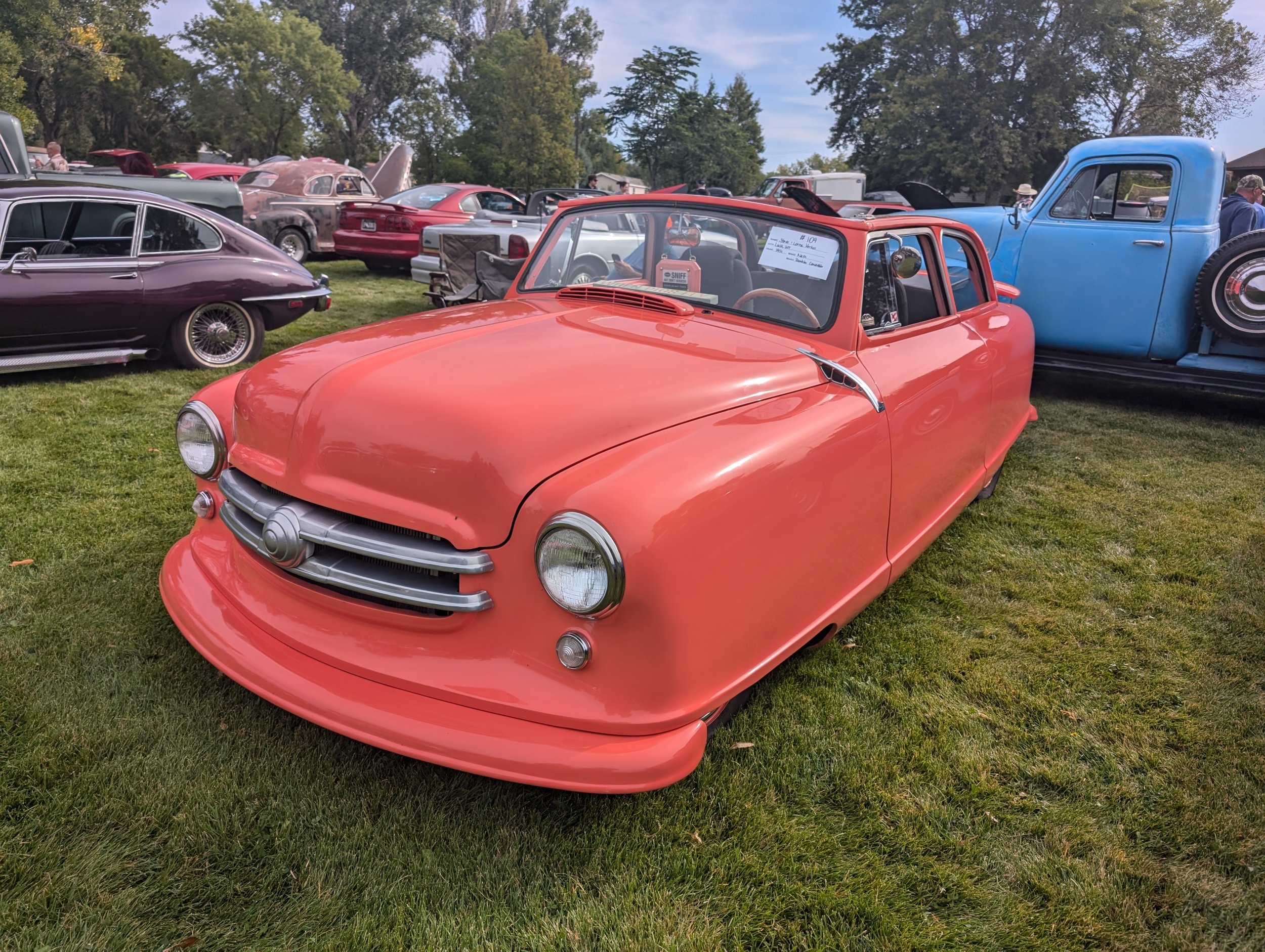

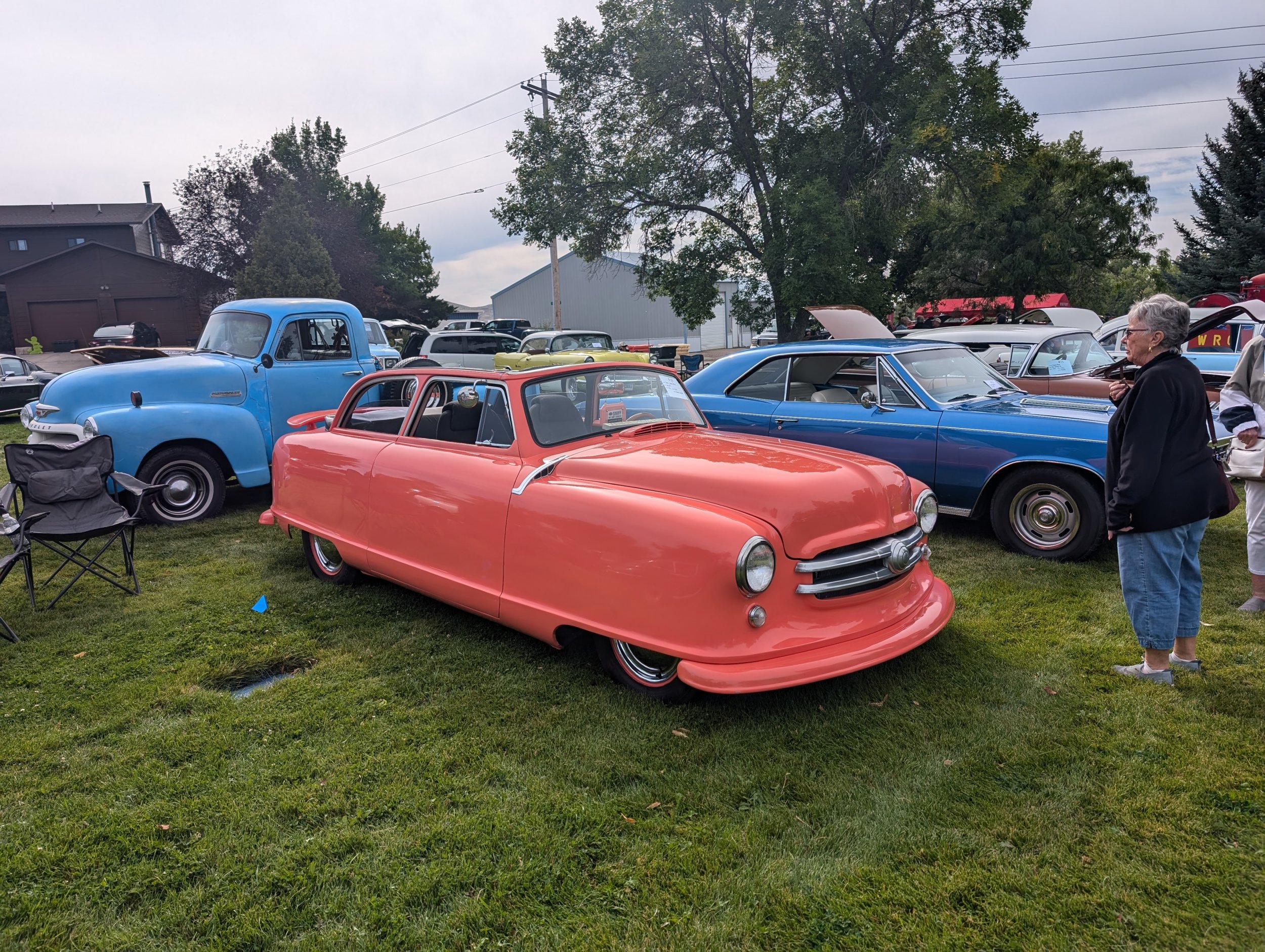

    Saw this today. Thought you might find it interesting PXL_20250920_161354188.MP.jpg PXL_20250920_161347325.jpg PXL_20250920_161317209.jpg PXL_20250920_161421061.jpg

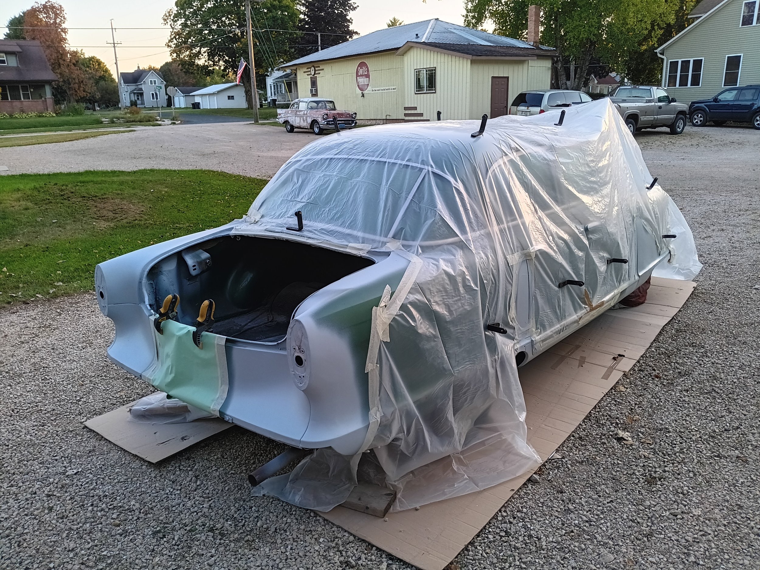

    Primer is on!
    20250929_181210.jpg 20250929_181230.jpg 20250929_181241.jpg 20250929_181201.jpg
    I had some time last night to go over the bodywork one more time and today it was calm, warm and dry, perfect weather for some gravel parking lot paint booth action.
    One new trick I learned from Cold War Motors on Youtube is when you're spraying fill primer, on the first coat you can use a spreader to spread it around to fill in pinholes or in my case, some deep scratches that didn't come out in the blocking phase. It works incredibly well, takes a little practice but you can level off deep scratches and fill in pinholes all in the first coat with a spreader as long as you do it while the primer is still wet. I'll be doing this every time from now on, it worked great.
    Second fun item are these magnet bracket things I bought at the Goodwill by-the-pound store. No idea what they were originally for.
    I think the magnets are rare-earth ones, they're pretty strong for as small as they are. I've used them as welding magnets to hold panels together, but they worked great for keeping my big sheet of plastic in place as I was taping, and as I was spraying. Seems like usually when I spray a car masked with plastic, the plastic constantly wants to blow around and flap everywhere. Using magnets to hold it down worked great to keep it from flapping around, and made it a lot easier to get it positioned before I started taping it into place.
    I'm feeling really good about this. I think I can safely sand these spots out without breaking through if I'm careful, and then paint right over them. Hoping to spray the paint on Friday, another warm, dry and calm day is predicted for then, and I'm going to try to have my skirts ready to paint by Friday as well. But even if the skirts aren't ready, I think I'll still put the paint on the car, I can always do the skirts separately.
    Finally moving right along! Was also nice to be able to drive the car back into the shop instead of pushing it, although I did temporarily forget it has no brakes! Gotta tackle that next.
