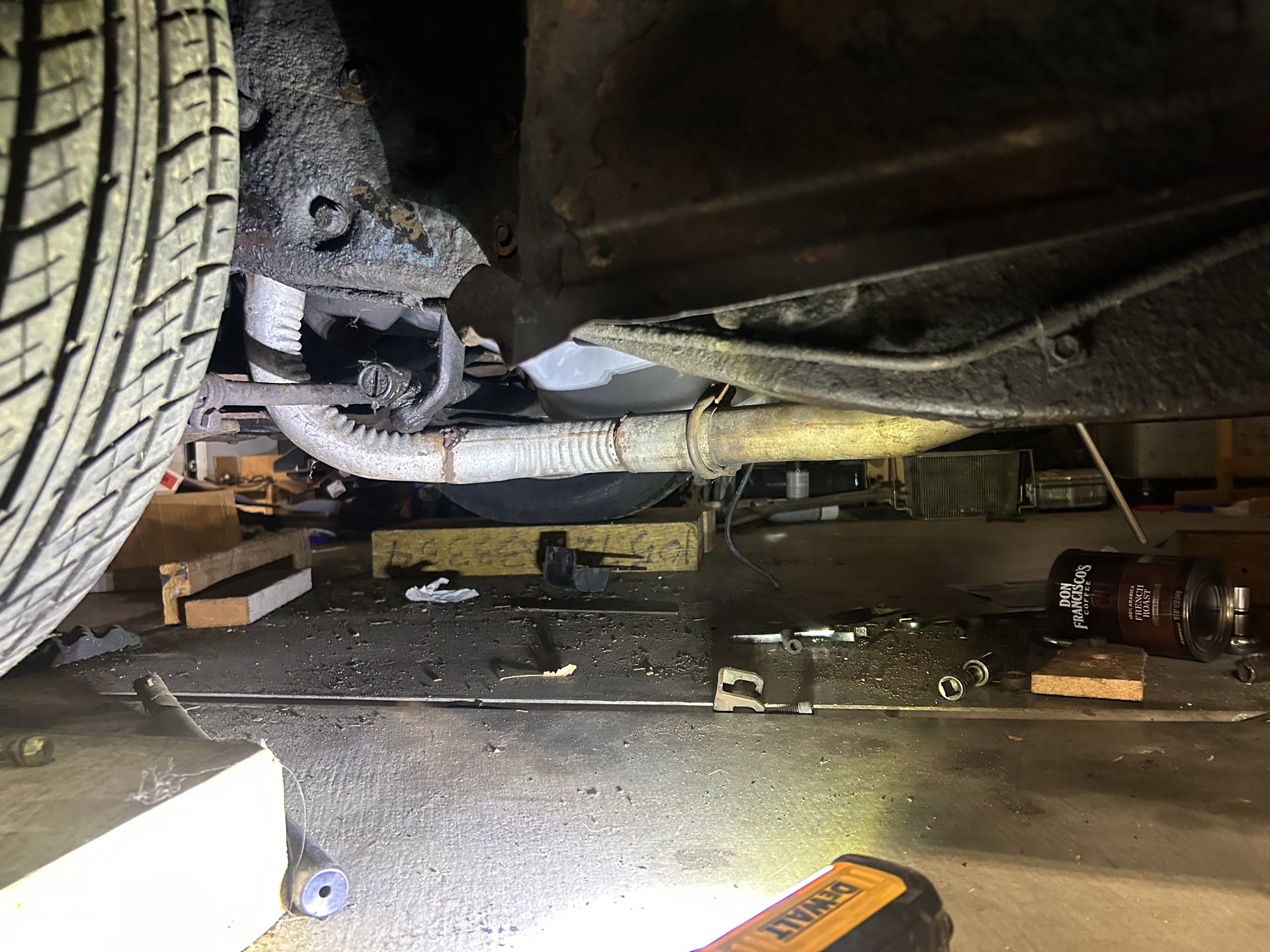

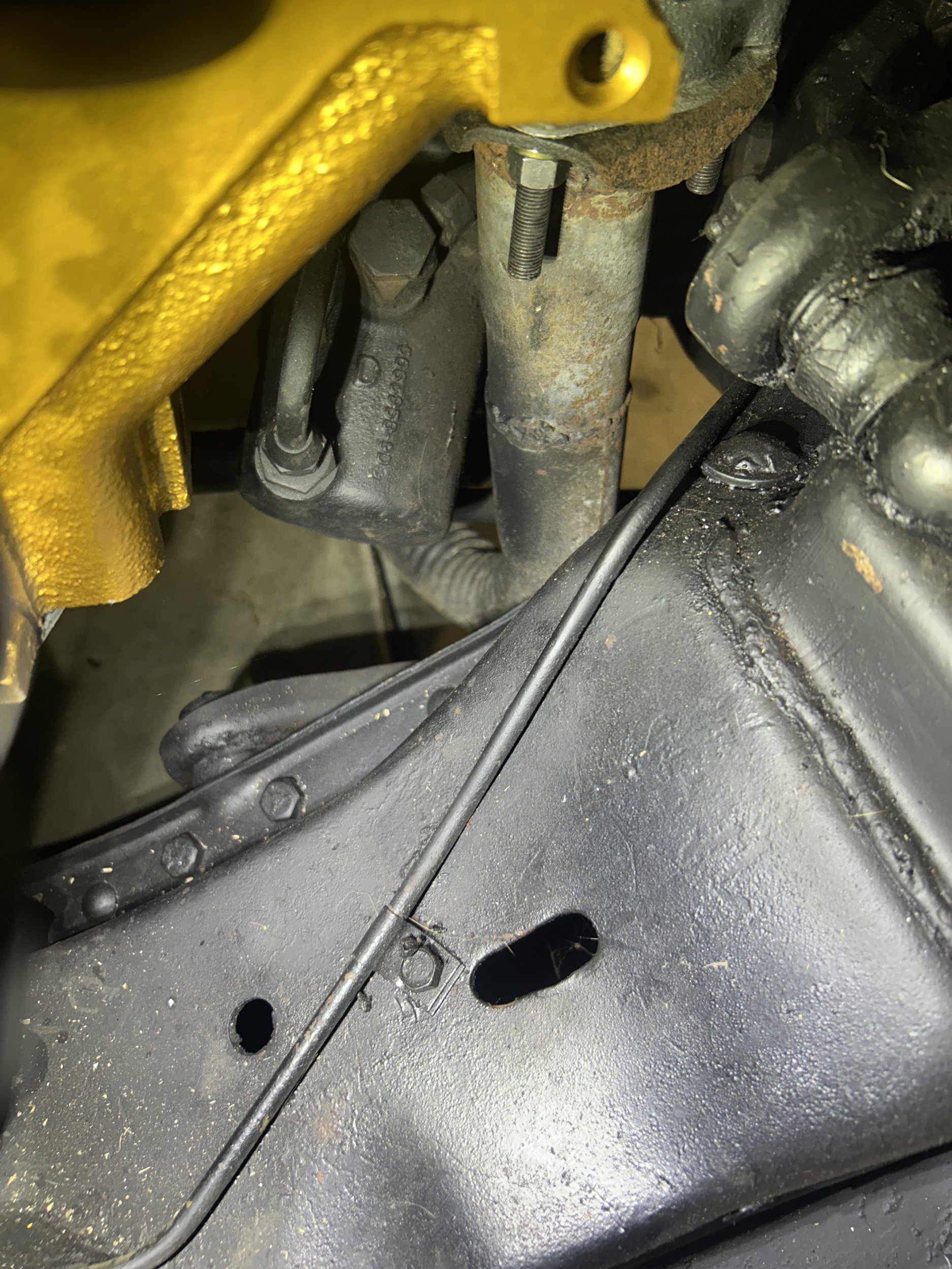

    Here are pictures of the sub-optimal routing on my 55. One day I will do something about it, but for now it clears the suspension and only rarely kissed the ground. The car also has terrible O/T wheels getting replaced with steelies and baby moons that will have larger diameter tires fitted, so the ground clearance should only improve.
  29. caprockfabshop
    Joined: Dec 5, 2019
    Posts: 698
    caprockfabshop
    Thanks for posting, always good to see another perspective. I have less ground clearance so I had to run mine high and tight.
