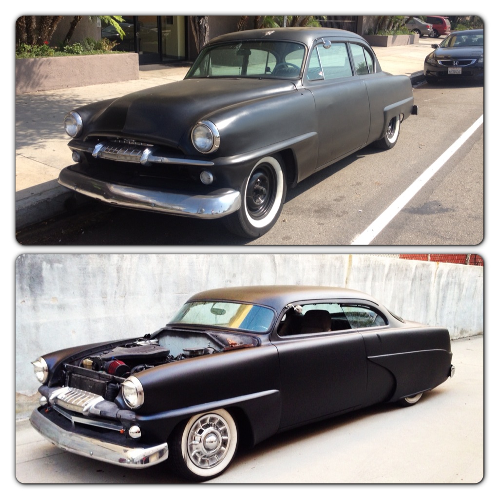

    Jay, Here is a few pics of my 54 Plymouth chop. before and After. 6" chop, ch***is swap to 1994 Caprice Cop Car (LT1 Corvette Engine, ABS Brakes, Fuel Injection, Sway Bars, etc) Cadillac Deville Tail Lights, Shaved Handles, and Shaved Gas Tank Cap, Channeled 6", Chrome Steering Column, Chrome Wheel, Power window Set up, New Metal floor pan, Cadillac Hubcaps, Stock back window that we laid down, Cut down front window, Fiero Seats, 1951 Mercury skirts and I temporarily sprayed the car with Satin Black Paint. Oh and Since the Wifey's drink of Choice is Johnnie Walker, I went with the Black Label License plate.

    54plymouthchop...love the body mods, especially the Deville tail lights. Nice transformation.
    Voodoowagon...your buddy doing the welding is a rock star!
