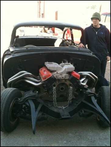

    Ok. Got some time to post an udate.
    If you look close you can see the pockets we made in the firewall for the valve covers. (Worked awsome, plenty of room)
    Also a close up of the engine mounts my bud fabb'd up (the transdapt ones kinda ****ed and i wasn't happy with um) here they are close up... Painted um and they look great imo.

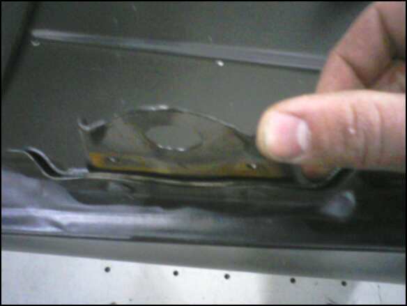

    ***The floor are where the shocks mount to the body had cracked from its previous life. Sooo i looked online and found they sell a crossmember you relocate them.
    Made my own!!!. more of a welding practice than anything, they turned out great. and will help tie the frame together a bit :D But it was FREEE!!!
    Sorry i didnt take any good pics :eek:
    My block is at the machine shop as we speak :D:D:D very happy about this.

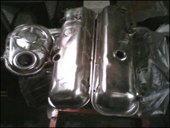

    I did figure out that the tall M/t covers are out of the question due to firewall clearance. So i picked up some good stockers that give me a great amount of clearance.
    I spent alittle time with a wire wheel & cleaned up the valve covers/ timing cover & oil pan. Turned out really good. Oil pan is alittle beat, but in good condition. (Plus it fits my ch***is well) So i pounded it out good as i could. It works fo' me
    now im on the fence about either polishing & clear coating, Or just painting them. Im thinking paint will last longer.

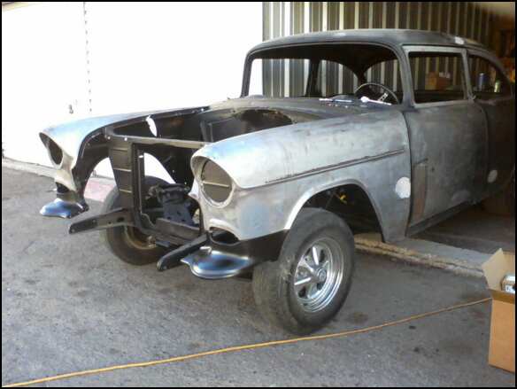

    Well... The money ran out for now, So I started putting the sheet metal all together.
    I'm gonna knock out the bodywork while im broke.
    Been puttin it off too long.
    Spent the day chasing threads and fitting the front Valance/ Splash pan & fenders again. Painted the hood hinges, plus abunch of other small stuff too.
    Had to replace rivets on a fender that were FUBAR'd while i was at it. I'm just try'n to foucus on getting the car solid and doing an inventory of what I have so far. When Ive got enough $$$ to build my engine it will be ready :D
    Just a nice, awsome day out today, 65-70* outside and just couldn't be nicer. Im happy.
    Promise i'll have more & better pictures next time. If anyone cares:p

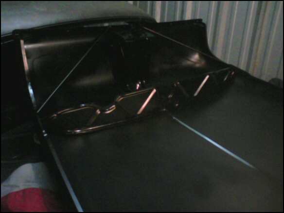

    Got off work and decided to get my hood underside painted up, So i can hang it. Bought 2 cans of VHT Epoxy Paint *Satin black*. and went at it.
    Sanded the hood down, wiped it down with Wax & Grease remover...Then sprayed it.
    Turned out good, Im very happy so far with VHT coatings!

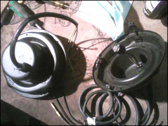

    Spent the rest of my time making pigtails for the Headlights/ Parking lights/ Tail lights.
    The American Auto Wire kit i got has all the right sockets & gromets even, so even I can do a clean install.
    Im not an electrical kinda guy, But this stuff is easy enough it seems
    made sure i properlly soldered outside connections and actually did a very nice job.
    Also ran the back half of the main harness to the general area it will be. I figure long as I do something everyday im making progress:)

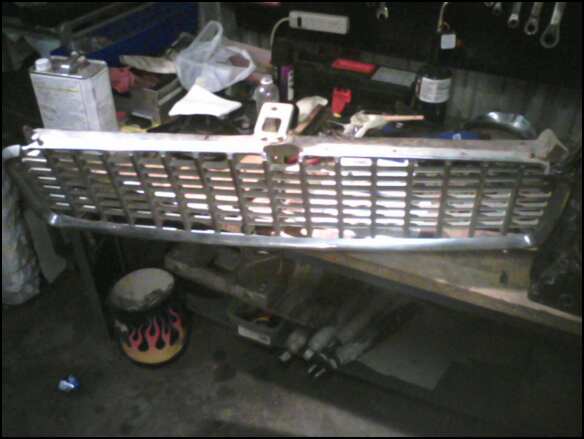

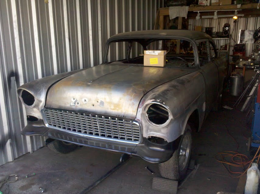

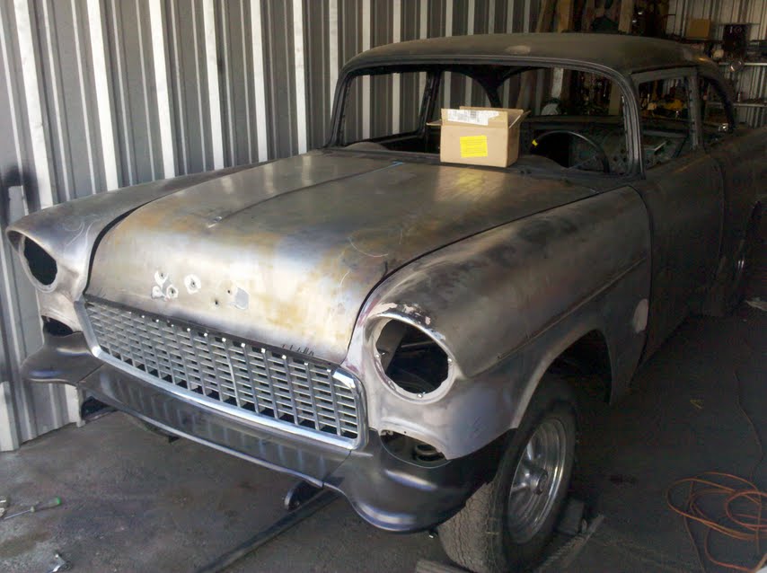

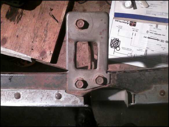

    got the grill back together slapped it in.went together great. i Was pretty excited...untill i closed the hood and realized that there is a hood-fender gap of about 3/4in:mad:
    After some head scratching i looked through a danchuck catalog and realized that the core support i got with the car is a 1957, these are about an inch wider at the top. im thinking i can drill out some spot welds at the top support bar to shorten it up. Id rather not buy another one at this point.
    Just the fun of buying an abandoned project in peices :D
    Anyways, check her out. lookin better everyday:cool:

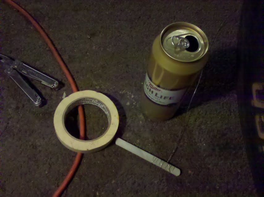

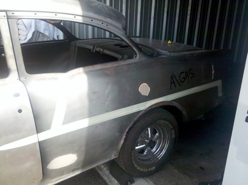

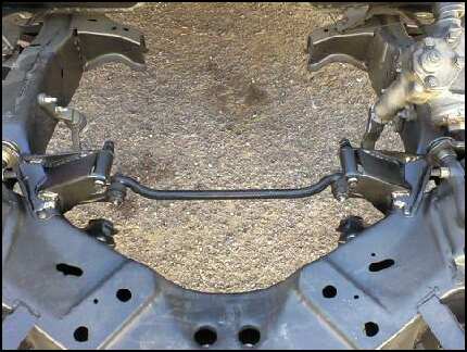

    It was time to do something with the quater panels, Id been staring at them for too long. Finally settled on doing a larger radius for a 28in tall tire.
    There are many ways to do this...and some of them are probally right. But this is how i did it.
    I found that a Tall Can Of miller light fit the center of my wheel perfectly (They were out of PBR :rolleyes:). So I messured how tall I wanted the arch to be, cut a peice of safety wire and wrapped it around a bit of soap stone. wrapped that around the end of a can, Held it in the wheel hub and traced a few times.
    BLAMM Nice centric rings :D.
    Then I simply cut um out with a cut off disk. (would have taken pictures of that process, But I had no one to take the pics)
    This weekend i'll be welding in some conduit the form a flare. You can see i retained the very bottom of the stock arch. Im gonna see if i can form it all together.
    *I may have to trim the very bottom if the tire is too big.*
    Its not alot of progress, But im happy with it untill i can finish um up. I think it Looks MEAN!!!:cool:
