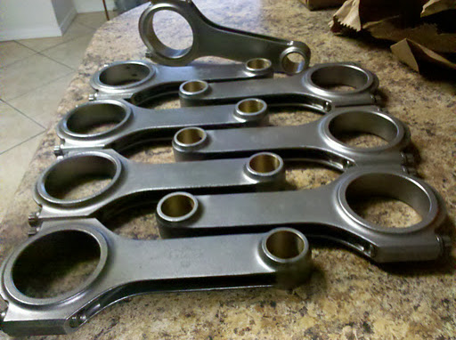

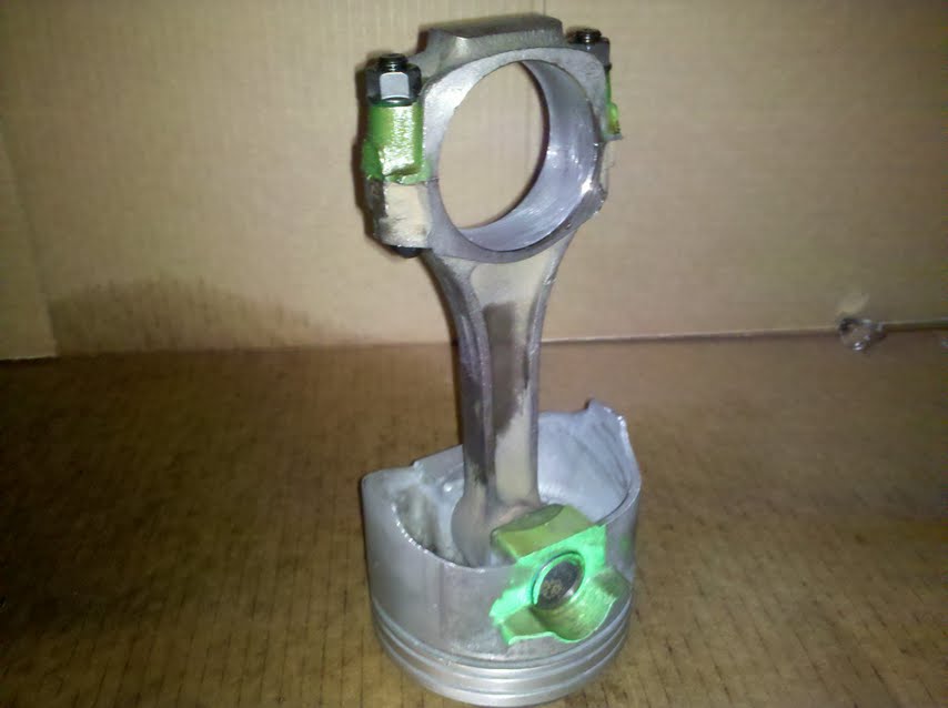

    I had my rods resized, and ARP studs installed. Also I had a "Slow day" at work, Luckily on a day they were doing NDT training. Whats a guy spossed to do???
    Brought in my stuff and they showed me how to check um out using Zyglo flourescent particle...Stuff
    Its a really cool process, you spray on the green. let it soak. wipe it off. spray a "developer" on. Then it it with a UV-a Lamp, If there ANY cracks or hairlines they will be seen Bigger than Sh*t.
    This was mainly for fun. They turned out Good. And I learned how to do it. I'll be having "Mag particle" training next week when i bring in my cylinder heads:D

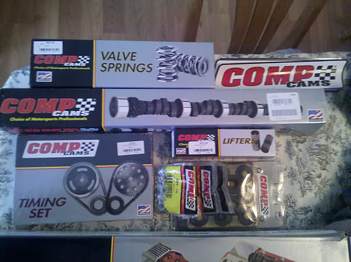

    I spent yesterday with my bud going through cams and such. It looks like im settled on a COMP XE284H. should be plenty...but no too much.
    244-252 @ .050
    Solid lifter.
    It will be rumpity and a little pissed off.
    Best part it, the torque cure looks KILLER. staying above 500ft lbs from 3k-6,500 rpm.
    After all, Its not cool unless it runs. Right???

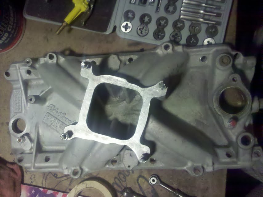

    Forgive me if this is a BS update, But im bored at work so here ya go.
    Didn't have much time last night to get much done.

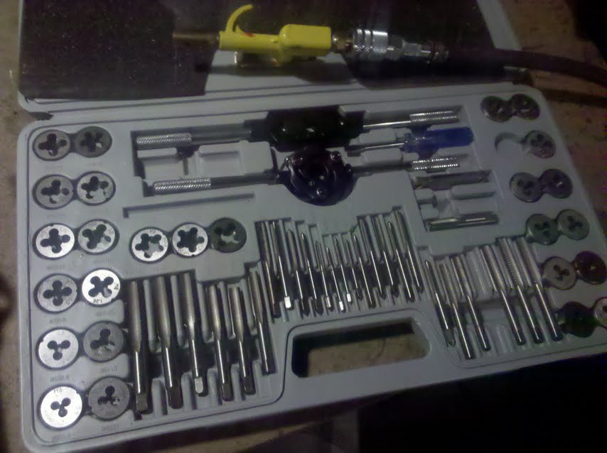

    I cleaned up the torker intake I bought, All threads are lookin great. I had to clean some out carefully with a tap, but didn't pull any metal out (Surprise!)
    Im leaned toward running this untill i get the rest of the car dialed in.
    BTW. A Tap & Die set has GOT to be some of the best money i've ever spent.
    I got it at Hardly Great, But so far its a great set. Inexpensive too.

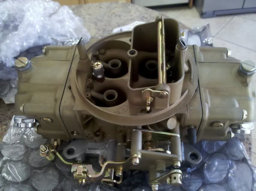

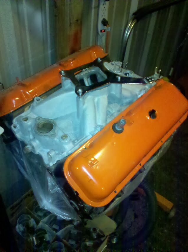

    I bought a few things to help get my engine together this week.
    I snagged a Holley 750 double pump from another hamber (Speedjunkie), which came in the other day.
    [​IMG][/IMG]
    Speedjunkie does great work, this is a completely re-done unit. and it looks top quality, and a killer deal at that!:D My buddies didn't believe it wasn't new.
    I would suggest going through him for your carb needs. Very professional and quick shipping.
    [​IMG][/IMG]

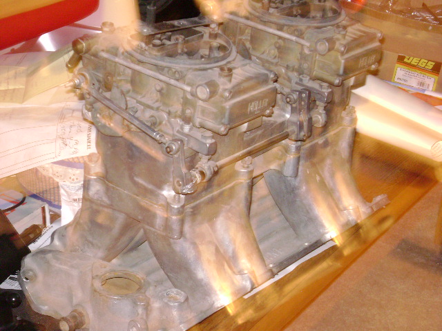

    So the block isn't put together yet, but i couldn't resist setting it together for a little bit of a motivational photo opp.

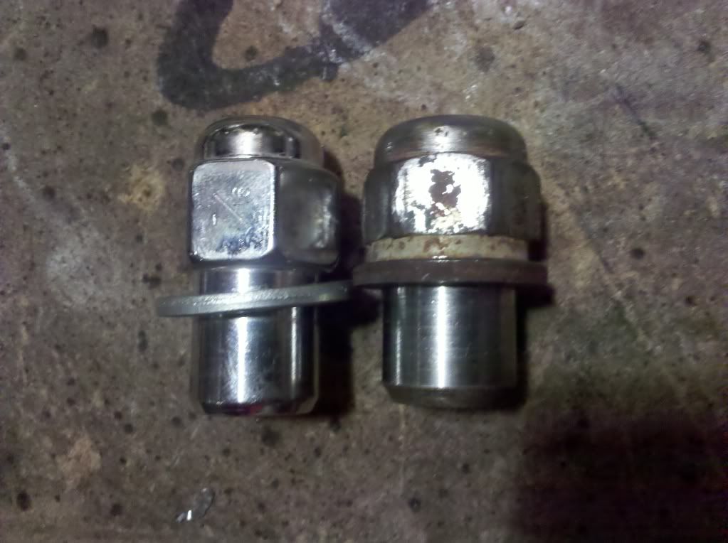

    Funny thing. I needed to get a complete set of lug nuts, And could not find ones that were the right length. They were either Too short (1/2 shank) or just too long and out bottom out on the hub.
    Grinder to the rescue!!! they all good now :D

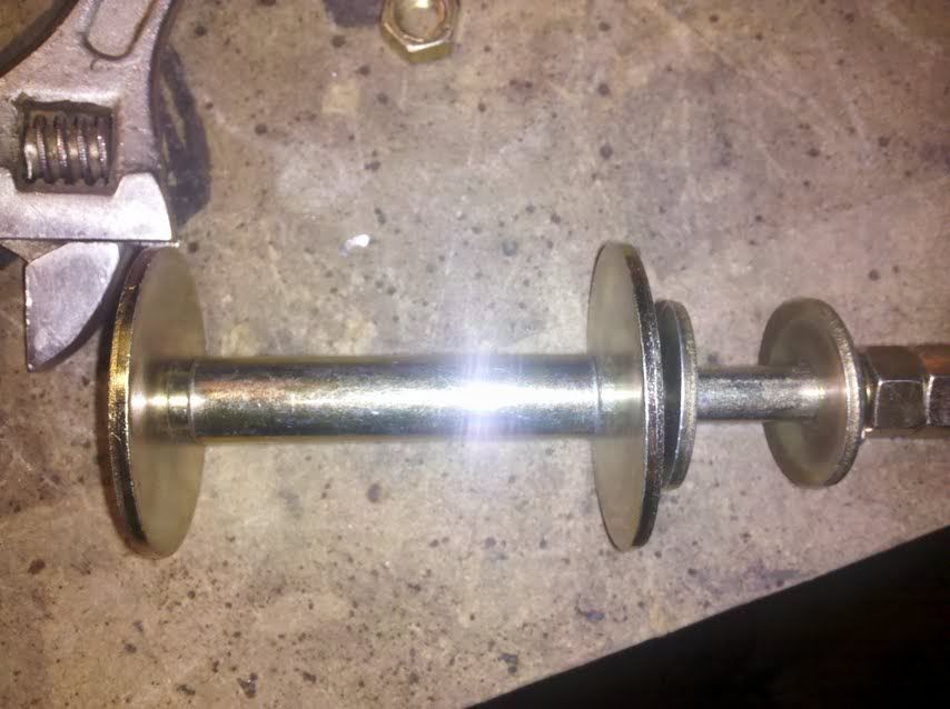

    Still waiting on brake lines & fittings, So I decided to tie up a few loose ends.
    The swaybar on my axle (8.8 ford) was never really retrofitted to fit my frame. Decided to give it a shot.
    This is what i had in mind.
    simply reuse the stock 8.8 links, as the seem the right length. and give the correct geometery.
    [​IMG][/IMG]
    I figured I'd run a solid bolt through the frame, and sleeve the inside. Easy-Peezy
    [​IMG][/IMG]
    a trip to ACE harware and about $10 later, this is what i had.
    You can see how the link fit on the frame, don't get much better than this!
    I used a Step Drill to make the holes.
    [​IMG][/IMG]
    [​IMG][/IMG]'
    Everything was going awsome, Except they were kinda ****ed to one side. Too much for my liking....
    So a trip to my press & a minute with a torch solved that, Only needed a little tweaking.
    [​IMG][/IMG]
    [​IMG][/IMG]
    They fit GREAT now. Im very happy with it, and i think it should be stronger that the U-bolt set up the aftermarket one have.
    I'll spiff it up with some paint and get a picture up.

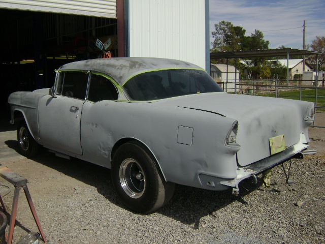

  27. johnybsic
    Joined: Oct 8, 2009
    Posts: 612
    johnybsic
    from las vegas
    Yup. Its coming along slowly, but surely.
    I upgraded my shop to a double wide this week. Much much better for working. I can actually get things done.:D
    Got the brakes all plumbed and bleed, Has really nice pedal feel now. had my friend push the car and i stopped it real good Haha.
    Still waiting on some more engine parts, Saving money up for SEMA...

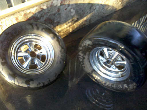

    Got s set of slicks for free from my buddy. Dont pay attention to the fact that they are Goodyear Eagles (Roundy round tires) There the size im wanting to run, So im using them for mock-up to finish out my radius job...Maybe a few burnouts too! :cool:
    Gotta get them mounted.
    They are 28 x 12's
    Funny, Im not worried about going in different directions. This is turning out different from how i imagined it, But i love it!.
    Yruhot- Yea Dave told me about getting yours primed. Hope you get it worked out soon. I'm on a roll now that its cool out, and im coming for you!!! Sweet tunnel ram too!

    I've been slaving away at work and collecting parts.
    As you can see. I got a good set of
    *Eagle H-beams,
    *My XS282s solid lifter cam & valve spring set,
    *Timing gear and stuff

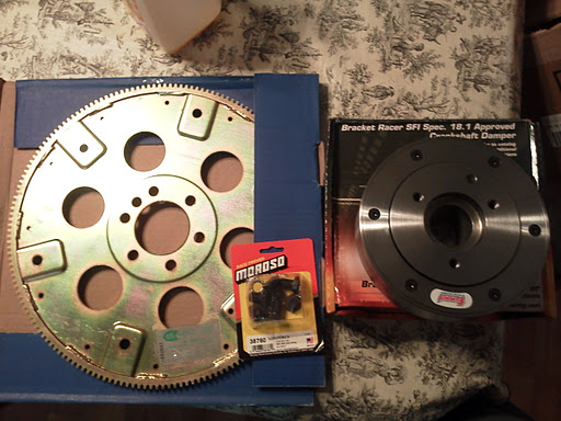

    *Flex plate
    *decent Balancer
    *Comp Magnum roller tip rockers
    *A sweet Moon tach my chick got me for christmas!

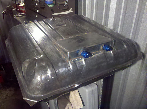

    I also went ahead and made my own fuel sump! :cool:
    My cylinder heads got new valves, and a full recon job. Along with a 5 angle grind and back-cut on the intakes.

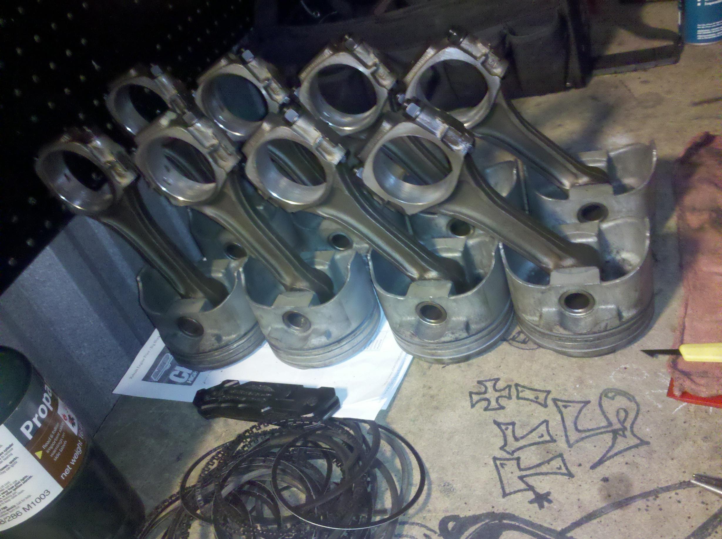

    my whole rotating ***y went in to get balanced, when the shop informed me that...Guess what!!! The H-beams wont work with press fit wrist pins :eek:. I should have seen it coming, But i over looked it.
    I had the shop procure a set of SRP pistons (LS6 spec) for me, and they will be in tommorow. absolutely blew my budget. Absoultely... All my trans money :( But, Hey its a damn solid block now right?
