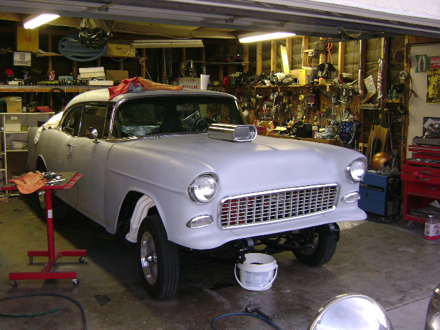

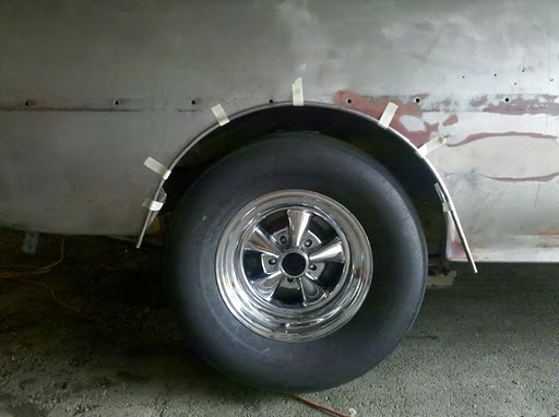

    Heres one for the general profile, before i filled and shaped it. *Teaser
    I gotta say i LOVE the look of it, specially with the slicks stuffed under there. I LOVE IT.
    The come more flush than in the photo (Wheel spacers were required as the tire was too close to the leafs) Anyways LOVE IT.
    I was planning on having the engine all together by valentines day, But im afraid the cost of pistons put the finishing stuff off a bit. Im trying to sell my old rods & pistons (still on good shape) to offset some things, Its a song and dance between parts...Or gas to get to work :p
    And truth be told...She bought me the Magnum rockers & pushrods too ;) She's a good one haha.

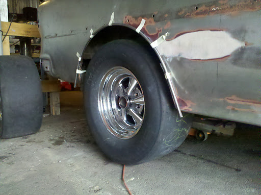

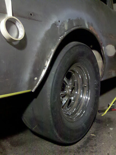

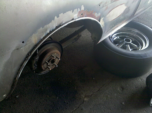

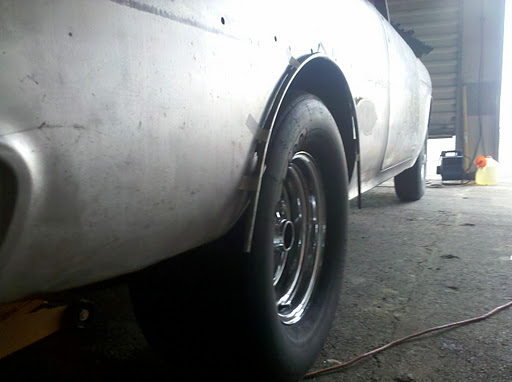

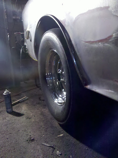

    Doing the radius on the quarter panels was easier than i though, I did take my time (Quite a bit) of it and did a whole lot of looking from every angle i could get to.
    Because the previous owner had cut some way, It might have been easier for me. I still ended up with a different shape and took a good portion of metal off.
    I started with a 10ft peice of 1/4? tubing, then cut roughtly 4ft sections to work with.
    I started working it over my tire (works great!) to get the arch rough'd in.
    Then I had to start forming the ends toward the body. compound bends can ****. Especially when all done my means of a tire and vise :eek:
    Once I got to close i added a bit more flair in the back of the opening, So i would flow with the body line better.
    I then starred for a day or so at it...
    Did a few tack welds to hold it, then worked it closer, and closer. I must have pulled it off and tweaked it 50 times per side.
    Once i was happy with it, I welded the back/ underside carefully to avoid ruining an otherwise good quarter. you know...Other than cutting a big arch out of it to piss off the purists :p.
    I then used (Metal 2 Metal) to fill it in, I was sure to really squezze it in there (with tiny bits poking thru the weld gaps) to ensure good adhesiiiianns.
    I let it breath and sanded it down, then applied another skim coat to help shape it.
    It tured out awesome, and will look great when primer/painted.
    Love it.
    Was nervous as hell cutting more etc, but once i got a flow going it was like artwork Haha
    Adds alot of strength to the panel too.

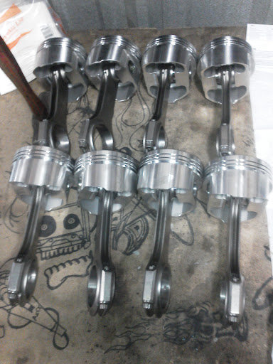

    Went and picked up my heads today.
    I had um hit with the "compe***ion" job.
    They were pretty wore out, so they got new: Valves/retainers/springs (matched to my cam) (back-cut intakes) 5 angle grind. pocket/bowl blend & clean up.
    My machine guy said they tured out damn good for a set of 290's, and they will be more than enough to twist the thing up pretty tight.
    Told me to watch my license too :D
    It was kinda cool, said he was happy to see someone my age building a BBC for street slugging. Guess these are getting rare these days. Lone ranger
    *Also got my crank back (balanced). My new rods were weight matched & balanced along with the new SRP pistons etc.
    Just uhhhh....waiting till i can s****e up the cash to pick um up.:eek:
    Having to buy new pistons really set me back.
    All in All, Im pretty fu*kin stoked!!!

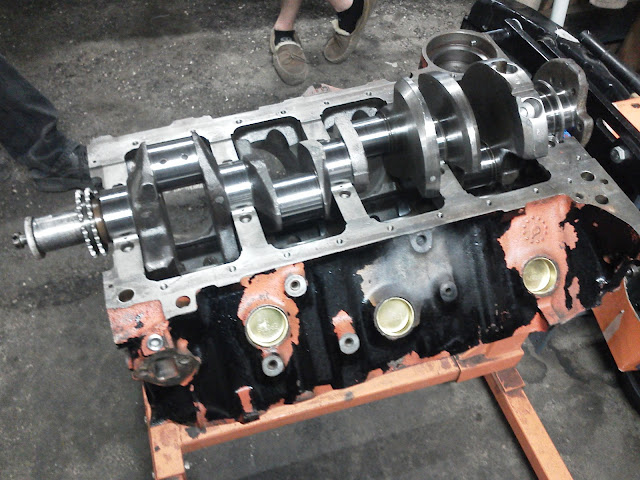

    Well, I guess its time for a little update.

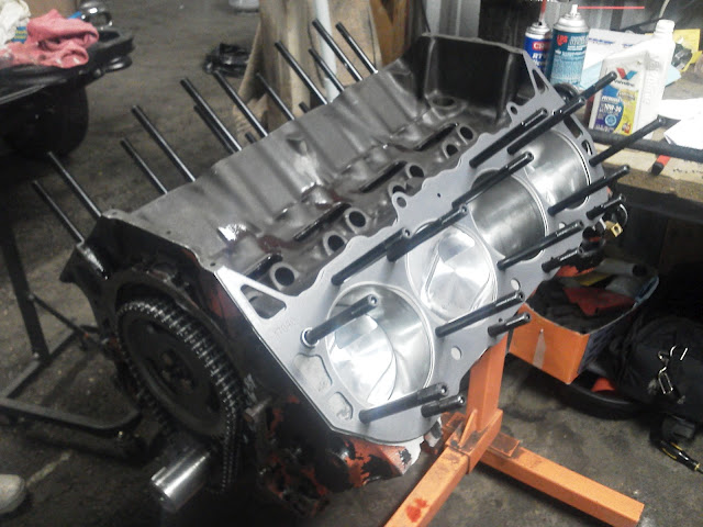

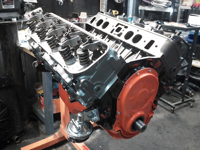

    I finally got all the pieces for my engine build, Got her tied up and put together!!!!!!!! Talk about a mile stone for me, One of the most fun day i've had in a while.
    Everything went smoothhh and i've got my very own Big Block cheby:D
  10. johnybsic
    Joined: Oct 8, 2009
    Posts: 612
    johnybsic
    from las vegas
    As you can tell, I ended up putting head studs on it.
    I learned how to file fit rings along the way, and a bunch of other things. Im very grateful to have the help of 1 or 2 friends who walked me thru it all.
    So in recap!
    It's a 70' 454 ( .30 over)
    Forged factory crank
    SRP Forged pistons (ls-6 style)
    *11.25:1 compression**
    Oval port heads (290's rebuild w/comp valve job. new COMP springs etc.)
    Solid lifter cam from COMP (xs282s)
    Comp true-roller timing set
    Eagle H-beam rods
    Kings brand bearings thoughout
    Comp Magnum roller tip rockers & Magnum one-peice pushrods
    MLS head gaskets
    ARP Head studs
    And other goddies throughout.
    All that wrapped up in a pretty stock lookin package ;)
    Here she is, IN the MOST proper CHEVY orange!
    Im so damn proud :D
    Its my first rat motor, and it should move my 55 veryyy nicely.

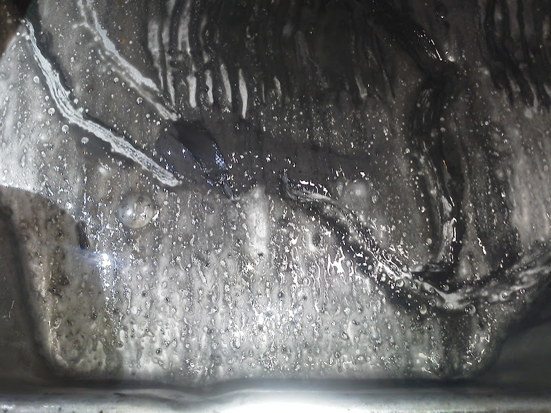

    My original idea was to use the TH400 i've got, push a fresh filter in it and new fluid. Kinda just see if it works i guess. Roll the dice, as i dont have the funds to have it "profesionally" rebuilt. In hopes that a 400 is pretty strong and robust.
    I popped the pan off last night and im not so sure. Im not an expert on automatics, But i think theres an awful lotta silver & gritty sh*t in there :(
    Its a 69' TH400, codded for a 350v8 4bl Chevelle/Nova/Camaro. Someones put a Transgo kit in it. So im sure its seen good abuse.
    I'm figuring its gonna need an overhaul? So im now looking into a DIY kit, Guess its time to learn something new! Hurray

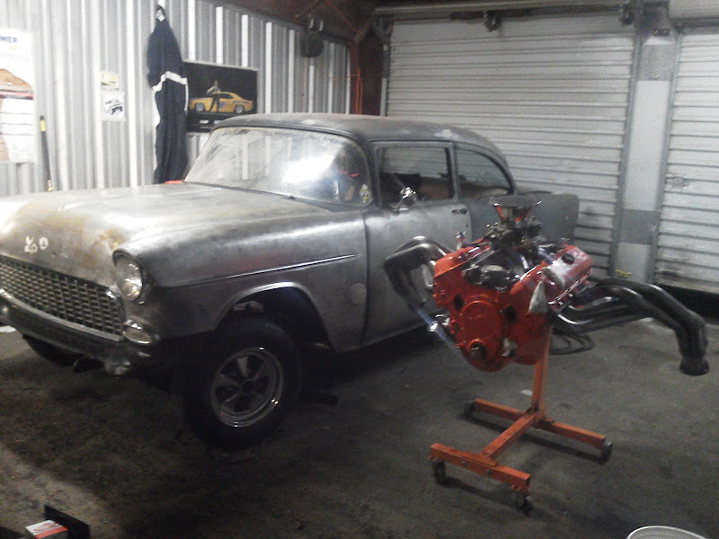

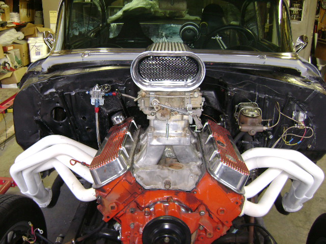

    Also I took this picture with the engine alllllllll dressed up for the dance, enjoy!!!
