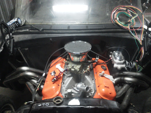

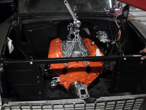

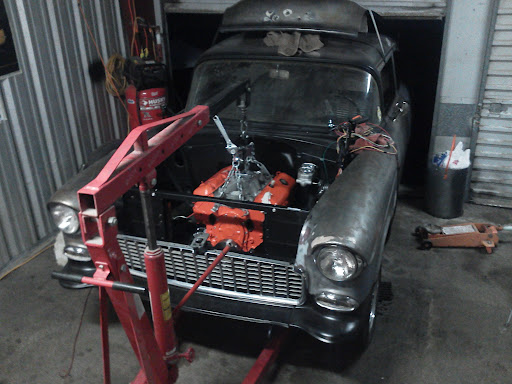

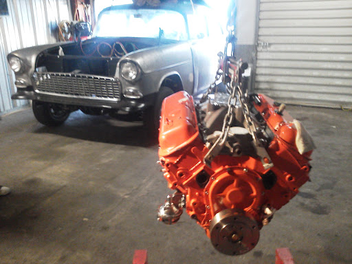

    I pushed through my trans fears, Once all the crud seattled in the pan i realized it wasn't that much (1 tea s****s worth) and no chunks. So im crossing my fingers that its all good. Threw in a new filter, oil and seals.
    Spent a few days getting little things out of the way, gathering the "Nickle n' Dime" stuff....Yeaaaa $500 worth of nickle and dimes :mad:. Justtt when i thought i had everything i needed Haha.
    Install went good too! Something about a prebuild mock up really paid off:cool:

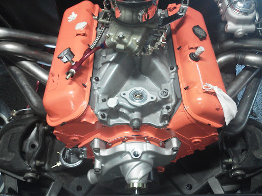

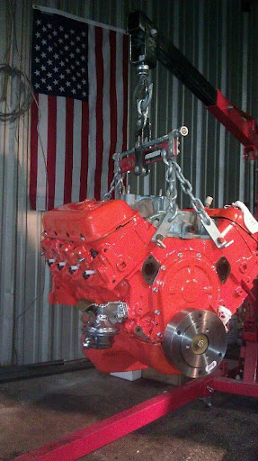

    Once i had the engine in the car I decided to try out my pre-lube adapter my buddy made out of an old dizzy.........
    THE PUMP DRIVE SHAFT WOULDN'T BUDGE.:eek:
    Aparently when i put the pump on, the drive shaft collar wasn't seated correctly, or something.
    I pulled the engine out again (Hurray) and checked it out. got it freed up and spun it with a drill on a stand. *Good oil pressure, nothing odd going on*
    So we stabbed the Dizzy in and it all went back in.
    THANK GOD I found that before i went further!!!!
    I then preceded to brush it off and keep rollin.
    Put the headers on (*****IN) got a water pump etc.)
    This thing fits reall good, Its got a good setback too!
    I had to chase a dead starter solenoid wire for an hour or two...Stupid neutral safety:rolleyes:
    with a water bottle full of 91* and a fire extinguisher in hand I said a prayer and turned the key It actually cranked it up, and it came right to life. Perfect.
    This thing sounds Soooooooooo absolutely bad ***. I LOVE IT.
    I couldn't be happier. Man

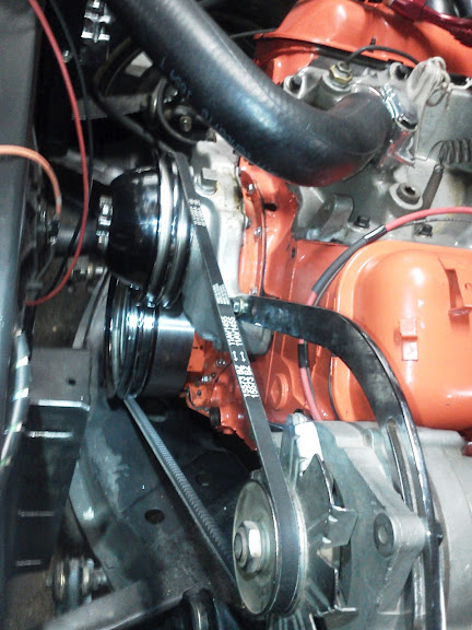

    However I cant break it in till i get pulleys for
    the damn thing ! I put a short style water pump on. Cannot find pulleys (even unreasonable ones) around here its driving me mad!!!
    I put up a wanted add, but if anyone has(water pump/ alternator) pulleys along with the alt brackets. Please help lol
    I think I screwed myself using the short pump, but I needed the room

    I was able to finally source pulleys n stuff this week, So-cal was able to order it for me. I actually had a store credit for $100 from them i forgot about untill i cleaned my shop out! Whooo Hooo got pulleys, and alt bracket fo free :D reused my top arm.
    Also I borrowed a mr.gasket scoop from a buddy, Just for eye pleasing'ness.
    I like it, Might have to get me one ;)

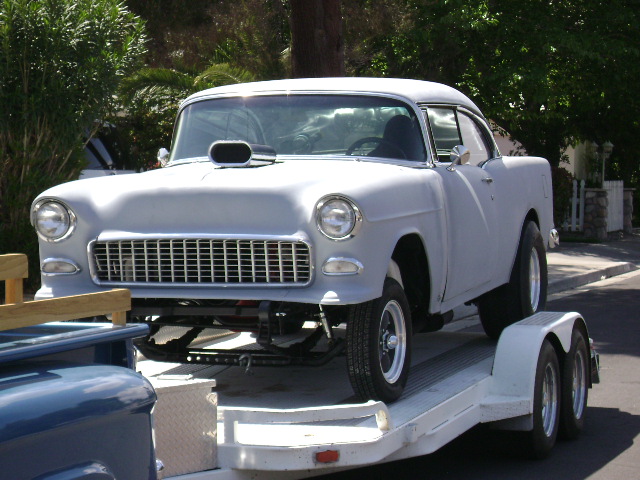

    Took the car on a trailer ride to the drive line shop yesterday. The missing links are falling into place

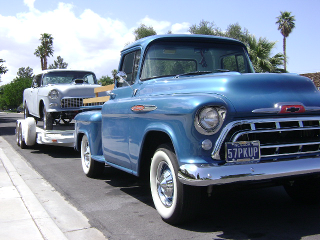

  24. johnybsic
    Joined: Oct 8, 2009
    Posts: 612
    johnybsic
    from las vegas

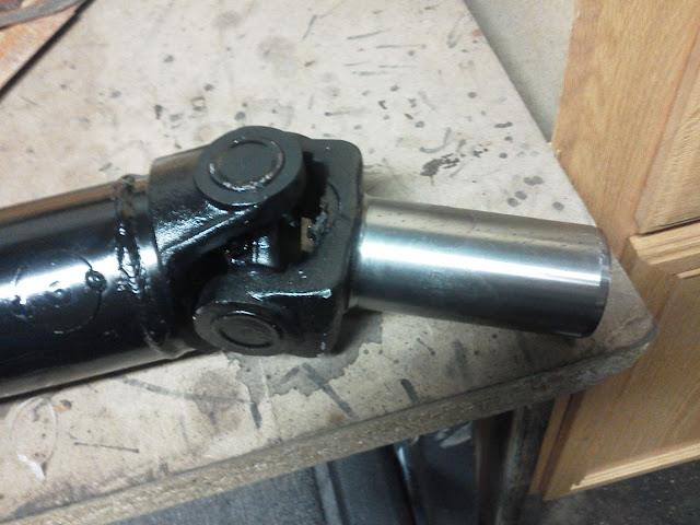

    waitin' on the drive shaft, my old (core) shaft was bent. so they couldn't use the tube like we originally planned and hoped.
    Cost a few more bucks cause of that, but hey...Its gonna be a good one!
    Heres a few pictures from the other day, she was gettin some sun and wind on the trailer.
    I gotta say, I'm diggin the stance shes got. Its just spot on my style! looks tough :cool:

    Yea I had to have a new shaft made up. Went down to Adams Driveline and they knocked it out in like two days. They crawled up under the car on the trailer and made I think it was a 3" dia. with 1350 u-joints. have'nt hurt it yet.lol. Going to install new torque converter after next week I hope. Getting real busy with the a/c work.Moneys good but the drain on my car time ****s. Why is everything a choice.;lol. Anyway I want to see some videos of this thing terrorizing the neighborhood. I went out to the Pep boys new speed shop grand opening out on Jones and Flamingo. Went to Santa Fee first and then over there. What a zoo. Drove around the place twice to find a parking place and no luck. Had to drive all the way around the soccer field/baseball complex out back and setoff quite a few car alarms. That was a hoot. No pun intended. OK later YRUHOT............Doug

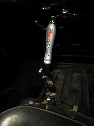

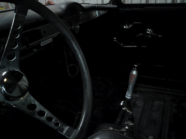

    Got the drive-shaft back and installed today, its a nice one...it was a few pretty pennys.
    had no issues installing. Went ahead and serviced the trans fluid too. Hooked up the converter bolts etc.
    My chick has been itchin to help so i let her install the shifter, cable and linkage. She did a pretty damn good job to boot!

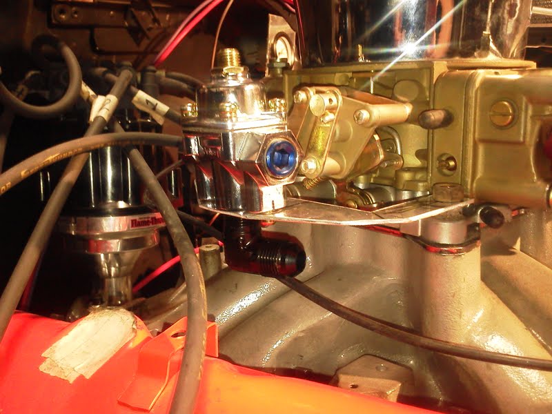

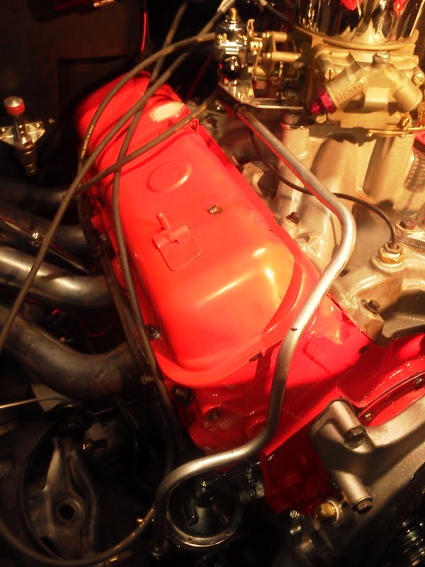

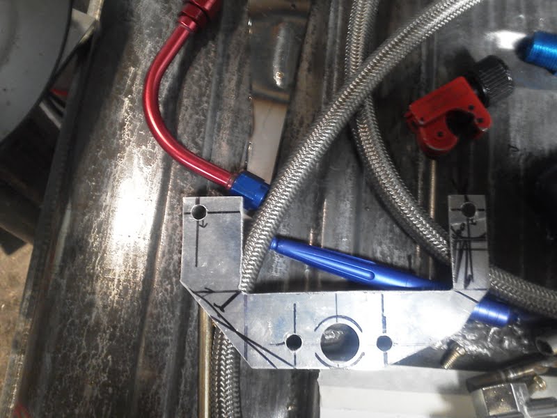

    getting the fuel lines and such tied up.
    Had no where to put my regulator etc. (no inner fenders) So i made up a bracket to hang it off the side of the carb.
    Keeps it clean, and out of the way of the valve covers too!
    I like it much better that the red carb log i already bought for $50:rolleyes:
    Ehh oh well.
    Should have it all tied up by end of weekend
    Chuggin along friends!

    Looking good. I mounted mine to my firewall and was chastised by the guys at Figs speed shop out in Henderson that my location was illegal according to NHRA incase of flying clutch parts that might fly up in that area. Huh? I didn't know, Do now. Also according to Jegs catalog I must use two regulators for multiple carbs on alot of their regulators. I think I'm having fuel delivery problems makes sense. Replaced the 660 center squiters with carters ( edelbrock) 2 600 cfm. Drives arouind like a dream compaired to the others. OK good luck, enjoy the ride. Lets see some video. Later. YRUHOT..............Doug
