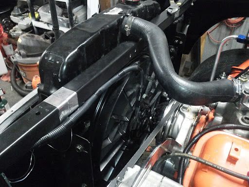

    Fan is from a taurus, it took just a little t******* to fit it. Covers the radiator damn near perfect!.
    Wired it to a temp switch, with an override for strip staging etc. or whenever i want it on manually.
    This thing moves alotta air for sure, and it was free (traded used junk for it)

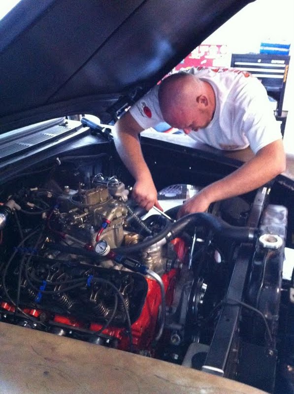

    Heres a picture of us trying to figure it out. dumb***es
