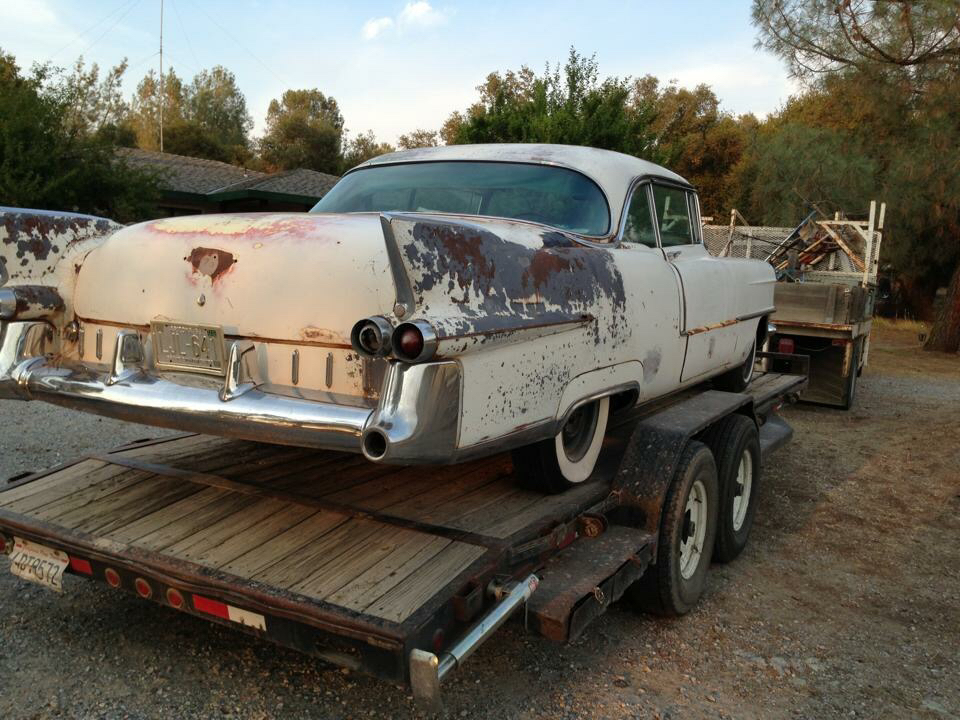

  1. Awesome build dude!! After I get my Buick finished up I'll be starting on my 55! Great motivation here! I plan on going the same route with the top and the motor as u did! Can't wait to see more updates! -Nick ImageUploadedByH.A.M.B.1440443487.154619.jpg here is when I brought mine home.

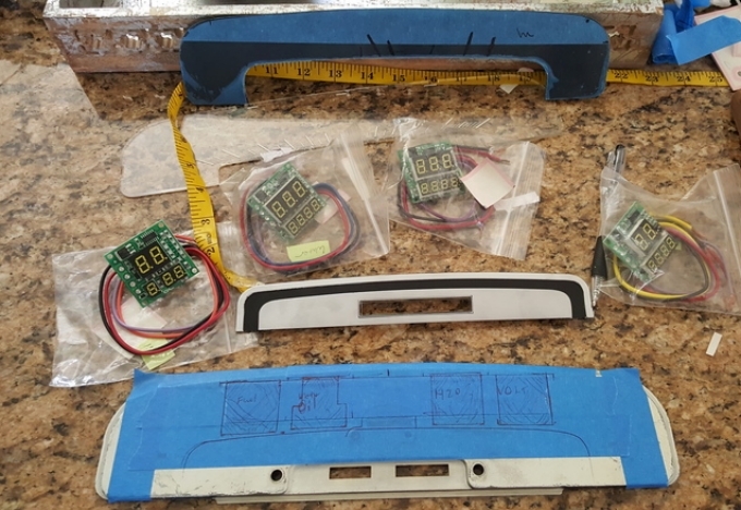

    Didn't take any pics of the work but a lot of effort went into rebuilding the electrical portion of my bag system and getting a digital readout as well as 4-way leveling capabilities into the ashtray. Something I have wanted for a very long time!

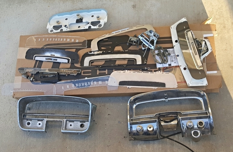

    Another big completion was bring an idea to life which consisted of using all Cadillac (54-56) speedometer parts to build a better looking, period correct speedometer that would house digital parts but appear 100% stock when turned off. Mission Accomplished?

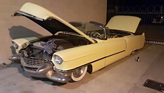

    Finally got around to shooting the car with hot rod flatz cream yellow and had trim around hood and down the side of the car dipped while it was off.

    [​IMG] Also shaved the hood ornament. Hated to see it go but just didn't like the profile with it on. Here is the latest pic at the Temecula Rod run 2016 all put back together. For those that don't know, this is a temp paint job to get me though the final stages (years) of this build...
