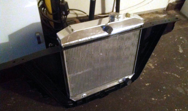

    I still need to fit the dual fan mount but here it is painted and mounted.

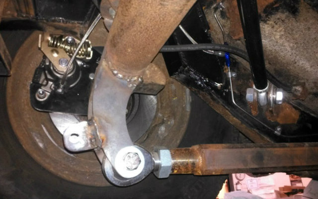

    Just Finished the rear disc brakes and plumbing all the stainless lines!

    Rear brakes in and shock tabs mounted.
