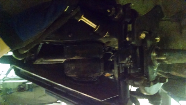

    Now that I have had a chance to take some road trips and work out any kinks that may have come up with the front brakes or steering, I am comfortable installing the front bags. Not quite a before and after... but here's what I have for progress pics.

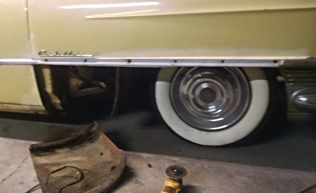

    I used an OEM rocker that I bought 5 years ago for way too much and cut down and hammer and torch welded an extension piece to fill the new cut hole.

    Now onto the front quarters. The driver side was pretty bad and the lower p***enger could use a little patch. I found a guy on line that looked like he produced some clean work so this will be the first piece of my project I will out source. Time to cut them free and UPS to Phoenix.

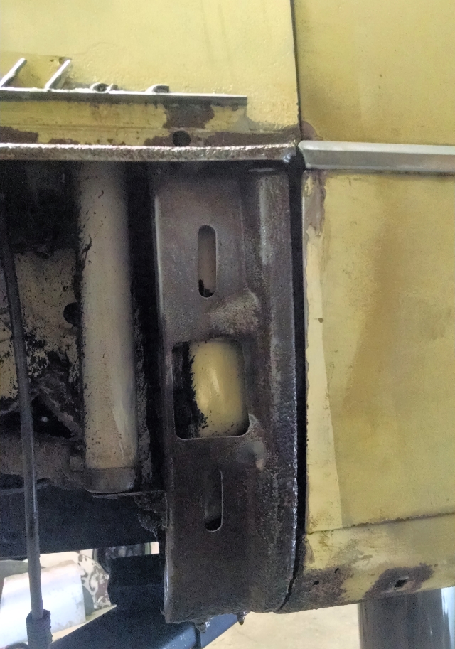

    Quick update to the front quarter work. Based on the pic it looks like I made the right choice having someone with stretching and shrinking equipment to re-make these.

    Thanks to the handy work of hubcap1 here on the hamb, the install of the new brace and fender quarters turned out great!
    The driver side cleaned up pretty good so I just cleaned it up and shot it.

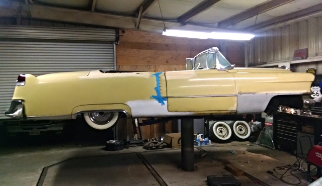

    Here is a before and after of the rust repair to the p***enger side.
    I am working on some scoops and taped off my rough plan for a side visual.

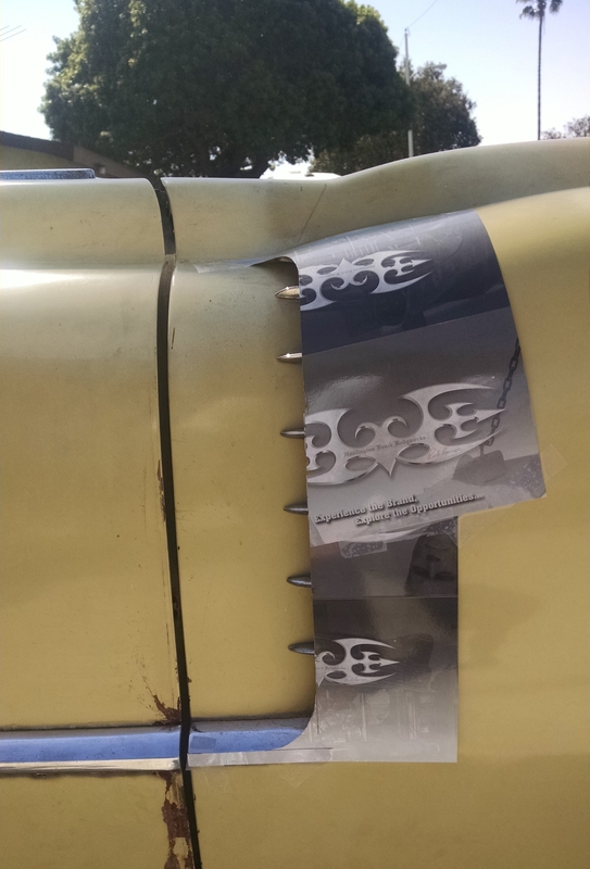

    Brought my car home for the first time in about 5 years! Thought it would give me a chance to just enjoy and drive it for week. I have been playing with the idea for scoops for a long time so I decided to mock some up and stare at it for a bit.

    Rich Evans designs in only a couple miles away so I called him up to see if he could lend a hand, advice, materials, or all of the above. He of course was willing to supply all 3. I drove over in the Caddy and held the template up to give him an idea of what i was thinking. He traced it onto some 20 gauge and cut one out then traced that piece and cut the second. We bent the metal between pipes and over my knee until both pieces not only laid flush with the car but were uniform to each other. He advised using 1/8" steel rod for the lip and within one hour of arrival, I was on my way. Now back at my shop for the weekend, I cut out the left side to the shape of the body line and tacked in for t*******.
