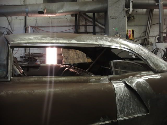

    well heres some stainless work the pics came out ****ty for some reason .
    heres the problem after the chop it didnt line back up
    whats a man to do ?cut on the line and weld it back up
    same on the other side
    here it is about half way through messing with it i think its sanded to 80 in this pic
    a very very very small ghost from the rod tried 3 different varieties and this one was the best
    and i ran out of clips so a half *** tape job and some imagination will have to do on this one!

    Don't try to open the door with the stainless on it that way...that small indention a the front of the piece you just welded up must go behind the flipper...just in case you didn't know...

    major changes coming to the top stainless 40 stude no worries about twisting it up!!
    thanks kev !
    thanks kool !

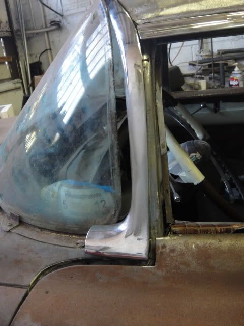

    this is really my first time messing with actual stainless trim. ive welded stainless but never trim .its tricky but in the end if you have patience it will work out. the welds were knocked down with an 80 grit roloc then hand filed out . a general idea this took 6 hours and still needs polished completley.
    there was some previous damage here thats why i cut it where i did.
    tighter your gap the nicer its gonna turn out
    heres it on the car
    polished up a taste
    and next to the stock piece
  6. Zed

    well got the a pillar stainless done .ruined the drivers first attempt by stepping on it got a new piece and then finished up the p***enger side today!
    waiting ona few other pieces of trim then shes headed back to ted!
