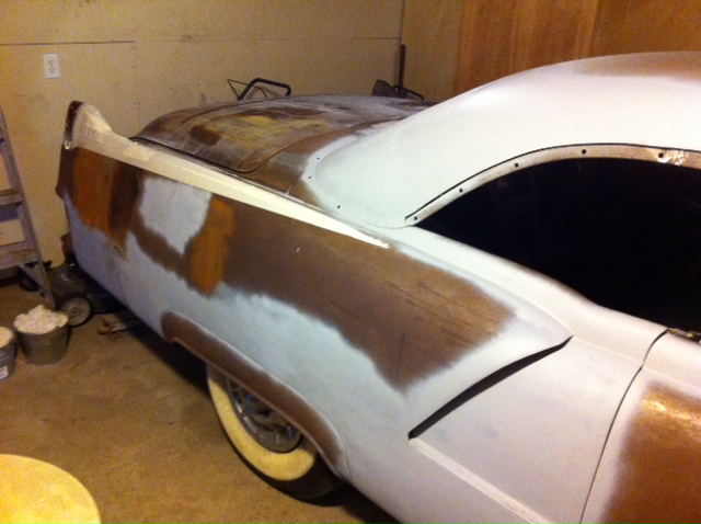

    shaved the rivets on the flippers.stainless is a ***** some times . ruined 1 flipper in the process
    these are just hanging out in place not tightened up
    heres the rear window trim as well .4 foot sticks of half moon aluminum!

    Im very interested in seeing and knowing the process on welding up the stainless.. I have repaired alot of dents but never holes. or for that matter welded. This opening up a world of ideas with me. I like to see a how too video out of this!! lol

    cant give away all my secrets fitzee!!! stainless is a ***** .it likes to move .its thin.you screw up just a taste your buying a new piece .matching rod to the piece you are working on so you dont get a ghost .give me steel any day of the week!

    onto the rear window trim . quarter moon aluminum will be made to fit the custom shape ted wanted

    a little primer over the metal we have a wet ride to new york tonight and tomorrow!!
    no filler this is just over the metal!!

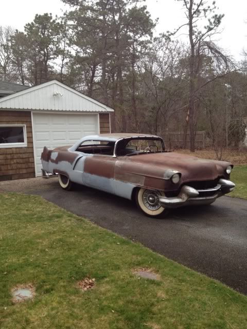

    headed to Teds on the george washintgon bridge
    back in Teds driveway
    wrong turn.stuck in the middle of NYC with 50 feet of truck and trailer
    on broadway
    Well it was a hell of a project .I learned a ton and Ted is very happy with the new look of his Caddy!! Thanks everyone for all the comments questions etc . Def makes the project more fun and keep the fire going while working on it!
