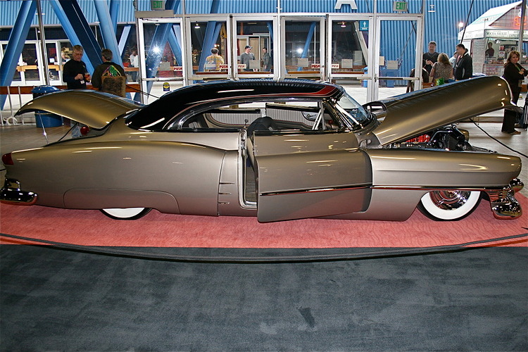

  12. Glad to see the next cut underway, Flop...
    Another option for the back gl*** might be a '61-'63 Imperial Lebaron. Probably not too hard to find. Fairly large width, and really tasteful reveal molding., though might not be flat enough?
    If you're still looking, I can measure the one on my '62. This one isn't mine, just a random picture...
