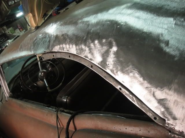

    down to business
    shavin drip rAils
    shaved
    ws posts
    gotta get the trim to work now with no drip rails :rolleyes:

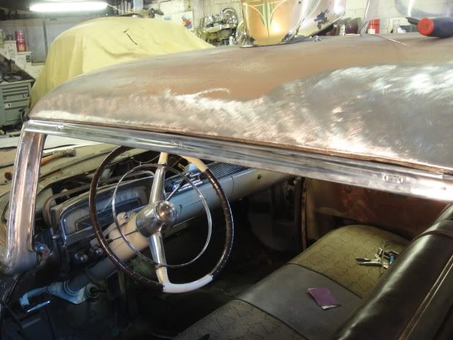

    got the drivers side finished up cut out some stuff i didnt like and it ended up looking like this
    now with the flipper on i can see what the drip rails hid. now that there arnt any drip rails you see what i have to fill in
    well i got about 4 inches into that in the front and i ran out of argon. so much for welding this weekend .but man its gonna look slick with no drip rails!!

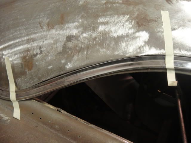

  26. looks great Flop. Mike Alexander told me awhile back that he and Larry would fill up the stainless with lead when they had to curve or bend it so it wouldn't kink. Keep it up
  27. Flop
    Joined: Jun 8, 2006
    Posts: 3,885
    Flop
    interesting tip hoboy thanks
    well waiing for stainless rod to come in and still working out some small kinks in the back window lay out .figured we would lay out what Ted had in mind for his scoops.
