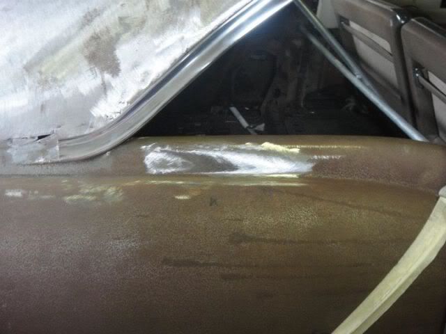

    well we were in a spot of hammering out details on the window and scoops i went after some rust and dents
    who ever had this car before ted really like to run it into things
    shaved the coupe deville
    couldnt tell ya why this spot was rotted out
    about a quarter inch of lead
    almost all finished up
    mess

    Killer Flop!!! Yeah Cadillac used a lot of lead for all the seams, not that it's bad just saying. The 61 has so much lead it's incredible. The body panels are only spot welded in the rear and filled with lead.... interesting?!?!?!

    Flop, what are you using to show you the low spots? It looks like you went at it with a disc sander? Details, please!

    atomic i use a low rpm sander with a 6 inch disc. to show the low spots thats just surface rust showing . but if the panel is clean i just go 2 different directions and you can see the low spots by the different sand patterns or if im feeling energetic i will run a vixen file over the panel haha

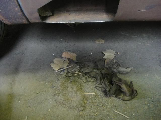

    heres the quarter panel from hell . dent ,dings ,previous damage, rust, lead a quarter inch thick and thin metal everywhere
    if this quarter panel could talk im sure it was taught some new words.thank god this one is done!
