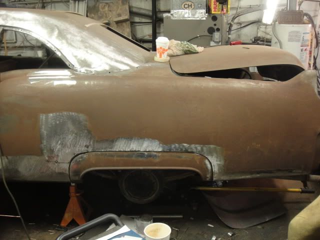

    this was a bigger mess then i expected
    alot of shrinking to get the curve
    tacked in
    the inner panels all done as well .primered and probably wont see the light of day until they rot out in another 60 or so years
    skirt fits better then before
    should be done with all the rust midweek then onto the scoop on this side

    hey gator pretty easy repair but ****s weld on the quarter because of how low corown it is .it warps like a son of a *****
    thanks eli!!
    stock height zed!!
    almost done with the rust its been a fight !
    weld and grind
    then some english wheel action
    always always make the patch way bigger so you can get a nice shape to it then trim it down to what you actually need
    about 6 more inches of welding then onto the fun stuff!!

    arts and crafts day at the shop . tied up the under neath of the car .so its back on the ground. rub you dirty hand on the poster board and illl be *******ed the image of a scoop appears
    so really i taped it to the other scoop to get its shape and transfered it to the drivers side

    cut a big hole in the side of teds car today
    a new piece i made on the english wheel
    took it out after i had it mocked up here and aded some more crown to the panel in the middle
    tacked in ready to make the inner pieces to seal the scoop off from the quarter!! this side went a whole lot easier then the last thats for sure!!

    i thought about it gator . the downward compound curve would be the killer to make a buck for and i would want to put out another ****py patch in the world! i would be super weird about selling something that might need tweaked .:eek:
