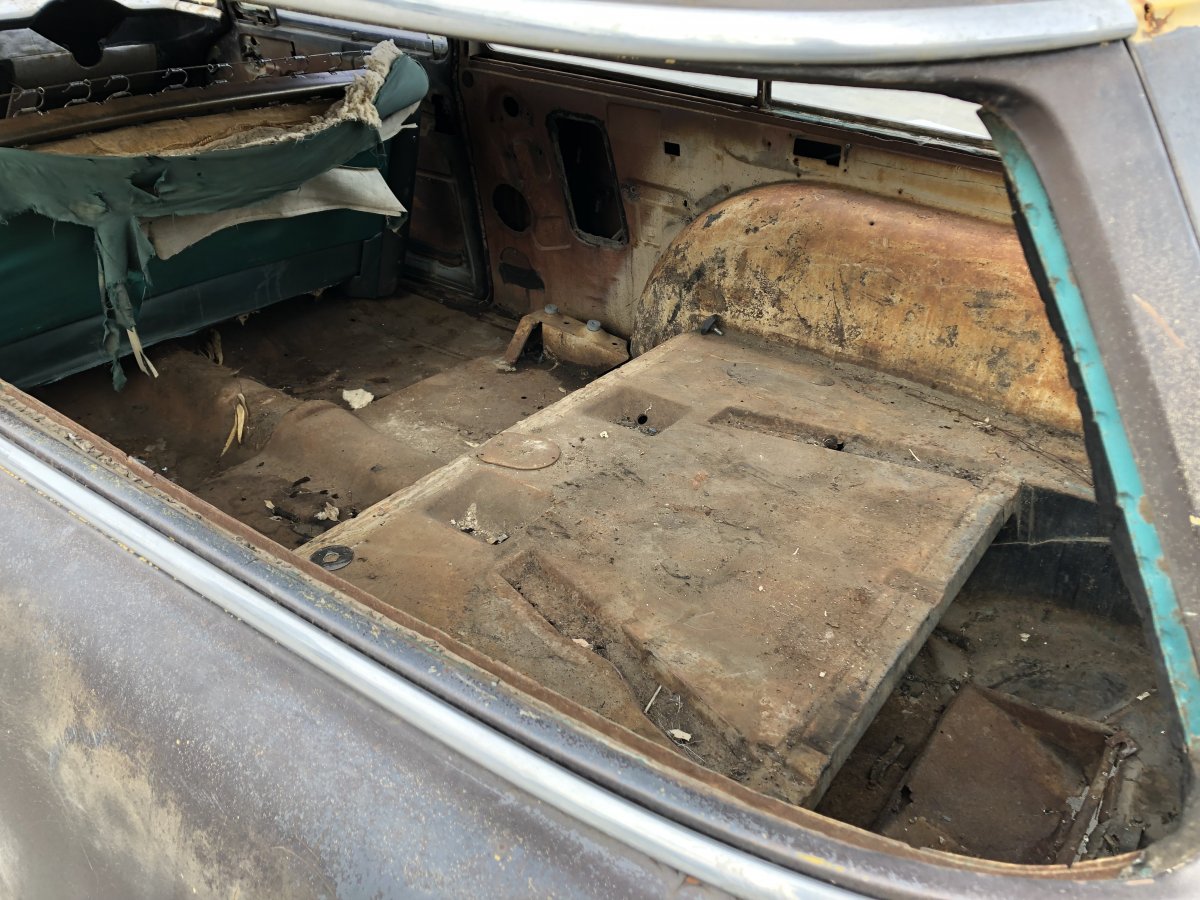

    I've always been a ****er for a wagon and I spotted this 55 wagon at a friends house, he had just bought it and was going to clean it up and sell it on. It had a good frame, at some point it someone had put an air ride system on it, power steering etc...not much of an interior, a tatty front seat and it's fair to say there was rust in the car, but it was all manageable. We had a chat and I bought it...
    Here are a few photos from when I first saw the car in my friends back yard to when I dragged it back to my storage unit and cleaned it up a little, just to see what I really had bought.

    The next stage was to strip the wagon back to what I had actually bought, it it went off to the blasters. The reason we cut off the rear fenders was that they were badly fabricated and instead I wanted to go with Nomad style fenders...not to everyones taste I know, but I wanted the opening to reflect the front fender. IMG_7974.jpeg IMG_7975.jpeg IMG_7973.jpeg IMG_1567.jpeg
