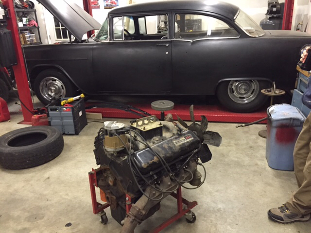

    I pulled the 302 (cam went flat) and acquired a 454 to take it's place. I also scored a 12 bolt posi out of 69 camaro for it. This should keep me busy through the winter....

    We dropped the big block in place today. The motor mounts move the engine forward 3/4 of an inch and gives it just enough room to clear the hei and valve covers. I had to to remove the centerlink from the steering to clear the oil pan for now. It looks like I'll need different pan. I'll need to figure out clutch linkage too....

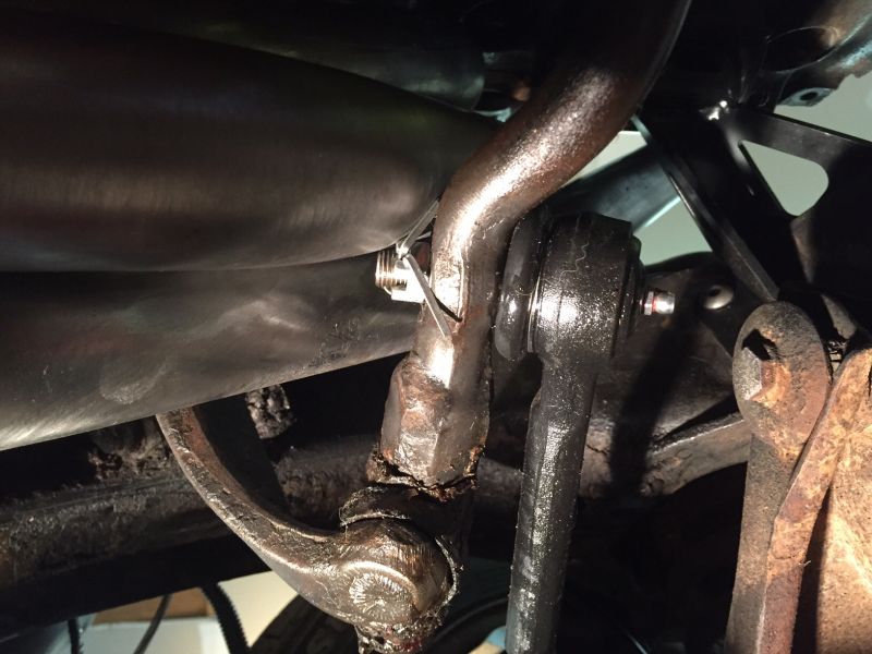

    Sanderson Headers are in snug and it looks like I have clearance issue with the drivers side tierod hitting one of the tubes. Thoughts? I sent sanderson some pics but haven't heard back yet.

  15. Looks like the motor needs to be back about 3/4" for the tube to clear the tie rod. Did Sanderson know you planned on moving the motor 3/4" forward?

    Yeah..it's 3/4" forward. I gave the specs to Sanderson before I bought them. I sent them some pictures but have not heard back yet. Hopefully there's a solution without major surgery.

    I gave up on the Sanderson headers and bought a set of Earl Williams headers and mounts. No more stearing issues and everything seems to fit nice.
