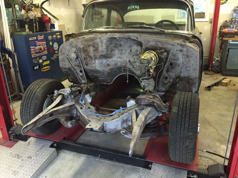

    A couple updates...
    I fitted a 1969 Camaro 3:73 12 bolt posi. I set the pinion angle and welded on new perches....

  5. rsg2506
    Joined: Mar 6, 2005
    Posts: 360
    rsg2506
    The motor is cleaned up, painted, and ready to go back in once I paint the firewall and front frame components.

  11. rsg2506
    Joined: Mar 6, 2005
    Posts: 360
    rsg2506
    A little more progress ...
    Blasted the frame and firewall
    Painted the frame with por15 and getting ready to clean up the firewall and lay down some white paint.

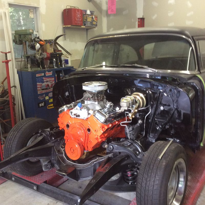

  12. rsg2506
    Joined: Mar 6, 2005
    Posts: 360
    rsg2506
    I'm moving the battery to the trunk and filled some of the holes in the firewall. I shot the firewall single stage gloss black.
    I did the dash too....
  13. rsg2506
    Joined: Mar 6, 2005
    Posts: 360
    rsg2506
    Dropped the big block in.....
  14. ChucksCrib
    Joined: Aug 20, 2006
    Posts: 430
    ChucksCrib
    from Uranus
    "Dropped the big block in"
    Probably a :10 job without the front clip off...........for most
