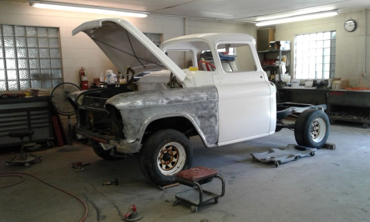

    Here's a few new photos. The front fenders are being fitted to the cab, doors and hood. A few small surprises were revealed after the factory black primer was stripped off. Although the fenders were NOS, they had been briefly installed on another truck.
    The p***enger fender had an antenna hole that had been previously drilled and patched. Additionally, both fenders had been drilled for large round turn signals, that were to be mounted on the top of the fenders, (as was done on a lot of old farm trucks). These holes had also been patched by a previous owner.
    The mounting holes for the hood emblem have now been filled, as well.

    The cab, doors, and front sheetmetal are all blocked, reprimed and ready for final paint. Took the pickup box parts to the shop and they are getting re***embled and fitted to the truck.
