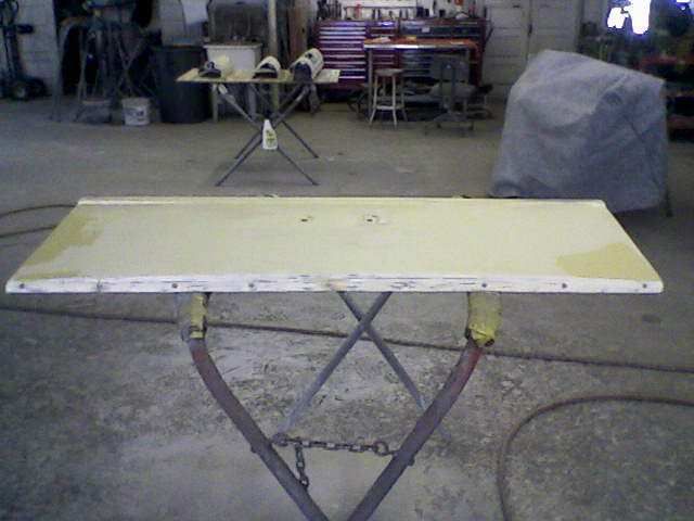

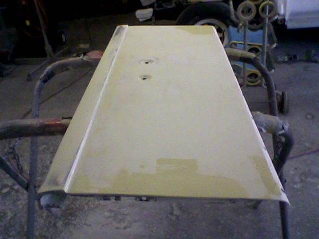

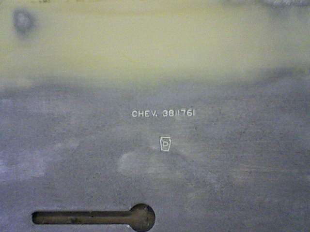

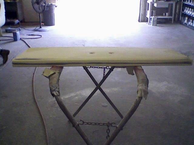

    Stopped at the restoration shop, on Thursday. The rear bumper bars are ready for their first coats of primer.
    When they were stripped, the Chevrolet part number and the "Manufacturer's Mark" of the company that actually made the bumper parts for GM, appeared. It'd be interesting to know what company actually made the bumper parts.
    The fibergl*** tailgate cover is also ready for primer. It's been stripped down to the gel-coat, with some minor repairs done. The main thing that was needed was to square off the top edges of the cover.
    When the truck was first restored, the fibergl*** area that rolls over the top of the steel tailgate was missing. This was probably caused by hauling lumber, or some other type of material, with the over-length load resting on top of the tailgate. This would have cracked the fibergl*** where it rolls over the top of the steel tailgate.
    This area was repaired in the early 1990's. However, at the time, there wasn't anything to use for a guide.....So, the shape of this area was just guessed at. As a result, it was a little off. It's now been fixed.

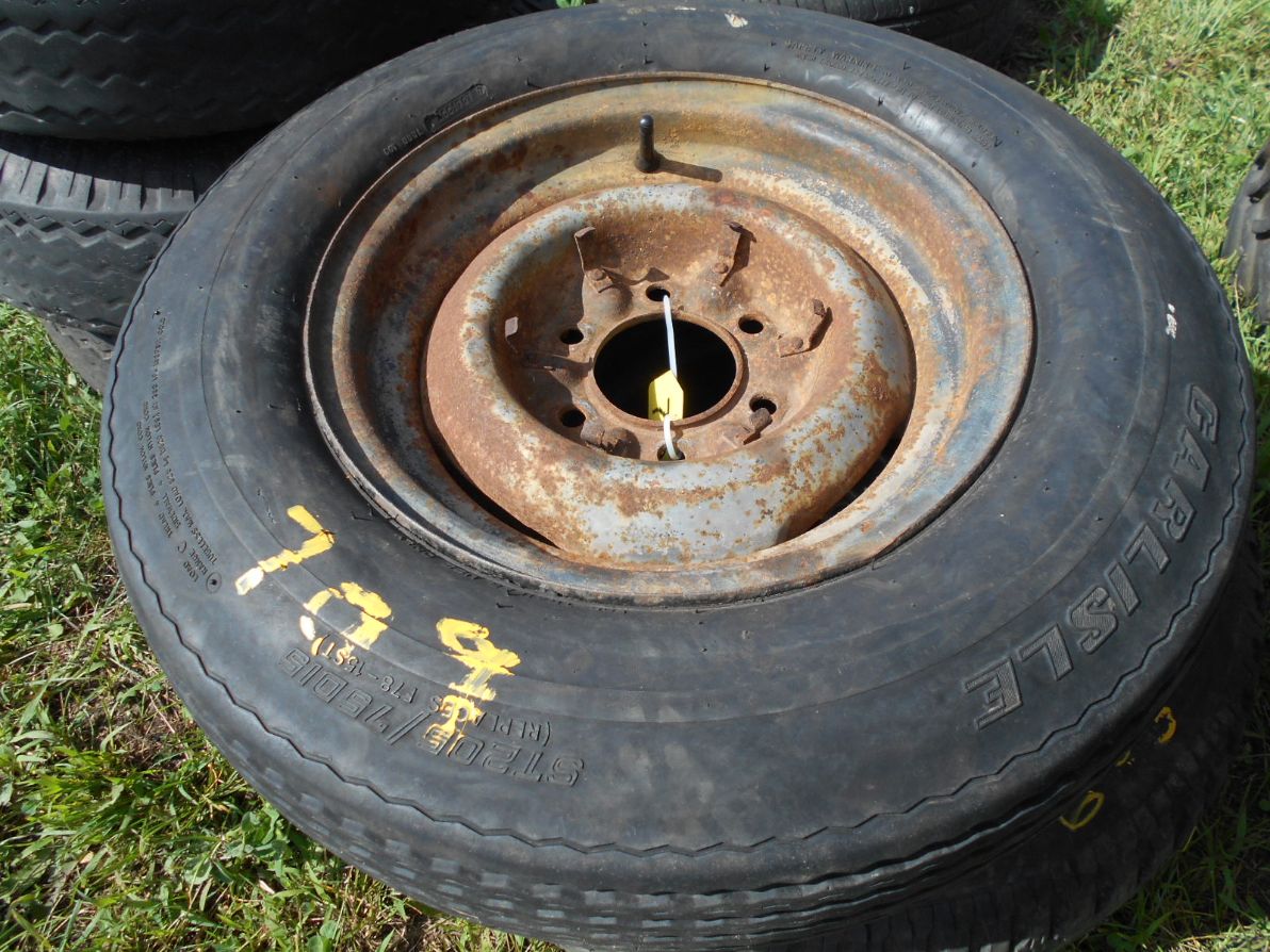

    Went to an auction yesterday, and picked up another wheel for the Cameo. This makes #3 out of 4. Still have to find one more that matches. The plan is to make a set of chrome reverse wheels, in the traditional way. Drill out the rivets, that attaches the center to the hoop.....Chrome the wheels. Then reverse and re***emble them.
    Not exactly sure what they are originally off of, though. All three are 6 lug, 15" x 6" factory wheels. They are riveted together. Additionally, they do not have the safety bead that was added, in the early 1960's, to all wheels.
    As far as I know, 1955 was the last year that GM riveted the centers to the hoops. This is why the 6" width seems VERY odd. If memory is correct, the pickup and p***enger car wheels were 5 1/2" wide in 1955. I've been told that they were optional 15", 1948 Chevy car wheels? However, it seems very unlikely that 1948 wheels would be 6" wide, from bead to bead. Perhaps, they are heavy duty pickup wheels?
    After comparing them to other 6 lug pickup wheels, they do have a very distinctive center to them. Now I just need to find a fourth one.

    The wheel that I was after was part of a set of four. Unfortunately, the other three were different, (but a matching set of three wheels). These are a bit odd in that they are not 15" wheels. Nor are they 14" wheels. They are 14 1/2" wheels, (and tires). A friend of mine suspects that they are off of a travel trailer, such as an Airstream, or perhaps off of a mobile home.
  8. To me, the centers in the upper wheel, 709, looks the closest to the original according to my memory. I don't remember the width, but I don't think the originals were as wide as 6 inches.
    The only reason I know that the wheels on the 55 were riveted, is because I drilled out the rivets on my 55 and reversed them. They were only painted, and I didn't even re-drill the holes for the valve stem, which made it a pain to check the tire pressure.
    They were only on a year before I put real chrome reversed wheels on.
    Bob

    Yes, those are mobile home wheels. They are lower profile and will not rub the floor when moving one.

    That definitely explains the other three wheels. They are also rather heavy.

    Many years ago, before we knew better, a friend mounted a set of the 14.5 mobile home tires on some 15 inch Ford wheels for his Galaxie ragtop. Don't try this at home.

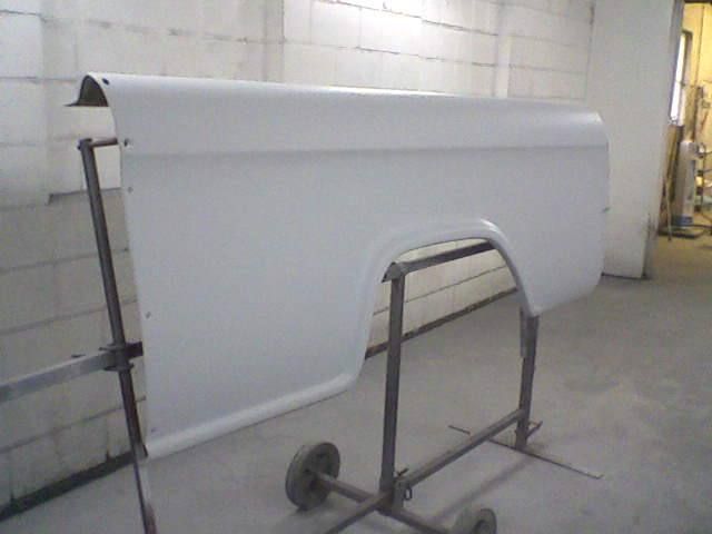

    Last week, both rear quarters were stripped down to the gel coat. Only a few small repairs were needed for the fibergl***. There was just a couple of stress cracks and one small break from when the truck was totaled in 1996, all in the left rear quarter. They have since been primed, blocked, and then reprimed.
    All of the bonding strips were in really good condition. These had been redone in the late 1980's when the truck was first restored. The fibergl*** work from the 1980's was done by Bridges Corvette Shop in Bartonville ILL.
    In addition, the fibergl*** filler panels for the front of the truck box, have been cleaned up. They still had some Jade Green overspray from when it was repainted sometime in the 1970's or 1980's. These panels needed absolutely no repairs. The filler panels will remain in their raw finished state, as they were from the factory.
    Rear Quarters In Final Prime.jpg Left Quarter Final Prime.jpg Right Quarter Final Prime.jpg

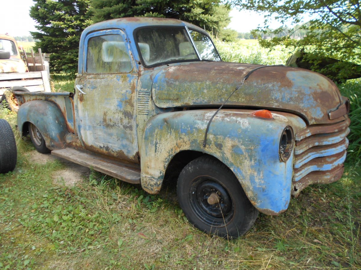

    Checked out a possible engine, today. It's a Big Block Chevy. Not sure if it's a 396, 402, or 427. Although it's in a 1970 Chevy grain truck, it is not a truck block.
    The head casting numbers are 3917215, with date codes of E88 for the driver's side head, and J127 for the p***enger side.
    Unfortunately, there wasn't enough room to see the block casting numbers. However, the number that was stamped at the front of the block is CE364277.
    From researching these numbers, it looks like it is a factory replacement block from 1973. This may or may not mean that the block was cast in 1973. It only shows that the engine was replaced in 1973. Nor does it give any indication of engine size.
    The heads are closed chamber, oval port heads. It looks like they were used on a variety of engines, ranging from 325 Hp. 396's to 400Hp. 427's. They have screw in rocker studs, and pushrod guide plates.
    I'm not very knowledgeable on big blocks, so all of this info was through the internet. Being on the internet means it HAS to be right. Right??? LOL!!!
    Surprisingly, the engine is extremely clean inside. Basically, there is not any sludge build up at all. This was looking under the valve covers, and down through the oil drain down holes, into the lifter valley. The truck itself has been sitting where it is, for at least 15 years.

    The plan is to get it started and do a leak down test. It helps that one of my nephews owns the truck. By the way, it has an Edelbrock C396 intake and a 780 Holley carb. The Holley is a Factory Chevrolet carb. complete with the part number stamped into the air horn.

    LOL....Nephew Bill can keep the rest of the truck. It's a good parts truck for his Dad's grain truck.

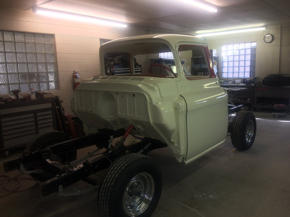

    Here's a belated update.......The Cameo is home from the body shop. The cab and doors are painted, and buffed, with the cab permanently back on the frame. The plan is to install the engine, trans, gl***, wiring, and interior over the winter.
    After this, the truck box will be finish painted, and reinstalled. The front sheet metal's final paint and re***embly, will follow the box installation Home From The Resto Shop C Dec 2019.jpg Home From The Resto Shop B Dec 2019.jpg Home From The Resto Shop A Dec 2019.jpg .

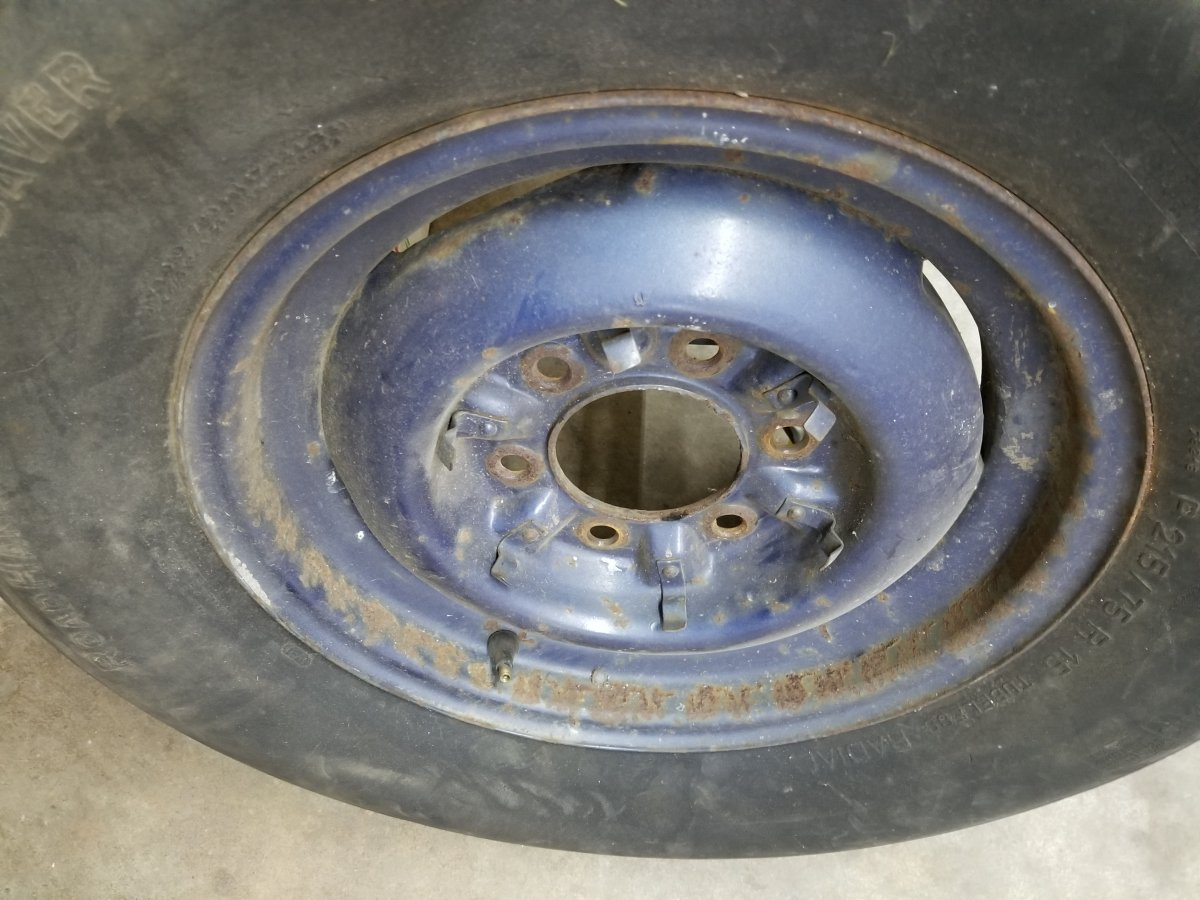

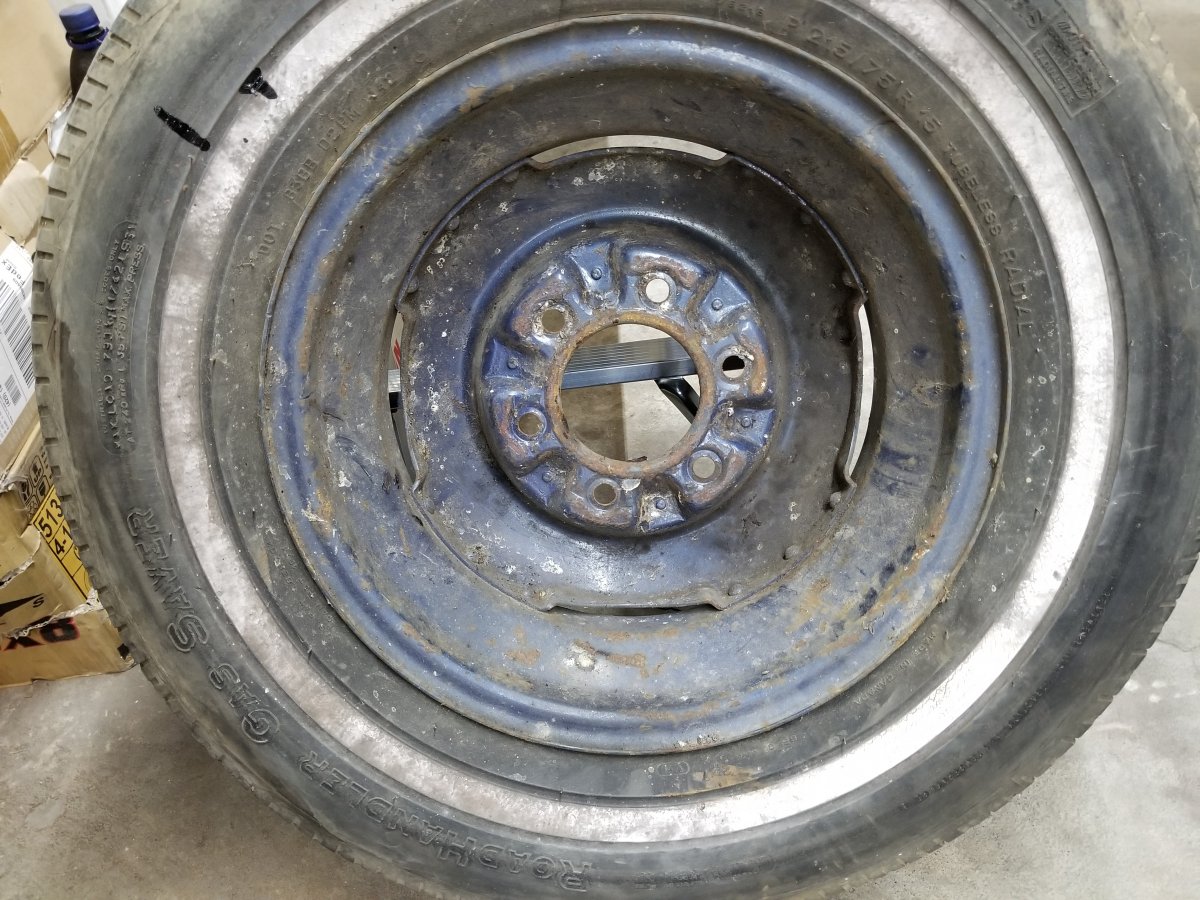

    Is this your elusive wheel ? It's 6 inches wide at the outside of the lips, obviously I can't measure between the lips because the tire is on. It was on my 57, along with 3 chrome reverse, so I only have the one.

    Thanks for checking. I'll look at mine this weekend for any markings.
    The correct wheel should be about 7 inches, to 7 1/4 inches in overall width. This being from the very outside edges of the wheel. Where the tire beads mount are 6 inches wide.
