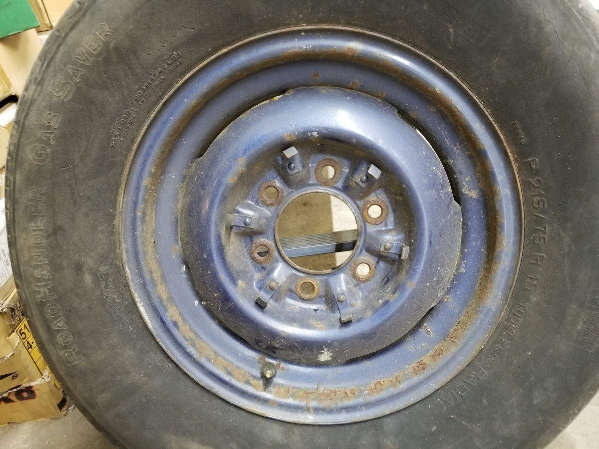

    It's tough to tell from the photos. However, if it's 6 inches wide from the outside lips of the wheel, it's probably either a 5 inch or 5 1/2 inch wide wheel, (at the bead).
    The one that I'm looking for is around 7 inches to 7 1/4 inches wide at the outside edges. It is 6 inches wide where the tire beads mount. Thank you for checking.
    That's a really nice looking wheel. It's one that would chrome up well, and could be used to make a nice chrome reverse wheel.

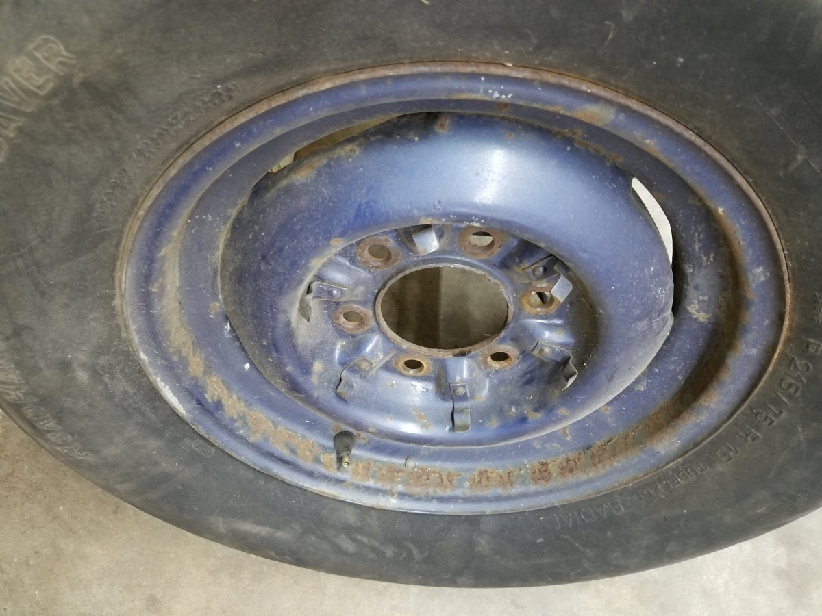

    Did some measuring on the wheels Sunday. The overall width from inside lip to outside lip is 7 1/4 inches. It is approximately 4 inches from the mounting face to the inside lip, and approximately 3 inches from the mounting face to the outside lip.
    Two of the wheels have a several layers of paint on them, so no numbers or stampings were visible. However, the third has a sticker on it. This is on the inside of the rim, and was protected by the tire that was mounted. This number is KH 48442.
    Haven't found any info on the number, but it's probably a Kelsey Hayes part number.
    Sure hope that I can find a fourth matching wheel. They would really look sharp, (and unique), chromed and reversed, like it was done in the 1950's.

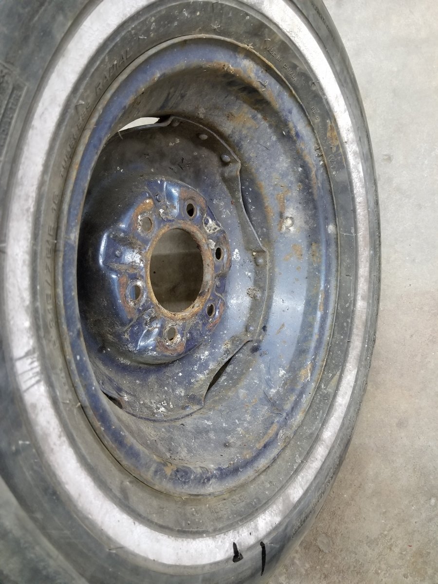

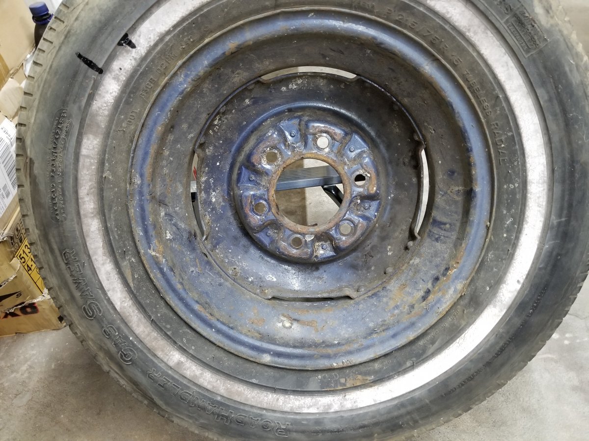

    Found another pair of H.D truck wheels. They were in Northern Wisconsin. These match the 15" x 6" wheels that I already had. Now, I'll have to decide to either paint them, (red), or make a set of chrome reverse wheels out of them.

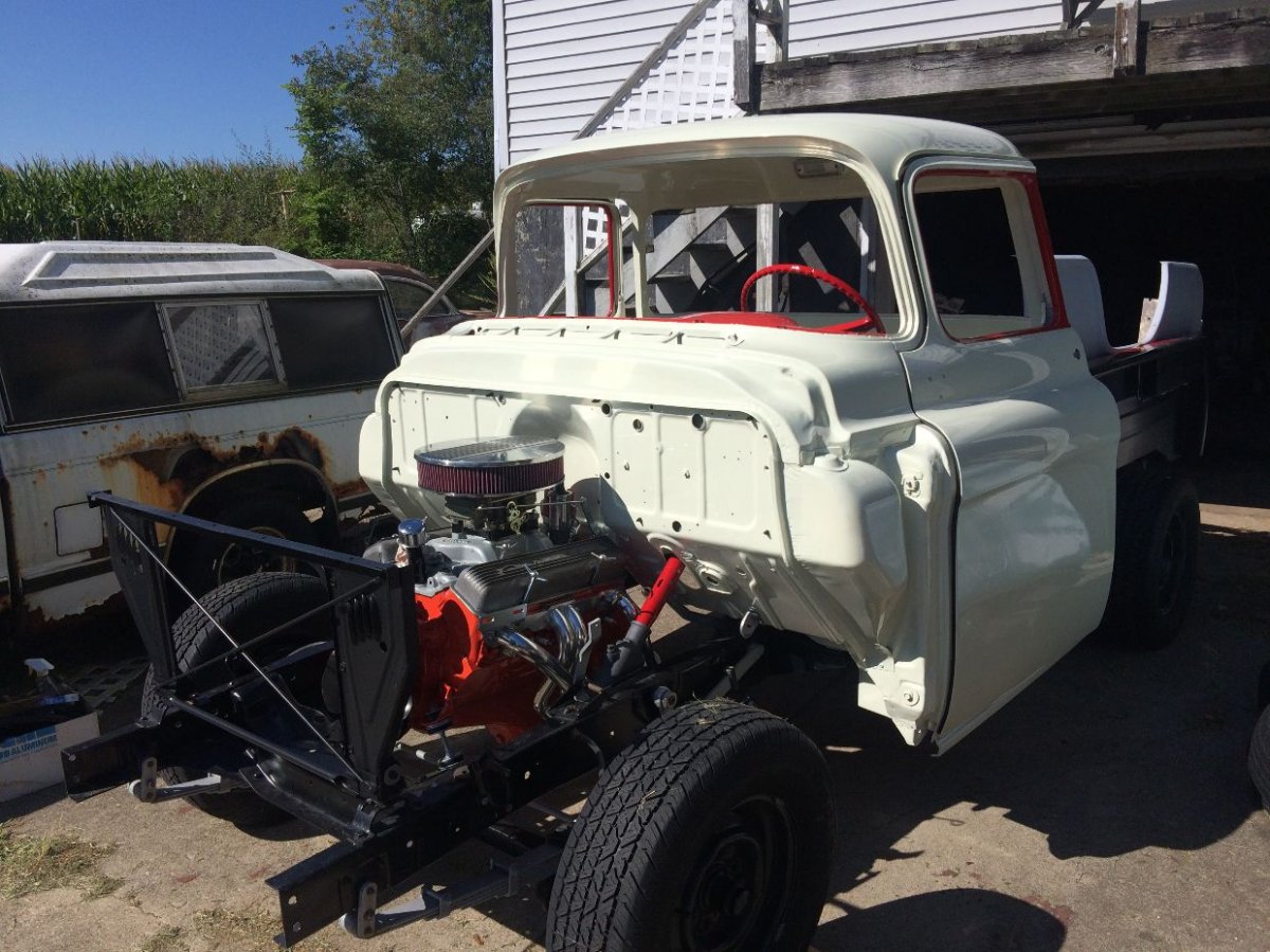

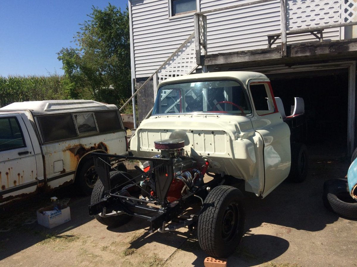

    Got a few more things done on the Cameo. The engine is installed.

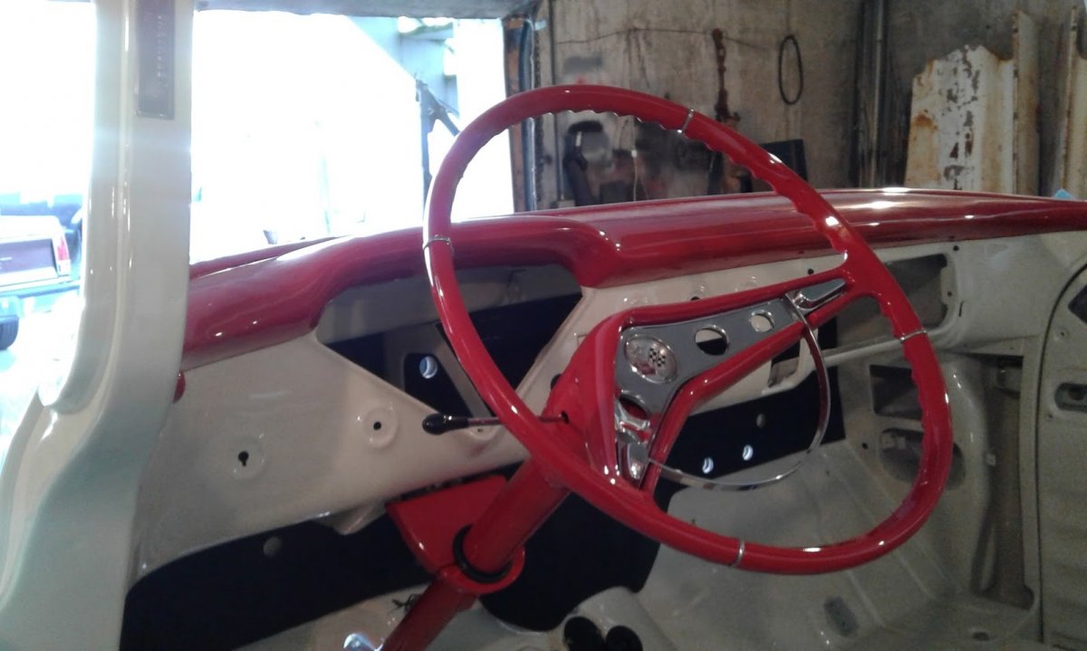

    The steering box, column and steering wheel are in, too. The steering box and shaft are out of a 58 Chevy pickup. The steering wheel is from a 59 Impala, and the turn signal housing, column shift cup, and mast jacket are out of a 56 Chevy 210 4 door sedan.

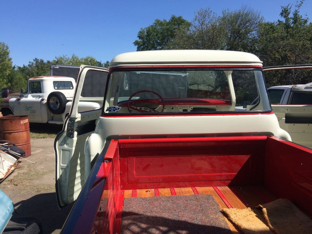

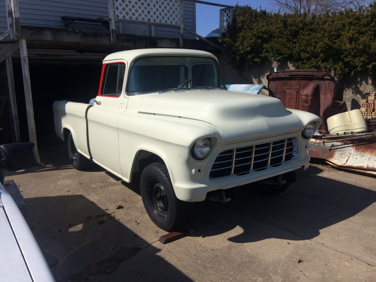

    With help from my Brother Bob, (hrbhrb here on The HAMB), and Brother Carl, the windshield and rear window are back in the Cameo. The windshield is an original out of a 56 GMC grain truck, while the rear window is original to the Cameo.
    Deuces, j-jock, simplestone and 8 others like this.

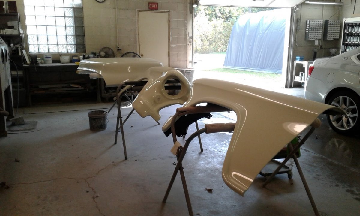

    The front fenders and hood are in finished paint, and all of the front sheet metal is back on the truck, (except for the hood). The rear fenders and tailgate are in finished paint, too. However, that roll of film is still in my camera, waiting to be used up, and sent off to be developed.
    Also, there has been another change in the transmission. I found a few original truck 4 speeds for a good price. They are Sm 420's. With the granny 1st gear, it should be great for pulling a car trailer from a stop.
    The Novak Guide to the GM Muncie SM420 Transmission (novak-adapt.com)
    Now I need to find a driveshaft for this trans / stock rear axel combination.
    Deuces, swade41, guthriesmith and 6 others like this.

    With ***istance from my Brothers Bob and Carl, the hood and rear fenders are installed. The front sheet metal and rear fenders still have to be aligned and adjusted, though. I'll be starting on that, tomorrow. Photos are courtesy of my Brother Bob, (hrbhrb here on The HAMB).
    R Front March 20 2021.jpg Rear Left March 20 2021.jpg Right Rear March 3 2021.jpg
    Deuces, rc57, swade41 and 11 others like this.

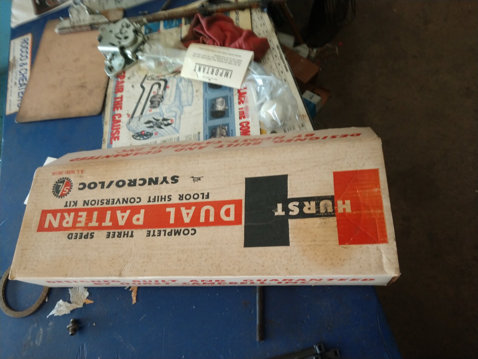

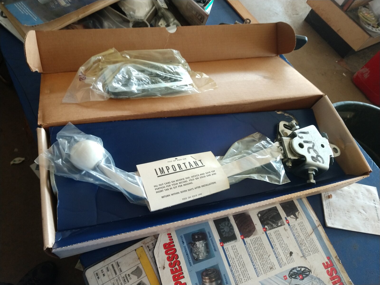

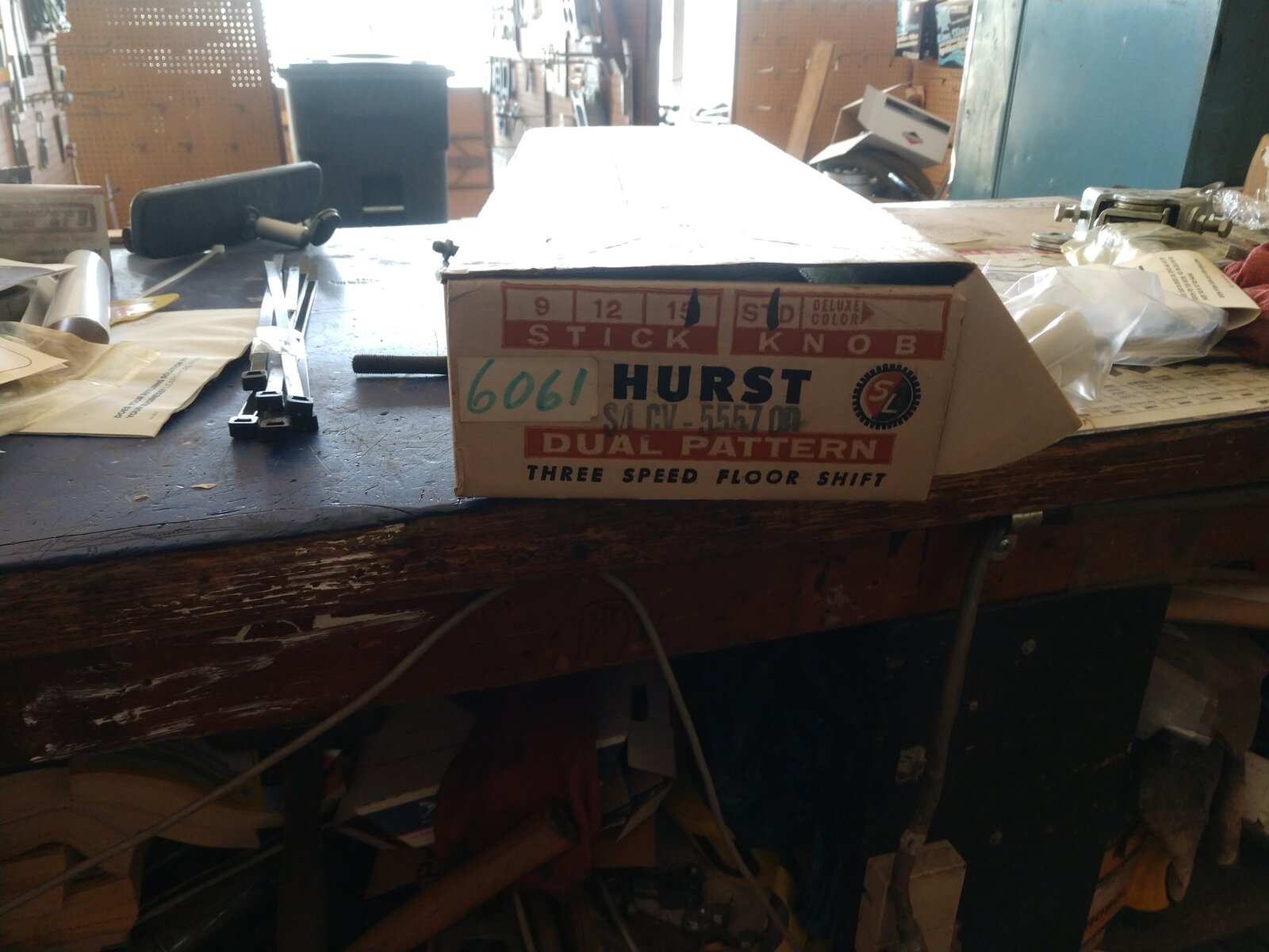

    Just bought a shifter for the Cameo. It's a NOS Hurst Syncro/Loc - Dual Pattern 3 speed overdrive shifter. From the installation sheet and other info, it was made in 1965 - 1966.
    Deuces, swade41, LAROKE and 5 others like this.

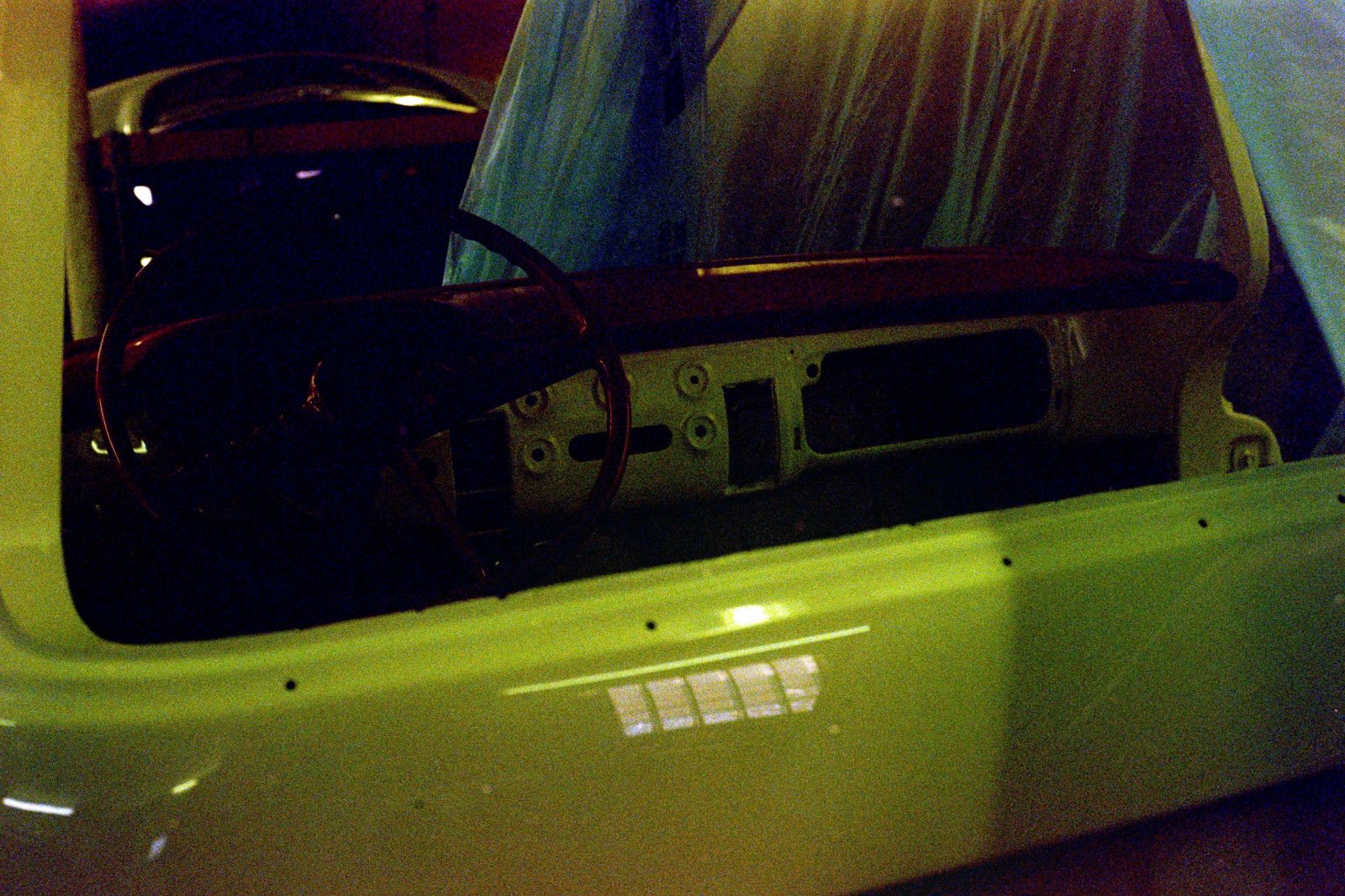

    Well, I finally finished up the roll of film in my camera and had it developed. So, here are some photos, although most are from a year ago. These are from when the cab was getting it's finished paint. At this point, the red around the cab windows has not been sprayed. This was from around the summer / fall of 2019.
