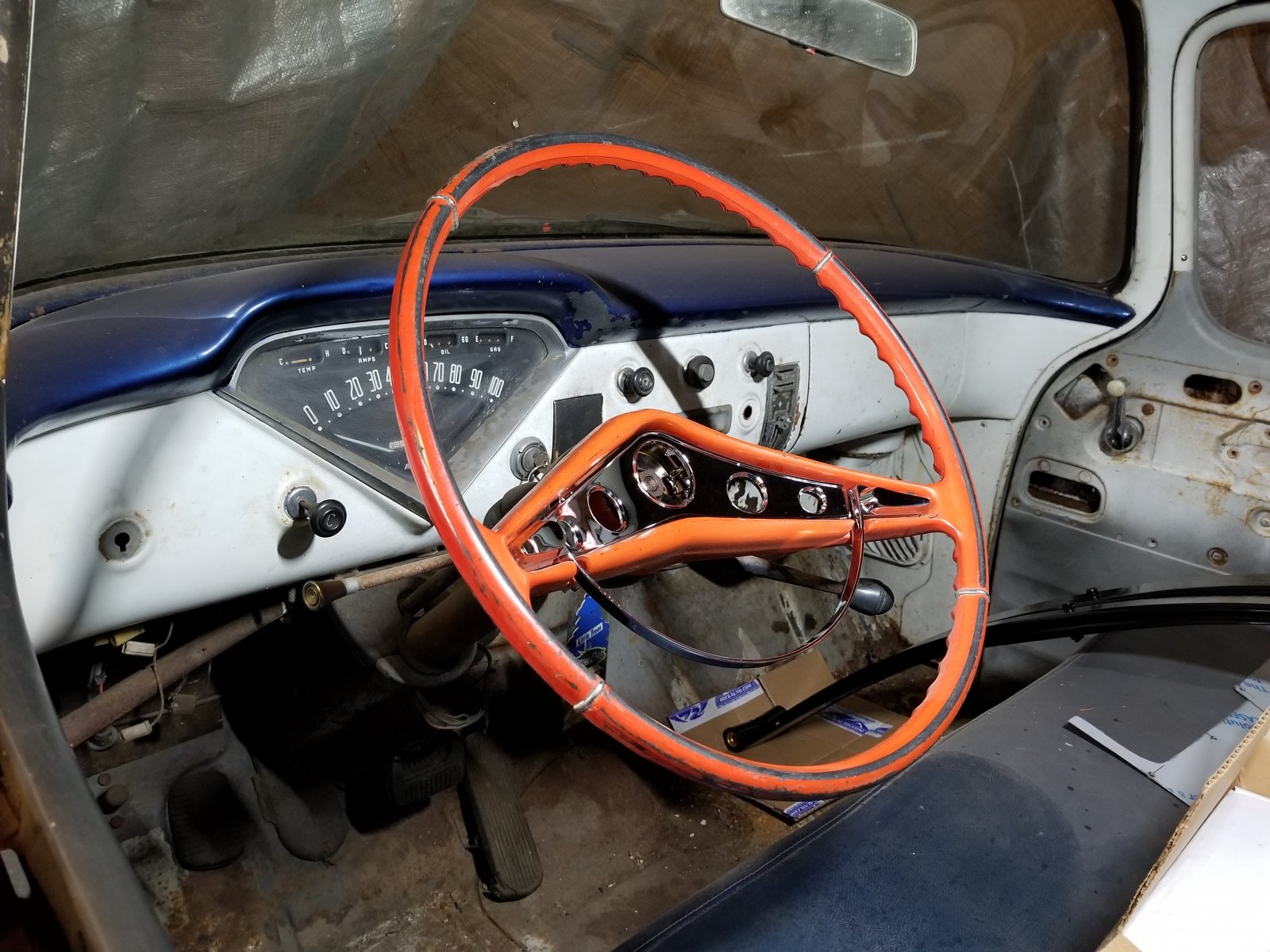

    Here's one of the steering wheel and column being painted. It doesn't really show, but the steering box and column are a combination of 1958 Chevy pickup and 1956 Chevy 4 door sedan.
    The box and steering shaft are stock 1958 Chevy pickup. The 1958 box and column was used for it's shorter length, compared to a 1955 Chevy pickup steering box and column. The shorter length is needed when using an Impala steering wheel.
    The upper mast jacket, turn signal housing, and column gear shift collar are all from a 1956 Chevy 210 sedan. The steering wheel is from a 1959 Impala. The p***enger car turn signal mechanism is a better design that the pickups. This was the reason for the change. These were taken in the late summer of 2020.
    swade41, LAROKE and loudbang like this.

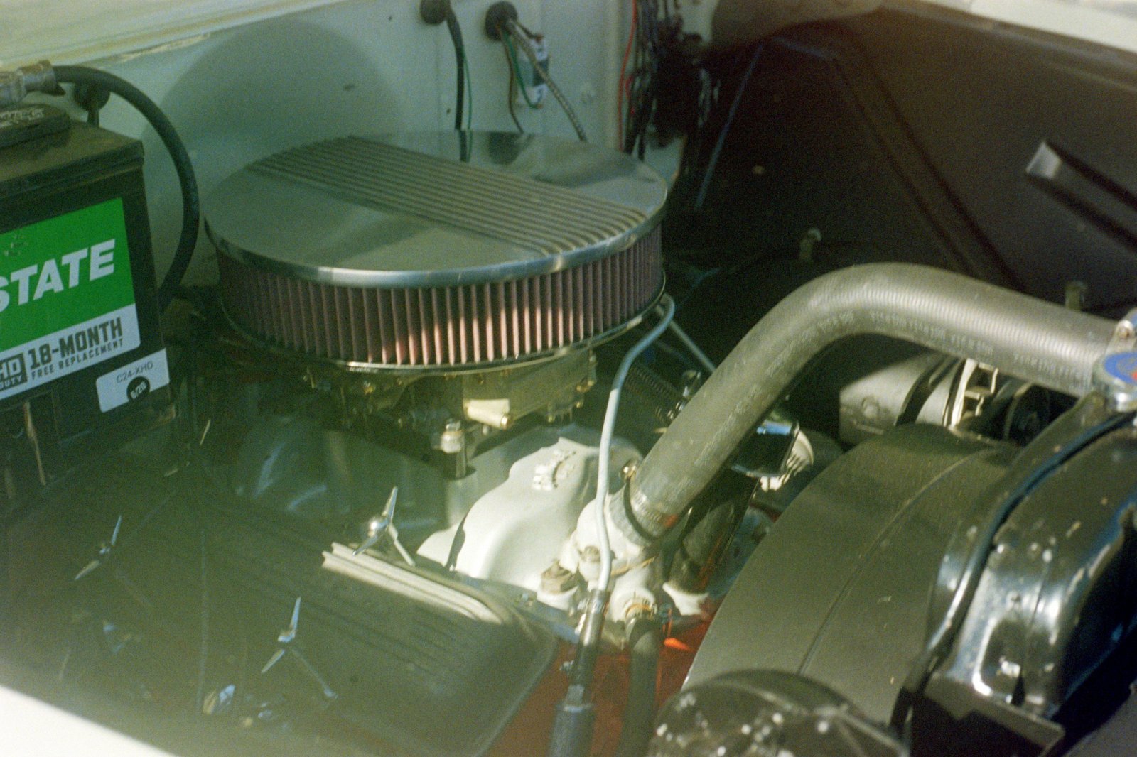

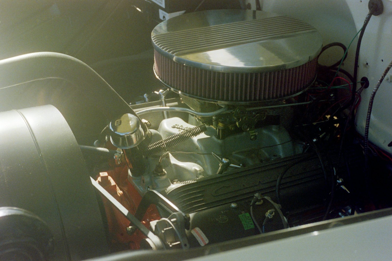

    Here are a few engine shots. The engine is a basically stock Power Pack 283. It has an Edelbrock C4B intake with a 650 Holley carb. The valve covers are Corvette, with Eelco one piece wing bolts. The air cleaner is in a Cal Custom style. The headers are ****** Super Comps. The distributor is a Mallory Unilite.
    The generator was remanufactured in 1980, but was never installed until now. The fan shroud is a combination of 1963 Impala small block and 1959 Chevy 60 series grain truck with a 348. The radiator is the original one from the Cameo....All copper and br***. It did have to be recored, though. The radiator was wrapped around the fan when the truck was totaled in 1996.

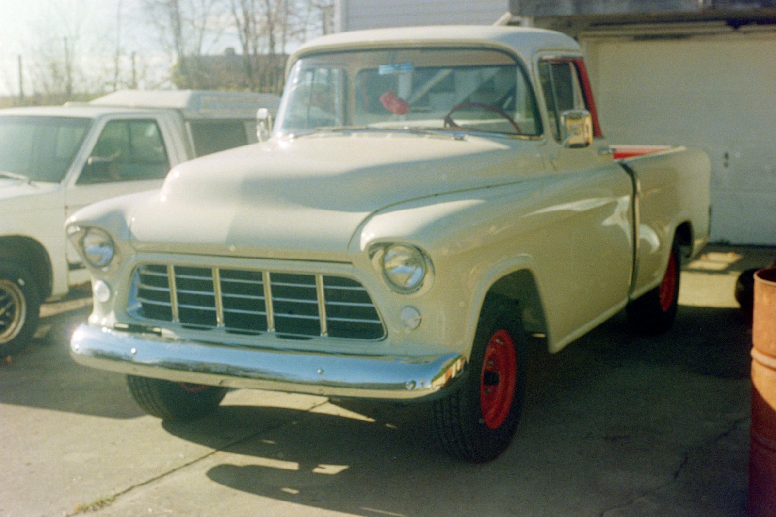

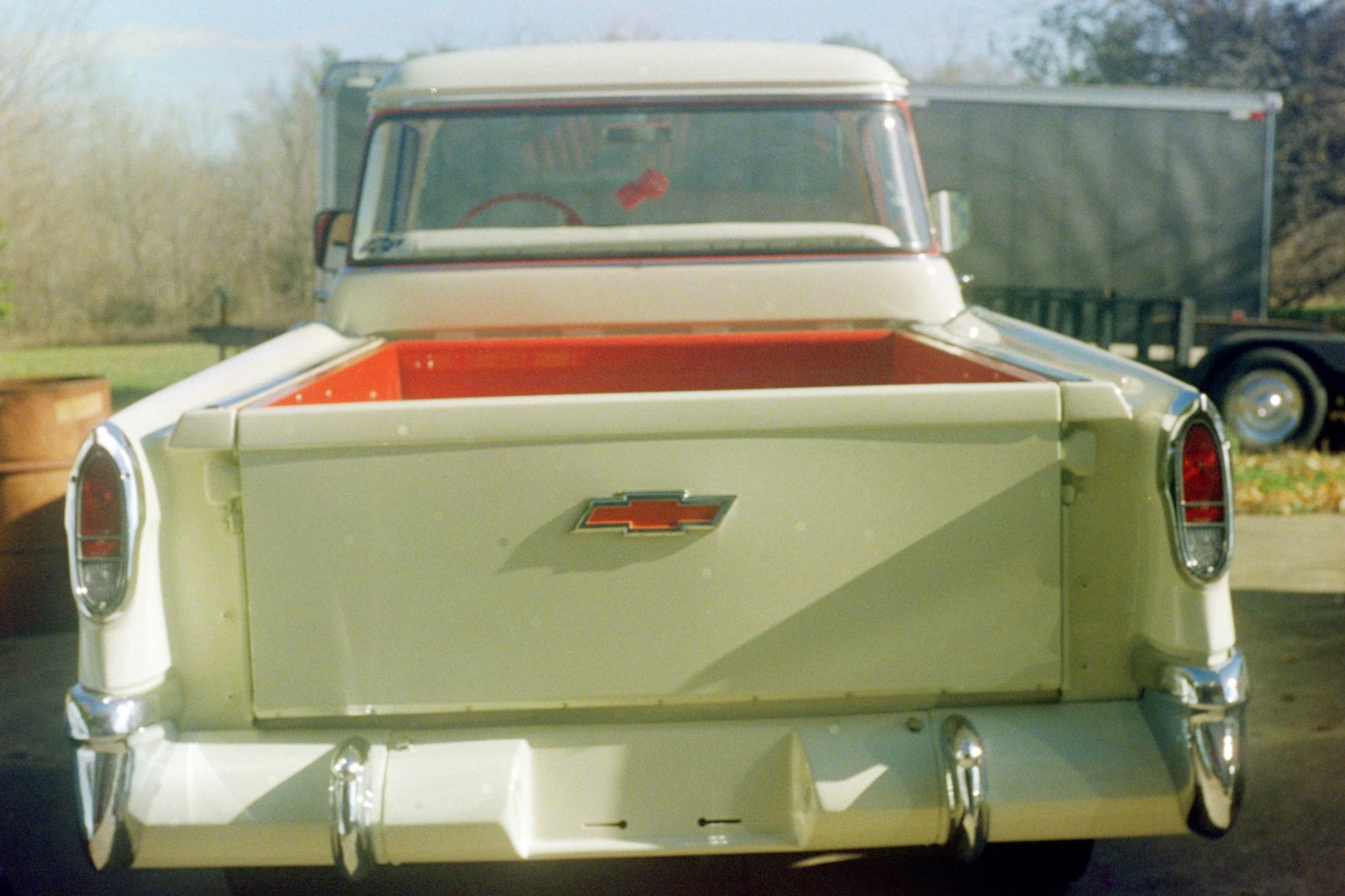

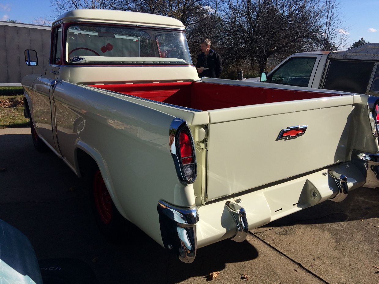

    Finally, here are some exterior shots. It's basically done, except for the exhaust. Cutouts and the tailpipes exiting out the side just ahead of the rear tires are planned.
    Sometime, I'd like to get the front axle dropped. Not sure how much, though. The trailer hitch also has to be installed. Unfortunately, to put a hitch on the truck, I have to leave the spare tire carrier off.
    Although it's basically finished, it has not been started, yet. Weather permitting, that will happen this Sunday.

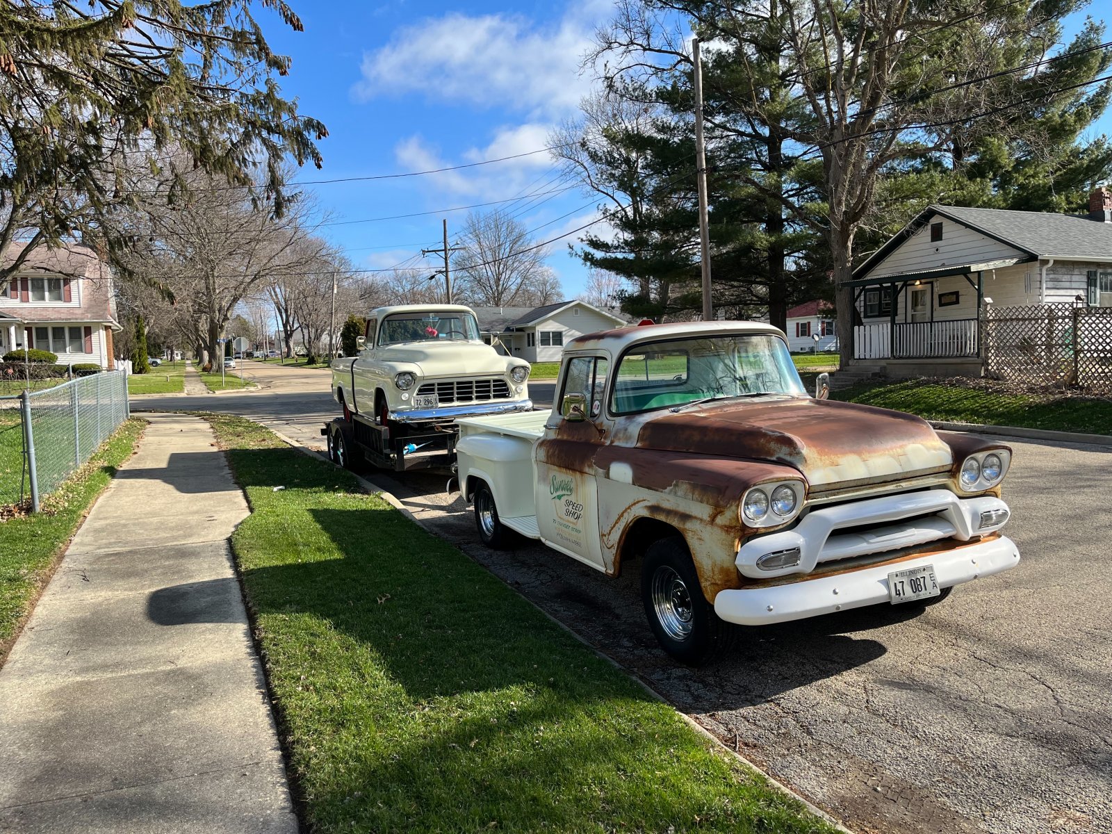

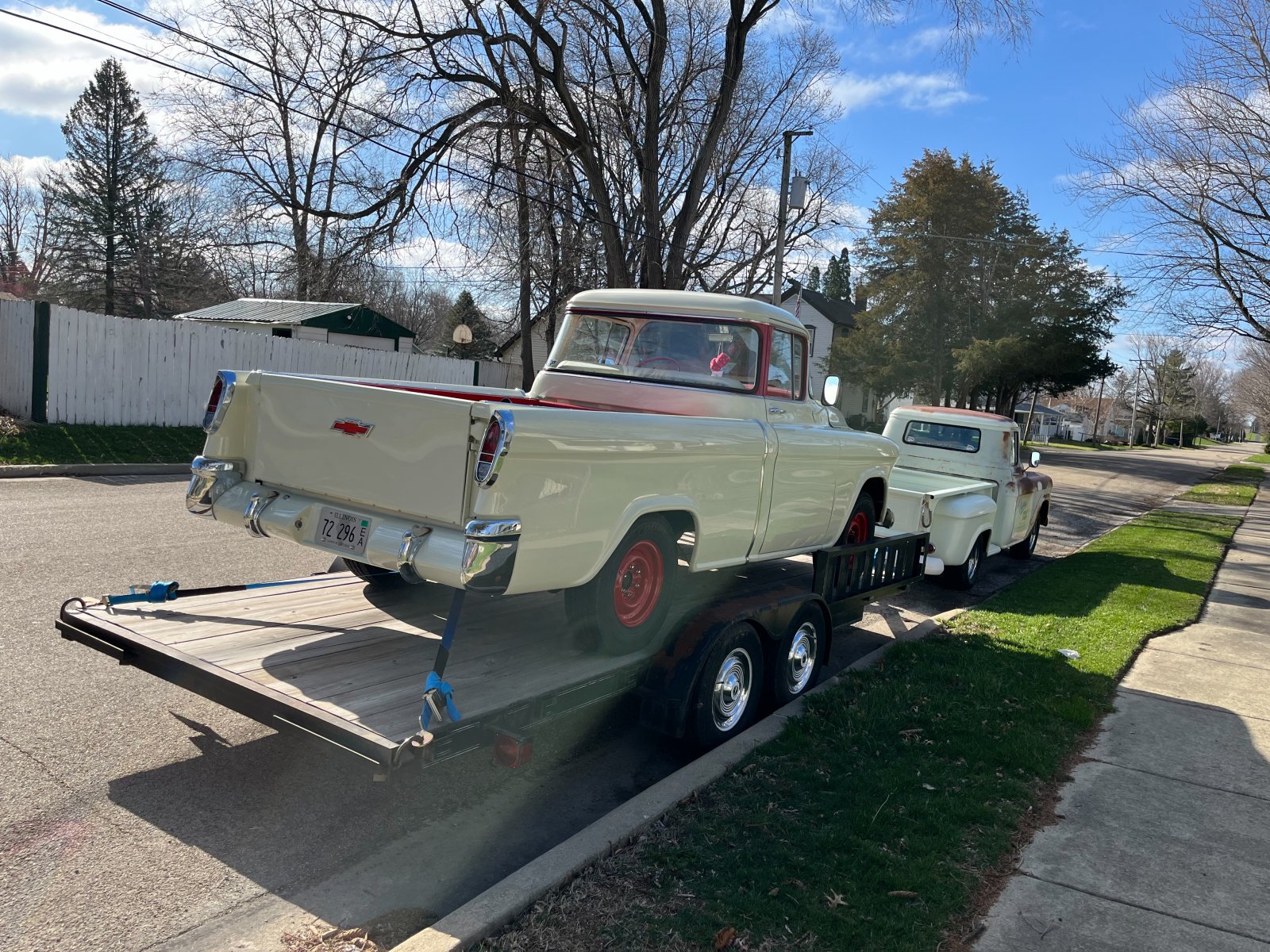

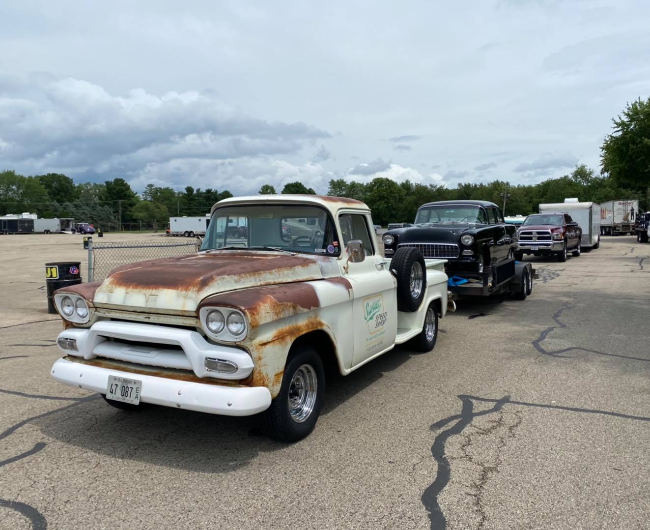

    Thank you. It's literally the nicest it's ever been. However, as good as it has turned out, it will not be riding on a trailer. Instead, it will be pulling the trailer...To the drag strip with my black 55, (replacing my 59 GMC as tow vehicle).

    Thanks, Phil. Actually, the GMC might be up for sale next summer or fall.

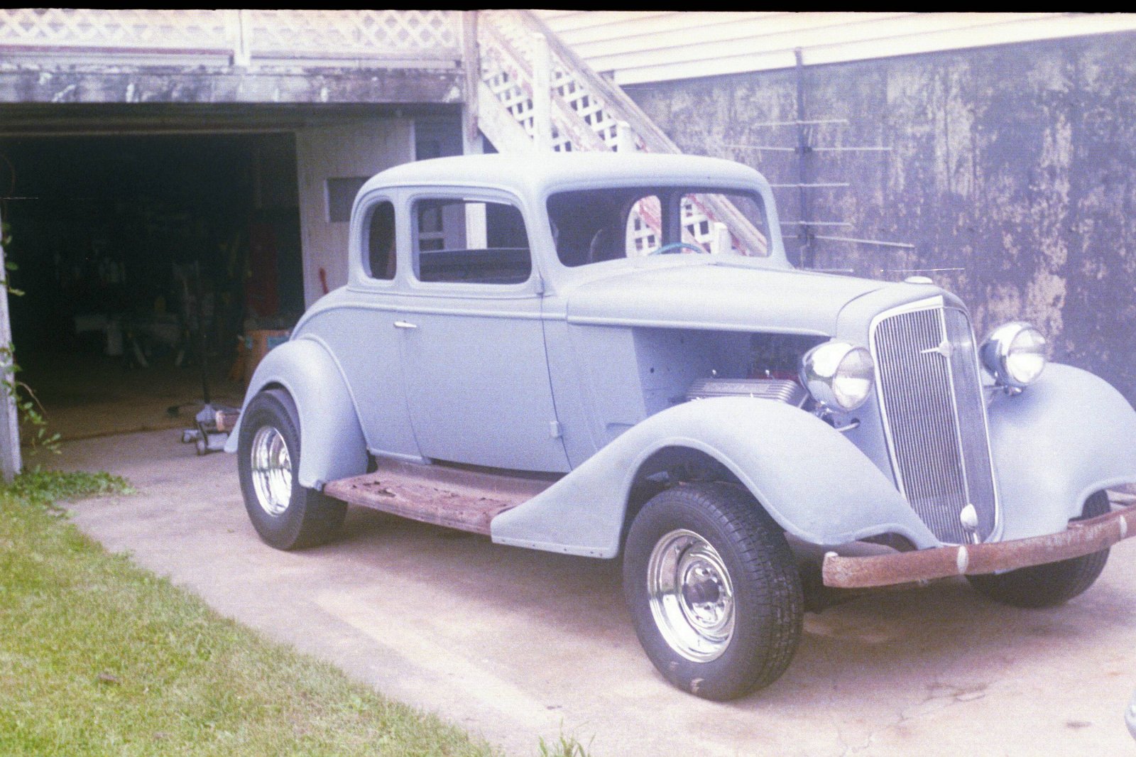

    I'd like to get started again on my 34 Chevy coupe. Quite a bit has been done, but it's been on hold since about 2014.
    Projects - 1934 Chevy Coupe Build. | The H.A.M.B. (jalopyjournal.com)
    However, I'd really like to get started on my 56 BelAir. I've known the car since 1980 when my best friend from high school dragged it out of a junk yard. This was just before my Senior year started. I've owned it since 1994, but it hasn't gotten past the parts collecting stage.
    Unfortunately, it's REALLY rough. It was sold new in Anchorage Alaska and went through the Alaskan Earthquake of 1964.

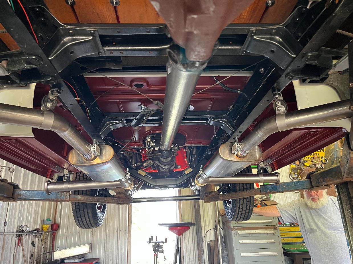

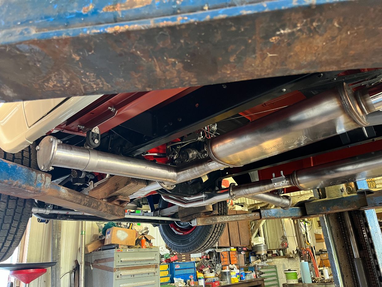

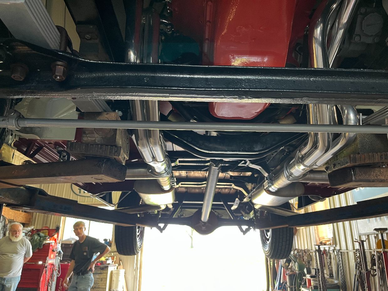

    A few weeks ago, the Cameo went in for the exhaust. It'll have cutouts with the tailpipes exiting right in front of the rear tires.
    So far, I've put about 20 miles on it so far. They were kinda loud with open headers. LOL! I still need to fix the charging system and reinstall the heater core.
    The trailer hitch will have to be custom made. Learned a couple of weeks ago, that Cameo frames are slightly different from the short bed stepside frames. The bottom side of the frame rails were slightly trimmed at the factory to clear the spare tire carrier. As a result, there isn't enough metal on the bottom of the frame rails to drill the mounting holes for a store-bought hitch.

    With help from my older Brother Bob, I drove the Cameo home from the exhaust shop. Here are a few photos.
    New Exhaust 5 12 22 A.jpeg New Exhaust 5 12 22 C.jpeg New Exhaust 5 12 22 D.jpeg New Exhaust 5 12 22.jpeg
    Deuces, OahuEli, 59Apachegail and 9 others like this.

    Very clean detailed work, I like that you're using it to tow the 55 to the racetrack, that's my plan for my 57 pickup too.
    What type of paint did you use on the steering wheel and does it seem to be holding up ? I need to paint mine too.
    LOST ANGEL, Budget36 and Torkwrench like this.
  29. Torkwrench
    Joined: Jan 28, 2005
    Posts: 2,751
    Torkwrench
    Thank you. It's great that you'll be using your 57 for towing to the race track.
    I'm not sure what the type of paint was used on the steering wheel. Base / clear perhaps? That's what was used everywhere else. I did about 85% of the mechanical & ***embly work, but I'm not a body & paint guy.
