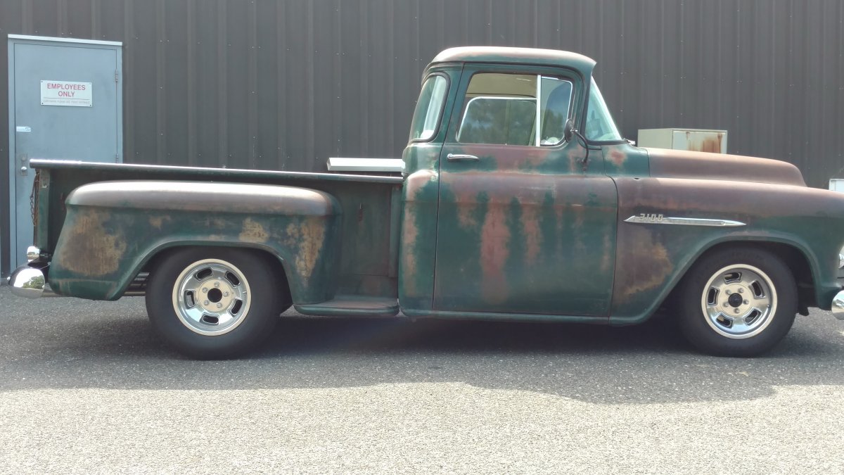

    2 leaves removed. 1 1/8" sway bar. Modified a Geo tracker bar. 20170702_155249.jpg 20170702_155712.jpg

    I drove it hard today and the slight body roll it has left was very tolerable. But I ordered a front sway bar and will install it when it comes in.
    I'll report if it's too tight or made it even better.

    **** UPDATE 7/19/17 ****
    Well I installed the new 1 1/8" front sway bar. Truck is even better. Really thought it was going to be to tight but it's not.
    If I ever get to ride in a truck with a MII front suspension I'll compare the two.
    My truck came with a dropped axle so that's why I added to that setup.

    Front sway bay added even more stability. Very happy with the set up. I just sold the truck a few weeks ago and the gentleman drove it from my place in NJ to his home in Michigan and loves it.

    I took your advice on the Bilstein shocks up front from Posies. Tough shocks! Yes, I had the Monroes.. Always hit bumps hard. Seem to work on the rebound only. I don't have a rear sway bar....yet! Up front is a factory 7/8" sway bar from a Panel truck. It's just ok. I believe it was just to help the top heavy Panels. I noticed that all the aftermarket sway bars are 1" front & 7/8" rear. The Bilsteins are a big difference. The truck may be fine now. Road test will tell. Anyway, thank you for your input.

    I did similar mods to my 57 and got great results, I’m fairly convinced it handles better than it did new. It’s a blast to drive.
    I had Sid drop the original axle, re-installed with 4 degree caster shims, Posies super slider springs, Bilstein shocks, and a front sway bar.

    3" drop
