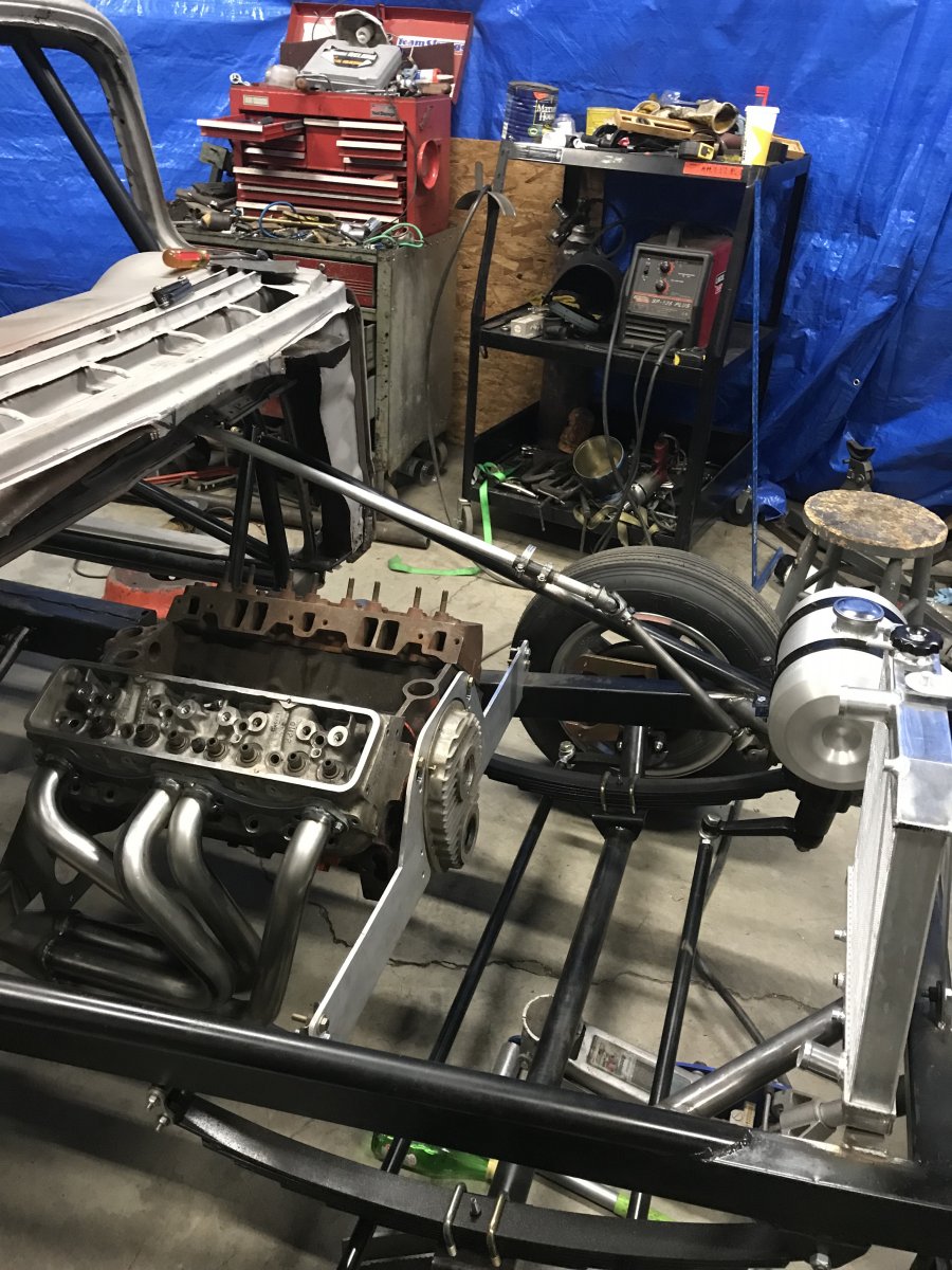

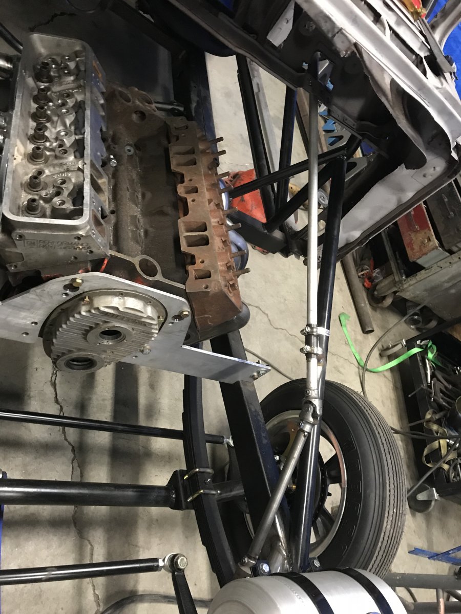

    9D25FB09-6239-4022-98AD-E9CE3B53345A.jpeg 949007FE-D599-41B6-B76E-E344D119FF14.jpeg D5F57C99-FB17-4E95-BB41-37E446D953E4.jpeg 5E9105BB-672C-42CB-AE74-10B2657E9B48.jpeg 1BB4FC89-589F-430A-A98F-DBD051DCC72B.jpeg 75C1D923-E6F5-475E-808F-4B0CB0C7532D.jpeg A94138B4-67B7-449D-AFCC-CA913B8FCE2F.jpeg 3612C83F-76A8-409C-894B-4DDE2D92EE3C.jpeg Got the headers painted and bolted on. Gotta paint the radiator but just put it back on to get an idea of the finished product. It’s gonna look light and radical. The list of things to do is getting shorter and shorter!

    6E2E0F29-E3B5-44BF-AA4B-7F213A32D7CB.jpeg 91057179-0CFE-4054-8415-1EC043B366D8.jpeg
    Headers, ignition, radiator, gas tank, battery, driveshaft, engine is full of oil, and everything on it. 2220lb. Only things left to add is the firewall, brake lines, minimal wiring, lexan, and water/fuel. Should weigh 2270-2300 race ready minus driver. Later on it will get light weight racing aluminum brakes, it’ll be even lighter. Not bad for a big car with a Big block Chevy in it.
