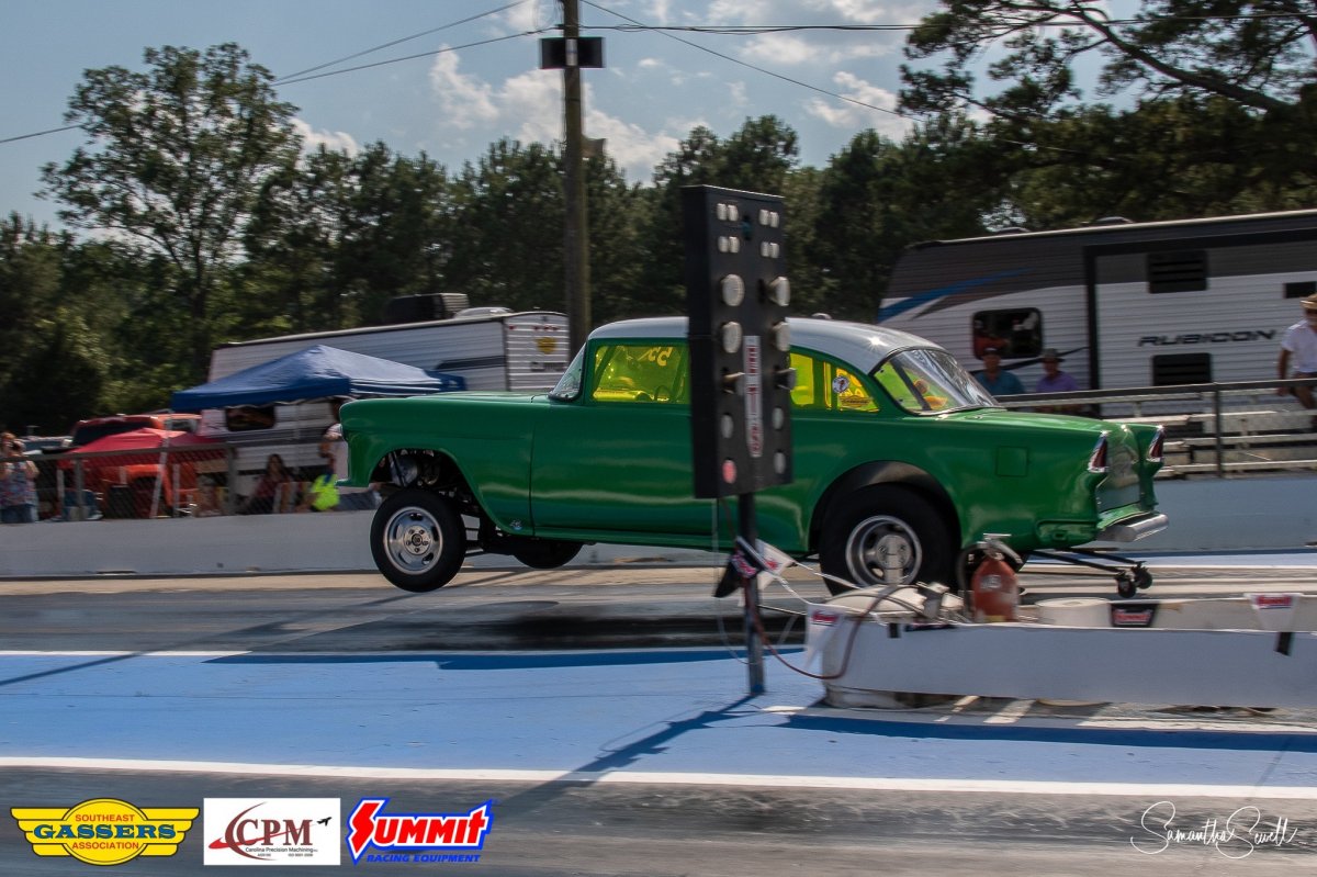

  23. Zak Hall
    Joined: May 11, 2015
    Posts: 712
    Zak Hall
    6CE43BEB-BC8D-4F80-87E6-973ABBB9D135.jpeg 82E3DAE4-D659-40C9-84CB-9282D9AE3DC0.jpeg Wheels up in 3rd!

  25. southcross2631
    Joined: Jan 20, 2013
    Posts: 4,412
    southcross2631
    After watching some video's of your car running and some still shots . You may actually have too much bite in the car. You may be spending more energy going up and not forward? Just an observation from me . If you have the adjustability raise your front ladder bar one hole and try it at a test and tune.
    With the blue coupe in my avatar I had so many p***es on it and so many times adjusting the ladder bars. I could tell you ahead of time how high and how far out it would carry the front tires.
    Zak Hall and enloe like this.
  26. Zak Hall
    Posts: 712
    Zak Hall
    At first I had to much separation and it was smacking the wheelie bars on the ground. Tightened the extension up on the shocks and now it’s hookinh but trying to unload in first once it hits. I’m going to tighten the compression up a couple clicks next, and pull the wheelie bars down a little. If it tries to hit the bars real hard, I’ll move the ladder bars up one hole and see what happens.
  27. Zak Hall
    Posts: 712
    Zak Hall
    The big wheelies look good and fans like them, but they don’t win races! That’s 2nd gear there.

  29. southcross2631
    Posts: 4,412
    southcross2631
    The blue coupe in my Avatar had a powerglide and it actually had a faster 60 foot with the back tires than if I didn't pull the wheels and broke the 60 ft. beams with the front tires, but with a 4 speed it is a whole different all game as you are finding out. I will be sorting out my Morris Minor in a few weeks trying to get ready for the Va. race.
    With my 87 inch wheelbase I am sure wheelstands are going to be an issue. Good luck with your adjustments.
