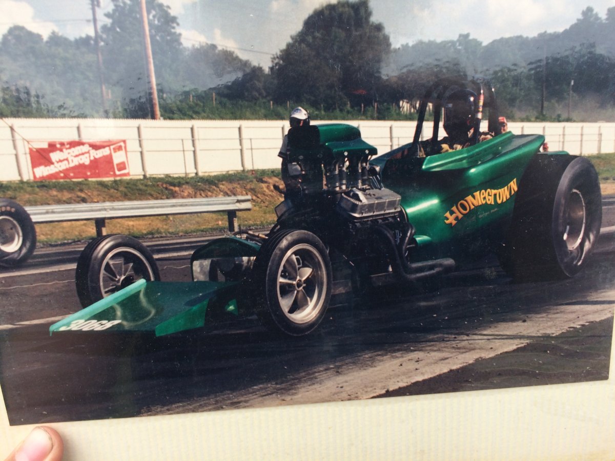

  14. Zak Hall
    Joined: May 11, 2015
    Posts: 702
    Zak Hall
    IMG_0680.JPG I think we've decided to name the 55 Home Grown also, but paint it green and do the lettering like dads altered he built and raced.
  15. loudbang
    Posts: 40,344
    No wonder you do so good, it's in your genes LOL
