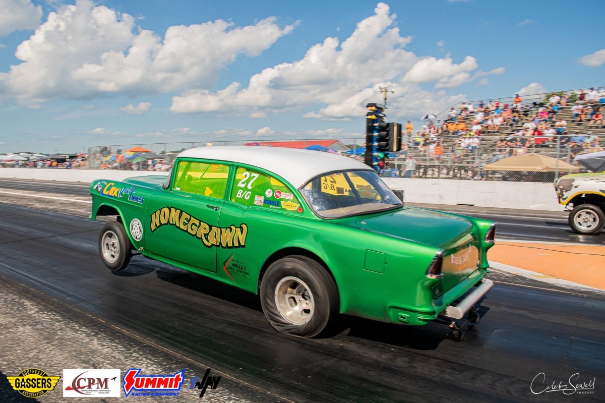

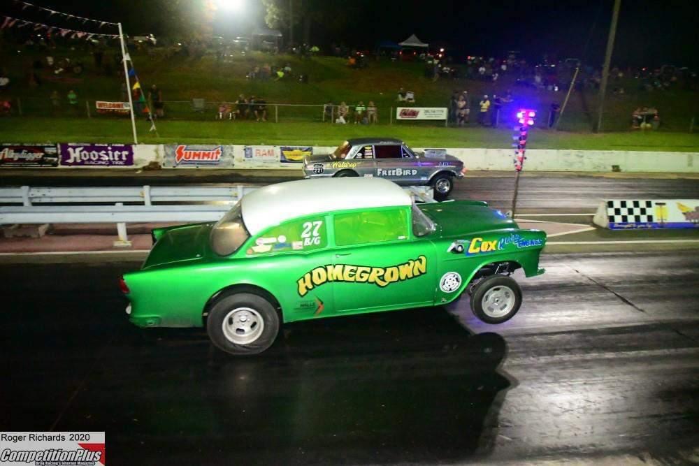

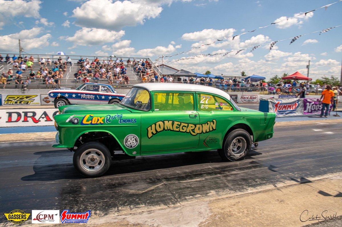

    55F18A55-BC85-4E4C-8693-A690F105A58D.jpeg D887F72C-A503-410F-B15D-8558A08F9A89.jpeg 03B49179-B96B-4945-996D-5078D3C54962.jpeg 70539281-83D4-4950-B978-91EAB5D87E54.jpeg F6EF52F1-2BCB-4A2F-B884-1D4EA4272AD3.jpeg FD9ED69D-F2A6-49EA-9403-FFE95CC6822D.jpeg 1A877764-0698-44EE-9205-DF38A78D4E6B.jpeg 7057D78E-8493-4BEC-9A32-6F7EBC8C4192.jpeg E8588742-29CE-41A6-AE75-DFEE5A84EA00.jpeg 809FB49B-6002-45CE-89B5-68B22C4BF3BB.jpeg FBF8F95E-EE7E-4323-B472-FAD927D140AB.jpeg A few more pics from London courtesy of Caleb Sewell photography and Dave Anglin

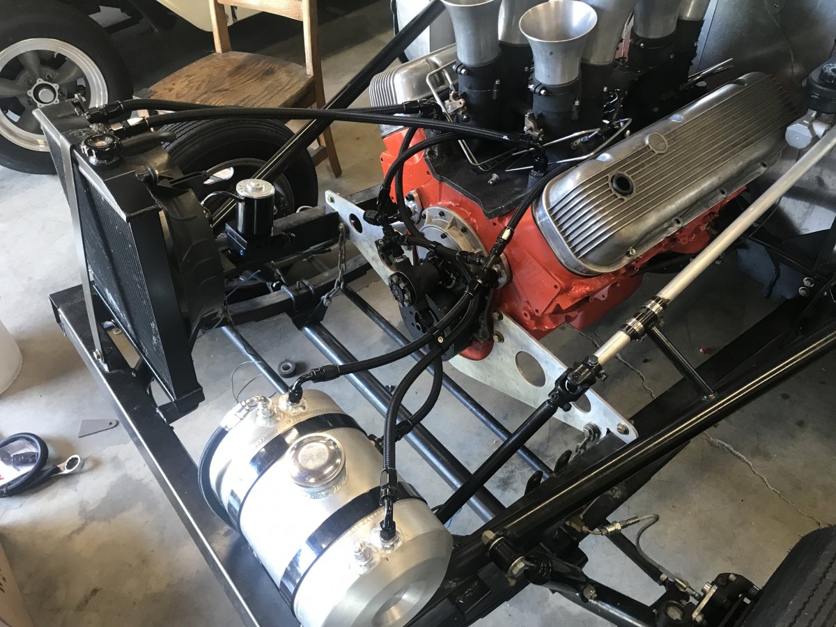

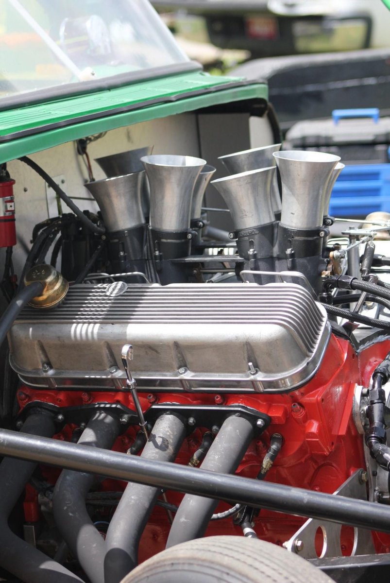

    That engine bay is very sano!! It’s clear that someone who knows wtf they’re doing built this car. Great job Zak you and your pops oughta be proud of yourselves that’s a *****in car. How are you circulating water with the fuel pump off the cam??
  5. Zak Hall
    Joined: May 11, 2015
    Posts: 712
    Zak Hall
    I run a meziere remote mount electric water pump. It’s black and behind the radiator mostly hidden.

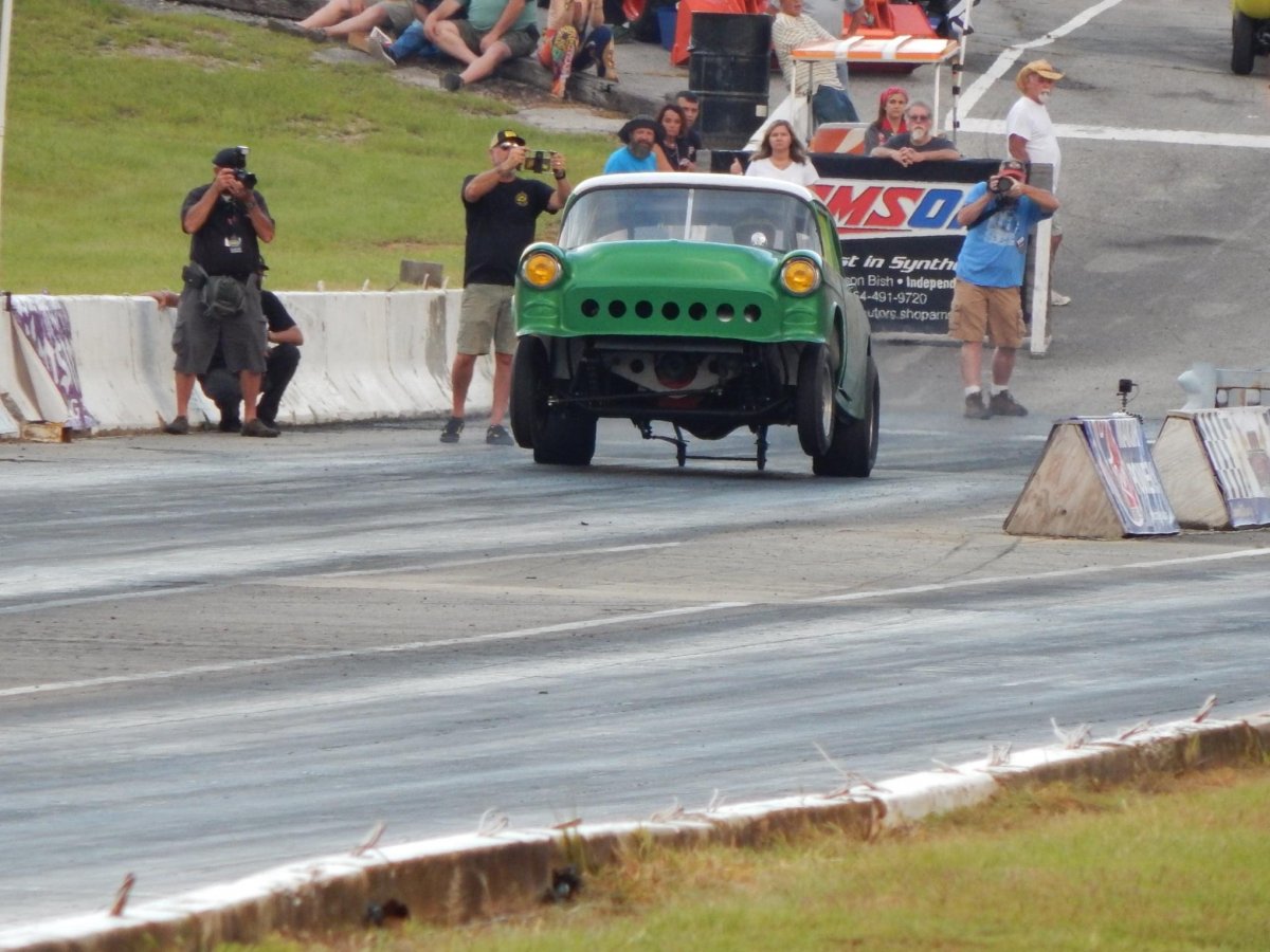

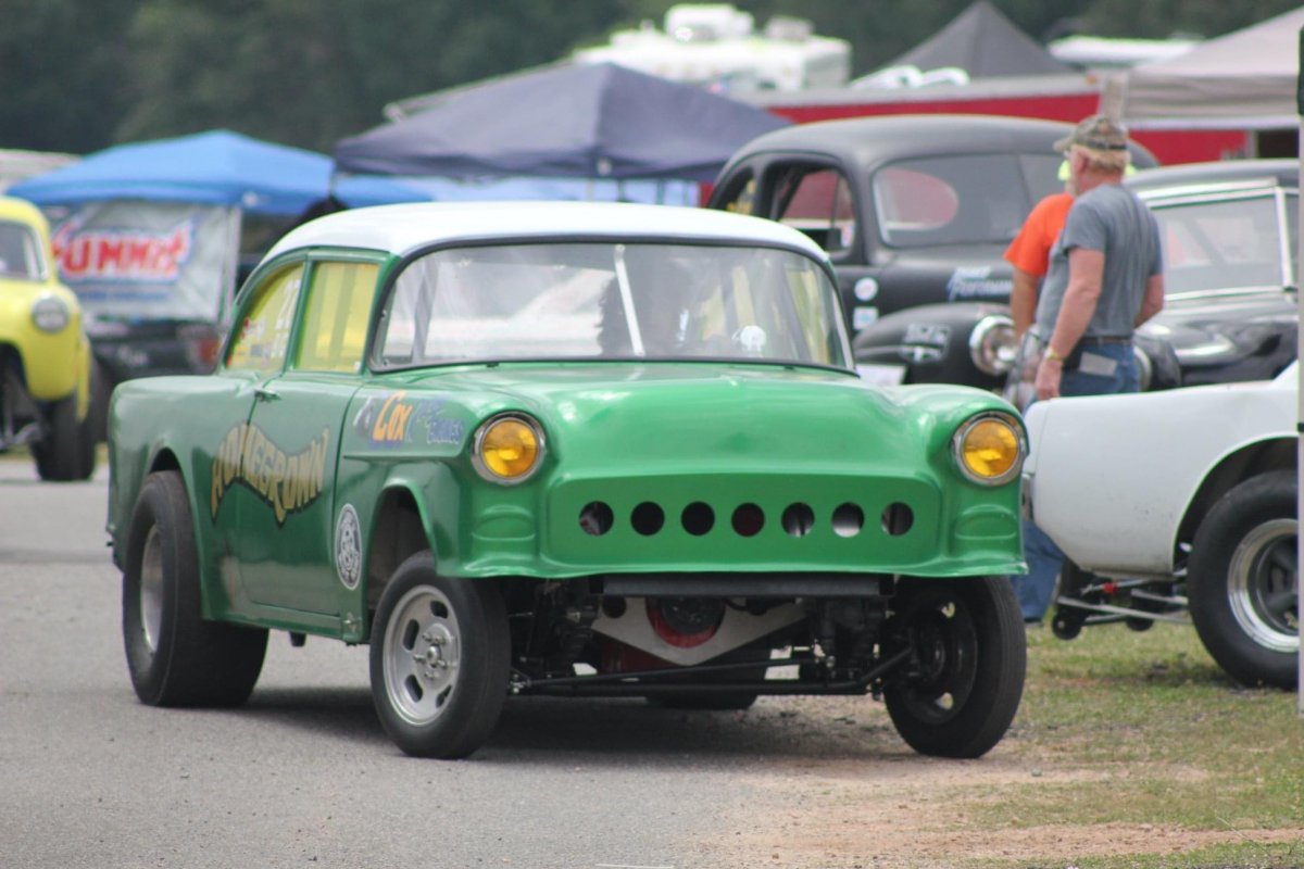

    Please excuse my ignorance, but what are the chains for that are mounted at each end of the motor plate and at each spring pad? Are they travel limiters for the front suspension when you lift the front wheels?

    Yes those are suspension limiters to help keep the nose under control especially when shifting it keeps the nose from bouncing down and rebounding up so high!

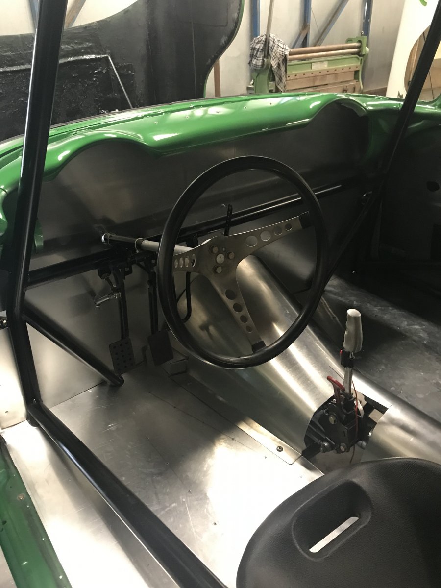

    Hey Zak, do you have a picture of your dash and interior. I don’t recall having seen the inside of the 55.
  13. Zak Hall
    Posts: 712
    Zak Hall

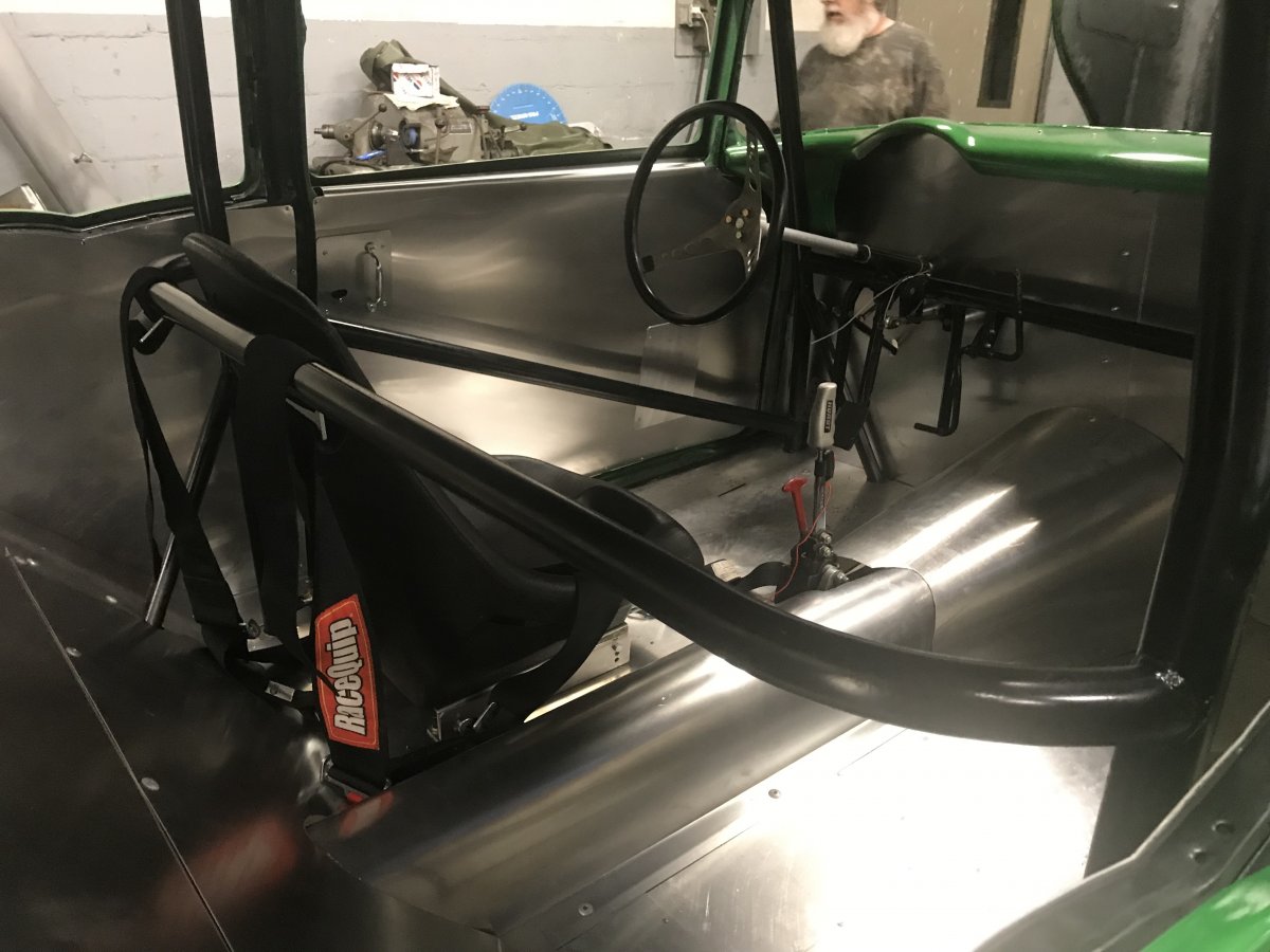

    It’s nothing exotic, the firewall is so far back that it is even with the dash so all I have are a small oil pressure an water temp gauge, and a tach on the dash. The tunnel and rear panels are all removable with dzus fasteners to make for easy maintenance though.

    Thanks Zak, it looks great! My fire wall is in about the same place so it gives an idea.

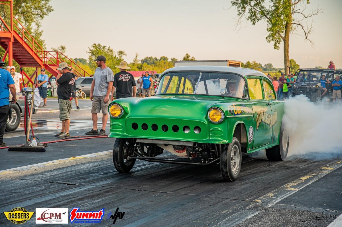

    Maybe if you would cut off the front grill section and install the original grill, you might, might get a lower ET since the air would p*** the grill section and exit faster without any restrictions.
    I know that 55 can run, but any tricks might help. Some of the other compe***ors, don't even have grills.
    Wishing you the best of Luck...
  27. Zak Hall
    Posts: 712
    Zak Hall
    I’ve actually thought about blocking the holes off to keep it from getting any air in. I’m not sure if it would be faster not catching air/ but pushing it.
  28. -Brent-
    Joined: Nov 20, 2006
    Posts: 7,860
    -Brent-
    It'd be worth a try. Cut a piece of aluminum sheet to the shape of the grill, polish it and stick it on. Some double-sided 3m would no doubt hold it while you're testing.

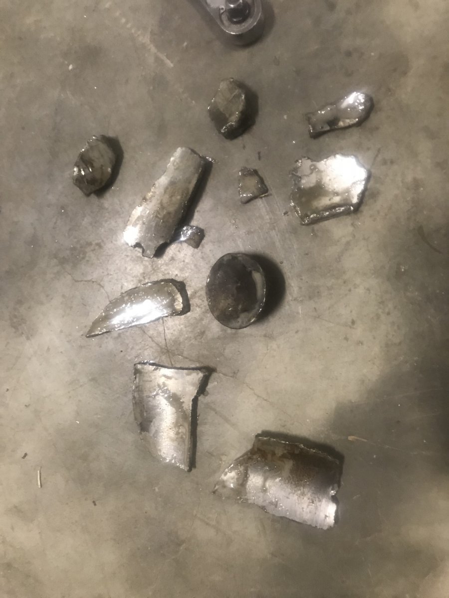

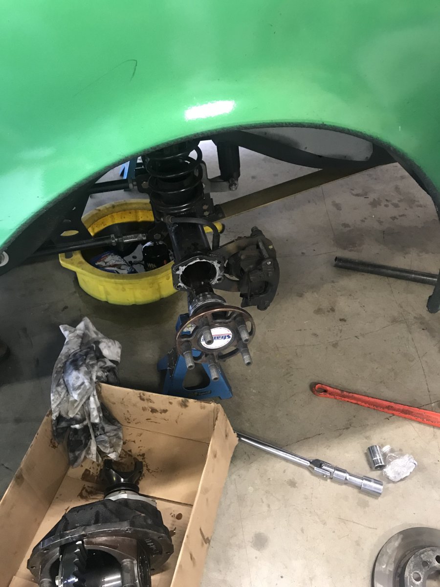

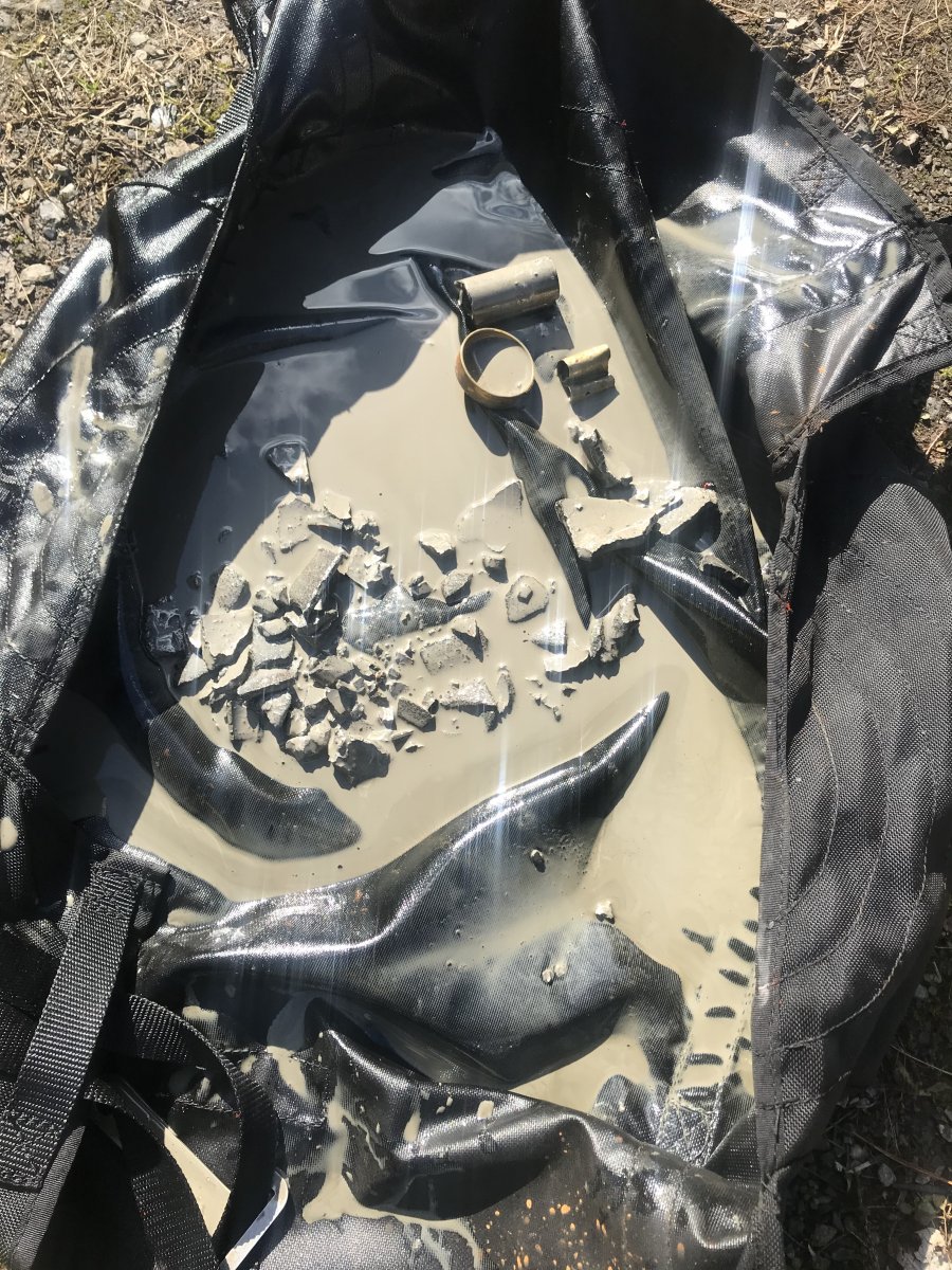

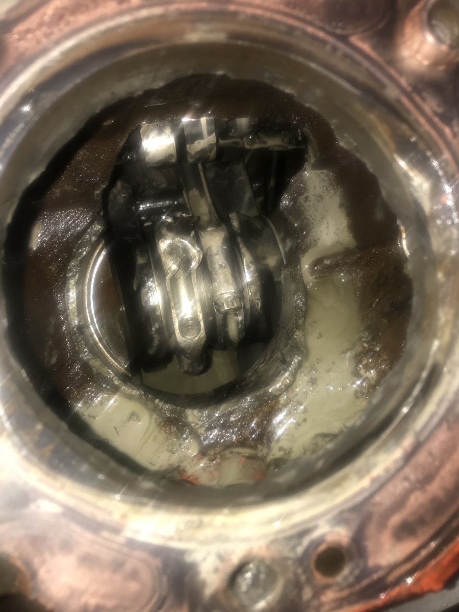

    C869E79A-57D5-4816-8A6F-A2F4FC7CB188.jpeg BDCC8A46-2DC4-4FF2-8102-5787650E2E27.jpeg 1B8C0D2B-AB09-42BC-B492-0C407034E9F2.jpeg 8E5EEA7F-0538-44FA-B351-3FC96400A4CF.jpeg EAD8EC8D-2EA0-4A12-8A24-C6038EFEE928.jpeg E3BCC724-169E-46AE-9C22-FA12F4184DCC.jpeg 52B49AAC-B180-42BD-9C5E-F310FECA028C.jpeg CCFE094F-CC27-43A6-8487-30AC8BC6F9B3.jpeg 1E96522C-4BAA-49BA-957E-8F499121116B.jpeg F053B983-A775-4B10-BACA-53F981C0BB30.jpeg 0617D492-E09A-48B7-86C3-116BE387603B.jpeg 68CD8E30-549D-47EC-8543-09A623FA83A5.jpeg 385050A8-9A5E-4F1E-8A21-7DB4E1B908DA.jpeg CF90D64C-043E-4D16-8328-65DCF0D51FF7.jpeg F22A789F-382F-4309-9D8F-72EECD5BFDA4.jpeg 3FEED9A5-28FE-4B1F-A185-84FC16AC35E8.jpeg Not how we wanted to finish our season at the final race in Florida this Saturday. We made a solid p*** and were sitting in 7th place after first round of qualifying, but second round of qualifying we had a major engine failure. Killed #7 cylinder in 3rd gear, and even though the diaper caught the majority of the oil and water, a lot did get on the track as the hole in the block came out near the top at the freeze plug. So I got in my own fluids and did scuff the car on the wall. We already have the heads at the machine shop to freshen them up, and we started on the new short block. We ended up still holding onto a 6th place points finish and we’ll be back stronger and faster next season. This motor was a test mule for our small bore bbc platform and had heavy parts in it. Still it loved rpms and ran faster the tighter I turned it. Tattle tale read 9150rpm after this race so that’s why it failed I’d say.
  30. loudbang
    Posts: 40,347

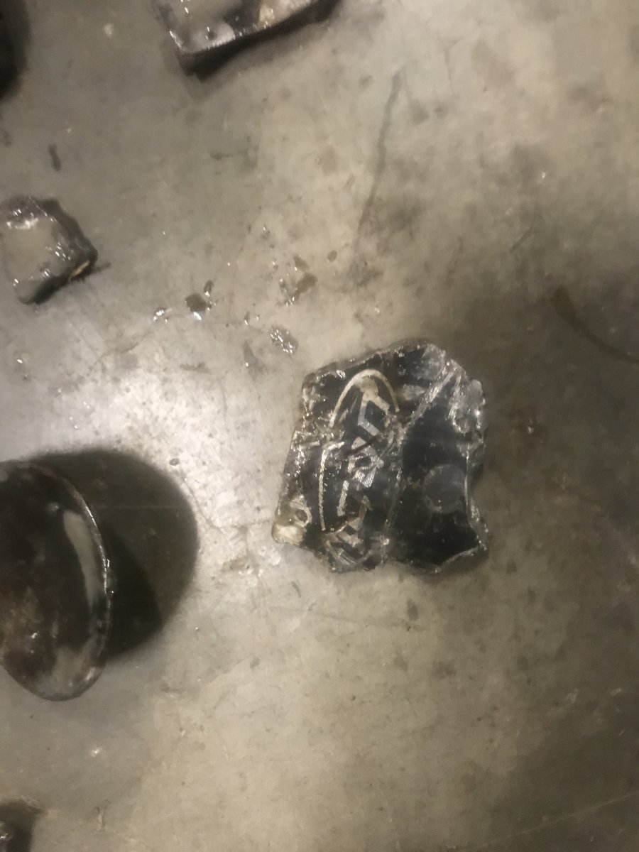

    :eek: Well that is a MESS of shattered parts. :(
