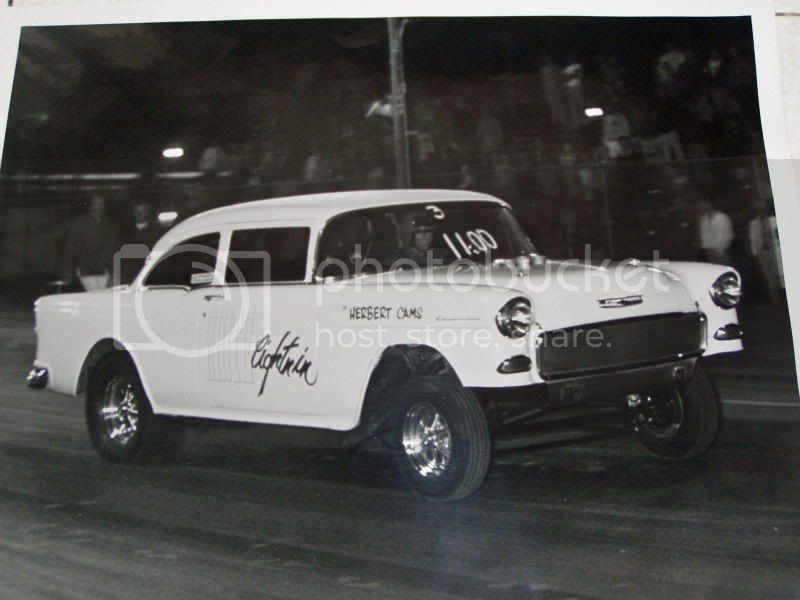

    Fogger

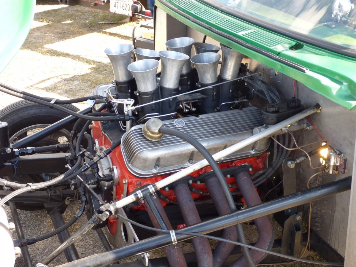

    Zak, Before the '67 Winter Nationals I removed the grill insert and attached aluminum in its place, also made a pan under the grill to direct air under the front end. Don't know if it helped but looked cool. The only pic I have is on Photo Bucket. 1955chevygasser005.jpg

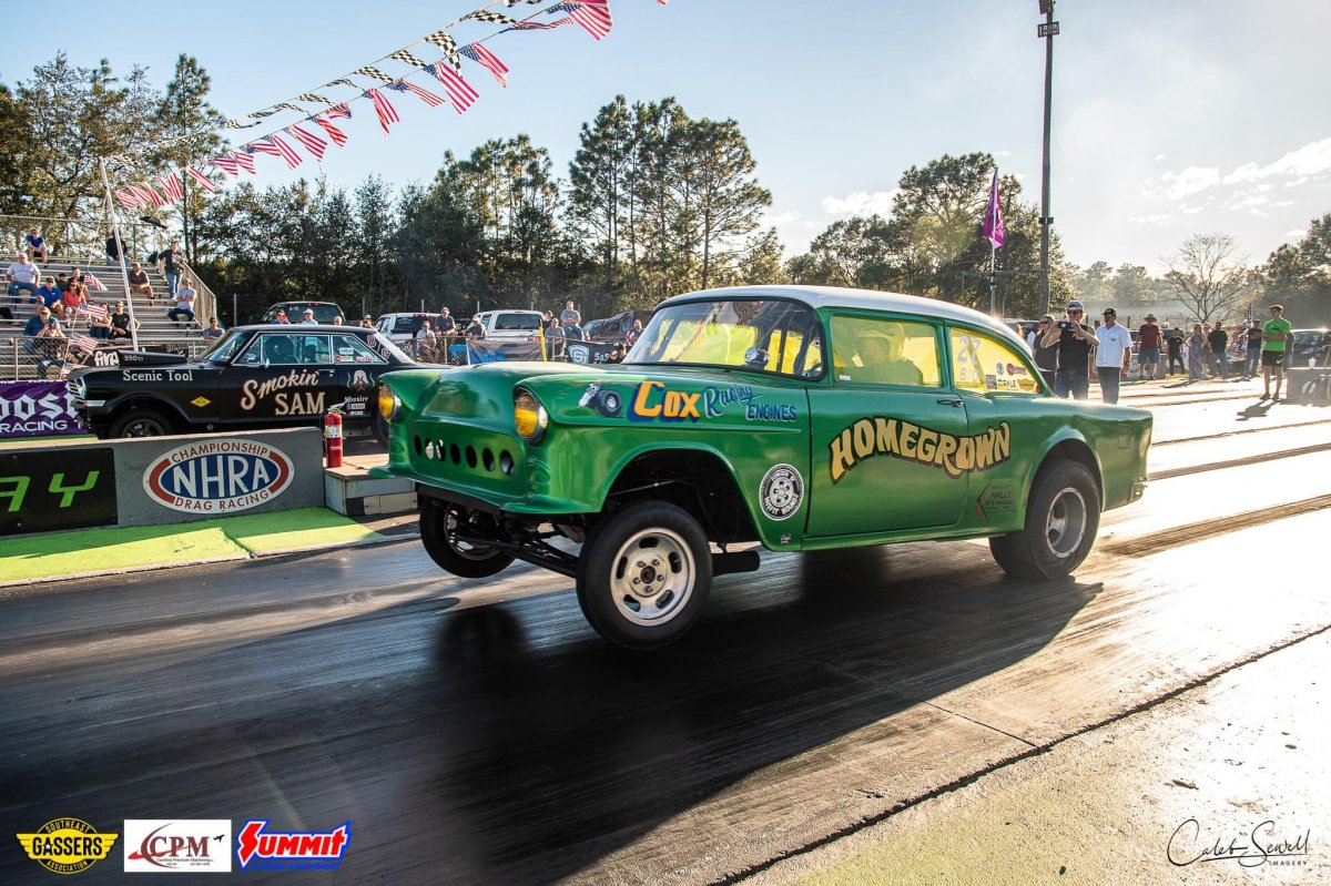

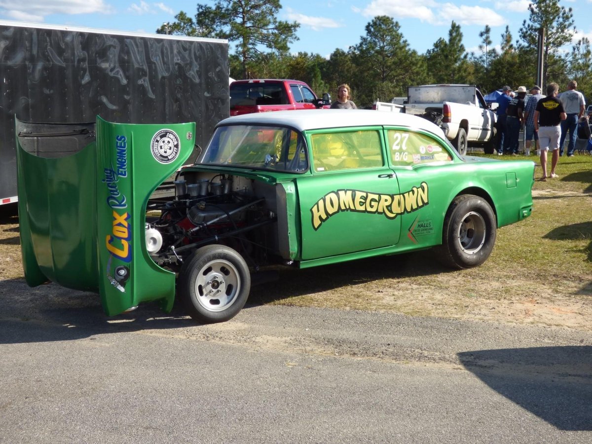

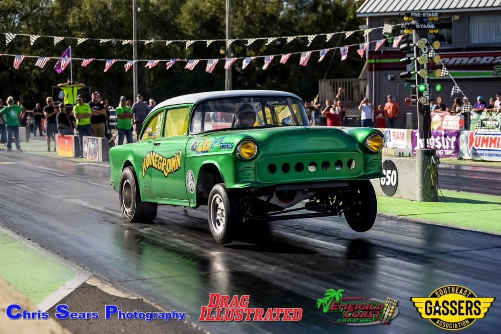

    Zak Hall

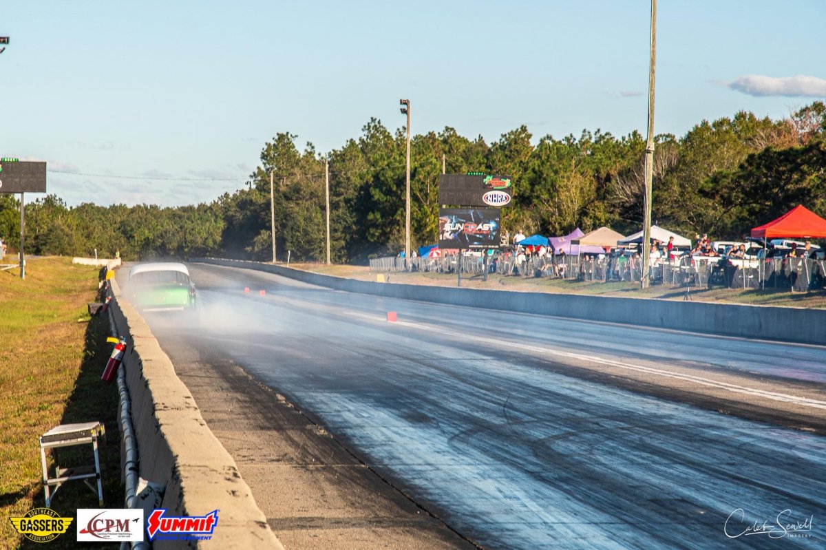

    541E1A07-84F4-4106-8202-26D66F288EE7.jpeg 60AFE006-3C29-41C9-BE09-FEB3ABC07967.jpeg FFBDE247-AA6C-476B-88A2-9938355579FB.jpeg 296E4368-86DC-43AE-BE8F-360944C2FBBC.jpeg 9C419D26-3BB2-4286-A934-55A290D460BB.jpeg C8BEA35B-494A-4C76-BEB3-3B99BD5C0FDA.jpeg EFD45BB0-D8F5-4288-87C1-653A70871759.jpeg Here’s a few photos from the p*** that the engine expired on.

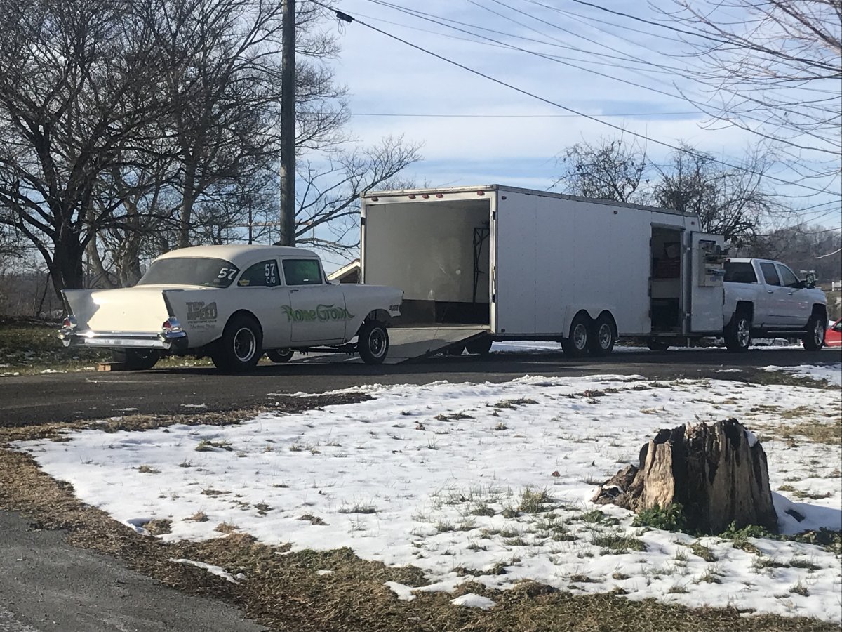

    Zak Hall

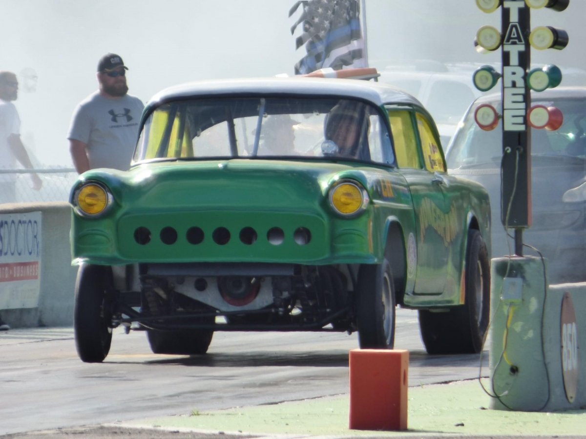

    5B6DB202-FC35-4732-ABFA-7D925D13F03A.jpeg 92863AC7-21C9-4AFC-AE1E-D634E3431CFF.jpeg FD0E60BF-4A9F-4984-B204-06E8907E659B.jpeg Bittersweet weekend as the 57 went to a new home with familiar faces. HomeGrown is a Texan now. Rusty and me made a deal and him and his wife came up over the weekend and picked it up. New things coming for 2021!
  16. 31hotrodguy
    Joined: Oct 29, 2013
    Posts: 2,699
    31hotrodguy
    Okay Zak, I’ll trust you but it still looked super awesome even being loaded up on the trailer! [emoji41] It was definitely one of my favorites but I’m glad it went to a good home! [emoji1303]

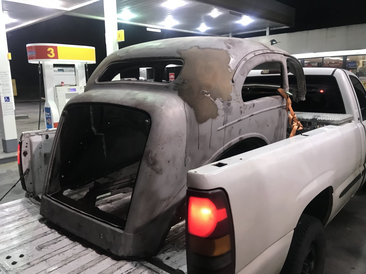

    Zak Hall
    Building a super light car this time. Should be cool!

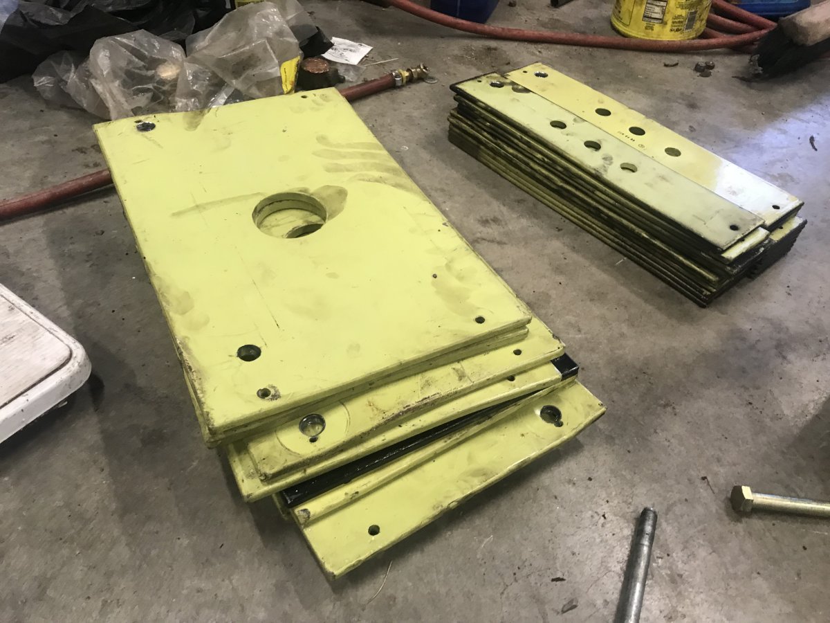

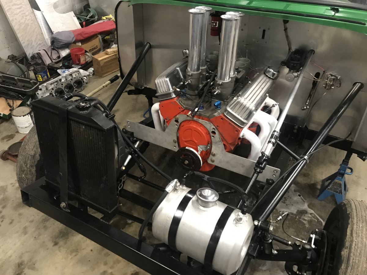

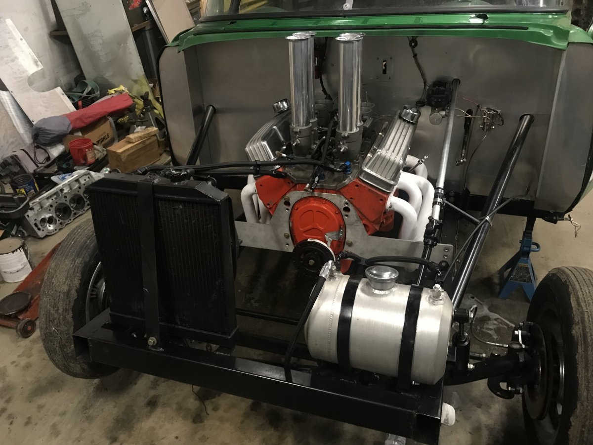

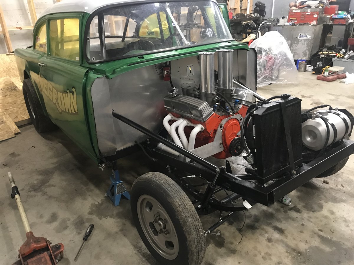

    A1680714-C8A7-4B79-A00E-04B6318E3CFD.jpeg 5146AEEA-14DF-4AA3-A246-3459B360B5F0.jpeg 911C64C3-1724-4CD8-ABB9-601A1C56A1D1.jpeg 54AE797F-2448-472F-BEDE-77B00250980C.jpeg 02A15706-C704-4A22-9E8A-1434A9B9D705.jpeg Gotta cut the stacks down, and take a ton of ballast out of the car but got the motor for the 55, just gotta plumb it up.

    494D1040-65CD-42BF-ABA0-3D049A8E3B67.jpeg Yeah
    The 396 is going to make a return, possibly in a new car! And this one is 331”. Took all 305lb of ballast out of the car too.

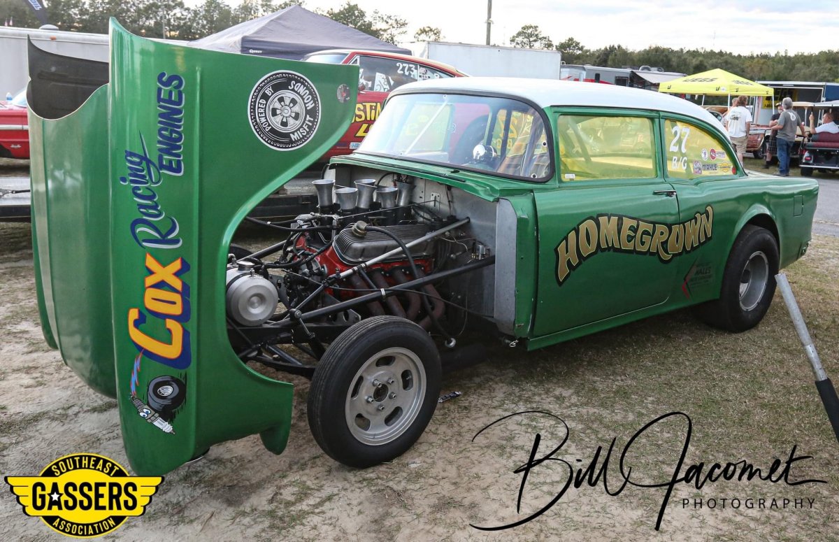

    F59268E1-5083-4F3E-81FE-356EF9A1F154.jpeg 107848B1-3709-47E8-ACB2-2E4697954418.jpeg 2189CEDF-0640-430C-8BBD-192C2E22B917.jpeg F4F564C1-CE34-4A95-AA66-23D1C7F05088.jpeg B7921E35-C60B-4693-9304-A771E81CB3CB.jpeg 25D4EEF5-3B6E-4CA7-84A2-FBA37A274718.jpeg 2810485D-A7AD-47B8-9818-DB571BC02556.jpeg D7FE06E2-DD0D-4B56-AB7E-0BB297364FA7.jpeg A968B71C-0ABF-42EB-9408-45D7AF8F3221.jpeg Here’s a few more pictures from Florida finals. Only January and already having withdrawals.

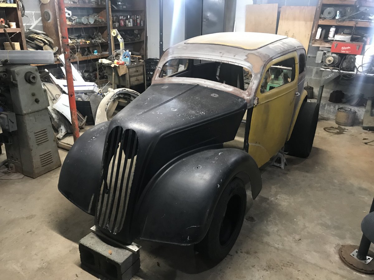

  29. Zak Hall
    Joined: May 11, 2015
    Posts: 712
    Zak Hall

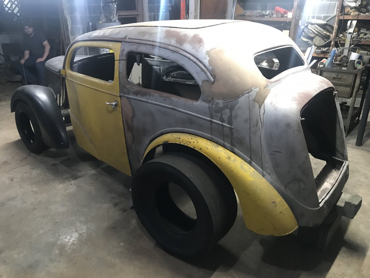

    208551D0-5916-4978-8B3B-9E10E390BFF9.jpeg 77361E63-7541-4CAD-9A07-404C1BDB0BA3.jpeg 1C1B6E18-3ABD-4B3D-8E4A-A58E1E31E48E.jpeg D146FB16-9F82-4C7D-ABAE-2EDF2A9E16D6.jpeg 80D08718-C080-4032-BFBF-F6602D176CE4.jpeg
    Here’s a few pictures of my new car I’m starting on, and I do plan on it being fairly light. Not sure how long it’ll take so I don’t know to what extent I’ll do a build thread about it.
