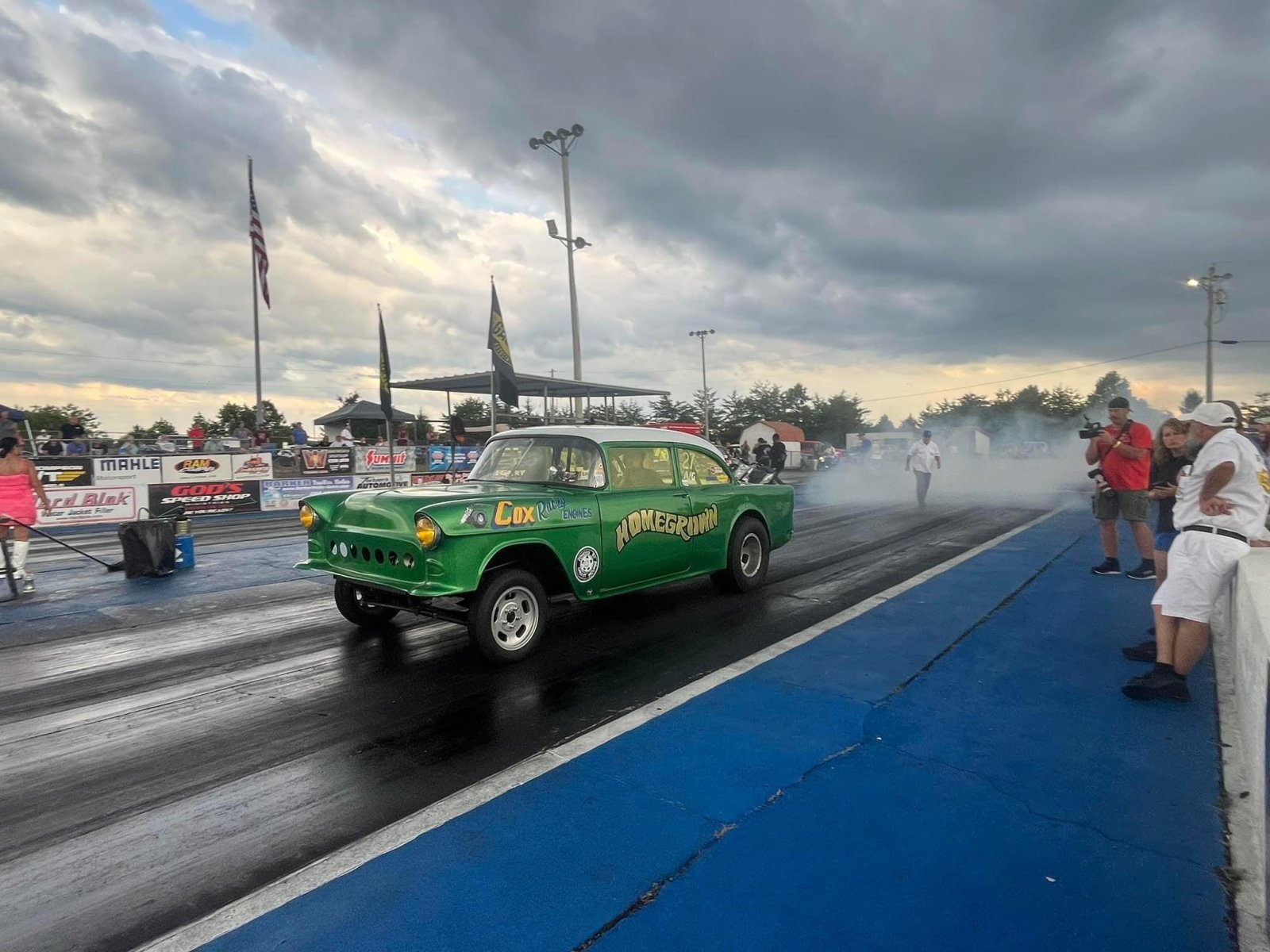

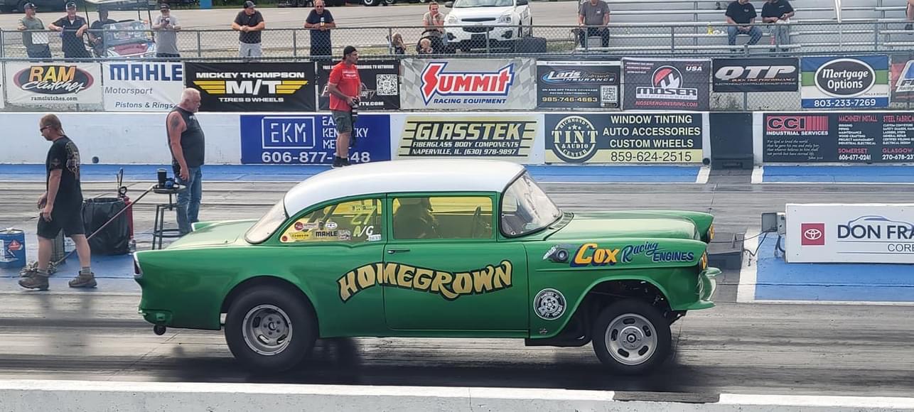

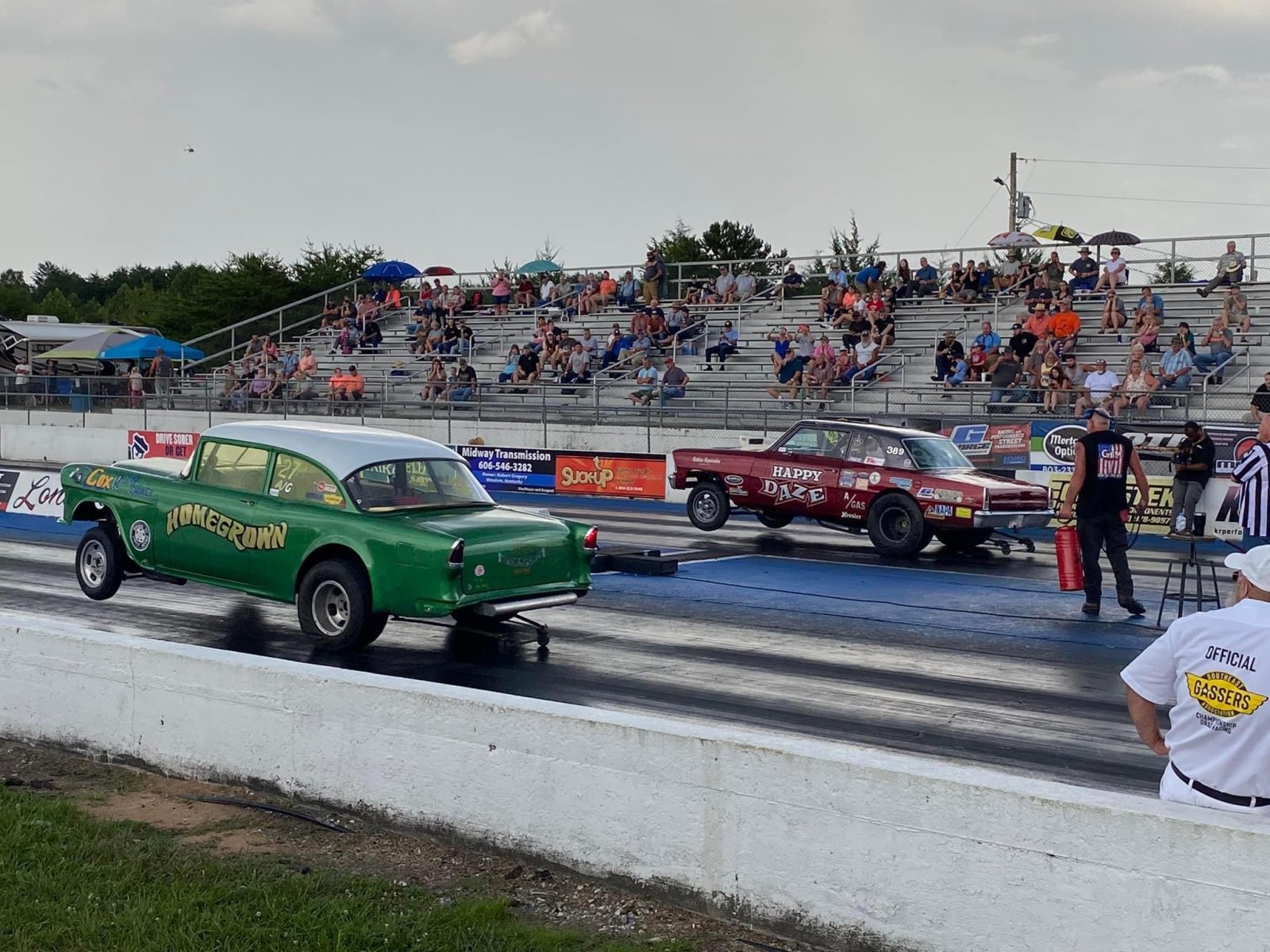

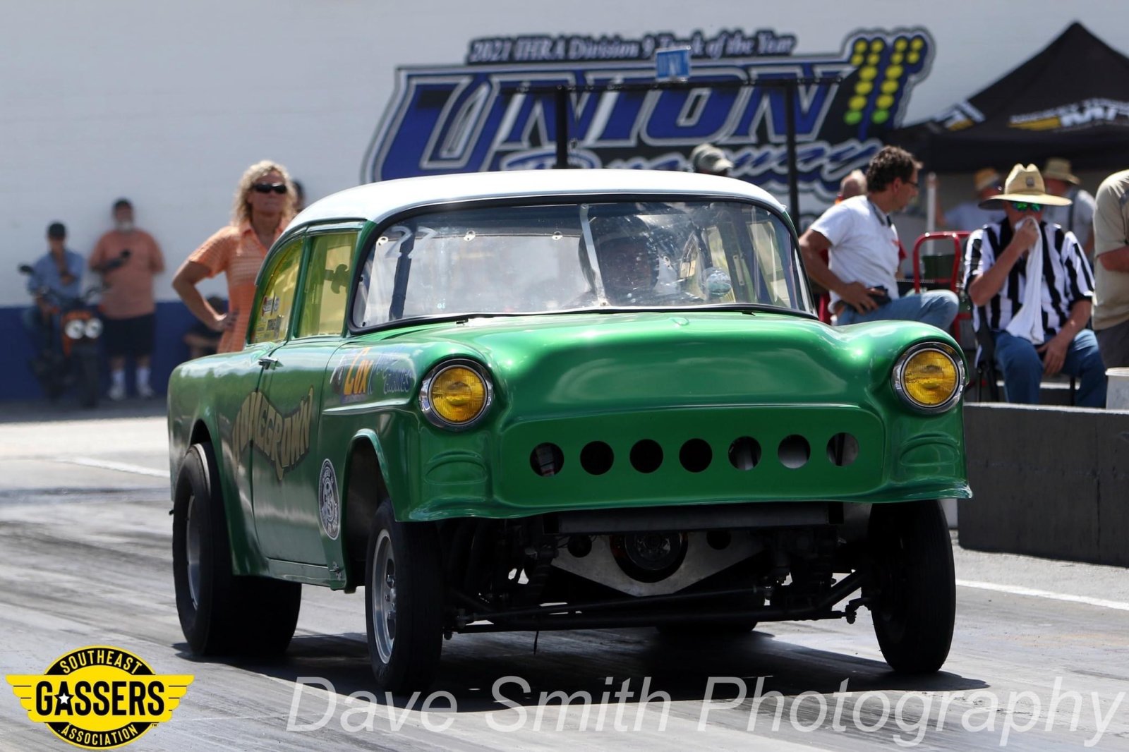

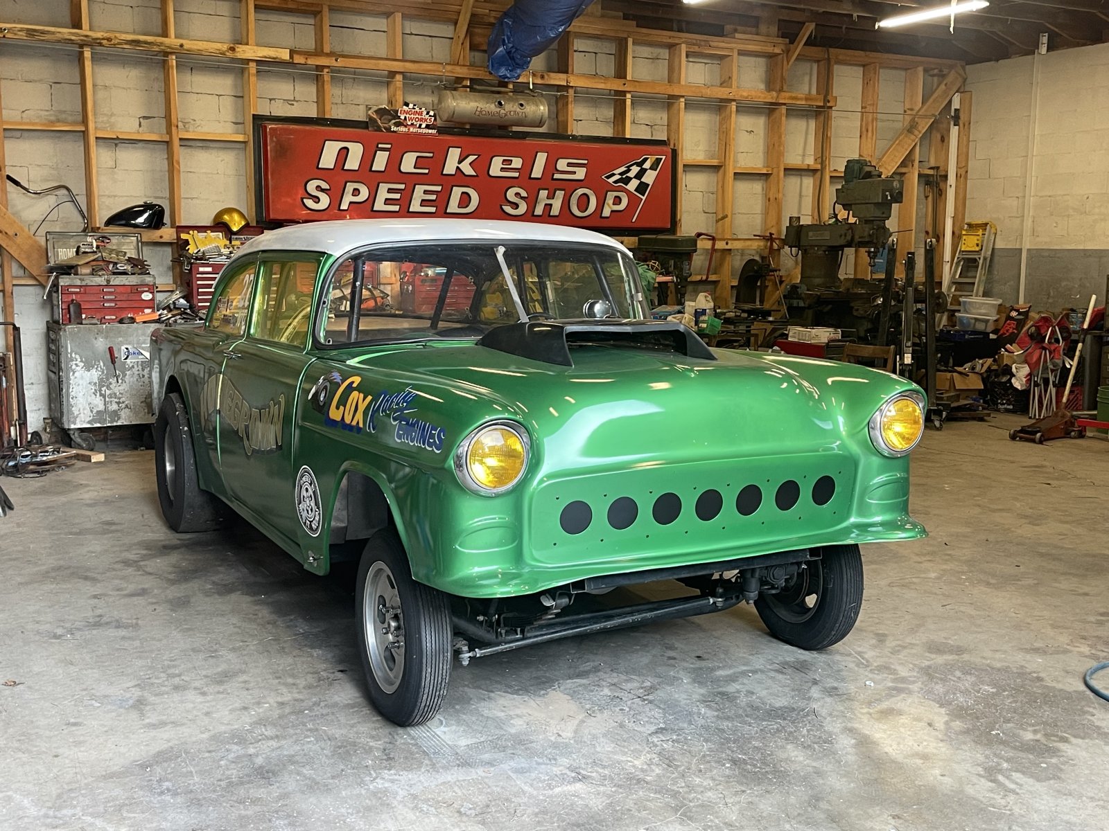

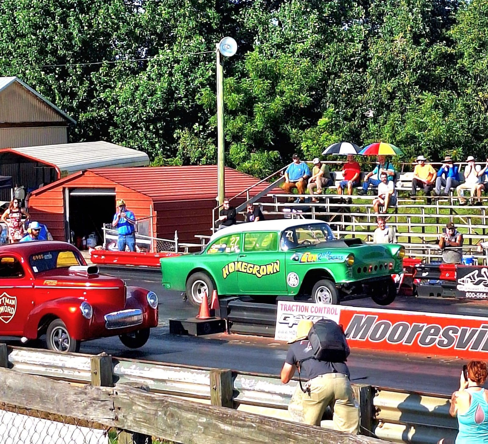

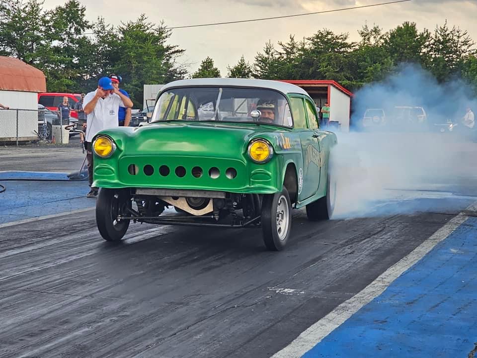

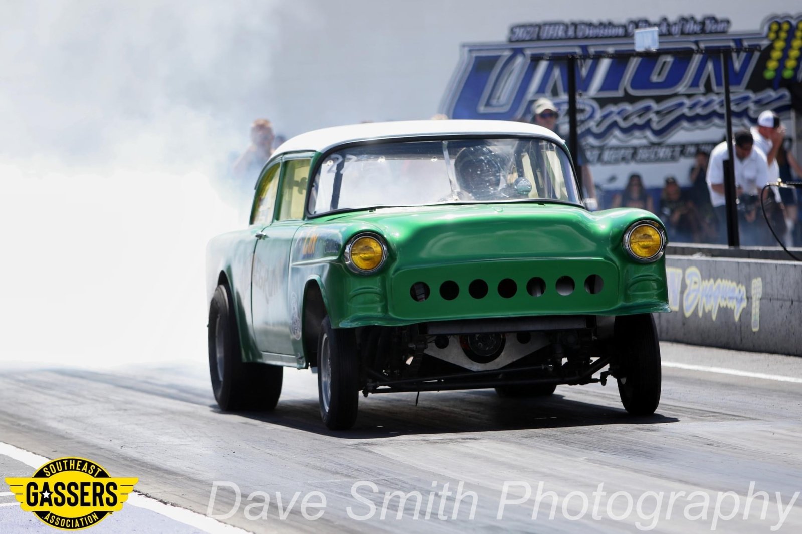

    A few photos from the past few races. Still figuring the new combo out but getting closer. IMG_4737.jpeg IMG_4487.jpeg IMG_4486.jpeg IMG_4293.jpeg IMG_3649.jpeg IMG_3610.jpeg IMG_3611.jpeg IMG_3404.jpeg IMG_4025.jpeg IMG_4233.jpeg

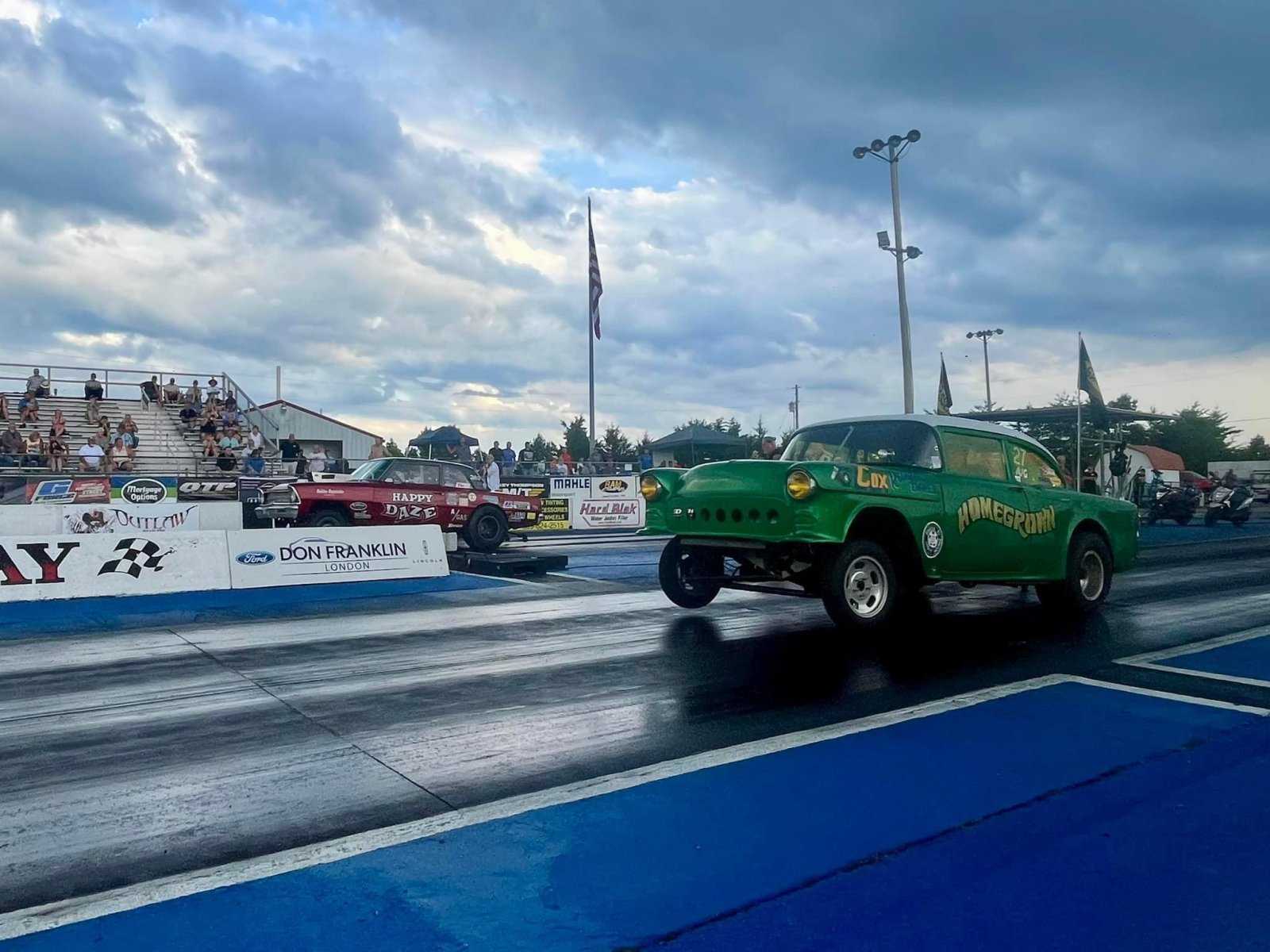

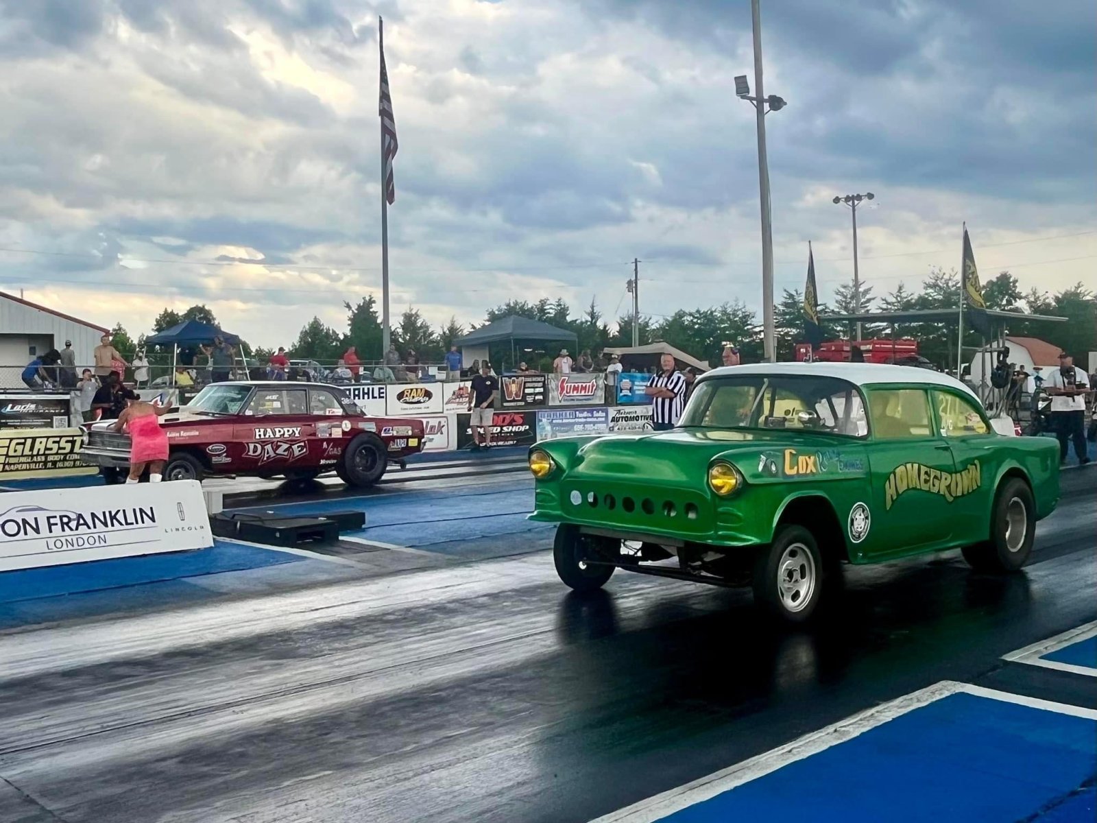

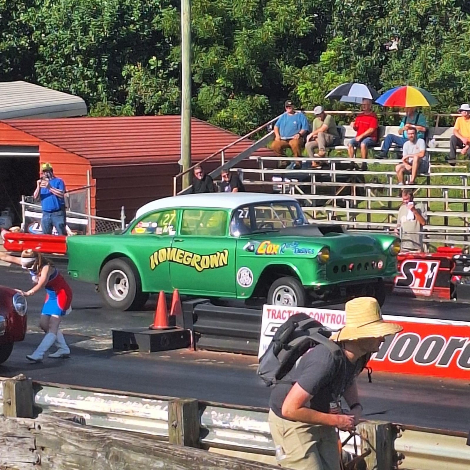

    IMG_5405.jpeg IMG_5404.jpeg IMG_5401.jpeg IMG_5402.jpeg IMG_5384.jpeg IMG_5377.jpeg IMG_5376.jpeg IMG_5375.jpeg IMG_5368.jpeg IMG_5370.jpeg IMG_5334.jpeg IMG_5328.jpeg IMG_5354.jpeg IMG_5353.jpeg IMG_5362.jpeg Had a good outing and fun time this weekend at London, until the rain came. Car worked well with the new clutch setup and went the fastest 60ft ever with this car. But just didn’t pull hard enough down track like it should. Not sure if it was due to too small of carburator, not enough fuel pressure regulator, or intake manifold. So changing fuel pressure regulator to a more serious one, swapping to a tunnel ram, and two carbs for next race, as well as taking some ballast weight out of the car to hopefully shed about .10 of et or so and run some 5s. Already made up the linkage and got the tunnel ram installed.

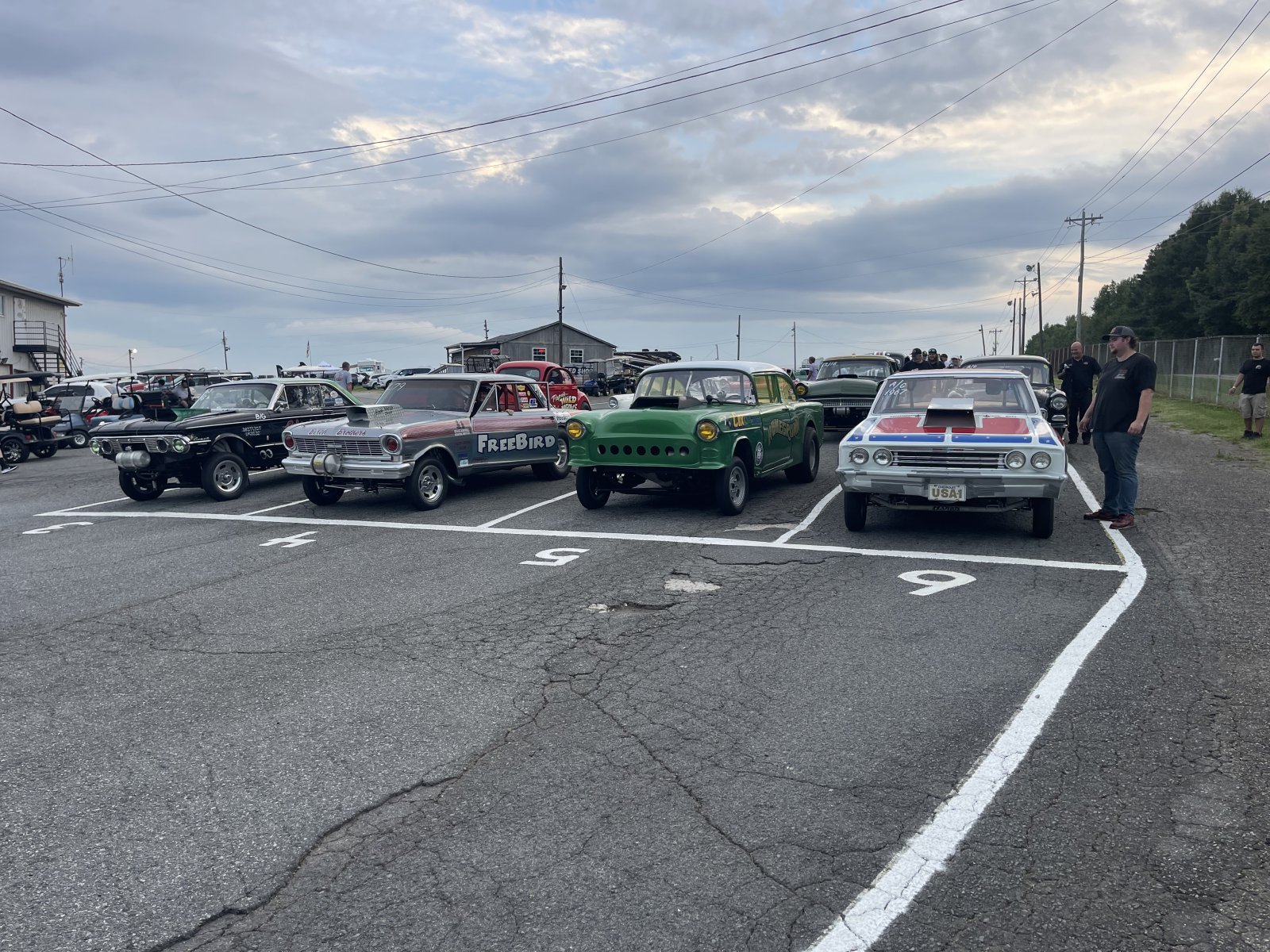

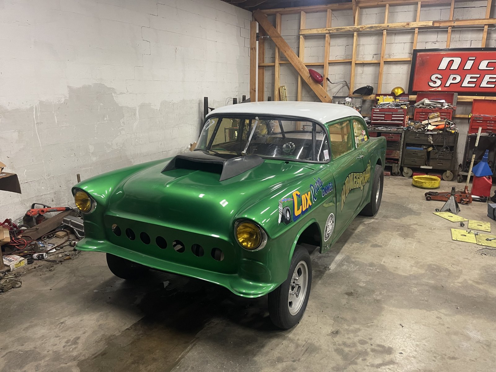

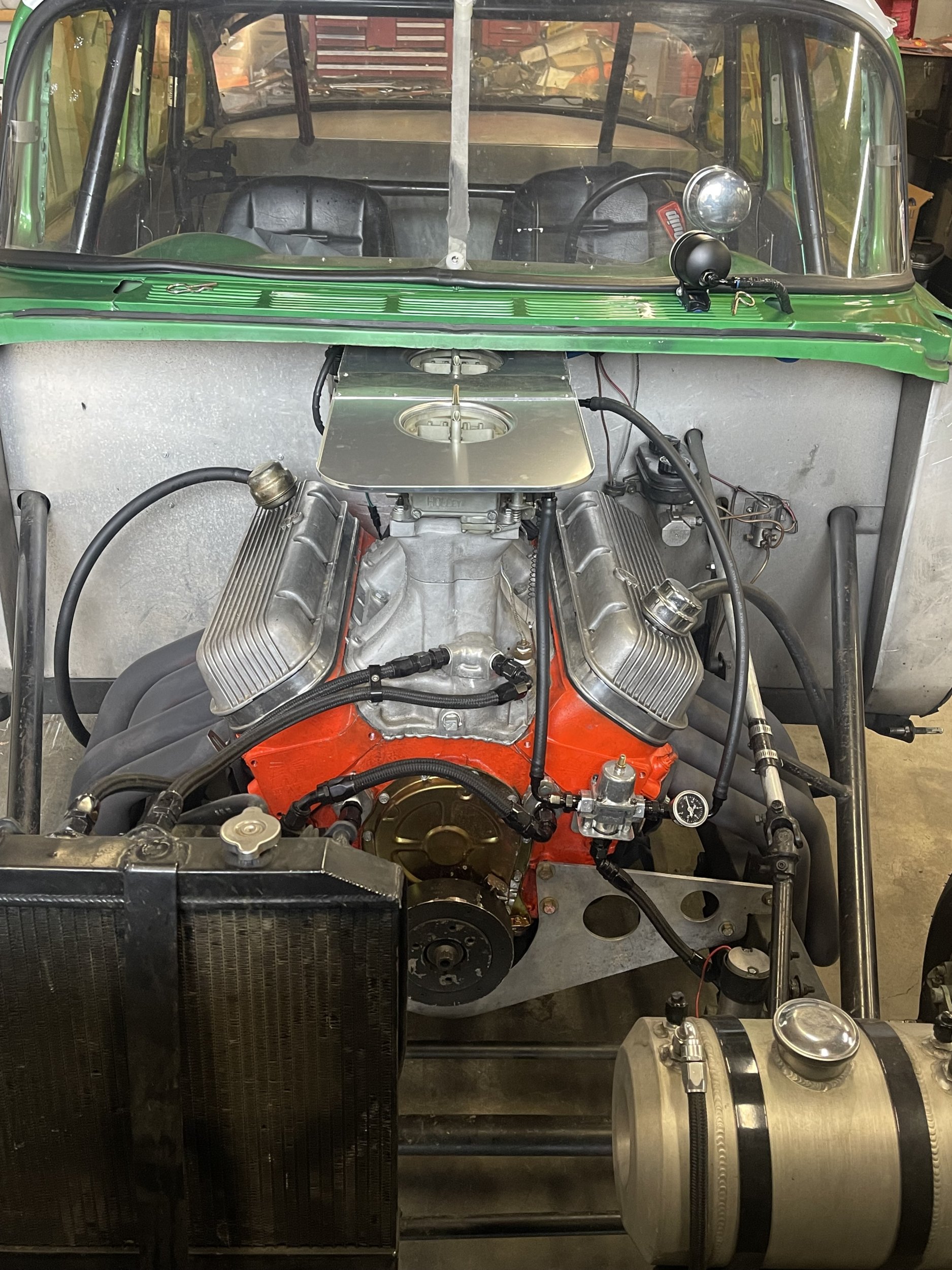

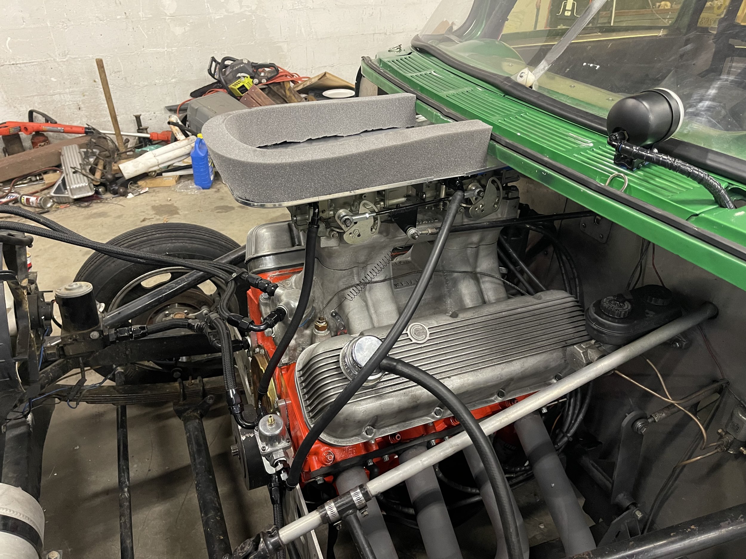

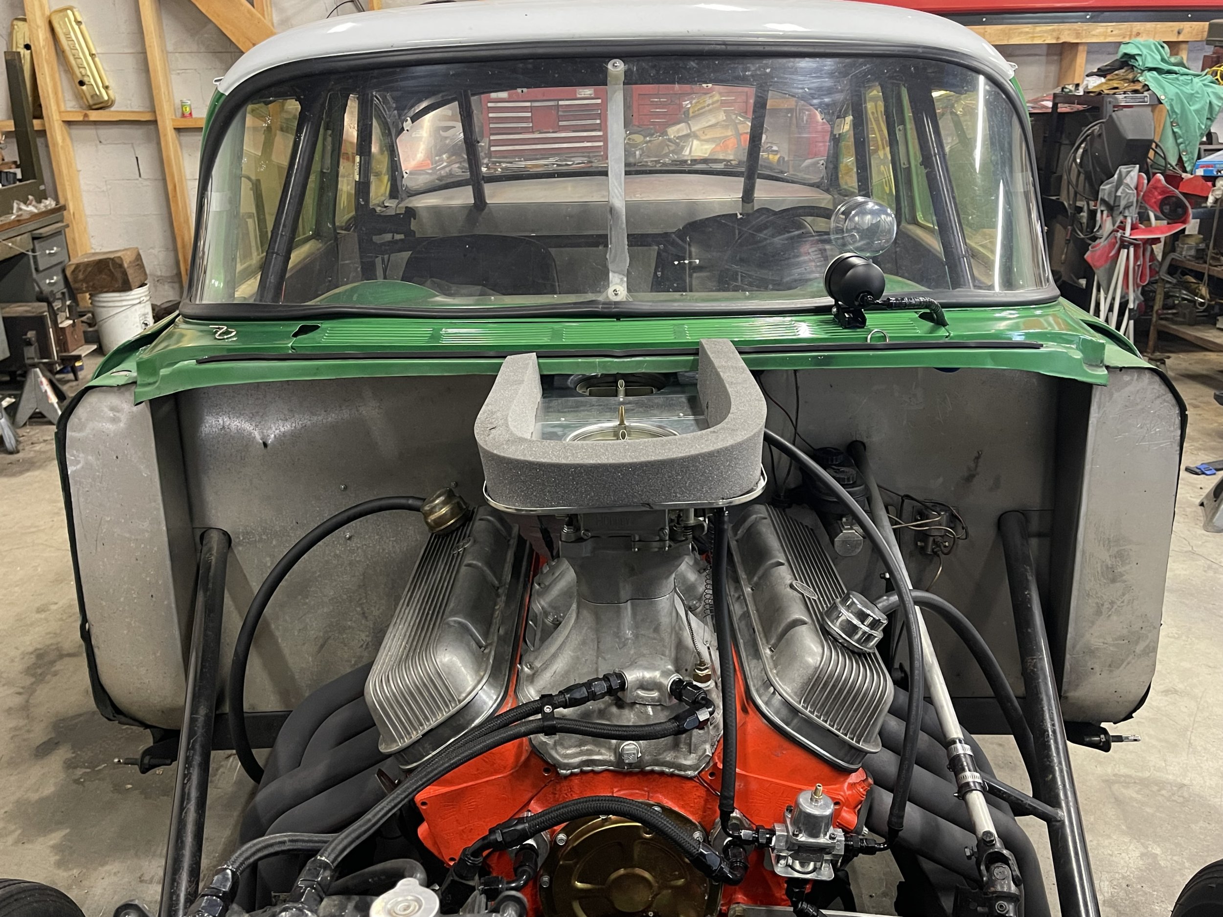

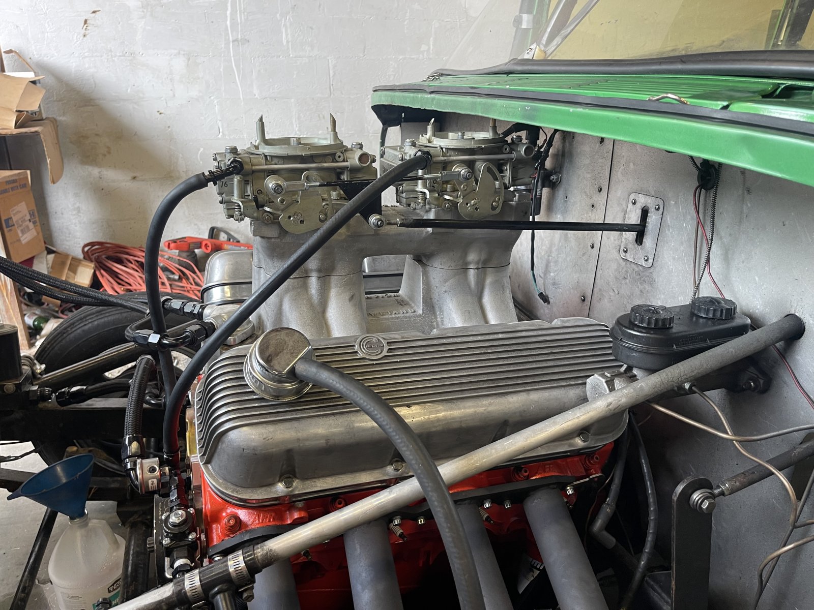

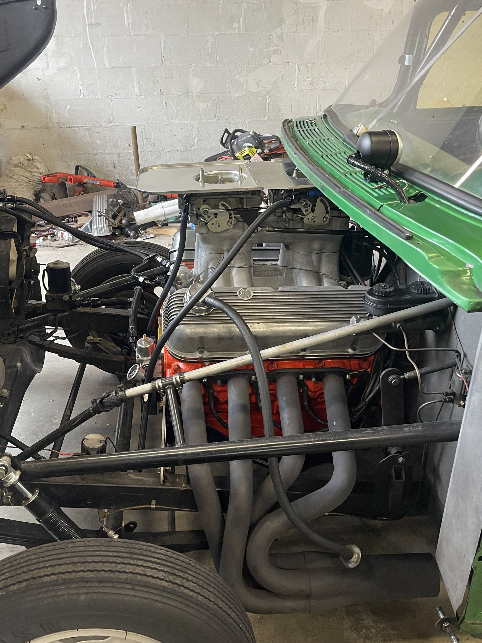

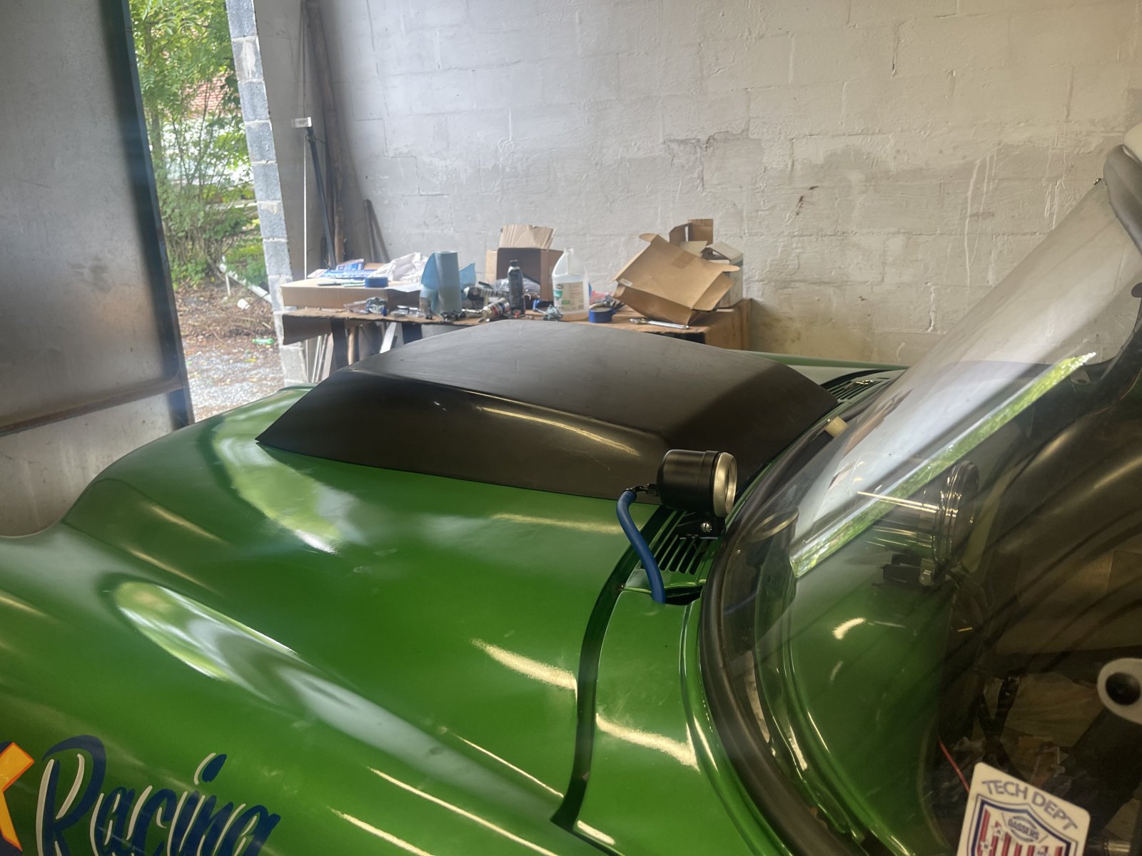

    Removed 88lb of ballast, upgraded to a much larger fuel pressure regulator, got the car running with the tunnel ram on it, and mounted the new scoop. The quest for 5s is at its end, either she will or she won’t lol.

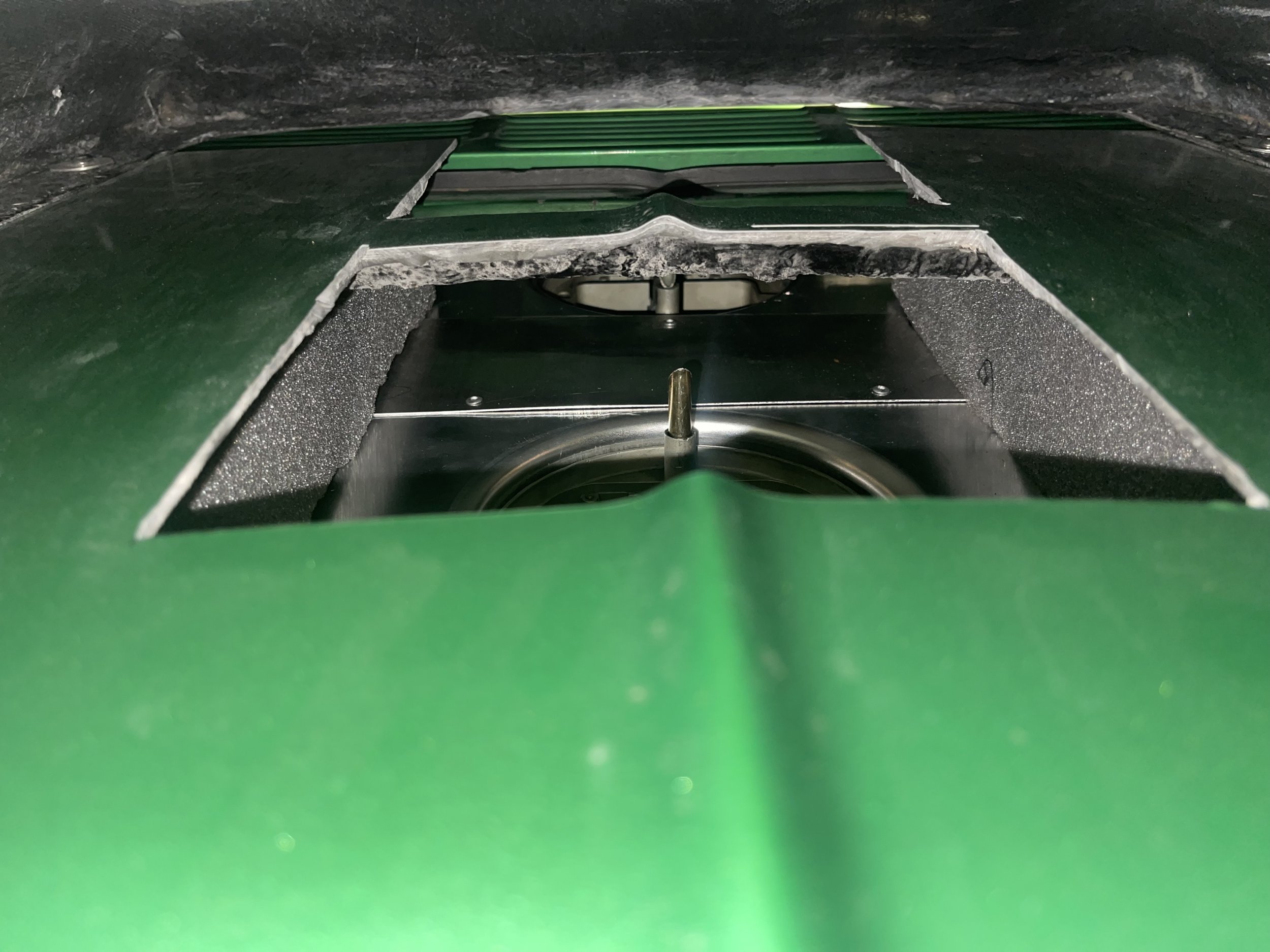

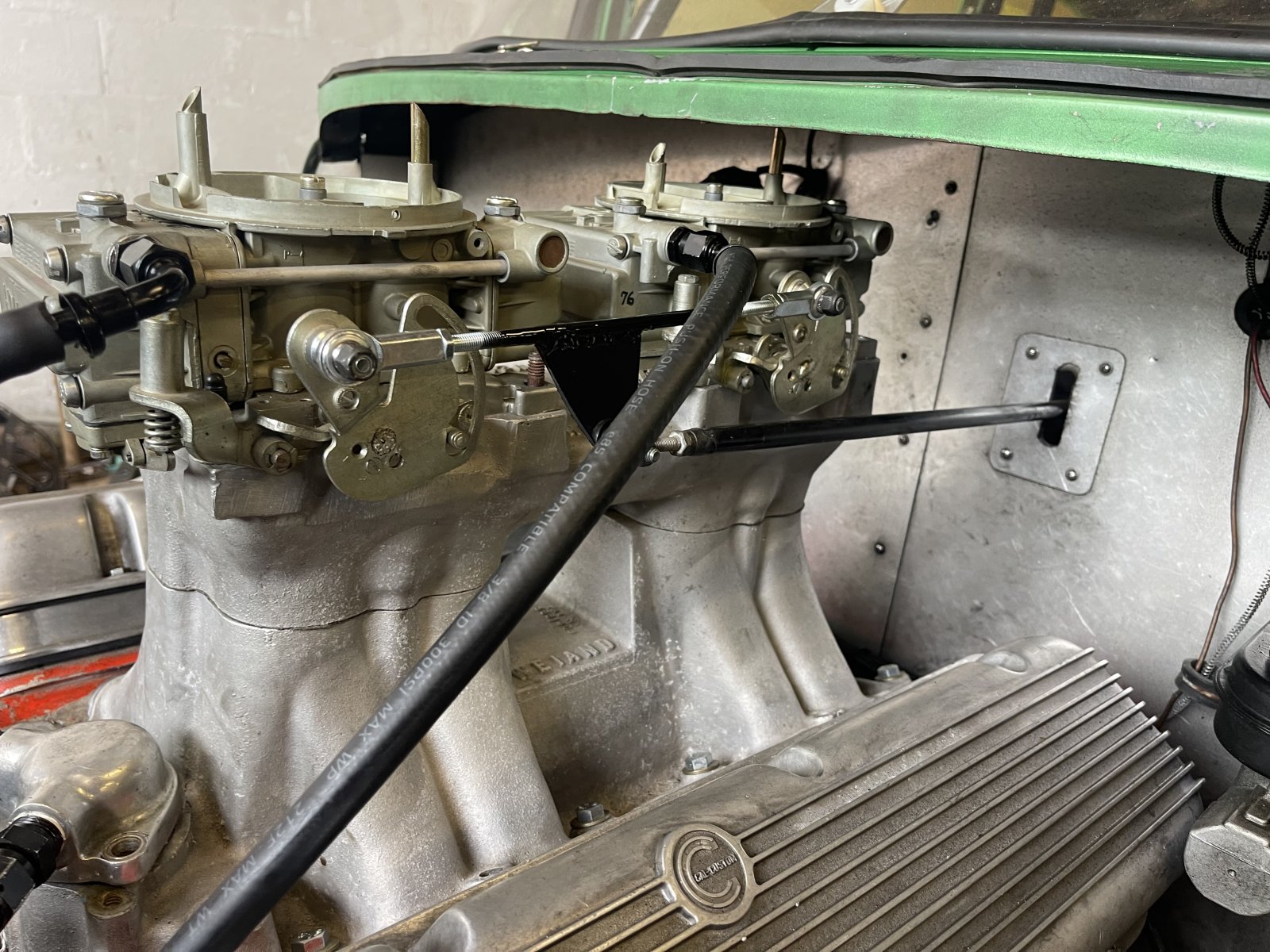

  7. Seal those carbs off to the scoop with a pan and foam and possibly trim the cowl a bit on the rear carb. I picked up over 2/10ths on a 55 I ran with a BBC single carb by fabricating a pan. Good luck , enjoy.

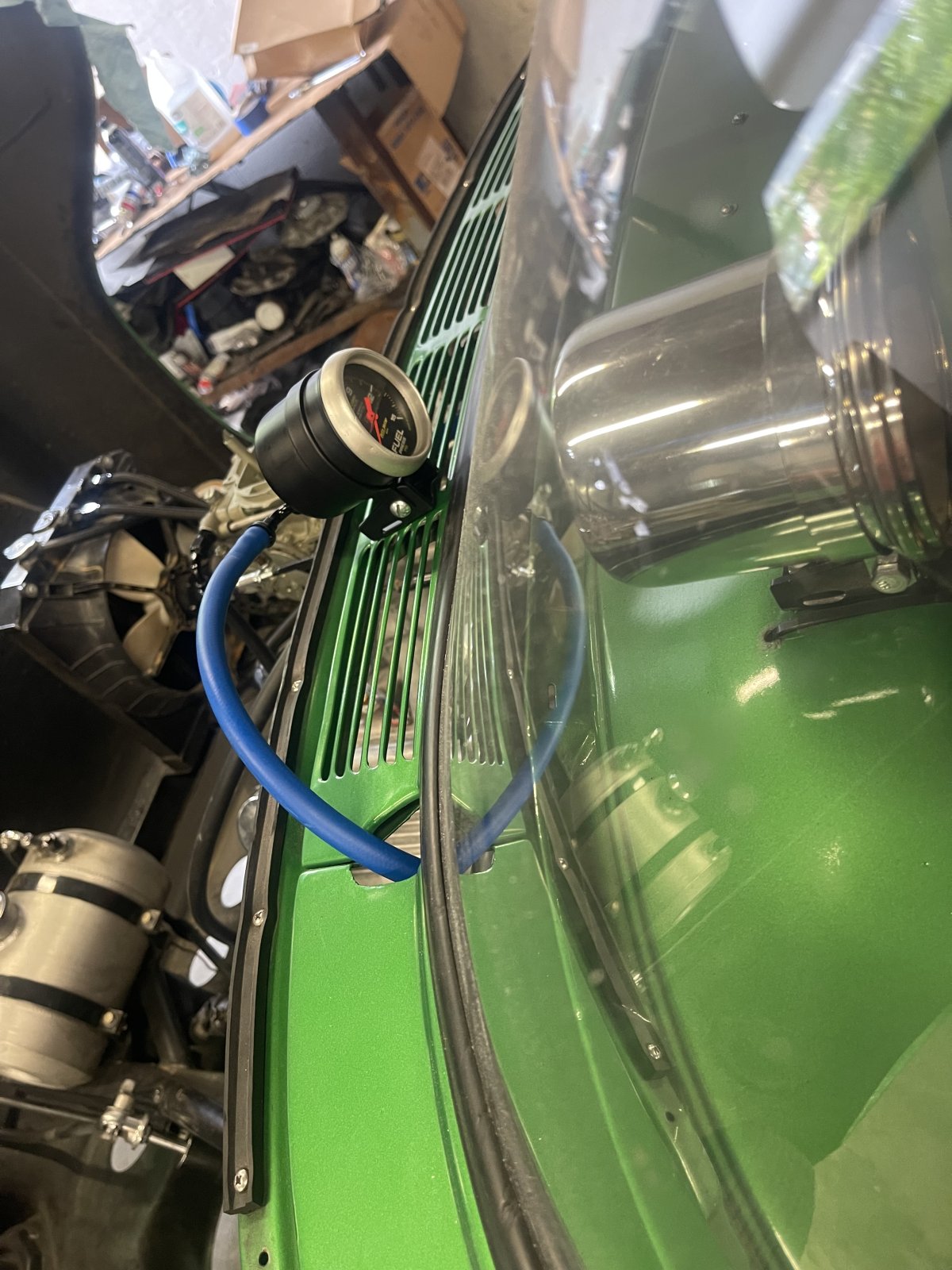

    Put a fuel pressure gauge on back carb. Mount it where hood meets cowl in your line of sight try to take a glance at top end. If to busy there ( big smile) put phone on dash & video the gauge. Got to have good pressure for whole run.

    I plan on making a tray, that’ll be the final step.

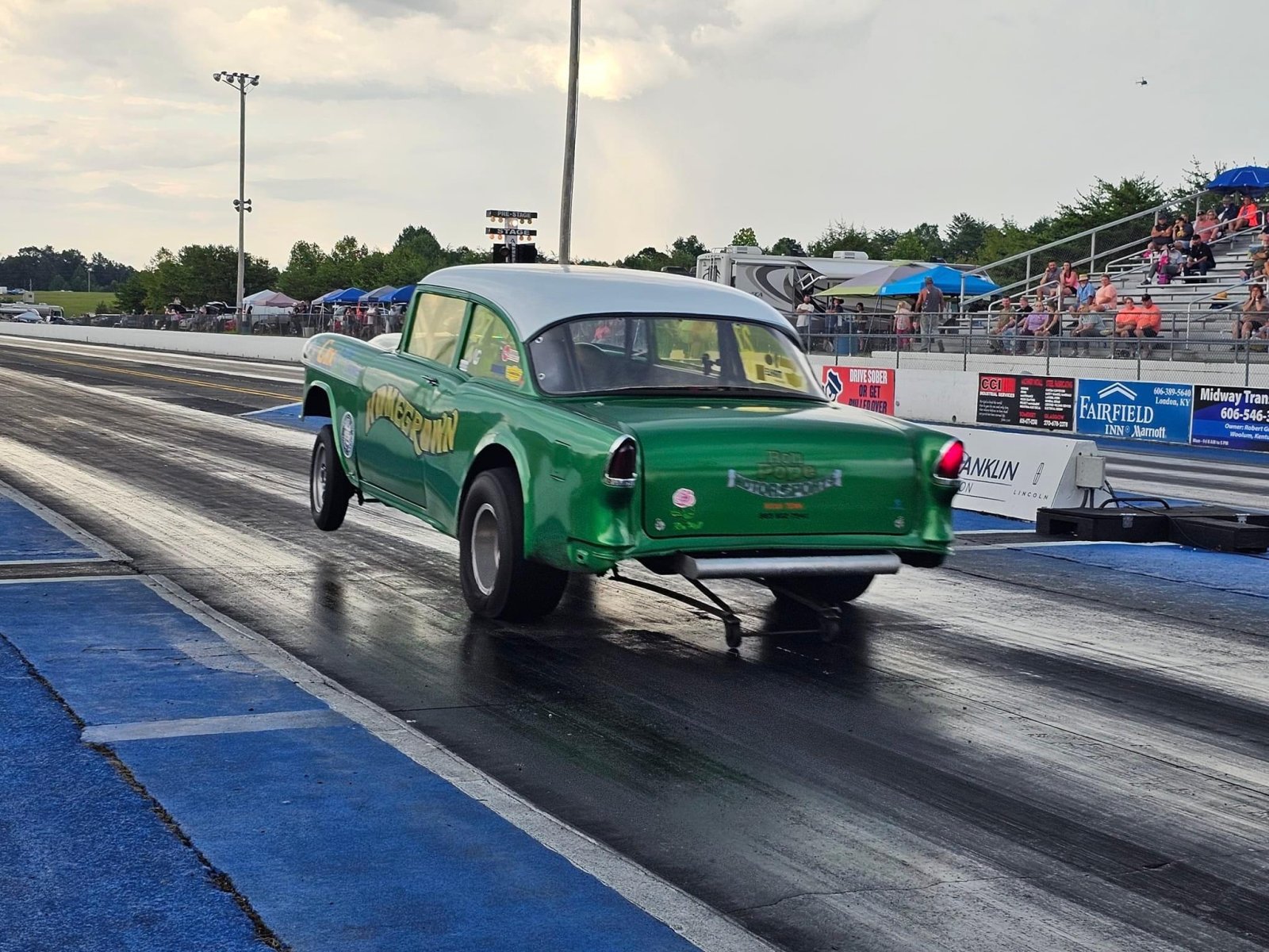

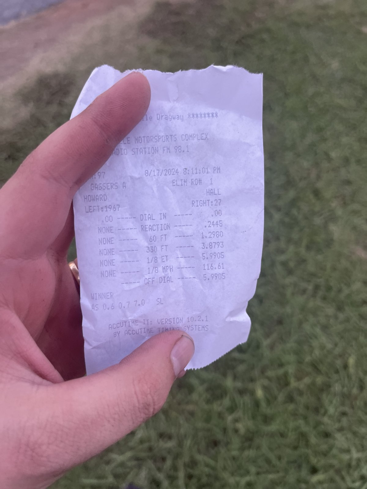

    IMG_6708.jpeg IMG_6713.jpeg IMG_6712.jpeg IMG_6714.jpeg IMG_6644.jpeg IMG_6636.jpeg IMG_6701.jpeg IMG_6750.jpeg IMG_6749.jpeg IMG_6748.jpeg IMG_6747.jpeg A few photos from the weekend. I did add a fuel pressure gauge off the back carb line to make sure pressure stayed steady going down track, and it did.
    Tunnel ram, hood scoop, and fuel pressure regulator upgrades all ***ulatively resulted in a 5.99 p***. Got my 5 second et, we picked up almost a tenth, and 116mph so a gain of 5 mph. 60ft picked up as well. With a little ch***is tuning and some more tweaks this will be a great combo I believe. Great weekend for sure.

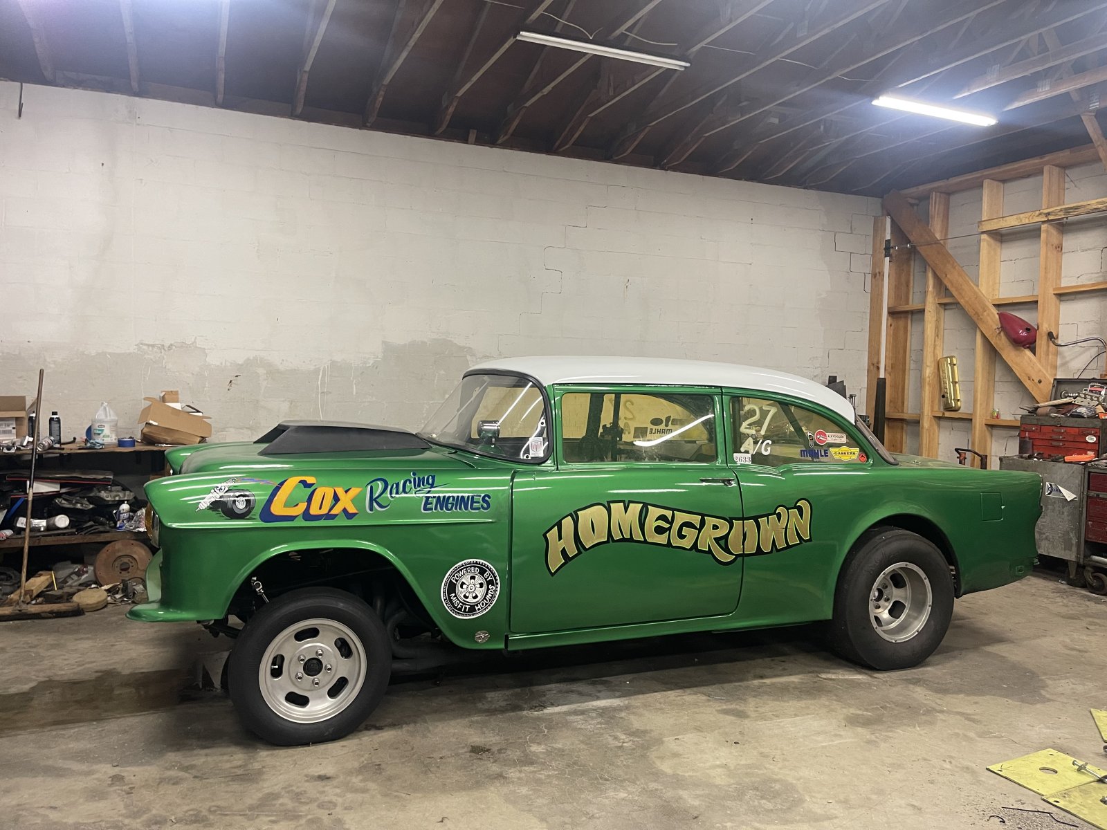

    IMG_8201.jpeg IMG_8202.jpeg IMG_8227.jpeg IMG_8228.jpeg Did some scaling of the car and adjusting preload to try to settle it down on the line and leave a little straighter. Also dusted off the metal working tools and clecos and made a grille block off to try to keep from trapping air. If anything needs aerodynamic ***istance, it’s a 55 Chevy. Lol

    Zak, I built my '55 G***er back in the early '60s and constantly tried to improve the aero of the front end. This photo was taken at Lions after I sold the car but I had also blocked off the grill opening with aluminum sheet metal. Car ran 10.80 at 129 in '66 when I raced it. Your car looks great and each modification you've done has had a positive effect. You should be in the 5.50s soon. 1955chevygasser005.jpg

    IMG_0962.jpeg IMG_0964.jpeg IMG_0967.jpeg IMG_0968.jpeg IMG_0980.jpeg IMG_0982.jpeg IMG_0984.jpeg IMG_1051.jpeg

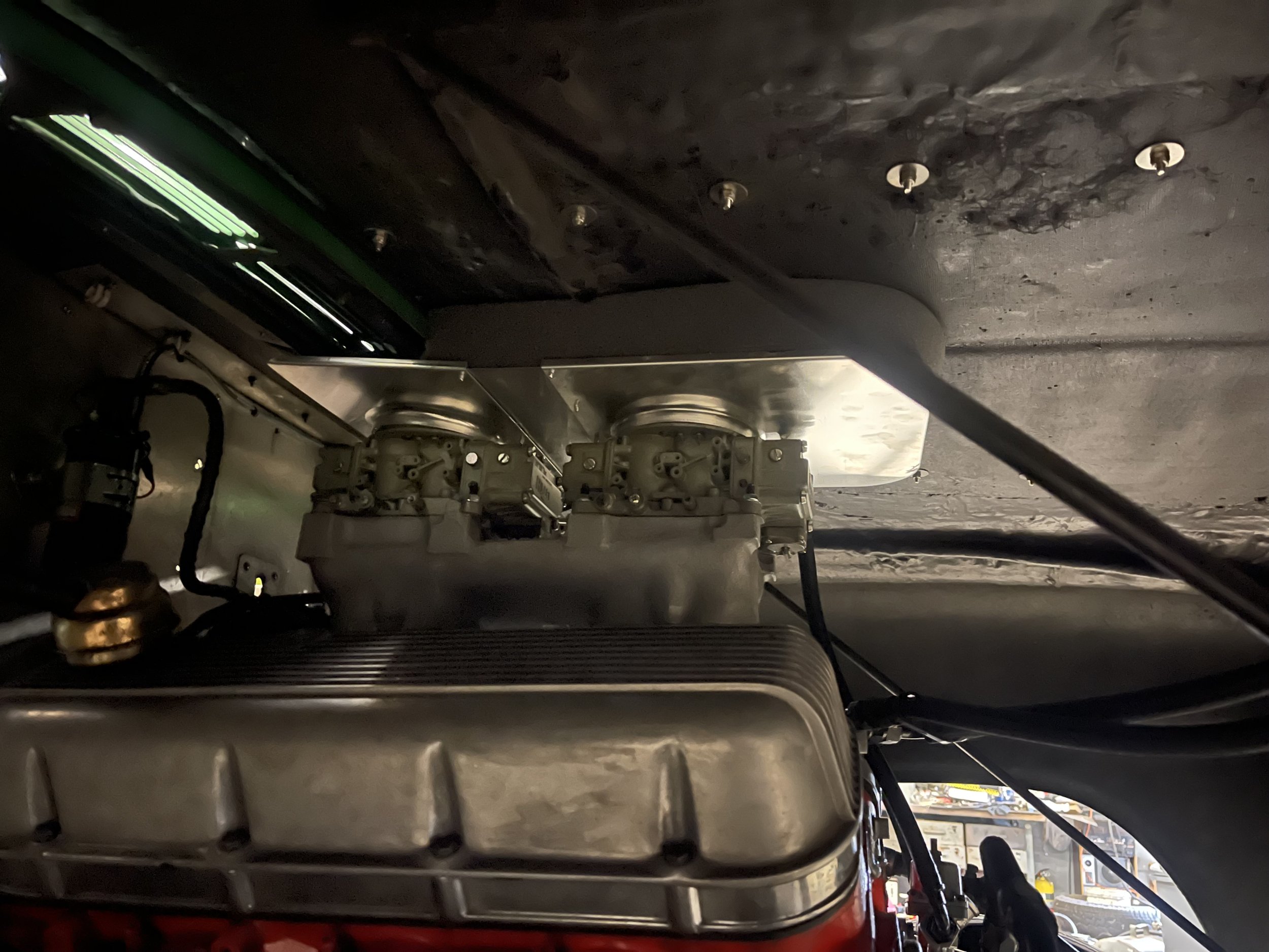

    Did some tinkering on the 55 this weekend and made a scoop tray and got the carbs sealed to the hood. Trying all of the little free hp ideas.

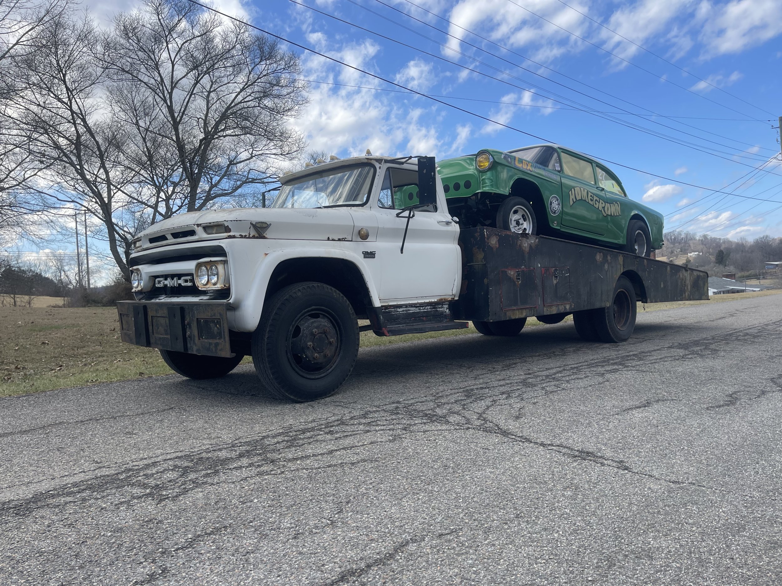

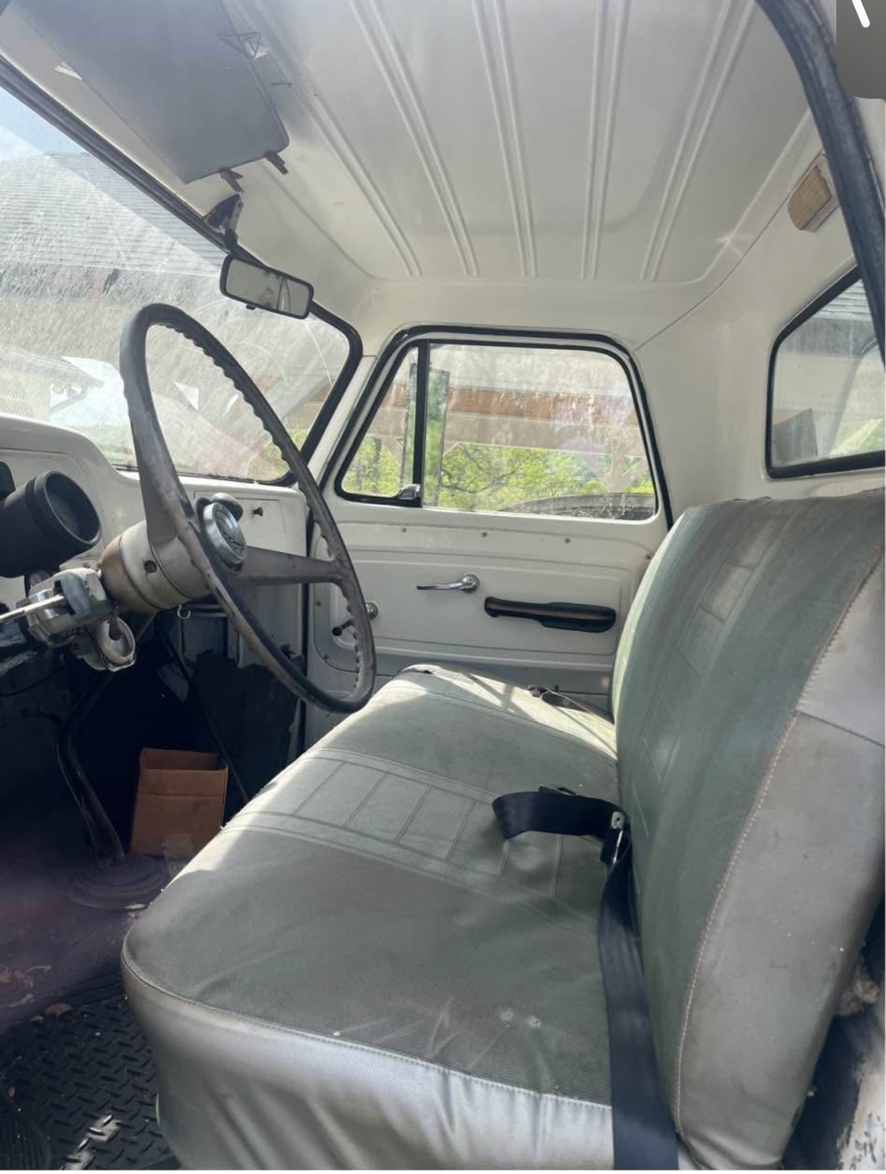

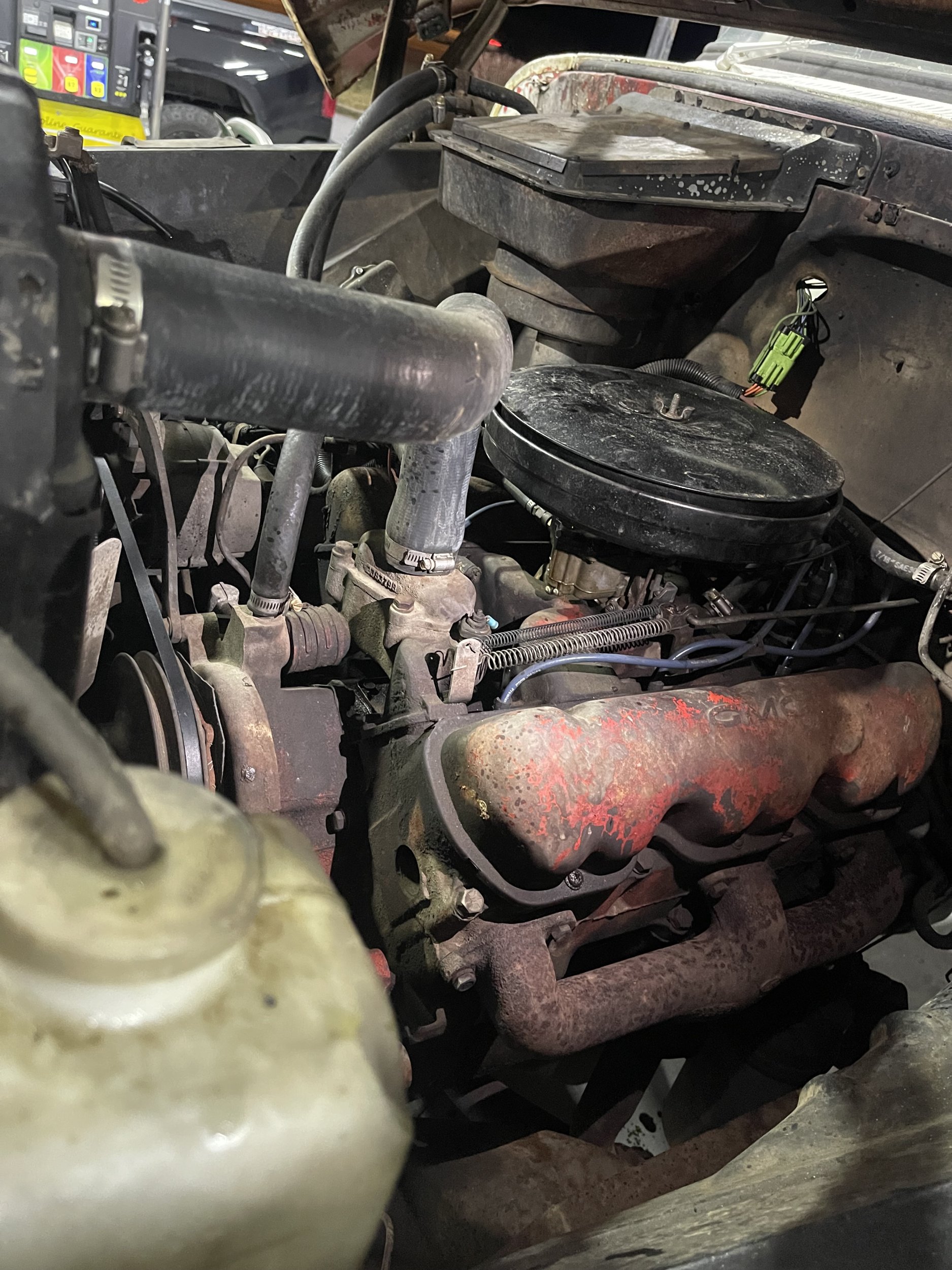

  17. Zak Hall
    Joined: May 11, 2015
    Posts: 712
    Zak Hall

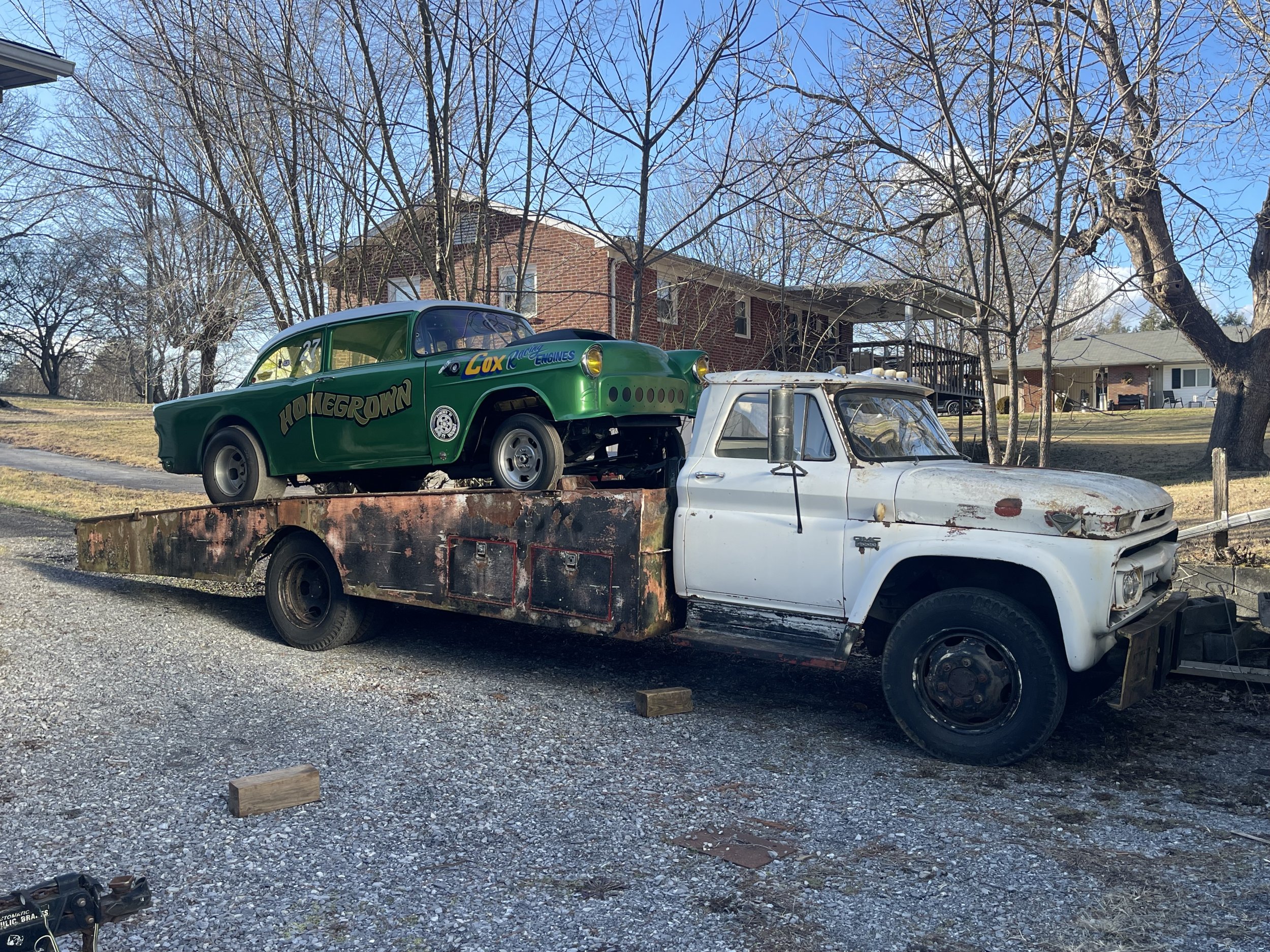

    IMG_4405.jpeg IMG_4394.jpeg IMG_4392.jpeg IMG_4407.jpeg IMG_4411.jpeg IMG_4408.jpeg IMG_4370.jpeg IMG_4196.png IMG_4197.jpeg IMG_4199.jpeg Little off season score for the race team, acquired this 1966 GMC 4000 ramp truck with a 305 v6/4spd 2spd Saturday. Incredibly good shape and just needs a little paint work to be up to really look the part. Going to put some fresh black down on the bed, bumper, and wheels. Then some enamel white on the cab and some door lettering and it’ll be dialed in.
    Next winter plans is small block or big block swap and nv4500 for a little more modern and highway friendly travel for long distance.
    The wife and son already approve of the vision!

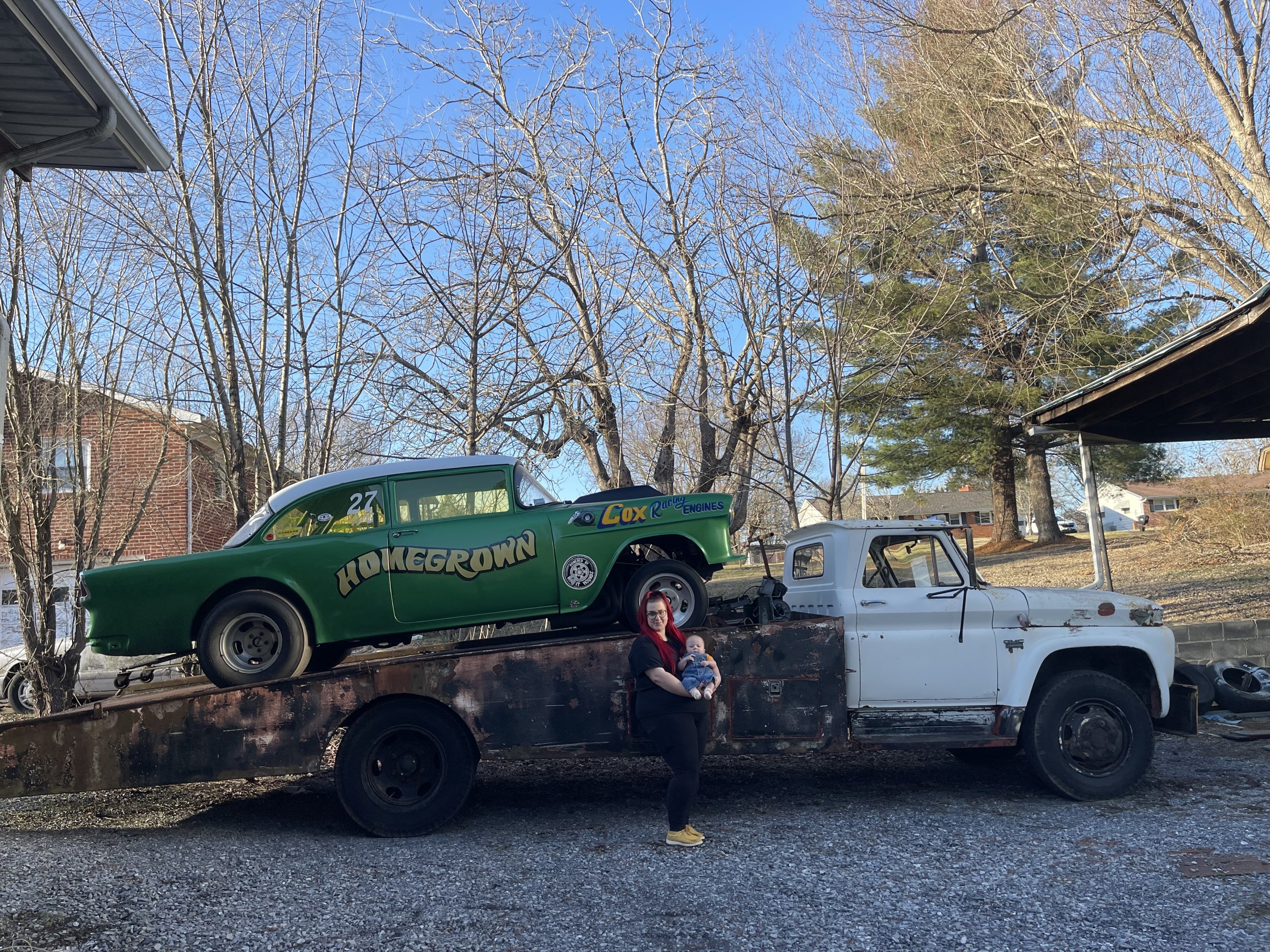

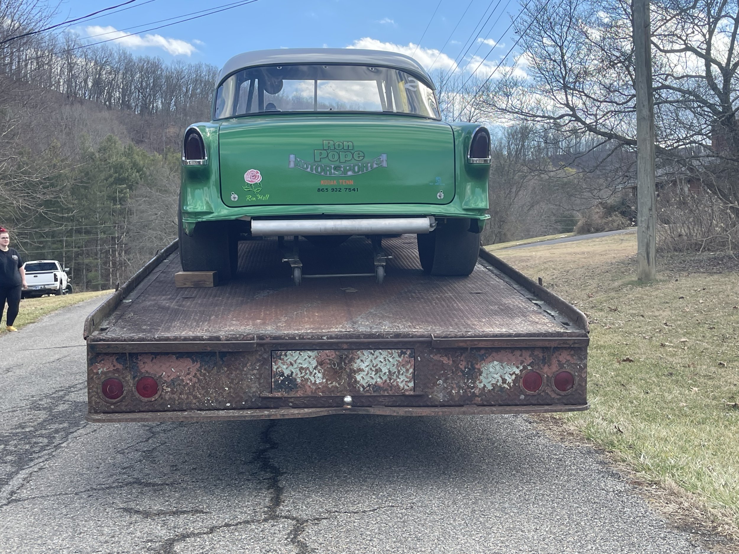

  23. Zak Hall
    Posts: 712
    Zak Hall

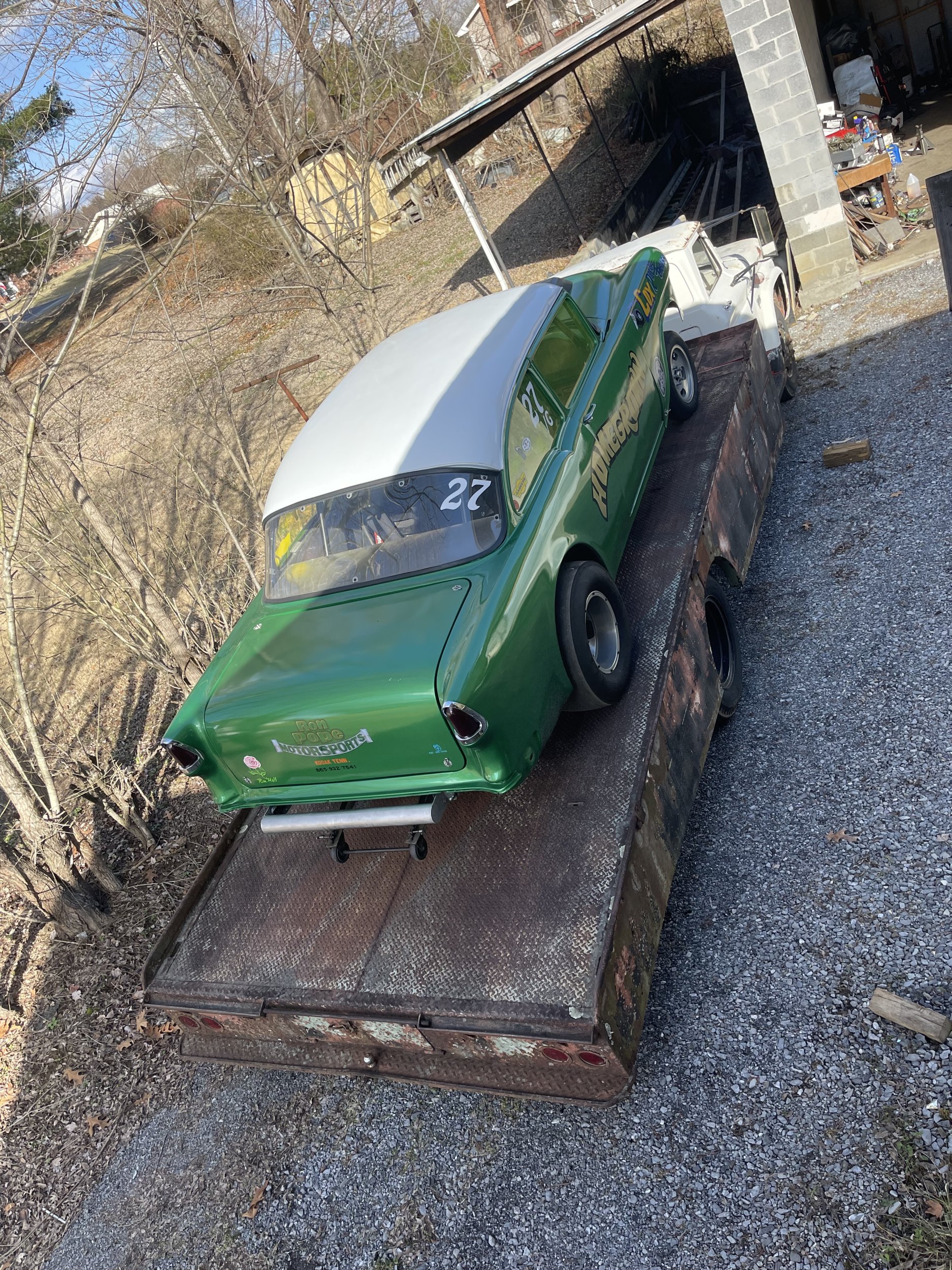

    IMG_4727.jpeg IMG_4685.jpeg IMG_4684.jpeg IMG_5399.jpeg Weather hasn’t really been cooperating, but have made a little progress on the ramp truck, fixing lights and painting the bed. It’s not perfect but looks better than it did. As soon as the weather breaks, I’ll scuff the cab and shoot some single stage white on it to freshen it up before we letter it too.
    Also, some big changes coming for the 55 too. Tore down a couple cores and ordered some parts, getting ready to throw together a powerglide and convert the car over to bracket trim for the upcoming season.
