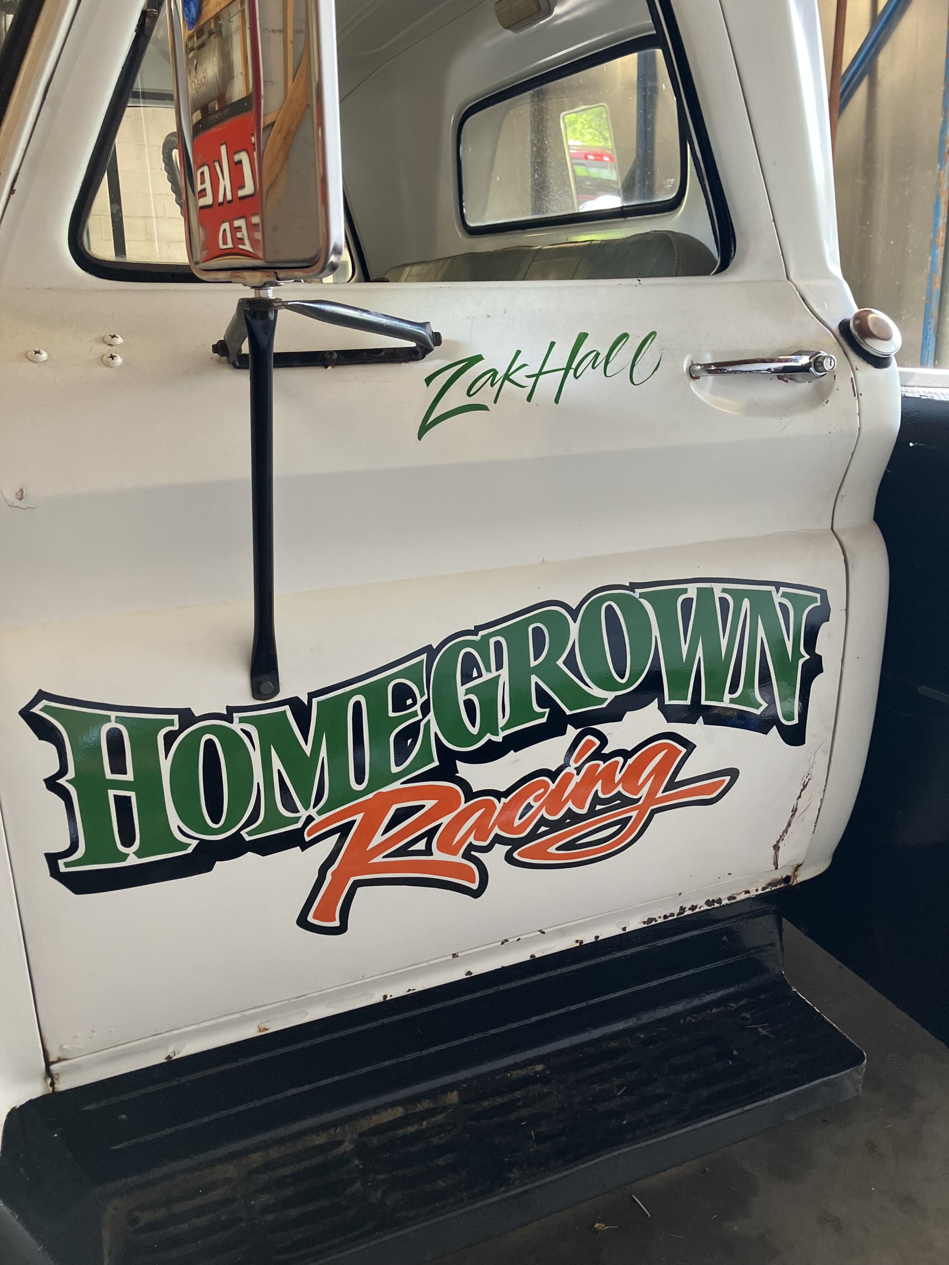

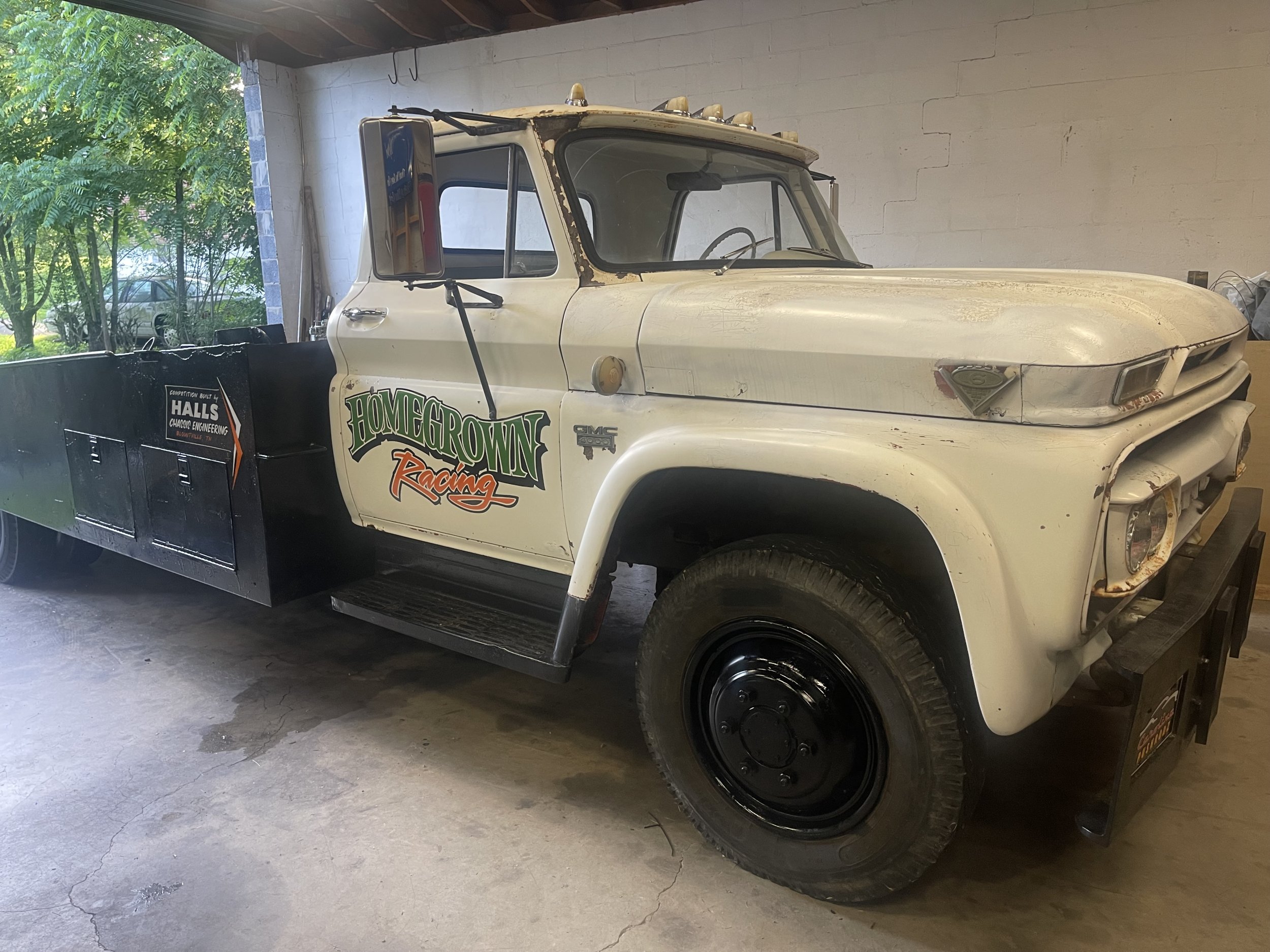

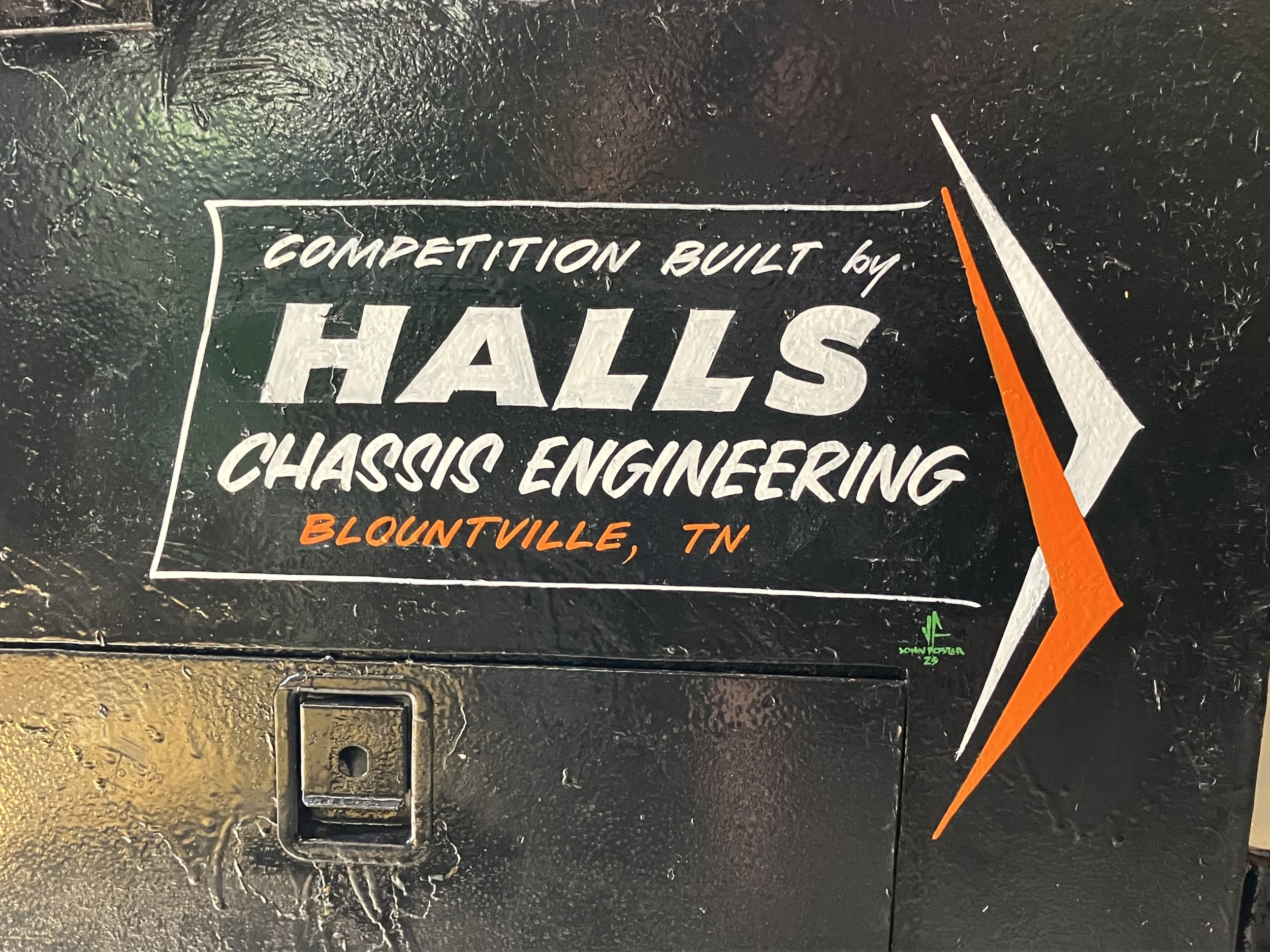

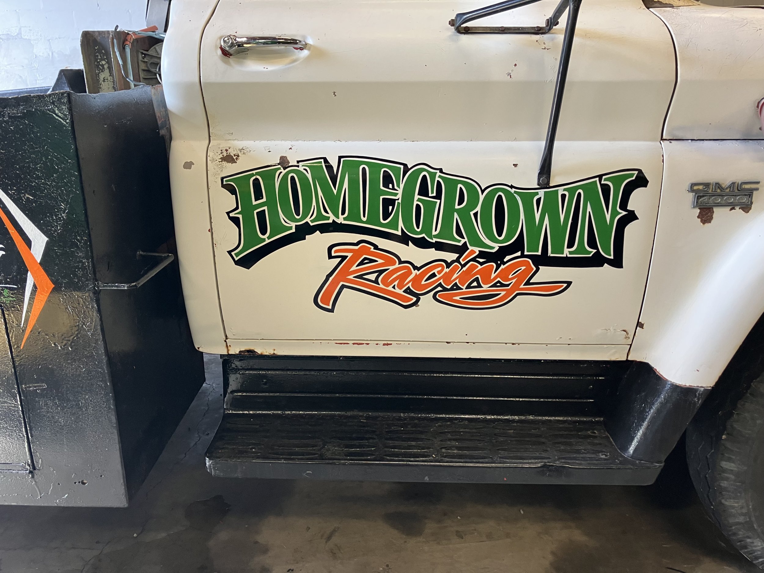

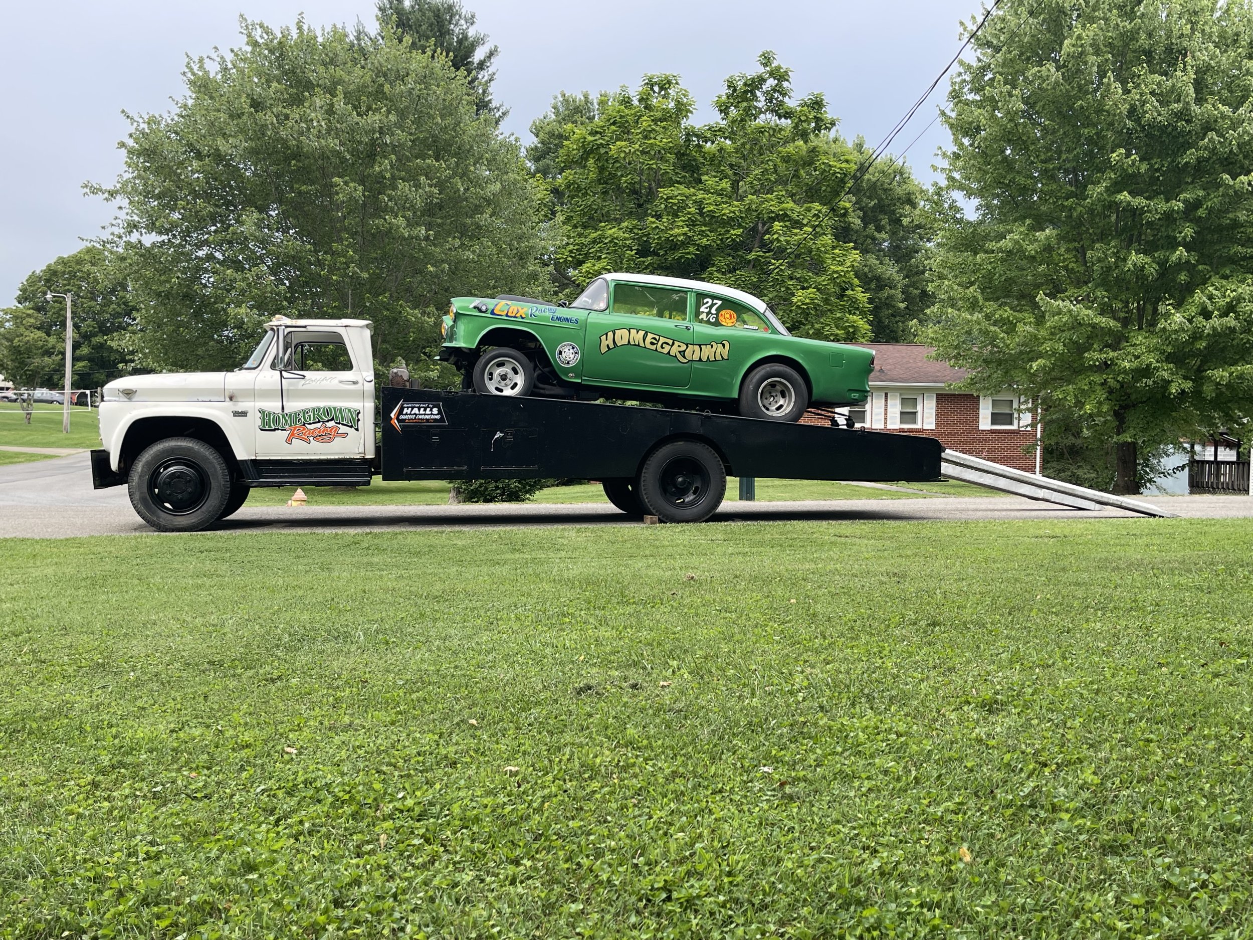

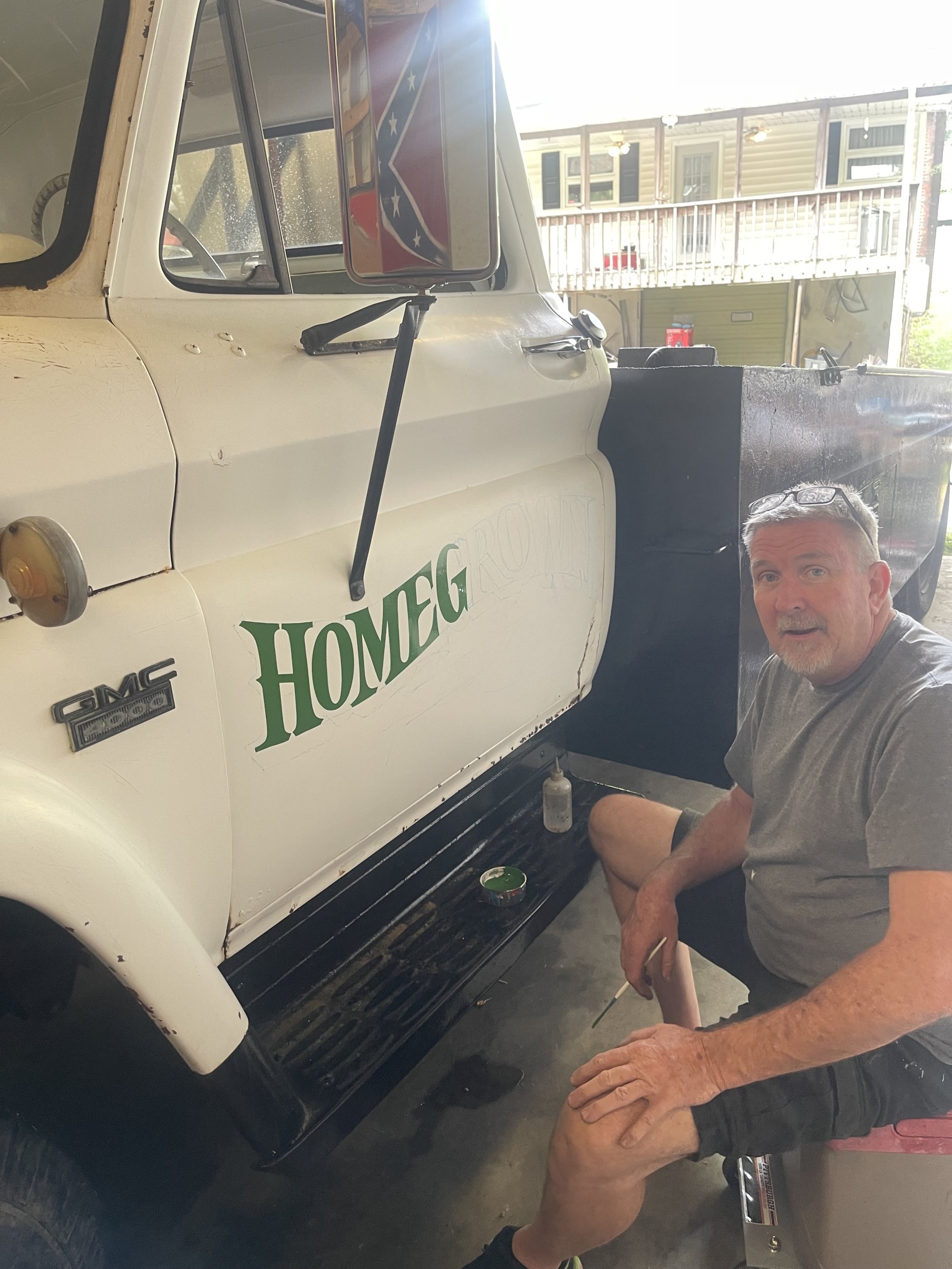

    IMG_0450.jpeg 77179932921__9954ABB8-8A45-453F-A887-4EC6E0D38542.jpeg IMG_3910.jpeg IMG_3909.jpeg IMG_0423.jpeg att.7awHq2MmVtzN_28hGq1ebyx-mt-R1mAUt3WyLNWqaGw.jpeg att.rxKRXle7NnCh6bPKRCTUwjXCAa0VY2qnN7KV8vjuDKA.jpeg IMG_0277.jpeg att.d6AqdlxcHL0E9rkHPludQOsievvLHYNzuYNe9qDqJhw.jpeg Been tinkering with the ramp truck.
    Got it lettered up today, and it’s going to look killer going down the road.

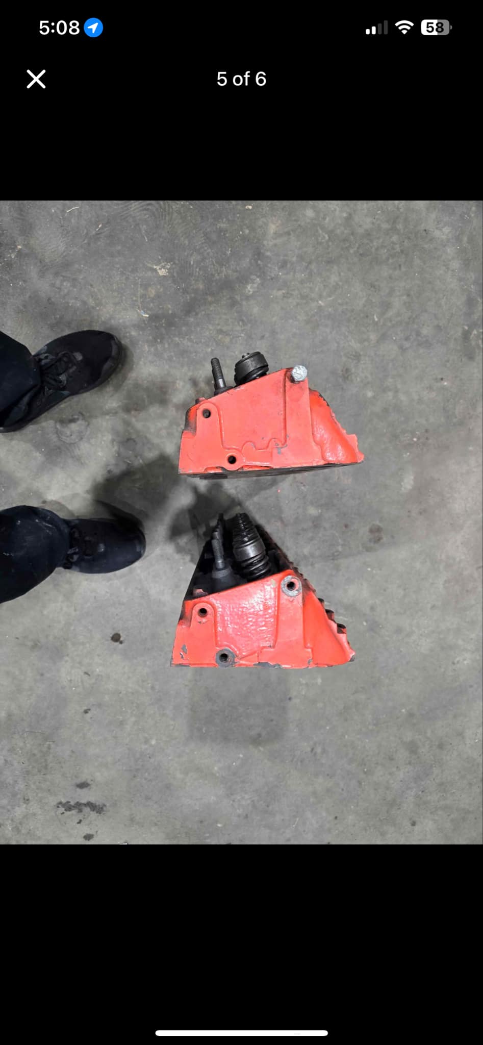

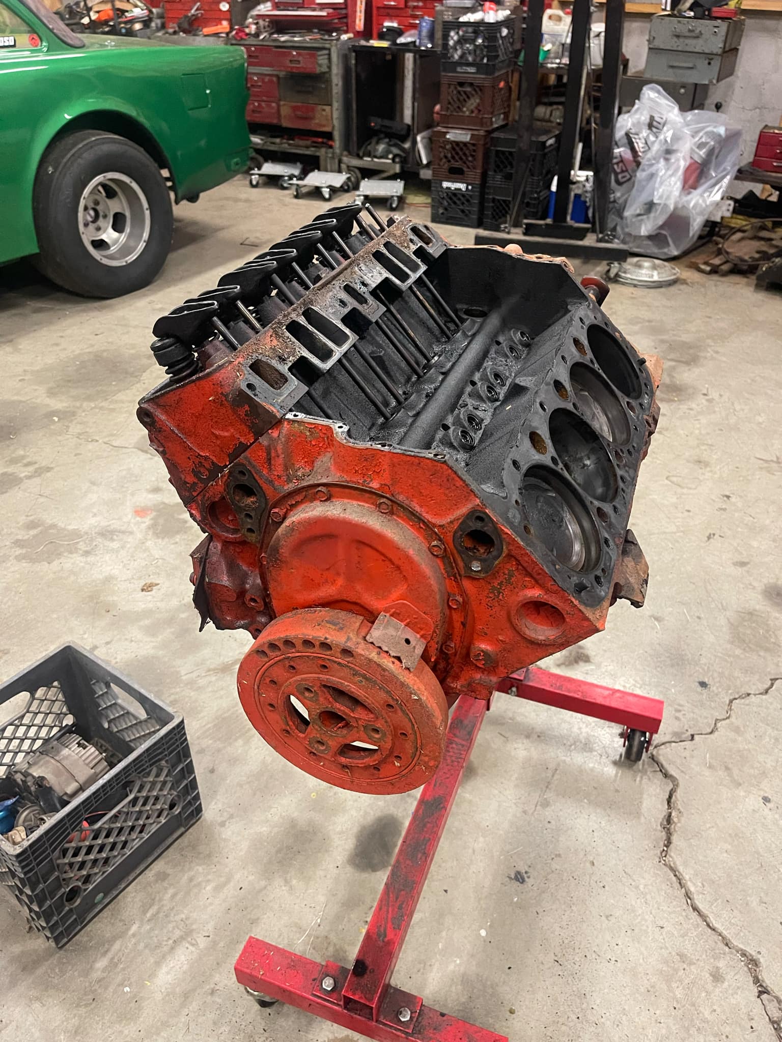

    Also started tearing down the 400 and getting it ready for cam/heads/intake. It’s getting a small rv cam and ditching the smog 882s and putting a set of double hump heads on it to help with compression and performance. Going to swap it and the 400 turbo into the old truck here this winter.

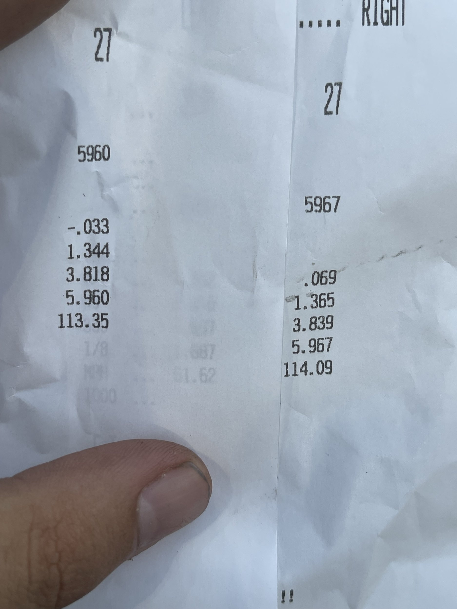

    Made some p***es, car ran great in the heat testing, and the ramp truck is just my favorite thing ever. Lol IMG_0998.jpeg IMG_0942.jpeg IMG_0944.jpeg IMG_1017.jpeg IMG_1015.jpeg

    Getting consistent times. Good light when don’t red ( smile )

    A few pics from this past weekend, last bracket race of the year at Bristol, going to try to make a few changes and make some more p***es in a few weeks and see if I can find the tree and maybe find some et too. IMG_2255.jpeg IMG_2254.jpeg IMG_2245.jpeg IMG_2233.jpeg IMG_2236.jpeg IMG_2238.jpeg IMG_2237.jpeg IMG_2230.jpeg

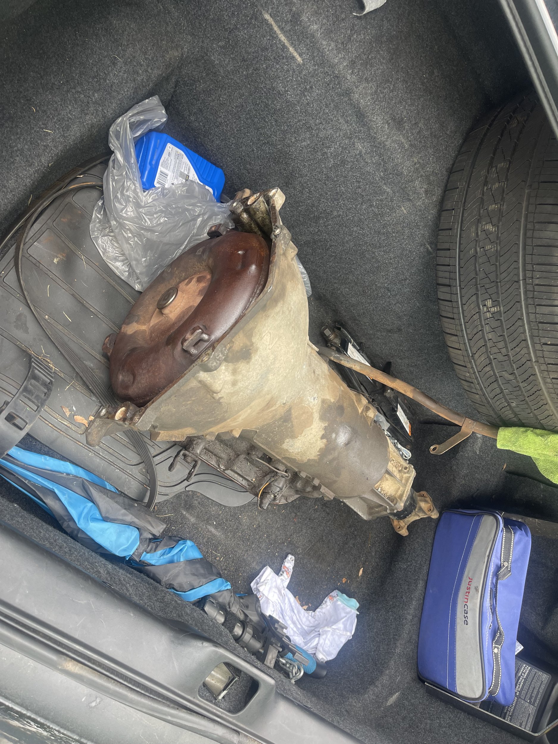

    IMG_5281.jpeg IMG_5282.jpeg IMG_5284.jpeg IMG_5285.jpeg IMG_5286.jpeg IMG_5287.jpeg IMG_5288.jpeg IMG_5289.jpeg Spent the past few weeks working on the tow rig, getting it updated and ready for 2026.
    Removed the dog turd 305 v6 and NP435 that was worn out, and swapped in the 400 small block that I’d reworked, with 186 heads, RV cam, and aluminum intake and Holley 600. Also added gauges so I know what’s going on while driving down the road. Has long tube headers, and some exhaust we made up in the shop, just 2.5” duals with china flowmasters and turn outs, but it’s really pretty quiet in the cabin and has a ton more power than the 305 v6 had.
    Still have a few small things to ****on up on the wiring, and clean and paint the engine bay (couldn’t get the truck in and out of the shop to clean it with no engine/transmission/clutch/ or brakes) but it’s pretty cherry now. I want to redo the seat, and find a taller geared rear end but other than that the truck is perfect. It’s 7.20 rear gear in high range right now so the cruise speed is about 3700rpm at 60mph. 5.86 gear rear end would be optimal with the 40” tires that this truck uses.

    Looks great - living the dream - don't s**** that NP435 - the off roaders love 'em

    I sold it and the 305 v6 for a couple hundred dollars and sent that stuff down the road to someone that can hopefully use it.
