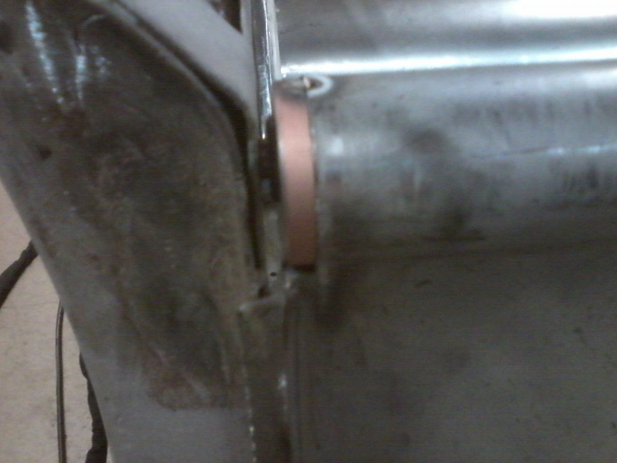

    Then there was dealing with one of my pet peeves which is squeaky, metal on metal rust traps that were the old style hinges. My solution started with two needle bearings I pressed into the lower tailgate tube.
    Then I turned down some 3/4 SS rod to fit perfectly in the bearings. I made some SS plates for mounting, set the tailgate in place, and welded them together.
    Now it is silent and smooth as ****er.

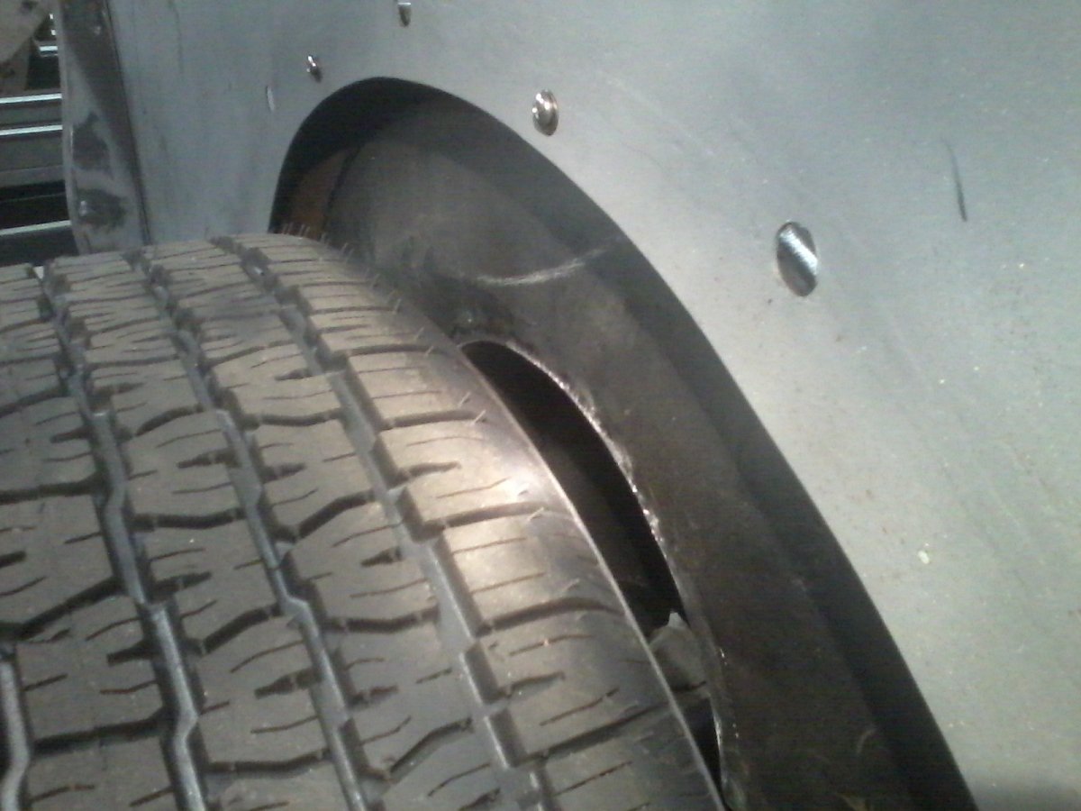

    Current work is all about the inner fenders in the bed and the tunnel that will cover the frame notches and rear end. The inner fenders came from trailer fenders that I cut about 6" out of and narrowed. IMG_3321.JPG IMG_3322.JPG
    But she is starting to look pretty complete!

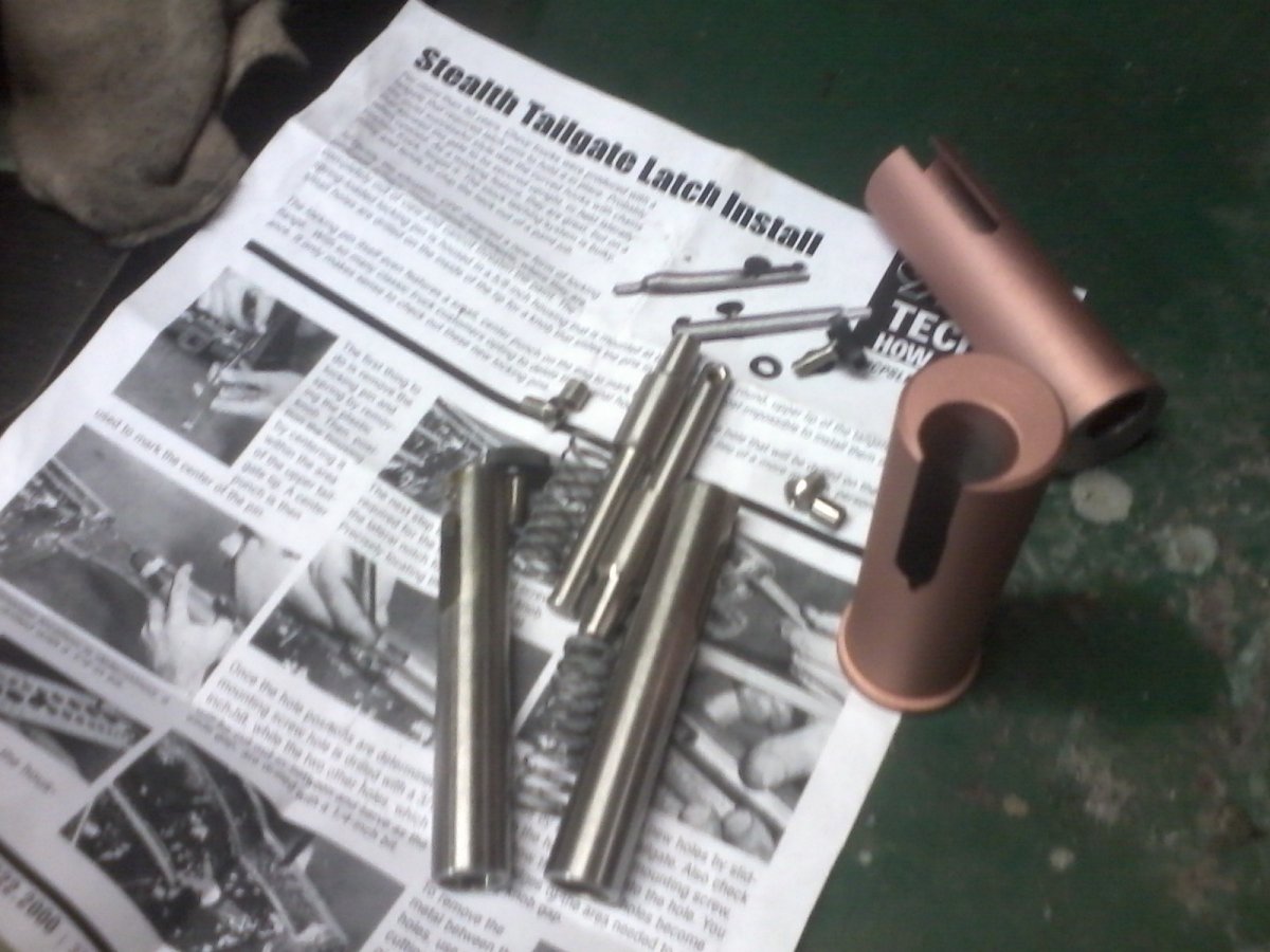

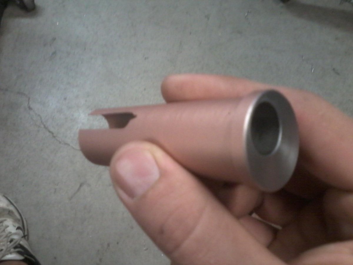

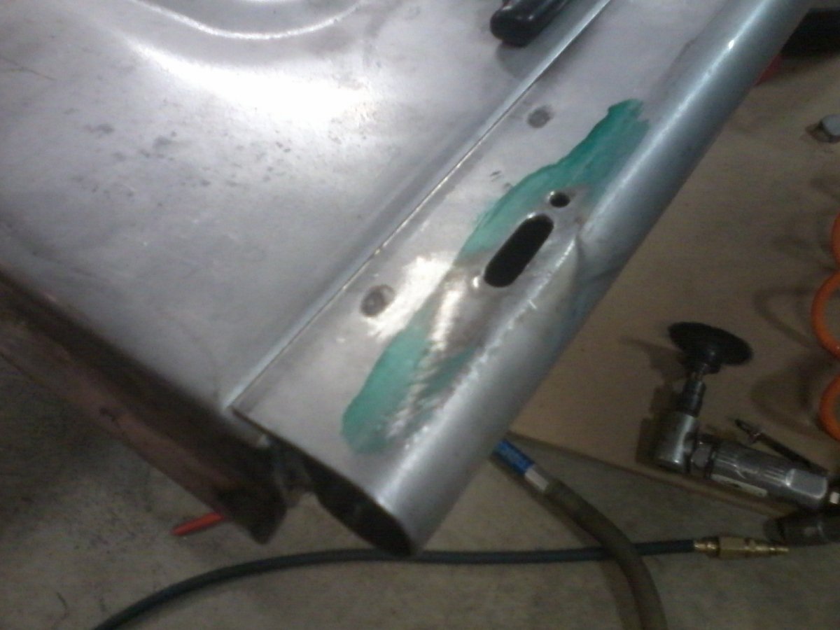

    My tailgate latches started as an off the shelf item, but I seem to always take things to the extreme by machining something. I purchased a hidden tailgate latch set off ebay, and then made these pieces to house the latches and extend the upper tailgate tube. The pieces are painted with weld thru primer.
