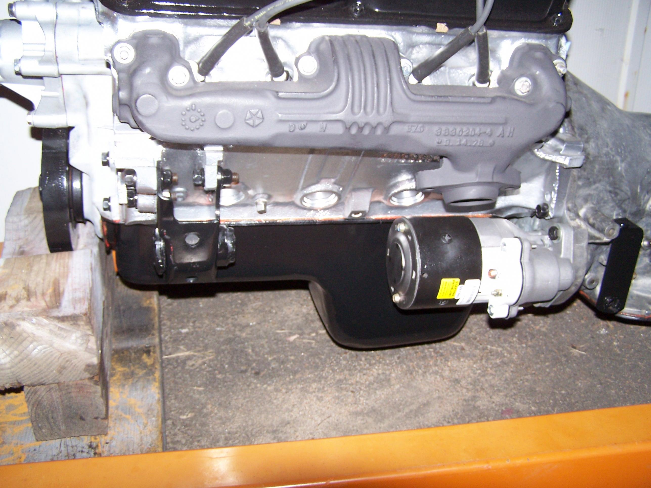

    This rear sump design wont work with my i beam axle, and since no front sumps exist to my knowledge, some alterations were needed.
    This is what I started with.
  2. TroyZC3
    Joined: Jun 26, 2012
    Posts: 230
    TroyZC3
    from Alpine, CA
    After cutting the pan in half length wise, flipping it around, then re-welding it and making clearance for the oil pump, this is what i got.
    Plus moving the sump location.

    Nice start !!! Keep posting.

    Forgot to mention shortening the dipstick accordingly

    The rear sump should have worked with the stock front suspension as long as no one removed any leafs mine fits fine with about 4 inches of clearence and when i got done I think the motor is too low i wish i would have mounted it higher in the engine bay. heres mine sorry its dirty ive been neglecting her:p

    Mine was kind of a different animal. It probably would have been about the same as yours, but the previous owner did an axle over leaf drop (which looks pretty nice). Therefore I lost any and all clearance between the axle and the oil pan. Ill post some pics when the weather gets better down here.
