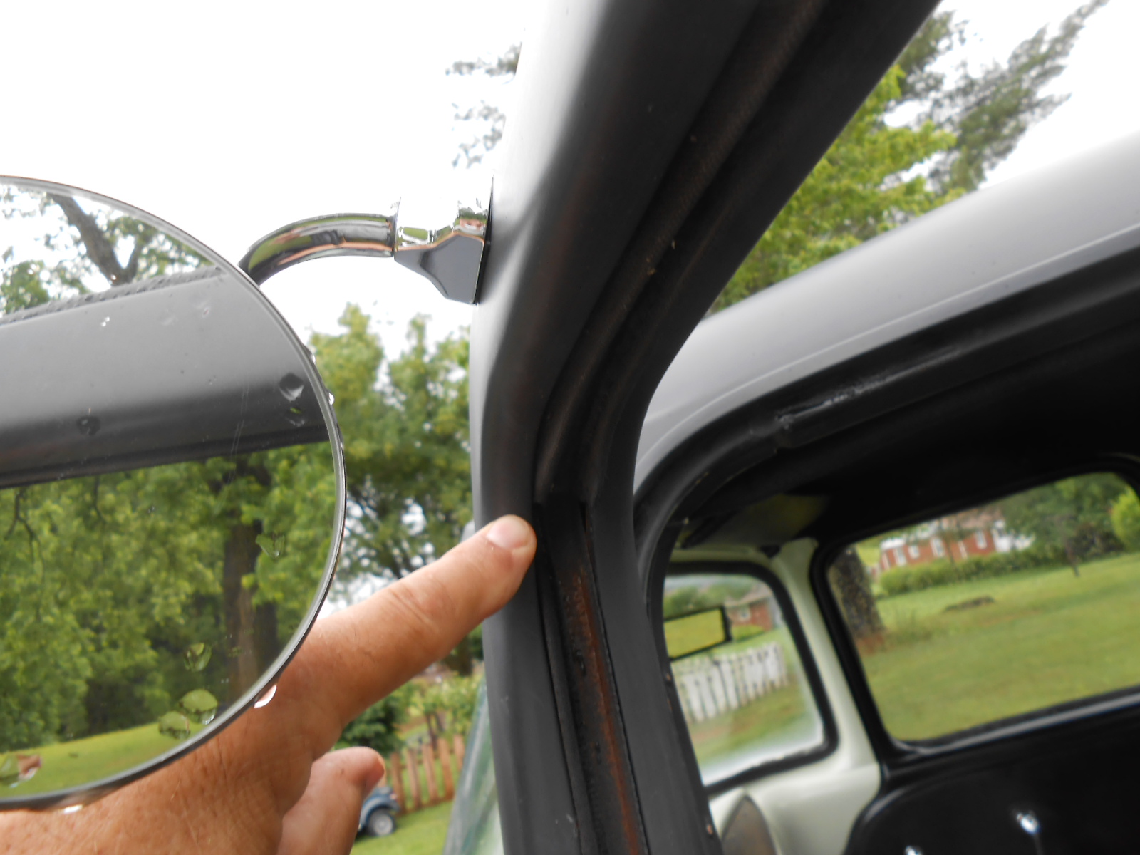

  6. stevethepreacher
    Joined: Nov 16, 2011
    Posts: 214
    stevethepreacher

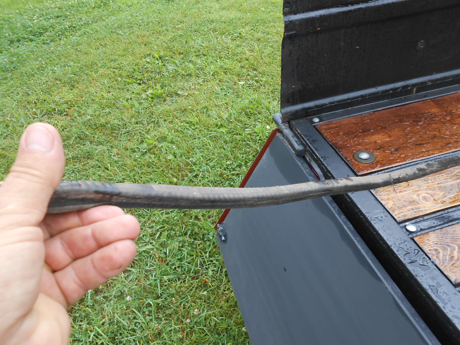

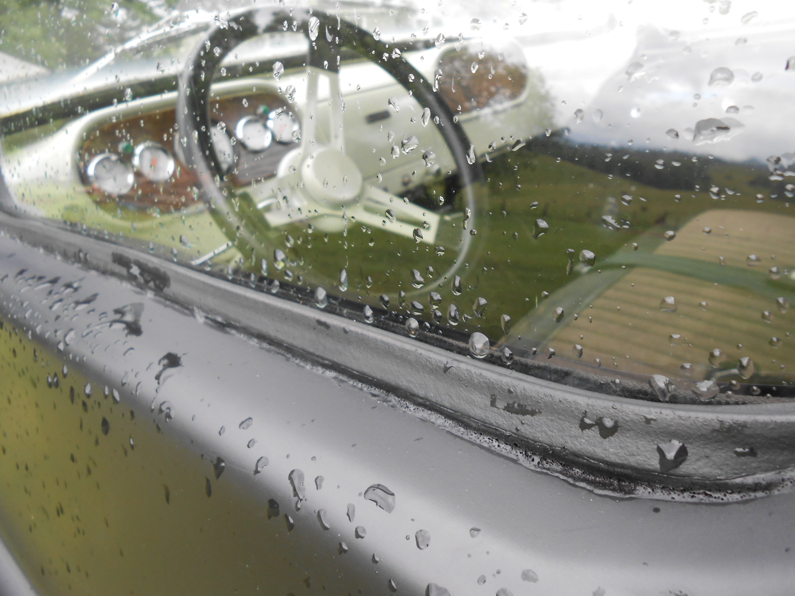

    Troy, tried to send a pic via pm. Here's a pic I had in my files of the window rubber. If you need a closer pic with more detail, just let me know. Hope this helps.
    Steve-

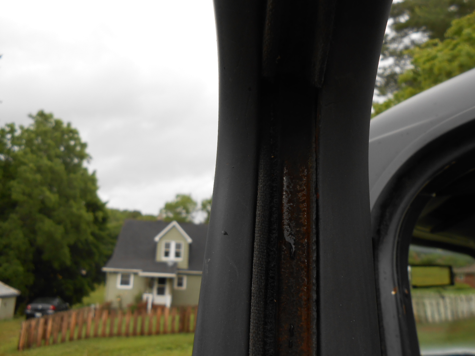

  7. stevethepreacher
    Posts: 214
    stevethepreacher

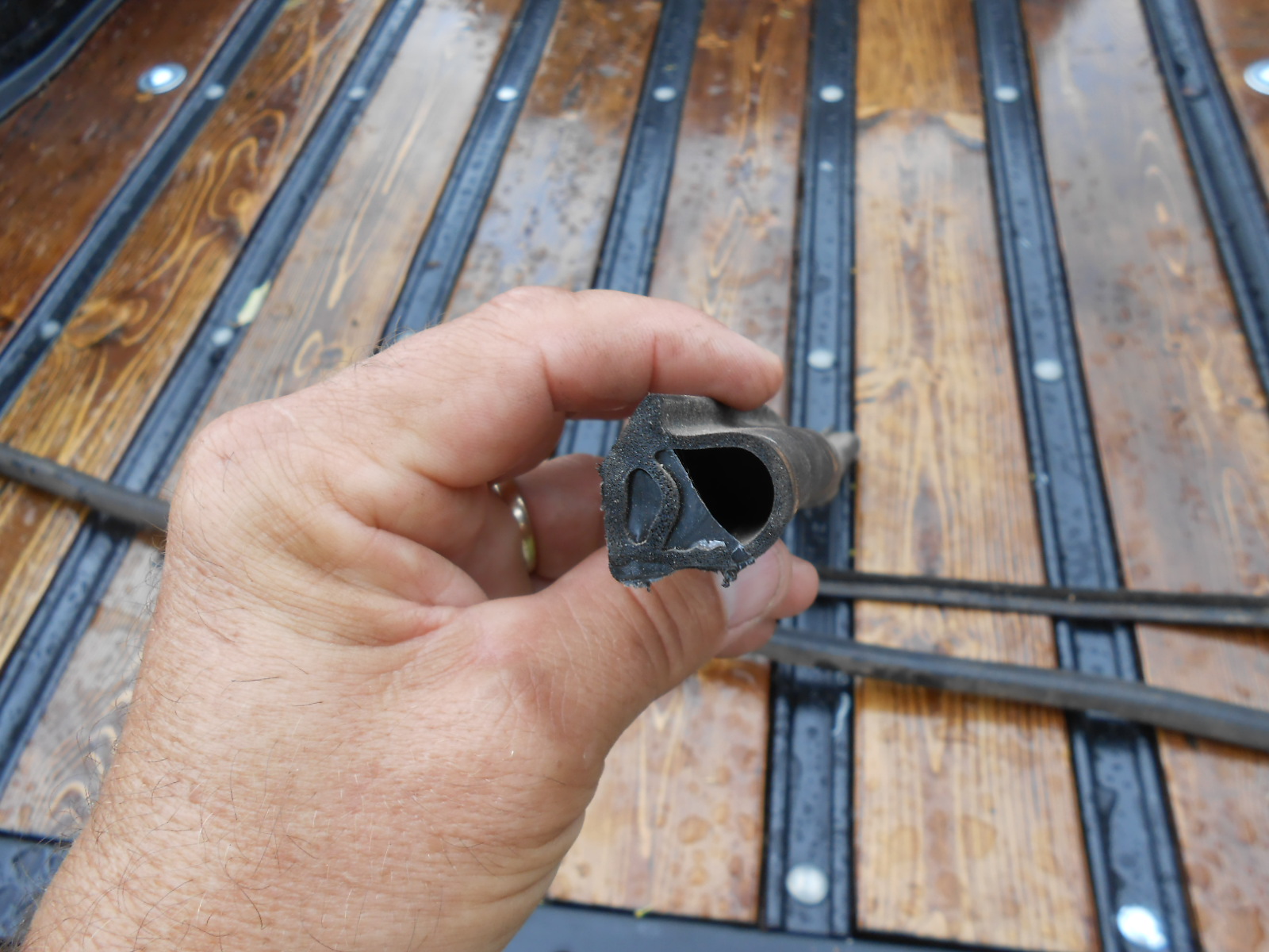

    Another pic that might help...
  8. TroyZC3
    Joined: Jun 26, 2012
    Posts: 230
    TroyZC3
    from Alpine, CA
    Stevethepreacher,
    So, the window channel rubber you got from Bernbaum's worked without the vent window? I was under the impression that it would be too short or something. And if you happen to have any other pics of your modified window guide (I think I am going to just move the old one forward without the vent) or window wipers, it would be super helpful. The closer the pics, the better!
  9. stevethepreacher
    Posts: 214
    stevethepreacher
    I will try to take some more pics today...it's raining cats and dogs here. I did move the 'post,' or channel, that was between the window gl*** and the vent gl*** forward and made a bracket down inside the door to hold it in place. The window channel that I ordered from Bernbaum's was either 6 or 8 feet long (it's been so long I don't remember) and it was long enough to run from the bottom of the front metal channel, up the front, over the top of the door and down the back and I believe that I cut off about a foot or two. You want to make sure that when you re-position the metal channel that separates the vent and the window that you get it snug against the front of the window. Initially I did not and ended up cracking BOTH windows ($40 apiece) and having to have them re-cut. After I got everything dialed in, my windows roll up and down very well and keep the water out. Also I do not get any wind buffeting when I drive with the window down. I'll get some pics for you.

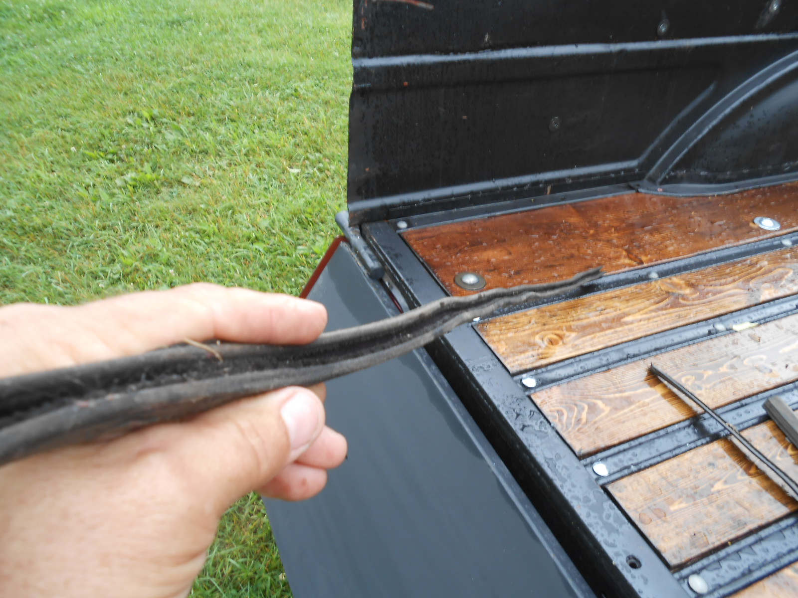

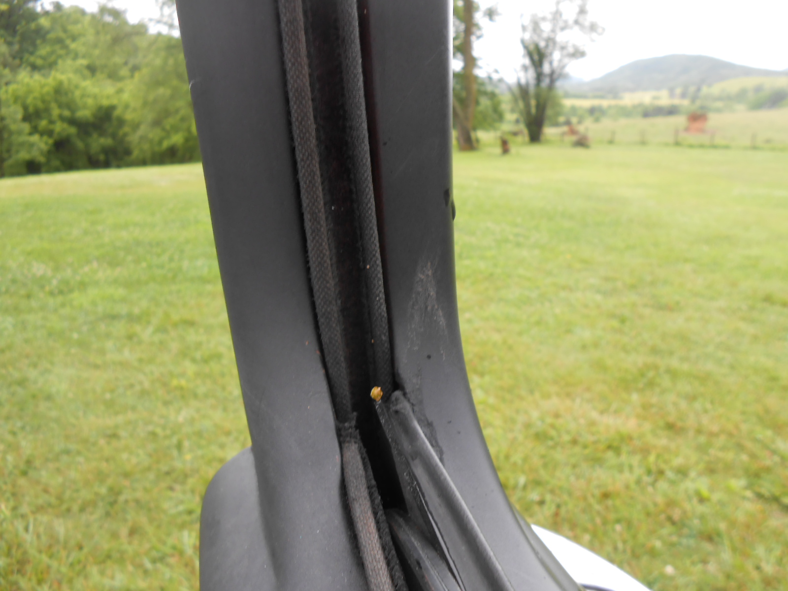

  10. stevethepreacher
    Posts: 214
    stevethepreacher
    When out and took some pics...and I told you wrong. The window channel from Bernbaum's ran from the front top of the window, across the top and down the back into the inside of the door. The window travels up and down at the front in the original channel that was between the window and vent. Here are some pics. I still need to get some felt and glue into the metal channel at the front. Also attached is a pic of some left-over window channel from Bernie's and some door rubber that a friend acquired for me. I cut the door rubber with an exacto-blade and glued it to the outside to make a rubber 'window' wipe. When you do something like this, you have to fabricate and imaginate a little. If you need any other pics or help, let me know.

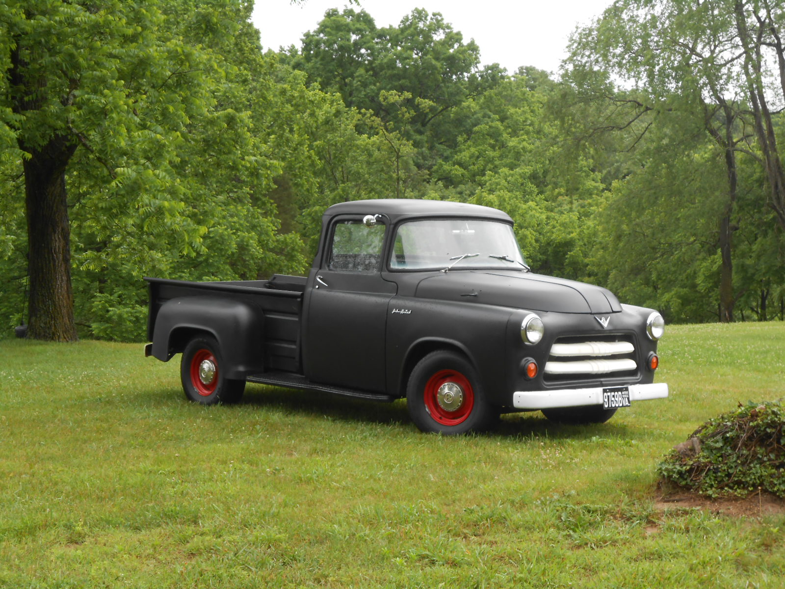

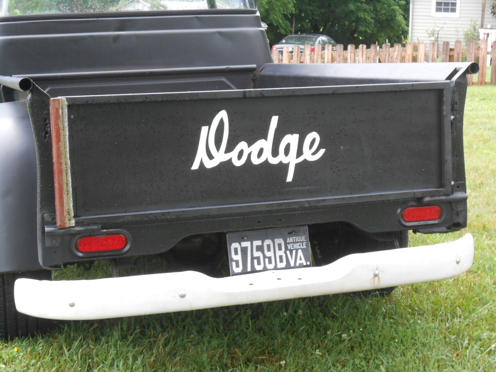

  11. stevethepreacher
    Posts: 214
    stevethepreacher
    Couldn't resist. Here's an 'after' pic of my truck. It had a high-side bed which I hated. I cut 5 inches out of the bed to make it a low(er) side bed. I also had to make a new tail-gate because the original was too tall. The tail-gate is not finished yet...
